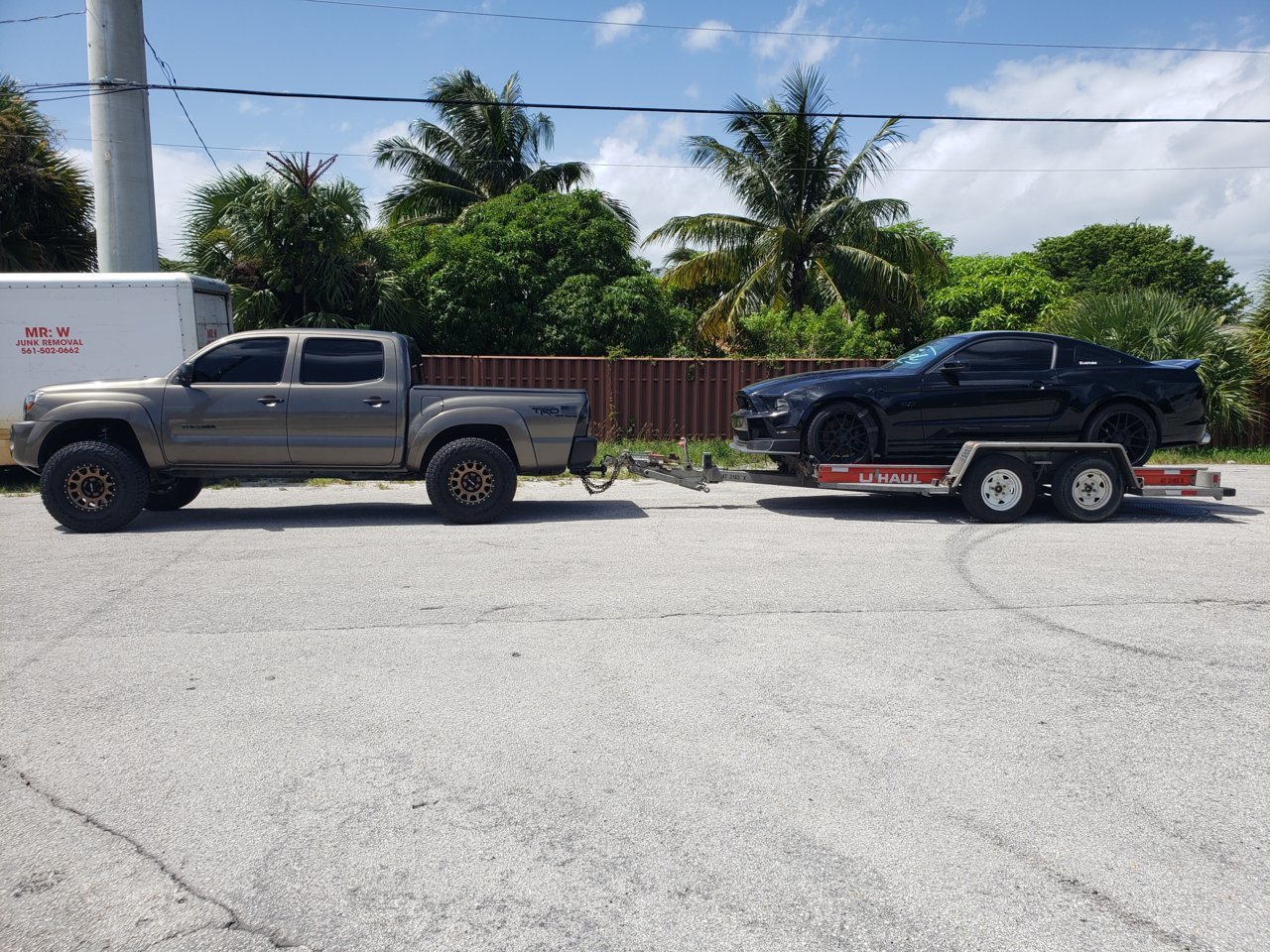

    Its pretty much stock tbh

    Where does the AR get mounted?

    Might help to move the stang back 6” or so to better balance the load.

    I'll try that

    Towing a dead horse? :rimshot:

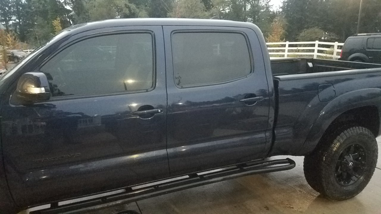

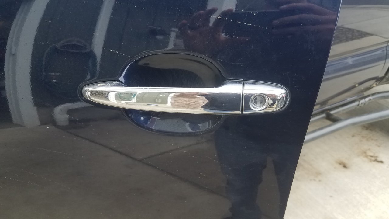

    2013 DCLB
    885s, Dakars, Bilsteins, Allpro Sliders, Archive Garage Hammer Hangers, Wheelers Ubolt flip, super bumps, RCI front skid

    Been thinking of doing the same, was it a pretty easy swap to the color matched ones?

    If I can barely lift the trailers tongue off of the ball with all of my strength I call the tongue weight good. How heavy is that depends on how much alcohol I had the night before (lol). Tongue weight is a key element when towing. And speed, I drive slower than grandpa drove whenever I tow.

    Very easy. There is also a how to for that as well. Rears, the door panel had to come off, I couldnt get to it through the door latch like suggested. The front you can do without taking the door panel off.

    I wanna say that theres a plug just inside the door for a torx bit to take them out...but i think i did mine about 7 years ago so i honestly can't remember...lol

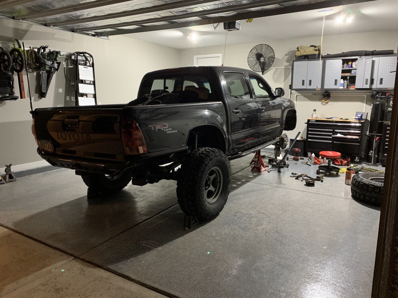

    Finished my PS spindle/hub swap & after a test drive, I am satisfied with the results.

    Youre right the little plastic plug and unscrew the torx screw for the front doors

    The reason for the sag is the tounge weight. Getting a 2" drop won't help with that (but it's still not a bad idea)
    I agree with @Pixeltim that the 'stang looks a bit too forward on the trailer, if you center it over the trailer axles they'll carry more of the weight and lighten up the load on your leaf springs, which will bring the truck up, then you WILL want the 2" drop on the hitch. If you're gonna make a habit of it, the firestone bags may be something to think about.
    But if this is just a one and done cross town run, I wouldn't worry about it.
    My SR5 with tow package dragged a boat over the Appalachians back in May 1100 miles, and I was astounded at how easy it was. No extra anything on the truck, well balanced load, and it was smooth sailing. (er....pontooning, actually.) Much lighter load than that Ford, of course.

    Thanks for the pointers, looking at the pic i should of moved it back some , i was too worry about filling up my tires since I run them on 35psi
