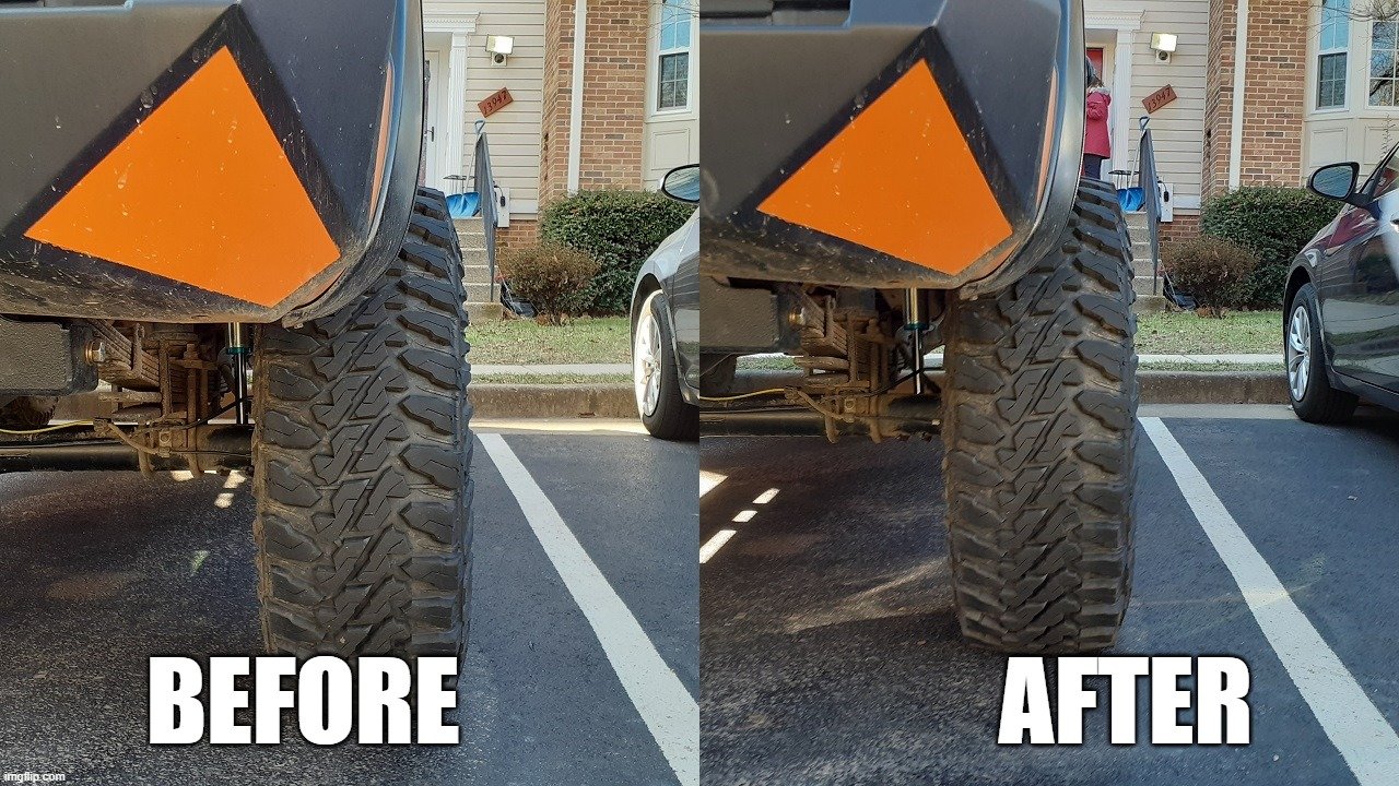

    Added a 3/4" Bora spacer to keep the tire off of the rear shock when stuffed.

    Quick question. Was this only necessary when you went up to 35's? What are the offset and backspacing of your wheels? I have 33's (285/70R17's) now and will be doing a 12 inch shock relocation for the rear of my truck. I have 1.25" spidertrax now but only on the stock +30 offset TRD sport rims. I will be moving to a 17x9 with a -12 mm offset and really want to do away with my spacers.

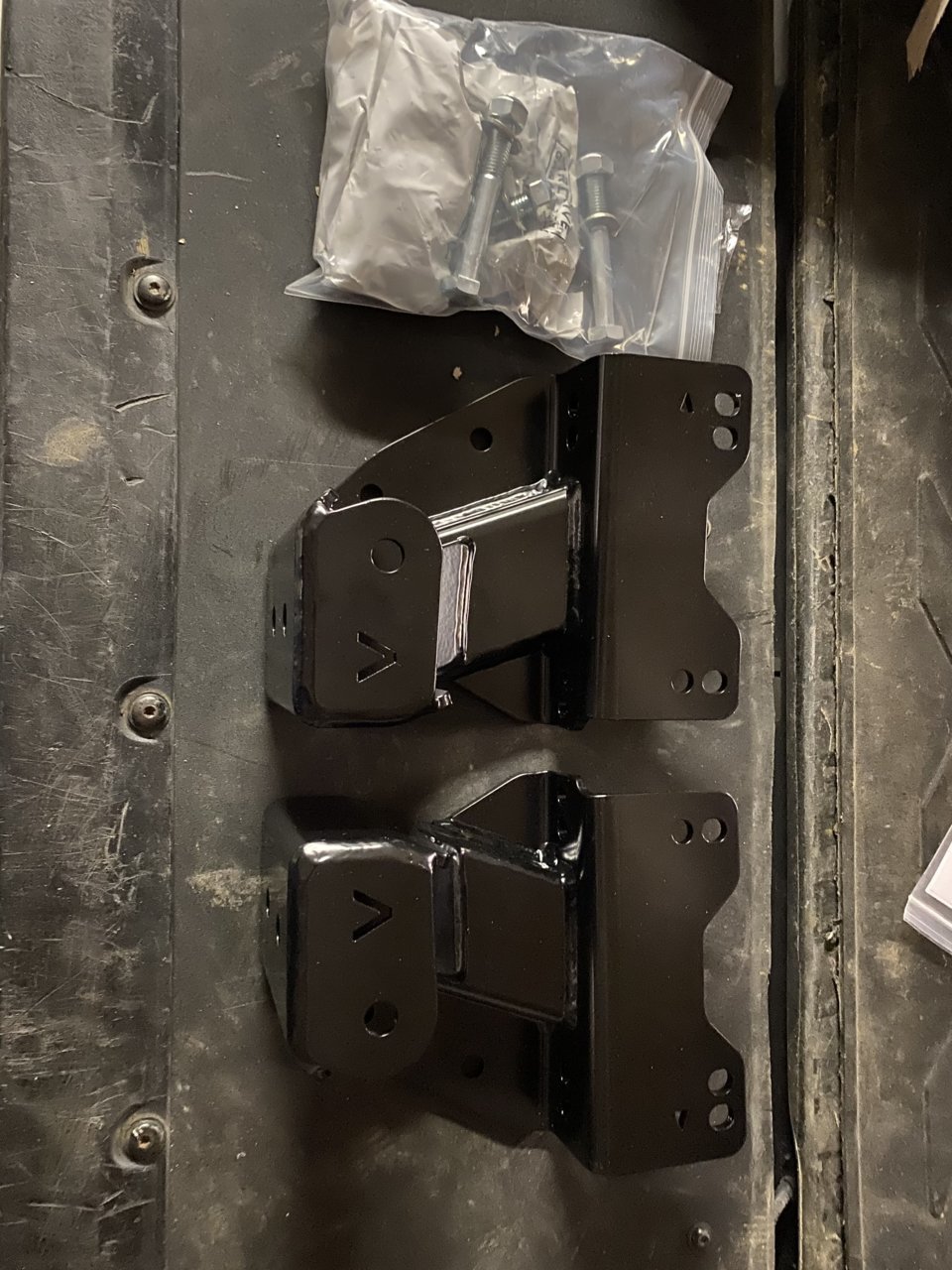

    These came in. Quality is top notch. V3 Clearance is on par if not slightly higher than stock. Cant wait to get them installed!

    What are they exactly m

    I can't say for certain but I never noticed my 33s rubbing on the suspension when one of the tires was fully stuffed. Wheels have 3.5" backspacing and -25mm offset

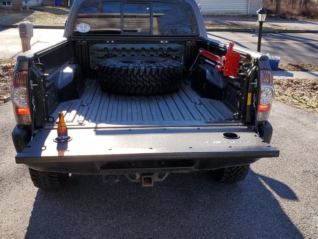

    Got my Bare outfitters Trailgate panel installed. It showed up in one piece no thanks to UPS. It looked like the box fell out of the truck at 60 mph. I immediately put it to good use.taco126.jpg

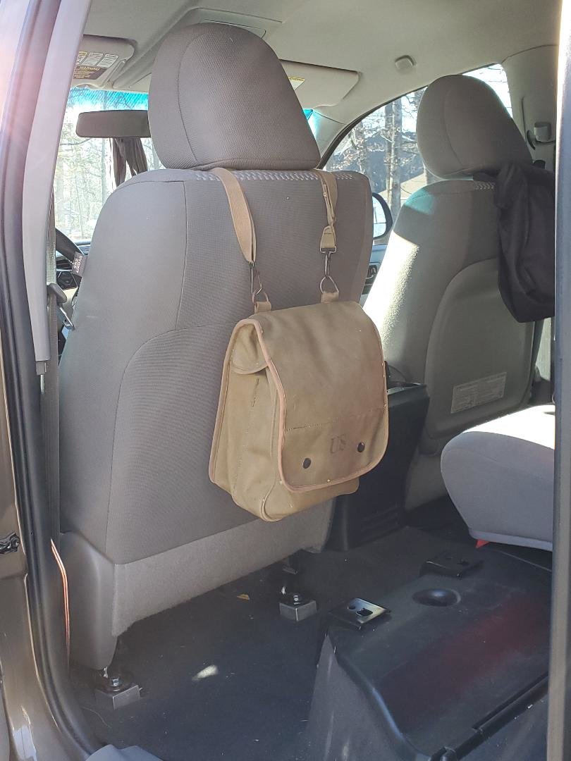

    Then moved my first aid kit and cpr kit to this bag that was my dad's when he was in the army back in the early 70's. Probably gonna redo the strap to make it a little shorter and need to sew in some velcro or come up with another strap so it doesn't just hang there.
