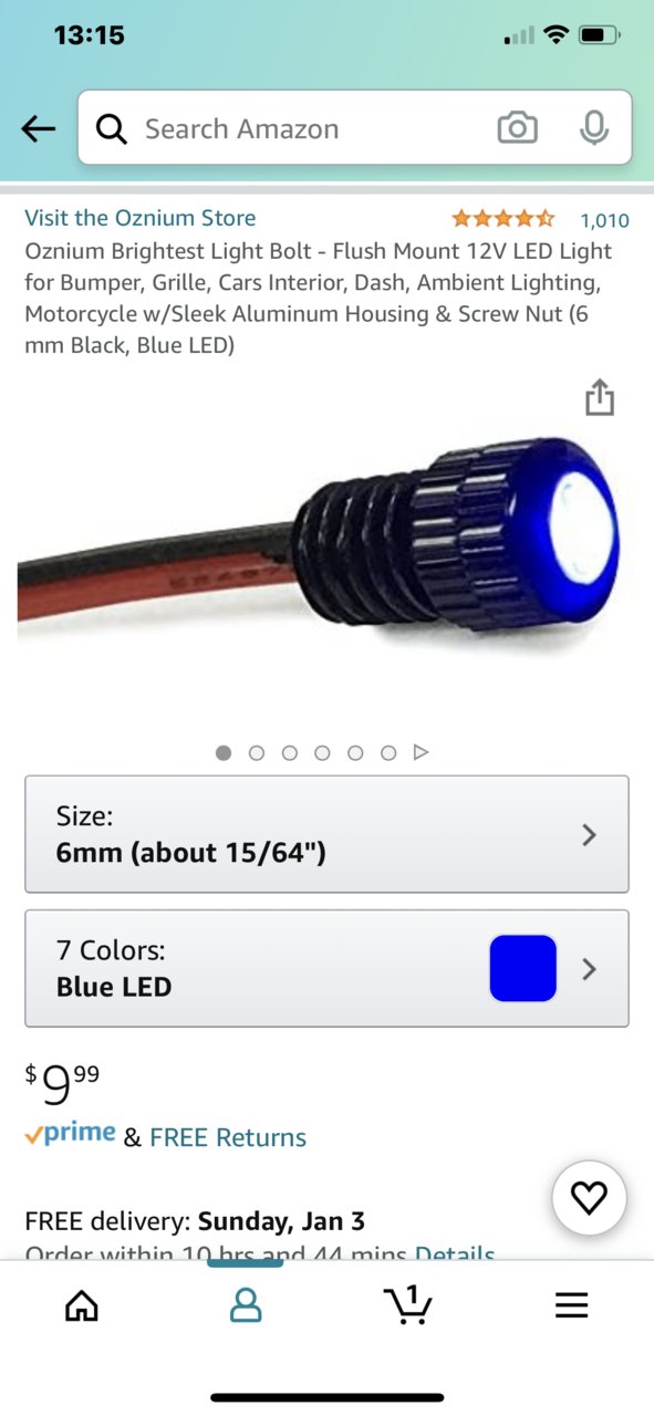

    Used these....
    drilling the hole for the cubby was a bit of the pain. Had to take a few bolts out to get it angled enough to drill a perpendicular hole.
    tapped into the wiring for the shifter lighting so that it comes on and off with parking and headlights. Also allows it to be on the interior dimmer.
    only advice I’d give is to draw it out before you do final wiring.
    I bought 5 white lights too that I’m going to put on a switch to help give overall interior lighting when needed since the dome lights are pretty weak.

    I put LEDs in the foot wells, front cup holder, and have a couple that shine through the rear vent (center console) in the back, but I really want light up the front cubby also. I tapped into the same place as you, (shifter light) so they turn on with the lights, and are dimmable.
    This will be a great solution! Thanks for sharing!
