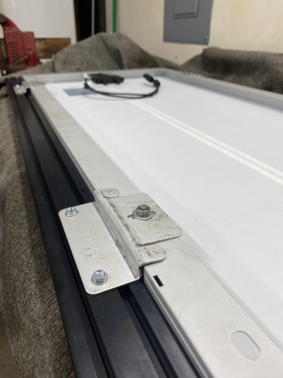

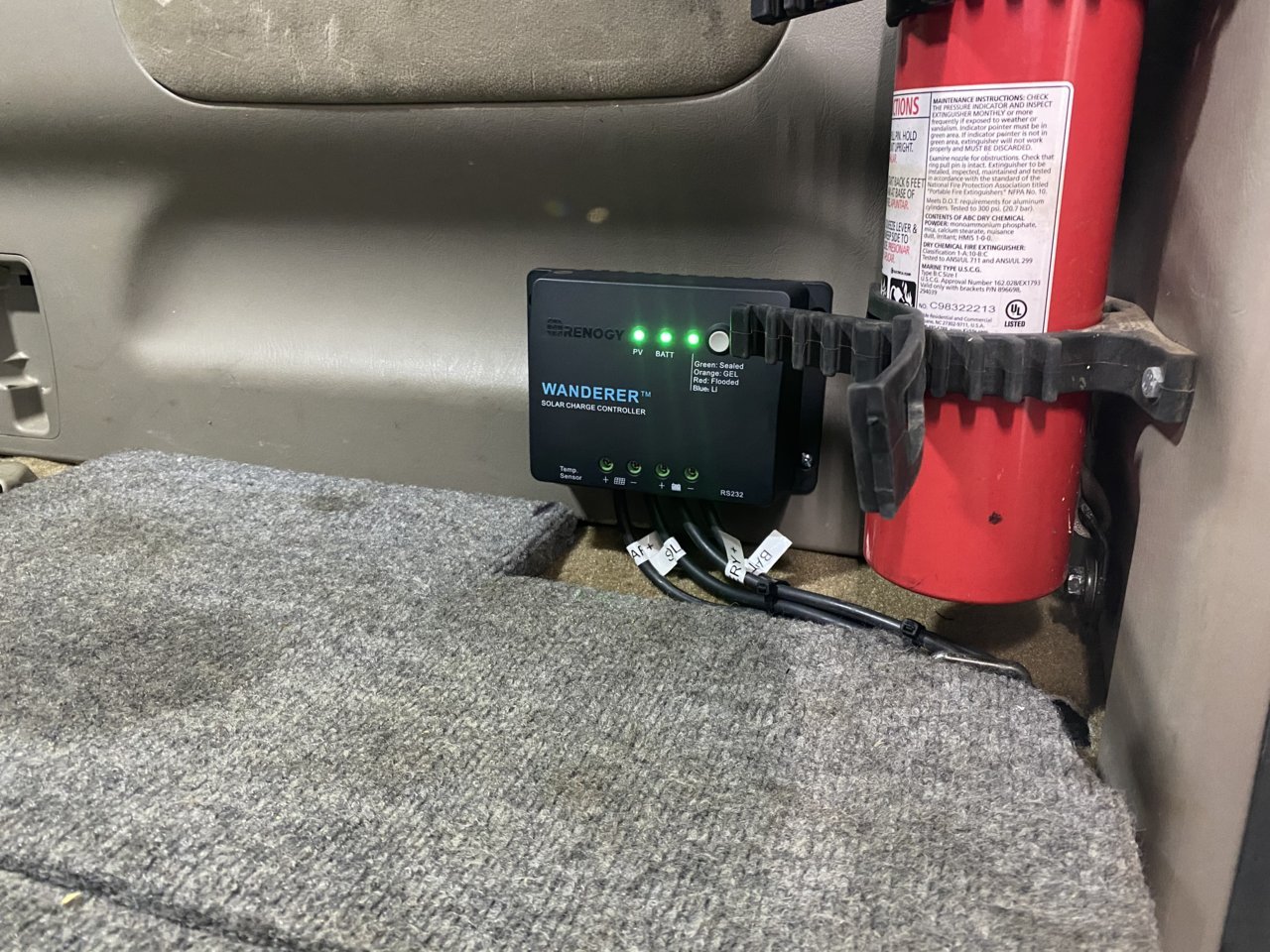

    I tweaked the panel a bit more today. Modified the brackets to allow for more clearance and I’m much happier with the finished product. I also finished routing and labeling the wires. Overall I'm very pleased with how this came out. The only thing I'm leery about is if I'll get any leaks where I routed the wires in the cab. Time will tell.

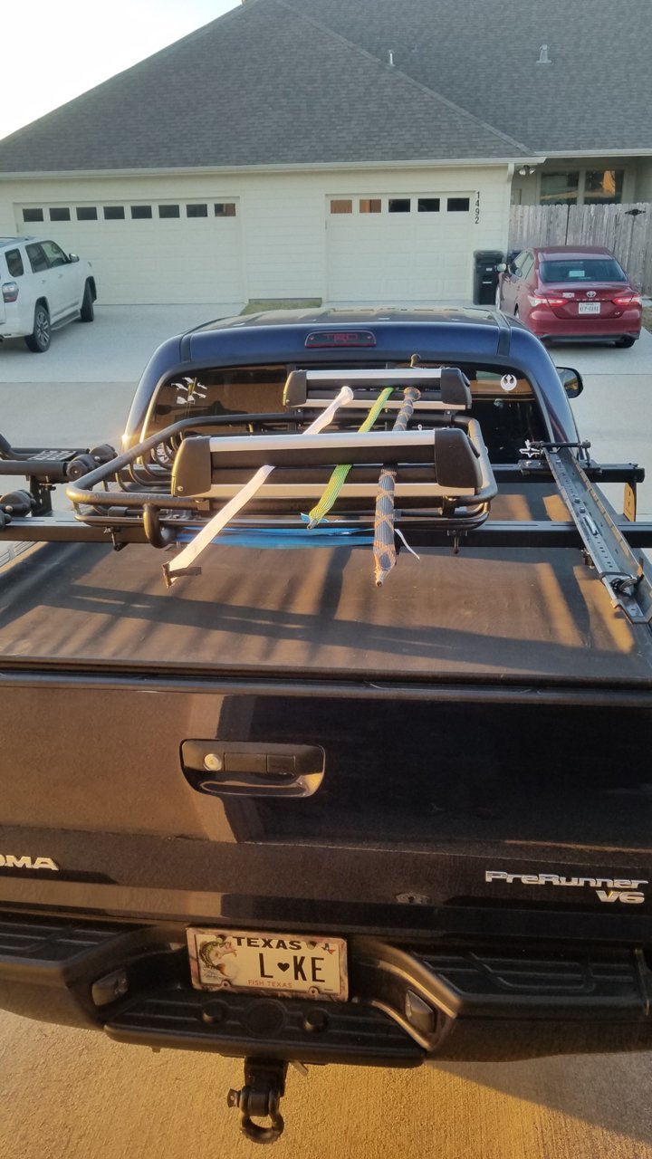

    Don't know if you're looking to keep that bed rack on all the time, but you could get away with a rocket launcher setup. You could build one with wood & PVC pipe without much difficulty, or fab/buy one of the more aesthetic options:
    https://www.google.com/search?q=tru...USPH0KHQcDDt0Q_AUoA3oECA4QBQ&biw=1536&bih=754
    Also worth noting some can be attached to the hitch as well, so it doesn't have to take up bed space necessarily.

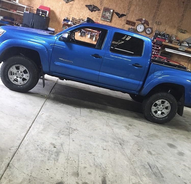

    Found Procomp uca for $300 and it started. Then I got All-Pro off road exp leaf spring kit with the bilstien shocks. Then I found bilstien 6112 fronts for under $600 off of rockauto.com. Found the timbrens bump stops on Facebook marketplace for $100. I ordered the front dif drop and drive shaft drop but ended up making my own drive shaft spacers.
    It took me over a year to get all the parts together. I paid the parts off one at a time. I had my grandma buy it and I would pay her back a little bit at a time until I paid it off and then we ordered the next part/parts. And at tax time my wife asked what else I needed and she ordered the 6112s.
    I thank all of you guys for inspiring me and the build

    I still dont understand much about solar. I'm not the best with numbers so it's kind of like I'm reading French. So I was wondering what can power with this setup?

    All this does is keep my battery topped off. If I'm parked for a while with my fridge running, my battery will slowly start to drain. This will allow me to stay parked for longer periods of time.

    I used to have a similar setup to that before I got the rack, and then I started from scratch again. I might have to look into ways to make it more compatible with the rack/basket on there (as of now the rods take up basket space for gear), or even the hitch idea. Thanks!

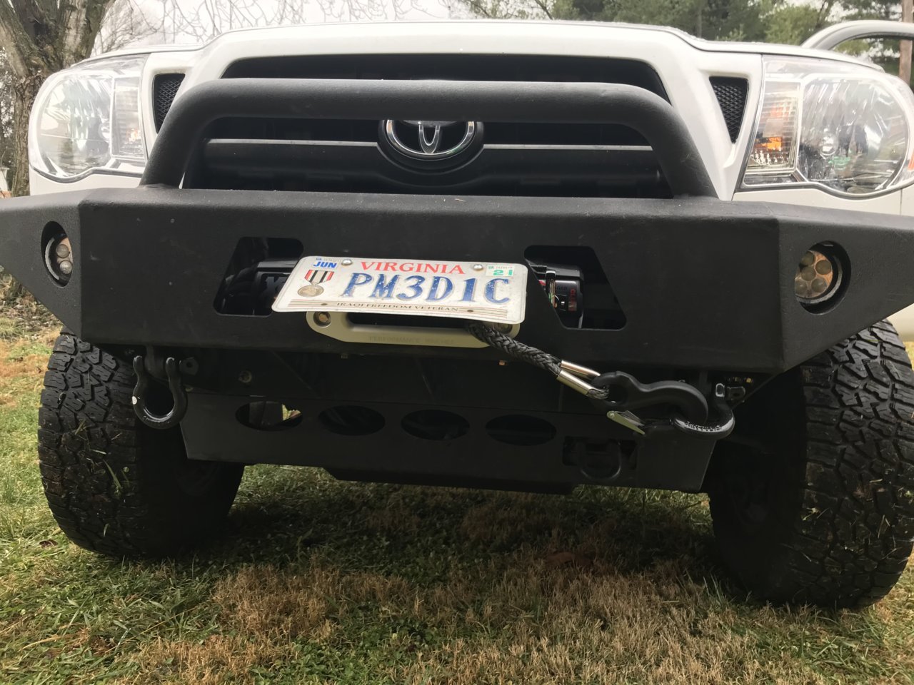

    That's a great winch. I love mine. I had to run the line underneath my truck and winch myself backwards up a very slick clay hill this past weekend that I accidentally slid off into. It worked flawlessly and quickly.

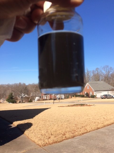

    Well since I'm semi new to Tacoma's and I'm from Missouri. ( The show me state) (I'm not really from there) but I always had a doubt about the rear diff breather mod until my Hurricane Creek trip last Tuesday with several TW Peeps! Dunked my Pumpkin in the first creek crossing. Changed my Rear Diff Fluid today and this is what it looked like. Keep in mind this gear oil only had 6k on it! It looked like coffee! There's no doubt it sucked in a ton of water! I now have the parts to do the mod. Just couldn't get them to the house before the trip! Here you go!

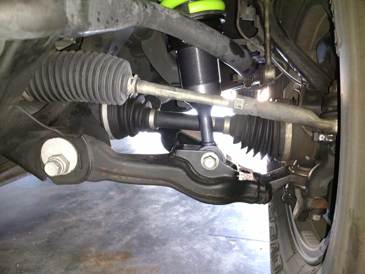

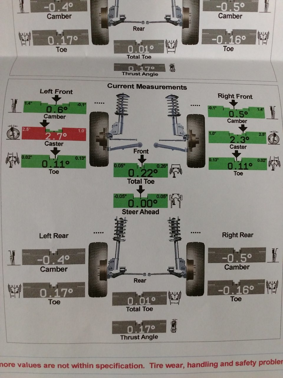

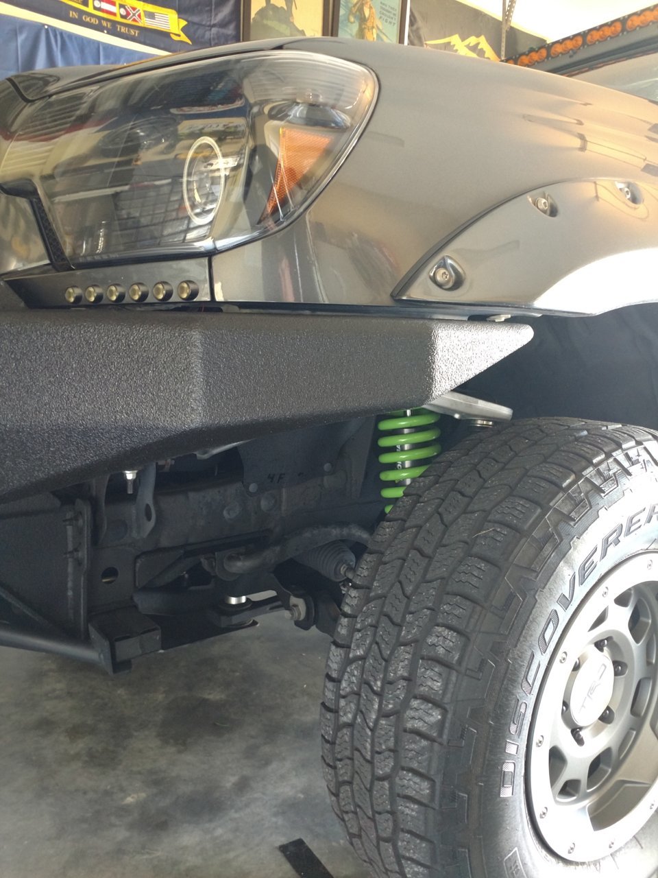

    Ironman 4x4 Foam Cell Stage 2 Pro kit installed. Alignment went well. 2.5 inch lift.

    Damn that's clean...beautiful color too! Front bumper smokin! But the tires got to go! :crapstorm:
