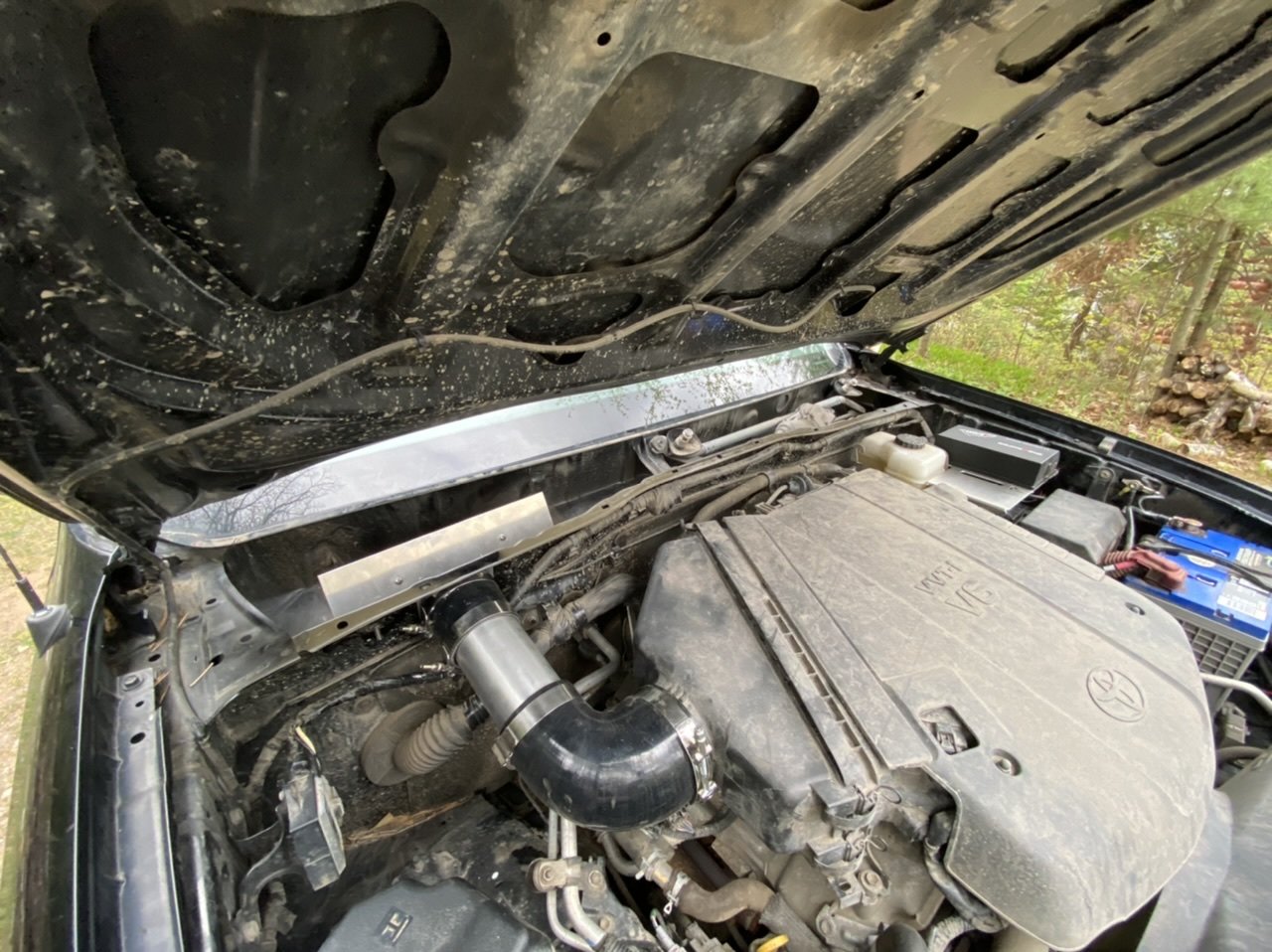

    I’ve been running the cowl induction snorkle mod for a while now. I don’t love the look of a snorkle and always knew I was gonna trim the fenders up front. Though I did finally pull that liner yesterday and need to cover the hole left by the intake being moved.

    what did you plug the fender holes with?

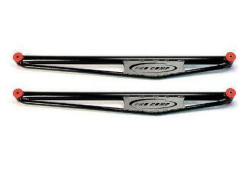

    So I guess traction bars are more universal so finding a Tacoma-specific solution isn't a big deal.
    https://www.4wheelparts.com/p/pro-comp-lateral-traction-bars-black-72500b/_/R-DFCW-72500B
    The reviews mention bigger lifts than I have. I only have a suspension lift based on 5100s and OME 884s/General Springs HDs - so 2.5-3", front to back. I definitely feel the effects of axle wrap, though, so I guess I should look into them all the same.

    So URD says they can have a bar made for a 4x4 truck (since the previous linked was only for an xrunner) - I'm wondering though, it's the "best" I've found so far - the pro comps hang low and mess the clearance up pretty badly - anyone have any inputs?

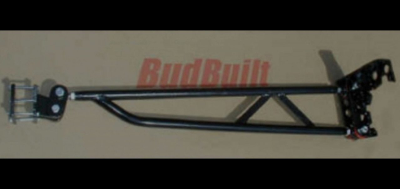

    I think my youngest stepson has a Go Pro, I haven't seen him use it in quite a while so I'll have to ask him tonight about it.
    In order for axle wrap to happen the axle has to be able to twist the leaf springs ~ the axle has to twist in a circular manner and with two solid points (one low and one high) on the axle it simply can not twist and is now forced to move up and down in a large arc instead of straight up and down as the suspension does its job, with fairly flat leaf springs (when loaded) it's an easy feat. The amount of arc that the rear axle is forced to move in is determined by the front traction bar's mounting point/length of traction bar.
    (1) Bullseye, that's axle wrap. (2) The BudBuilt bar is the only Tacoma specific bar I've seen that its design guarantees zero axle wrap IMO.
    With the Tacomas flat leaf springs (when loaded) this type of bar
    will limit axle wrap but it will definitely not stop all of it. With its single mounting point at the axle it will still wrap up but the amount of wrap will be lessened by half.

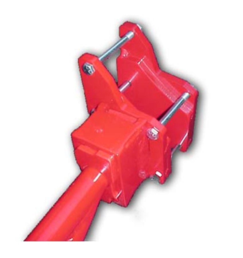

    This type of bar (URD)
    has no pivot point at the forward end of the bar and has a single pivot at the rear of the bar. Once again axle wrap will be reduced by half. This bar is designed for a X-Runner, a low profile 2WD street truck, and that type of truck has a rear suspension that has very little amount of travel and the axle is required to articulate very little at any given time.

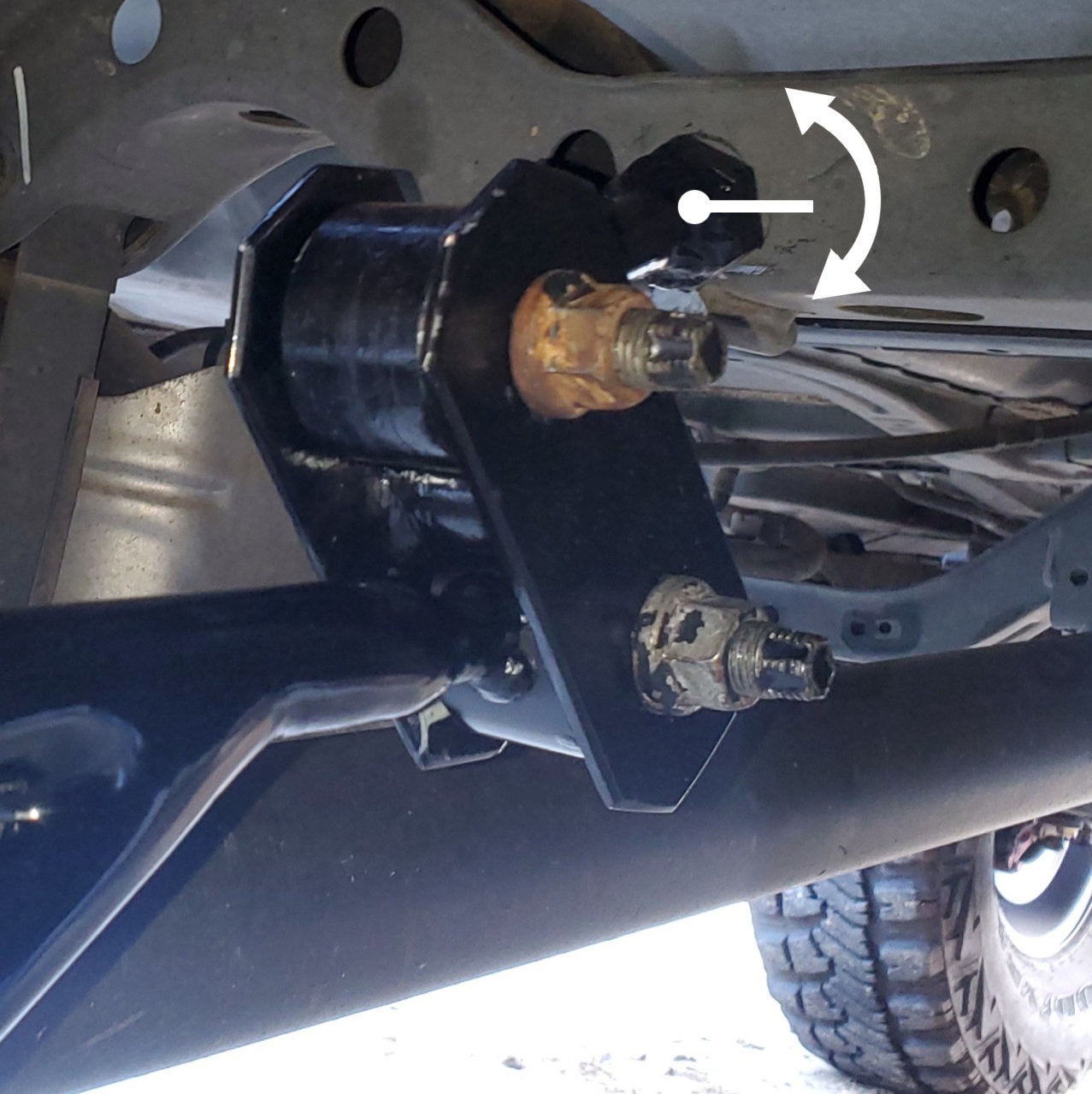

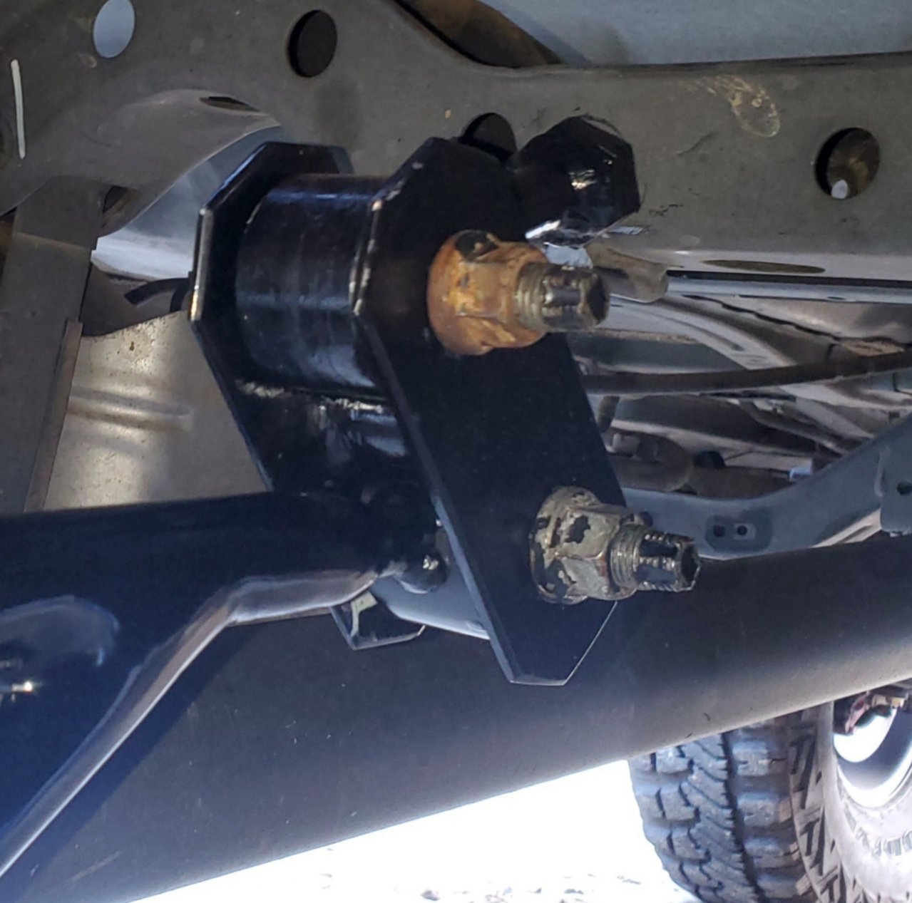

    The biggest difference between "my design" and BudBuilt's is the front mounting system. The BudBuilt uses heim joints to allow for axle articulation. Heim joints are solid with zero give, I chose to use rubber bushings because any solid pivot point will transfer vibrations. The front mounting point of my traction bar swivels 360*, not that 360* would ever be used, but this feature of my design completely stops the traction bar from limiting the axles amount of articulation.
    The basis for this swivel action is this 3/4" grade 8 bolt and nut which aren't completely tightened (I tightened the bolt and backed it off about 1/5 of a complete turn). The nut is shoved as far down into the crossmember as far as possible which keeps the nut from backing off of its bolt. There is also a 0.375" plate on the inside of the crossmember to add structural rigidity to the crossmember and to beef up that pivot point. I'm going to be adding more strength to that crossmember soon.
