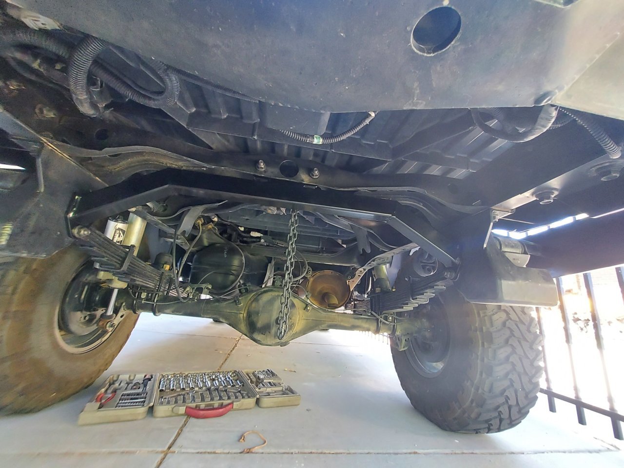

    Installed @ARCHIVE 's high clearance cross tube.
    Eric makes some awesome products.

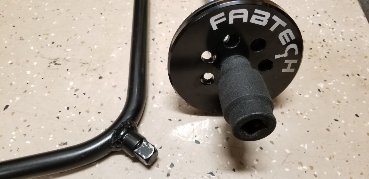

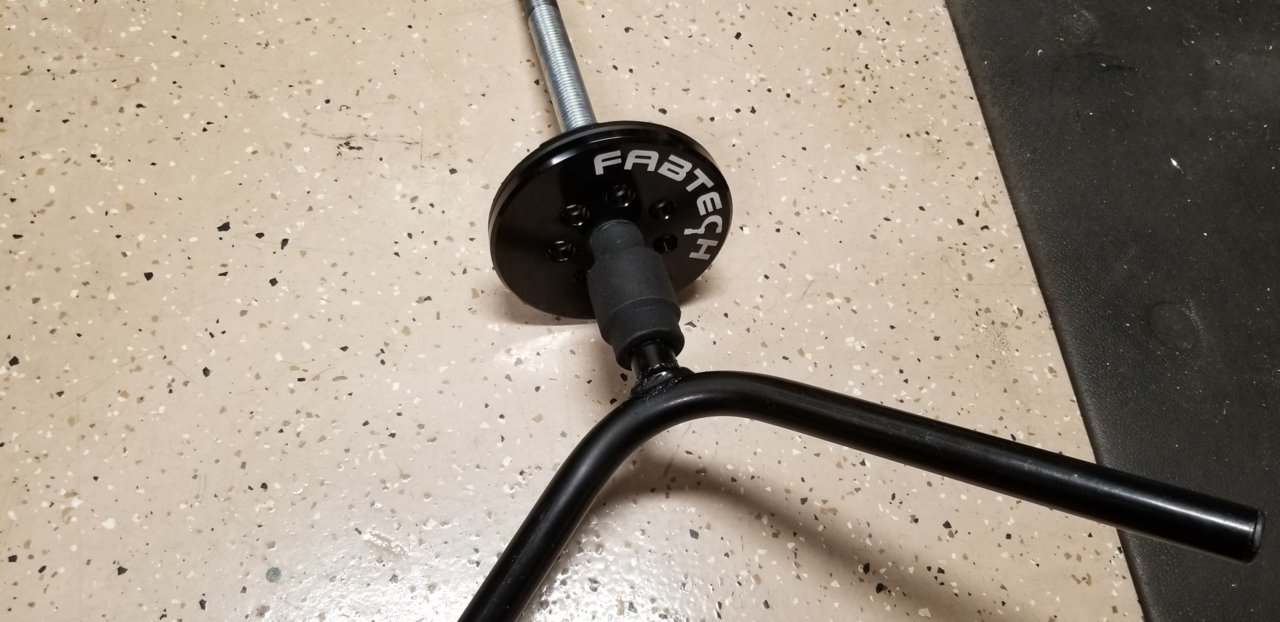

    I reconfigured the straps on the spare and changed the color. Also modified the Fabtech spare tire carrier hold down to make the bunny ears removable as I didn't like them sticking out. Basically I cut off the ears, welded in a 3/4" socket to the screw and welded in a 3/4" adapter to the bunny ears. Then went out for a swim.

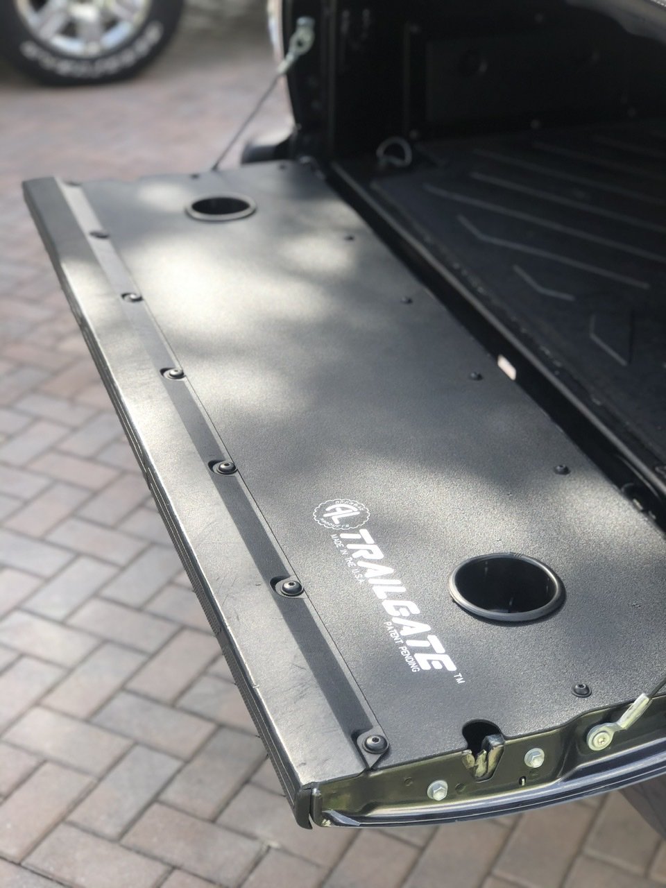

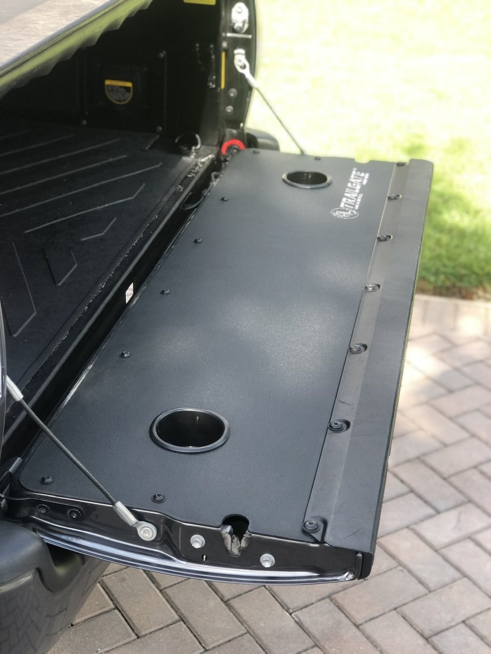

    Ordered this a month ago and finally arrived this week. Looks good and seems more solid than the stock. Great for the beach. Price seems a little steep but found a couple code so made it a more reasonable price. 5EC19E69-A57C-4150-A97C-CDC34FA7AA39.jpg1F9A6D0C-4837-4F98-94D6-783F20E65ABF.jpg
