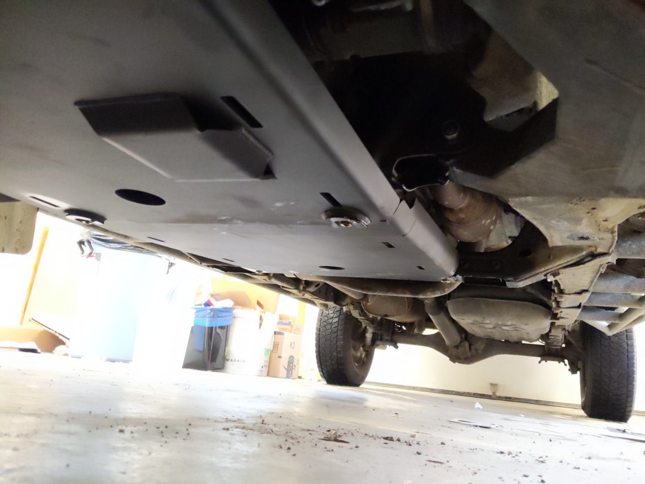

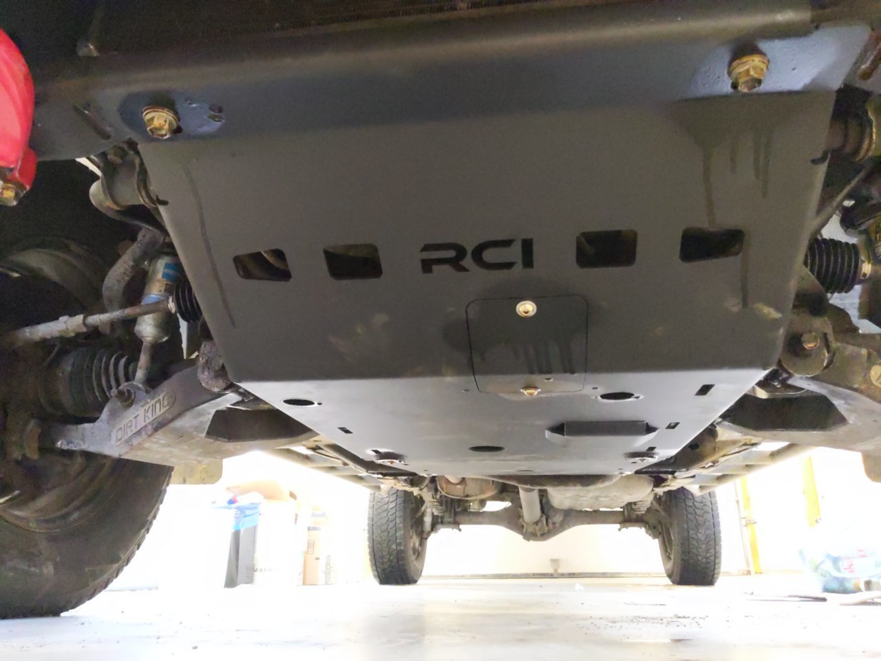

    RCI engine and Xmission skids in. A couple of the M12s on the factory front members took a righteous cheater bar to get out, but none rounded or snapped. They actually cleaned up shockingly well and were just fine to reuse after almost 13 years of Salt Hell.
    Was a hassle getting it in solo, crawling around on the garage floor, but doable. An offset ratcheting head 14mm wrench was invaluable to get the driver's side rear nut tightened for the xmission skid - it was able to reach over the crossmember and through the kink in the exhaust.
    Nev-r-seize on everything, Amsoil HDMP on all the cross member surfaces under the skids and on all the hardware heads.
    I have the Tcase skid and cross member (RCI's "full set"), but I'm going to be tearing the ass end out and doing some frame work in Spring anyway when it's warm enough to sandblast and paint outside, so I'll do it then.

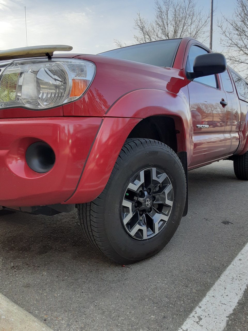

    Happy Groundhog Day! Costco Tire guys installed the Gen3 alloy wheels as a "winter tire swap" this morning for $49.96. I took in the wheels, new TPMS sensors (programmed by seller for 2008-2012 OBDII), and the new black standard length lug nuts. Mike said he went around the truck twice to set the TPMS reading (no additional charges). I like the look and the way it rides on slightly lighter wheels. The new Michelin Defender LTX MS 245/75R16 spare tire should be here in a week to install on the single alloy wheel to be hung under the bed... We replaced the original set of Dunlop tires last August at 19.5k miles. 20210907_170739[1].jpg 20220202_105921[1].jpg 20220202_105853[1].jpg

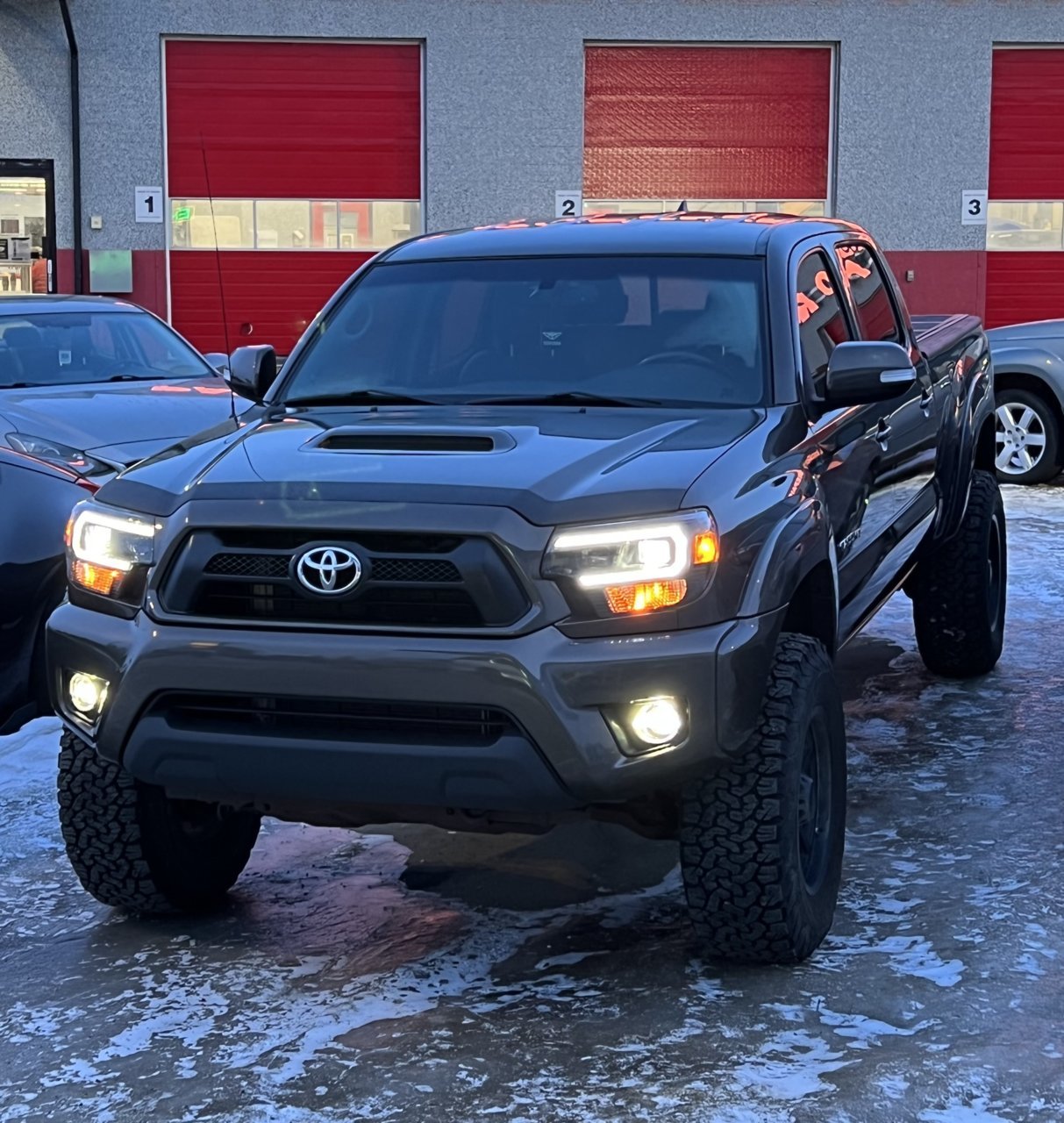

    Just upgraded to the Morimoto XB Hybrid LED headlights and matching fogs today Feb 2 ‘22 on my ‘12 pyrite mica taco. Huge upgrade over stocks. Night number 1 was a big success, could see everything!!!
    PacTac, Juniorbpd, Fixxxer and 11 others like this.

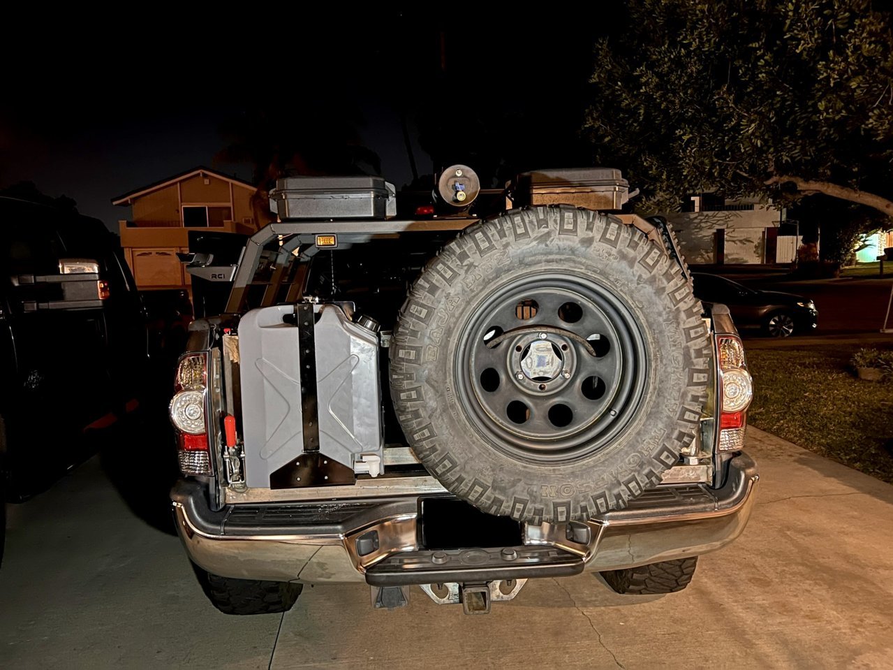

    Add the jerry can/water can holder to the tailgate swingout tonight. Almost complete, fold down table is next and then some paint!
