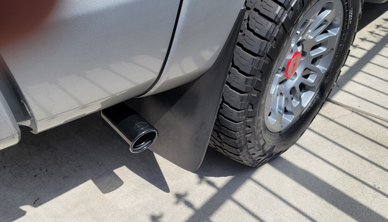

    New exhaust tip P/N: PT932-35180-02

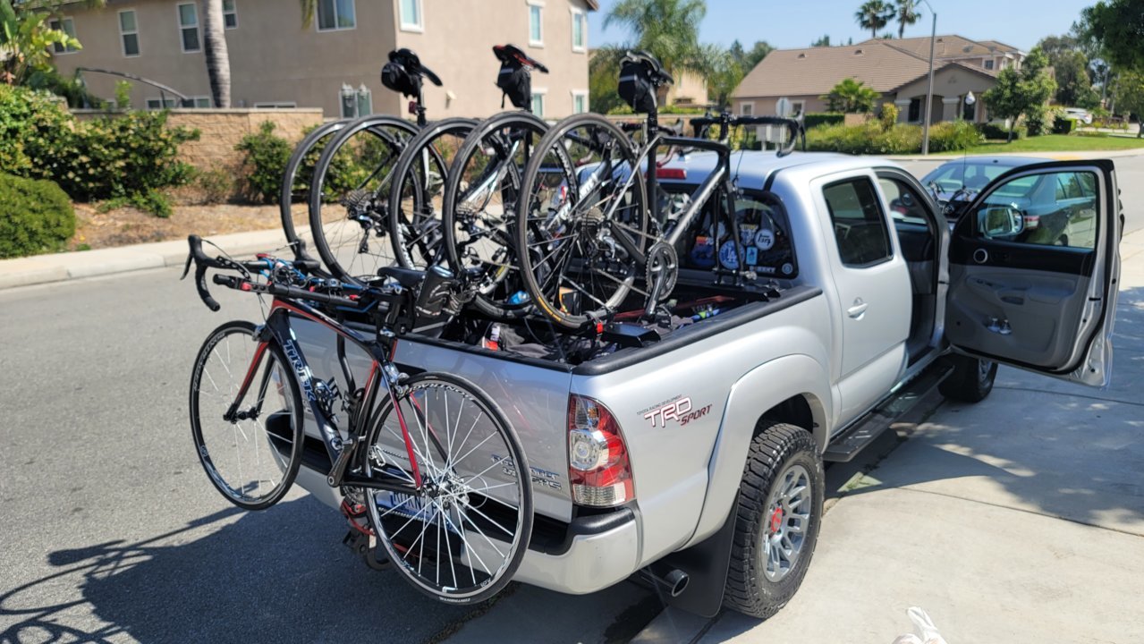

    New bike setup on the bed. Got to hit the pavement this summer.
    KB Voodoo cross bars, locking Rocky Mounts forks, Yakima rear wheel trays, and Delta front wheel holders.
    Leaves all the space in the bed for bags, gear, a cooler full of tasty beverages.2022-05-01 14.56.22.jpg

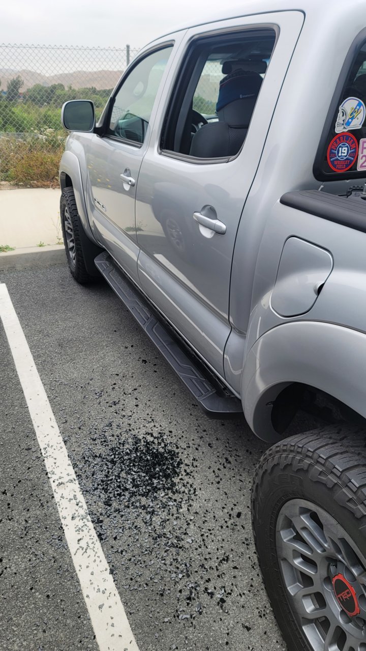

    One unwanted fix: New rear driver side window. Got my truck broken into while on a bike ride. (Sons of Bitches!! :mad:)

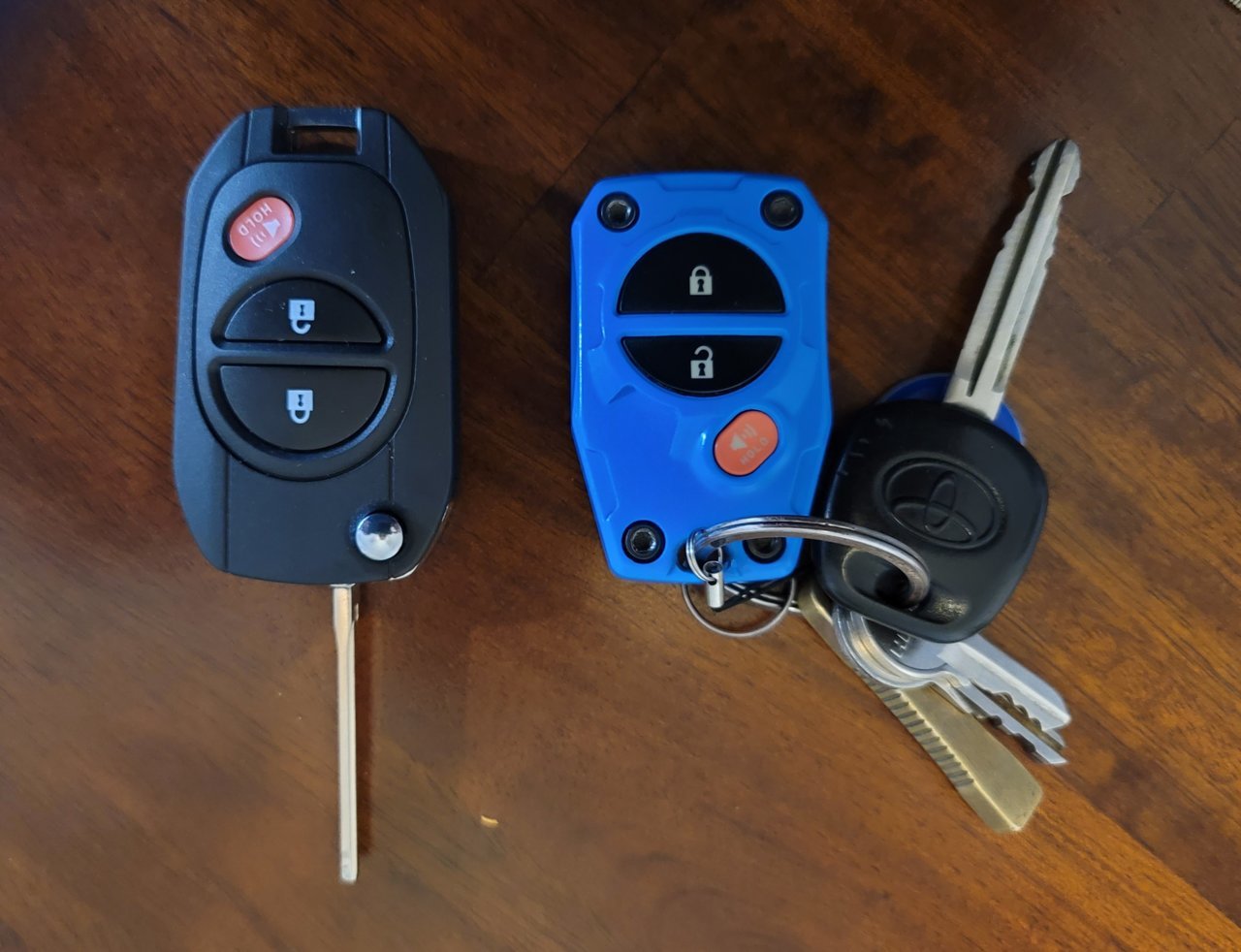

    Nice to see another fob case from AJT Designs! https://www.ajtdesign-llc.com/ I've dropped the snap-together style (once is) enough to grab this screw-back option quickly.

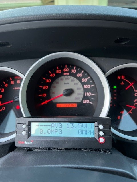

    Truck things
    Finally got around to buying a ScanGauge and I'm hopeful that having something telling me what my MPGs are in the moment will help get them up a bit. The other features on it seem super cool/helpful. Also check out the mileage, getting close to the 200k club!!

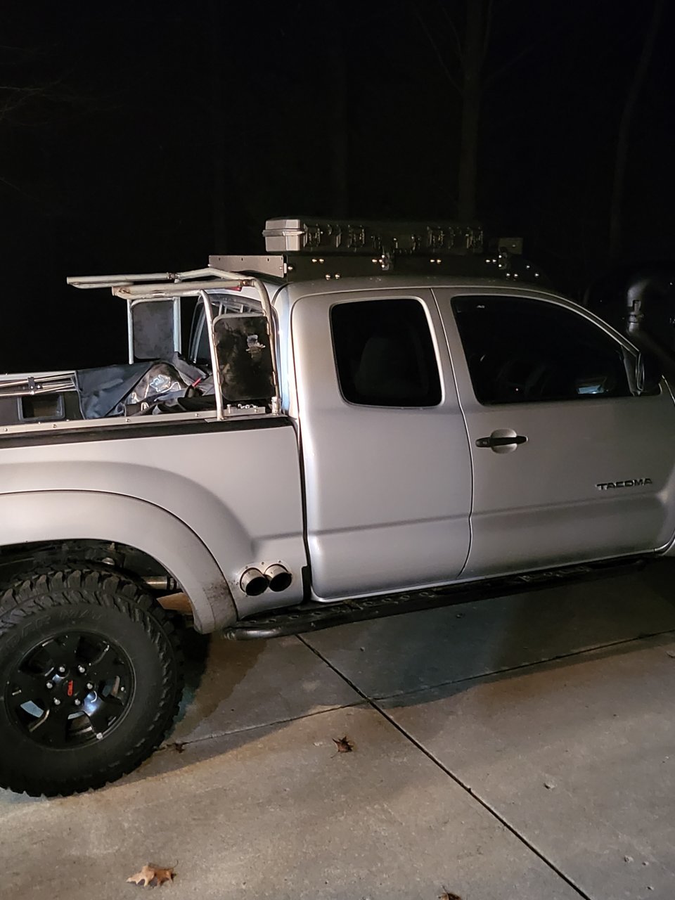

    Been working on a rack that allows the softopper to fold/unfold. It has a pair of hinges. Not quite finished yet. What to add a "box" that matches my roof rack and add secondary hinges that allow it to fold down, parallel to the rear window so i can still haul my dirt bike. But what do you all think so far? Any changes I should make?20220503_230743.jpg

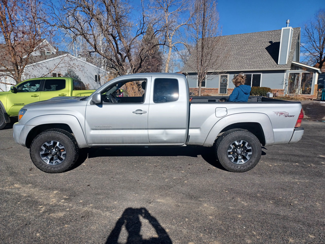

    A few, mainly added skids. I like leaving the suspension alone. I drive forest service dirt roafs in the desert west extremely extremely too fast. Toyota nailed this suspension going 65 across desert terrain. Changing it is dumb unless you have a specific need like crawling or mud.
    250 to fix this dent? It's set up for tomorrow.. he's going to drill a small access point in the flair or depth of the door.
    Thoughts?
    Anyone have experience with bad body work. Please.. pile on

    I had a dent (not as big or severe as yours) in the exact same location on my access cab, only it was the passenger side. Same deal where an access hole was drilled inside the door. I can't say w/certainty exactly how much I paid, but for some reason I wanna say it was around ~$75. Mind you this was back in 2008 and only a couple months after purchasing the truck brand new. :annoyed:

    Did it look good? I was fine with the price, but "clutch" is borderline family.. It works? People can pop that out? I've lived with it for 9 years!!!
    My son unhitched my 5700 pound sailboat. I should not.. have been towing.. as it slowly rolled forward 4 kids and 4 adults slowed it. That dent was all we got from towing a gigantic sailboat across America.. and one clutch.. we did burn out a clutch

    Looked great and can't even tell the door/panel was ever dented. There was some scuffing/scratching of the clear coat from the original cause of the dent (i.e. door ding), but that was easily buffed out.
    Are you actually taking your truck to an auto body shop who does PDR or just someone who does it on the side? The guy who did mine was kind of like a mobile PDR service type who traveled to the vehicle (or just bring it over to his place). My initial thought was $250 seems steep, but after taking another look at yours that probably isn't too far out of the ballpark for a dent/crease that size (although I'm sure as usual there'll be some tosser on here saying they could get it done for $25).

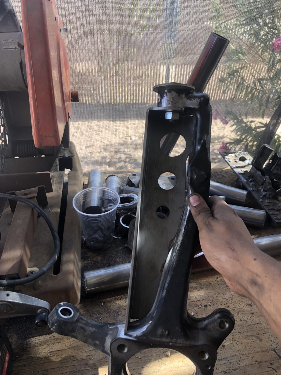

    What am I looking at?
  16. May 4, 2022 at 7:01 AM
    BadDNA
    BadDNA Uh, huh huh... Member
    Apr 15, 2015
    #153223
    4,811
    Eammon
    Cabot, VT
    '15 Blue Ribbon Metallic DCLB SR5 4x4
    OME BP-51s, JBA UCAs, Dakar leaf pack, Hammer Hangers, SOS Skids and sliders, Mobtown Tailgate reinforcement, Bussman fuse block, and stuff...
    A (soon to be) gusseted spindle.

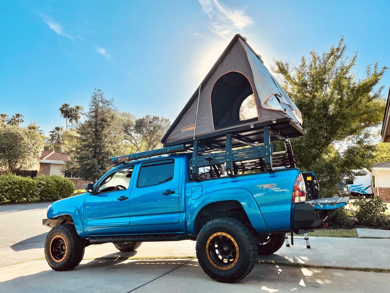

    Turndown exhaust installed and mounted on the RTT for camping szn.

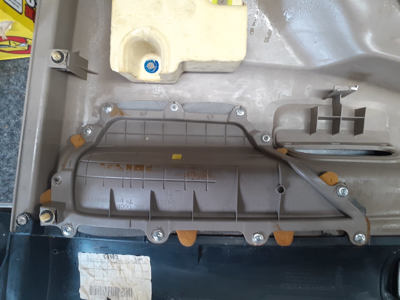

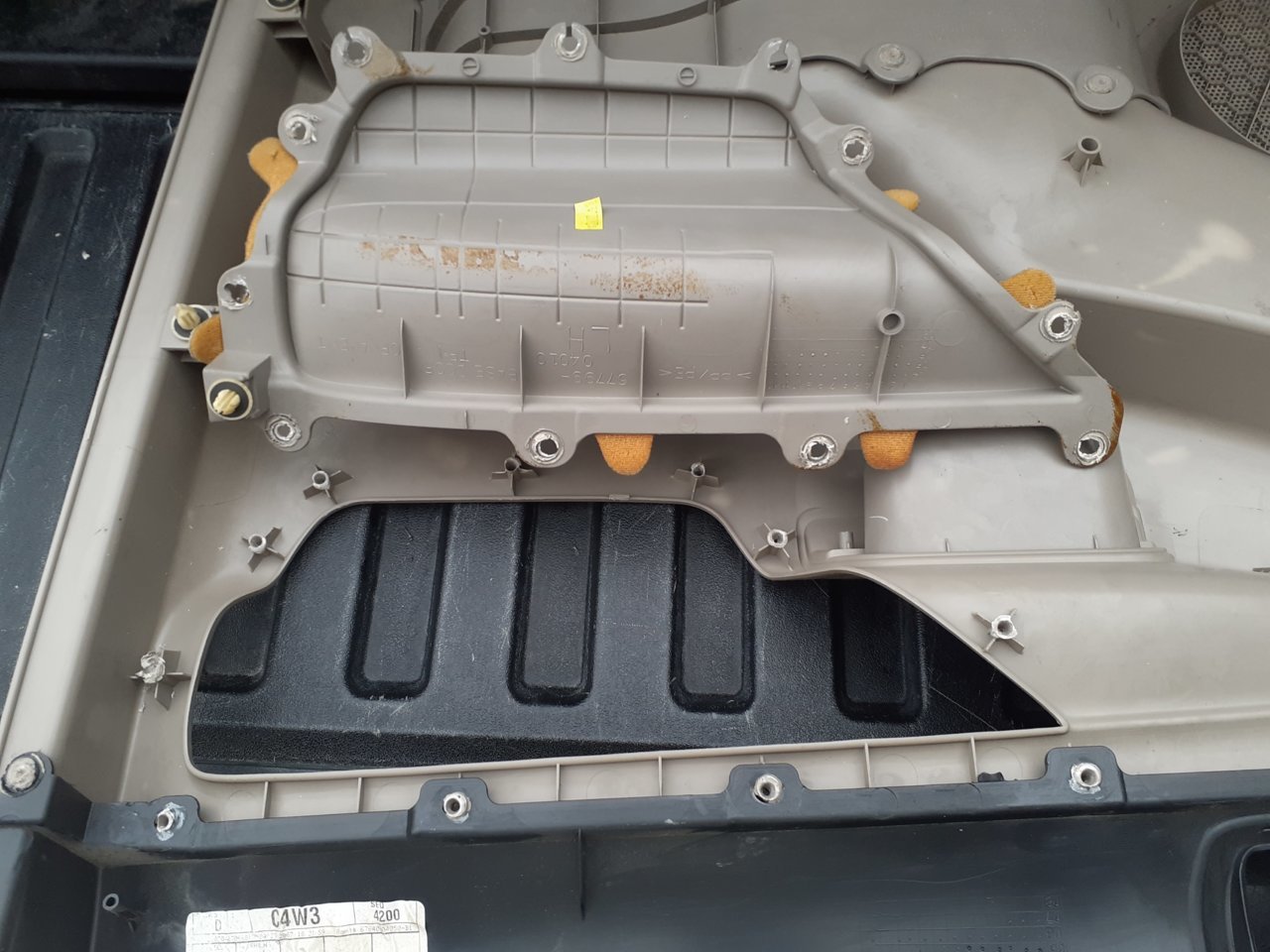

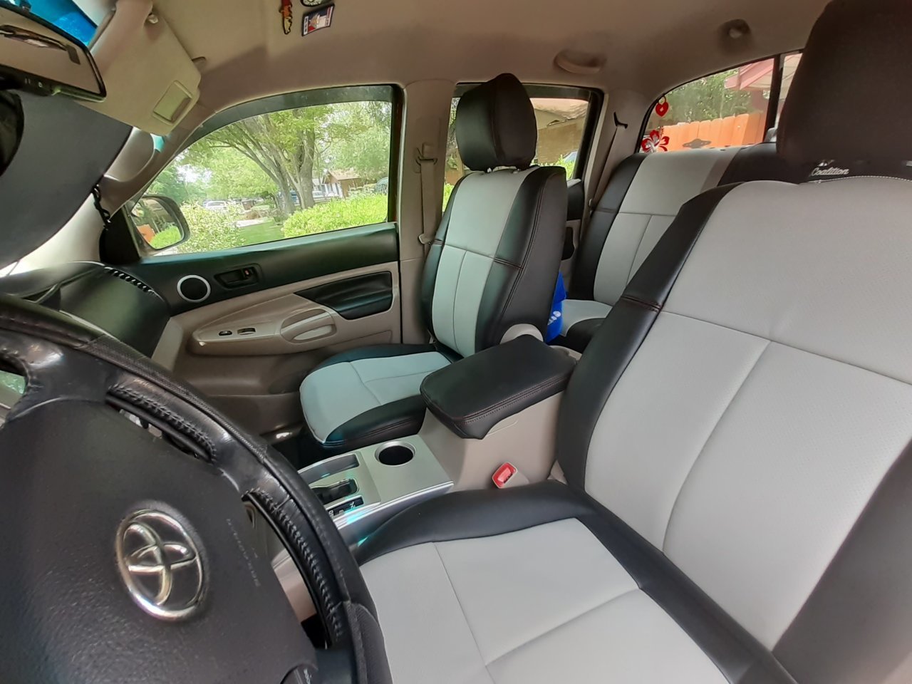

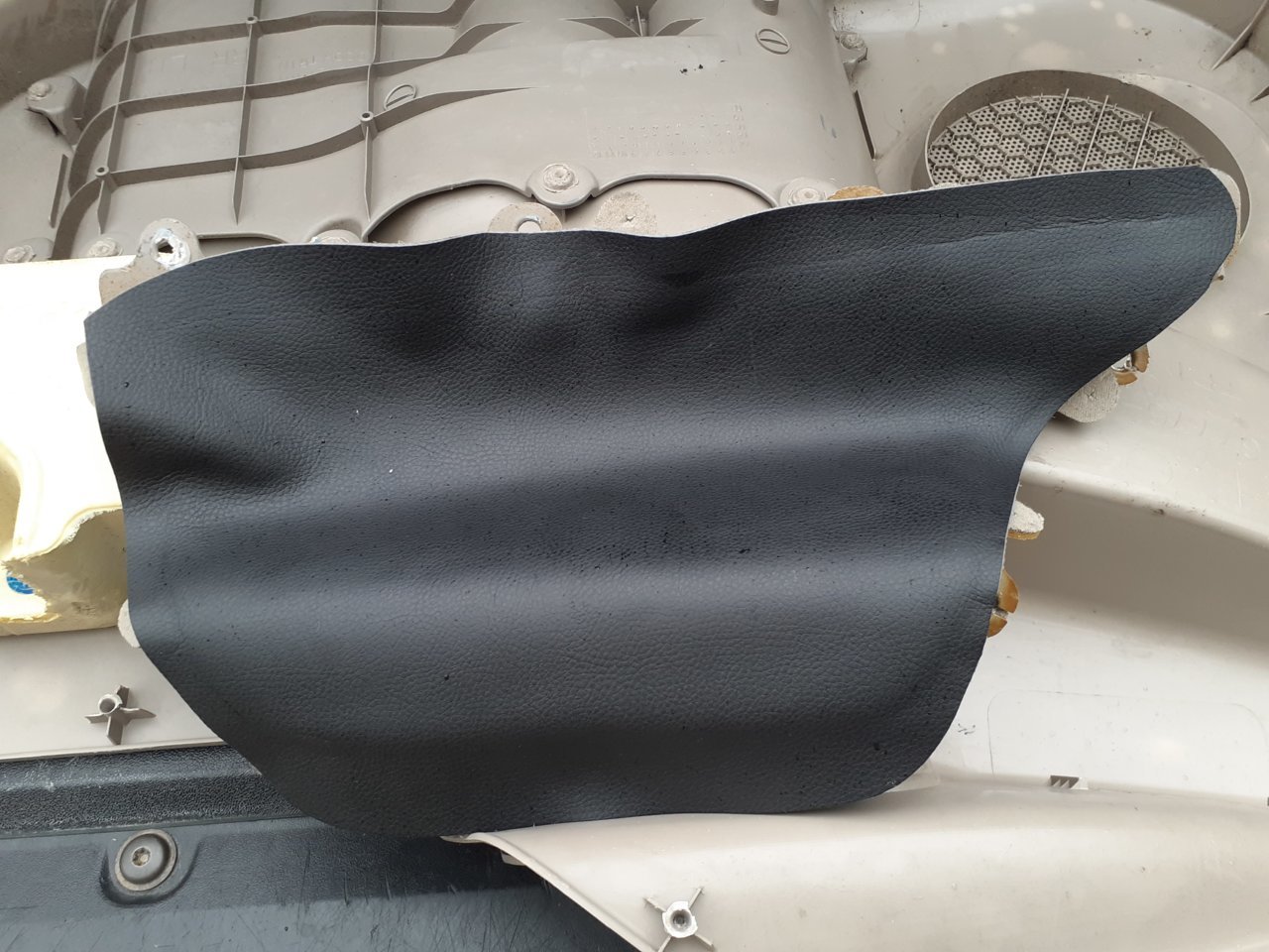

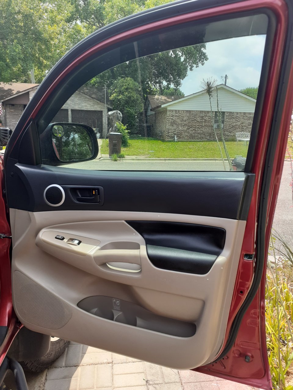

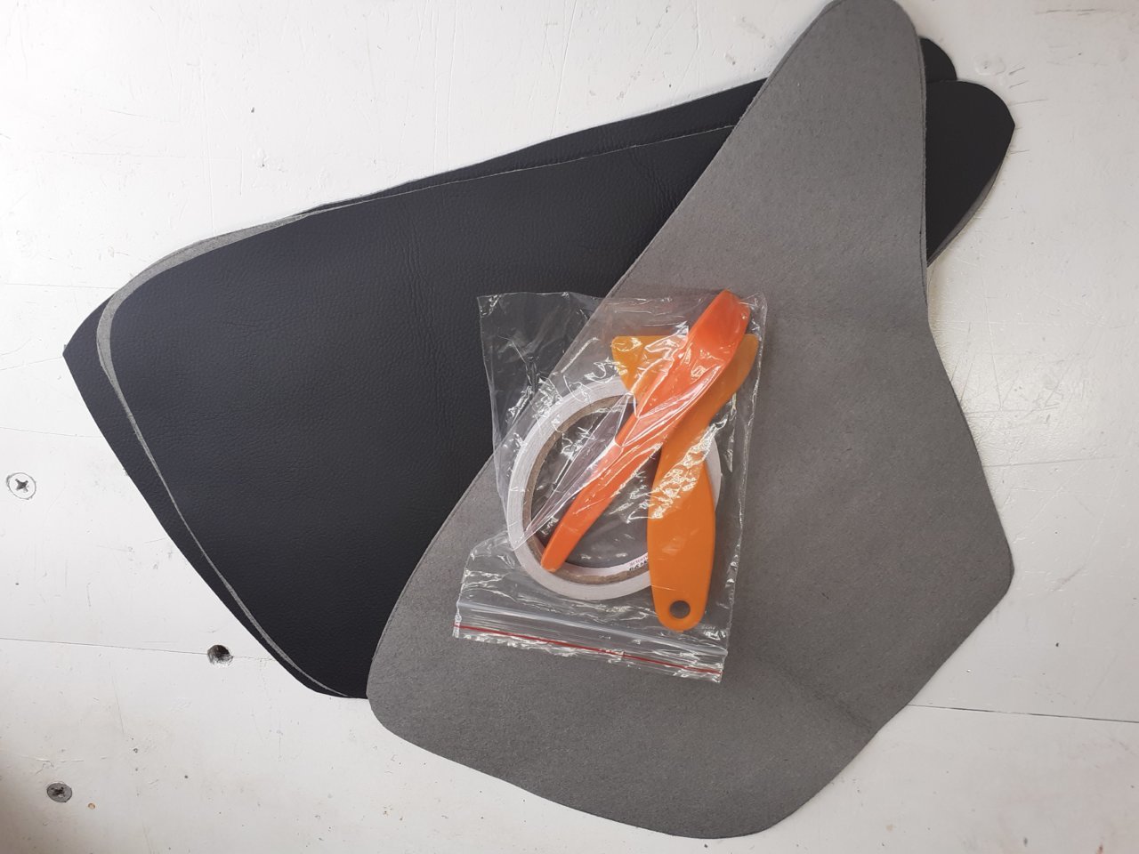

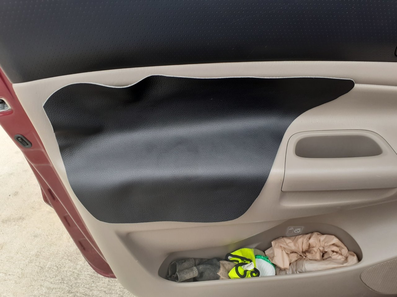

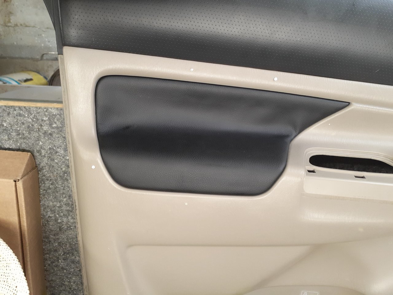

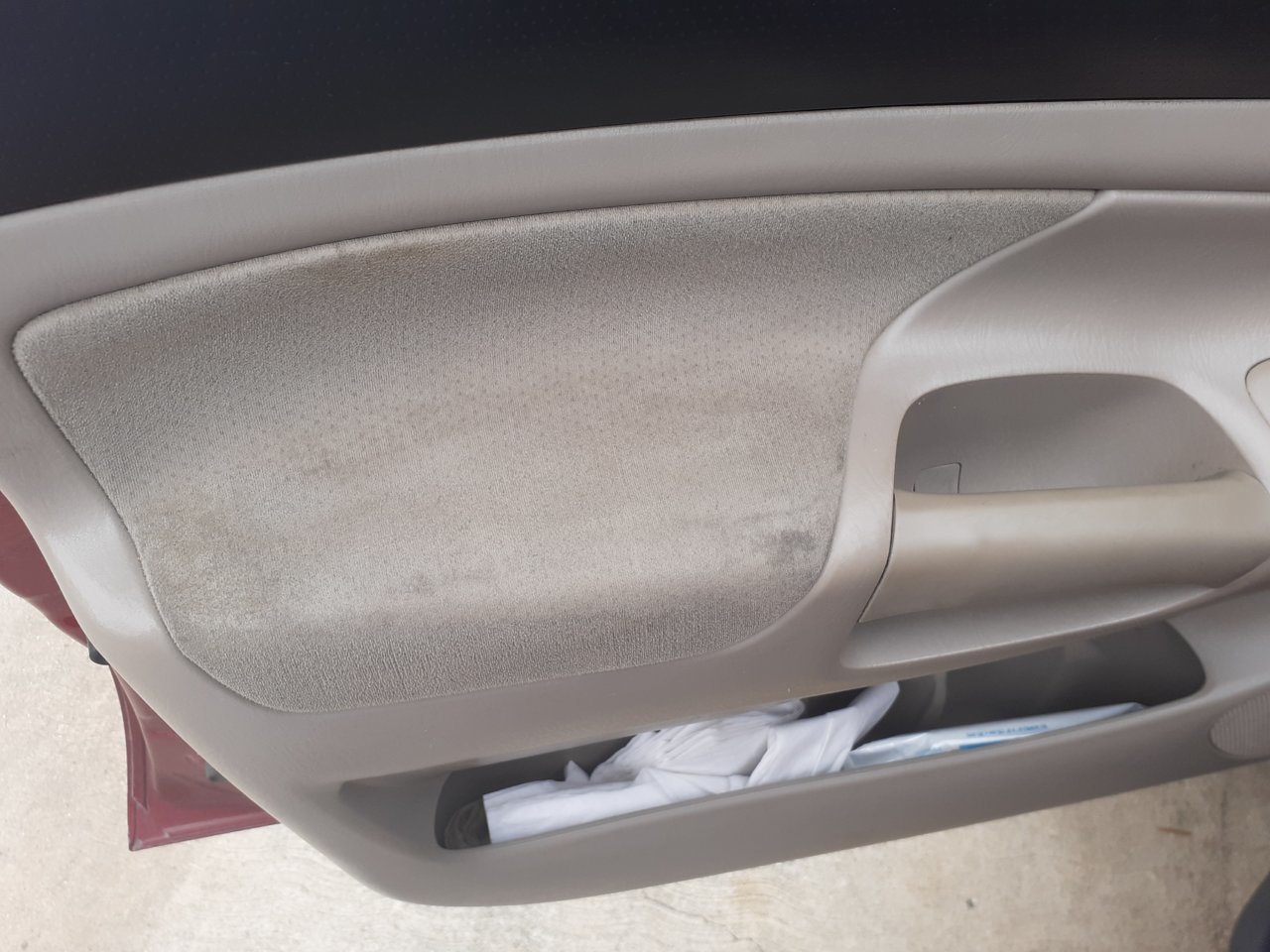

    Might as well finish the project....
    "It easy" they said. "Just use our tools you like, and it just go under old with push. Easy you install!"
    OK, so if you Google THIS particular thing, you will find very little, except a TW from @GHOST SHIP , so, props to you sir!
    So, why? After all this work? That's as clean as this old stuff will get. Sick of it.

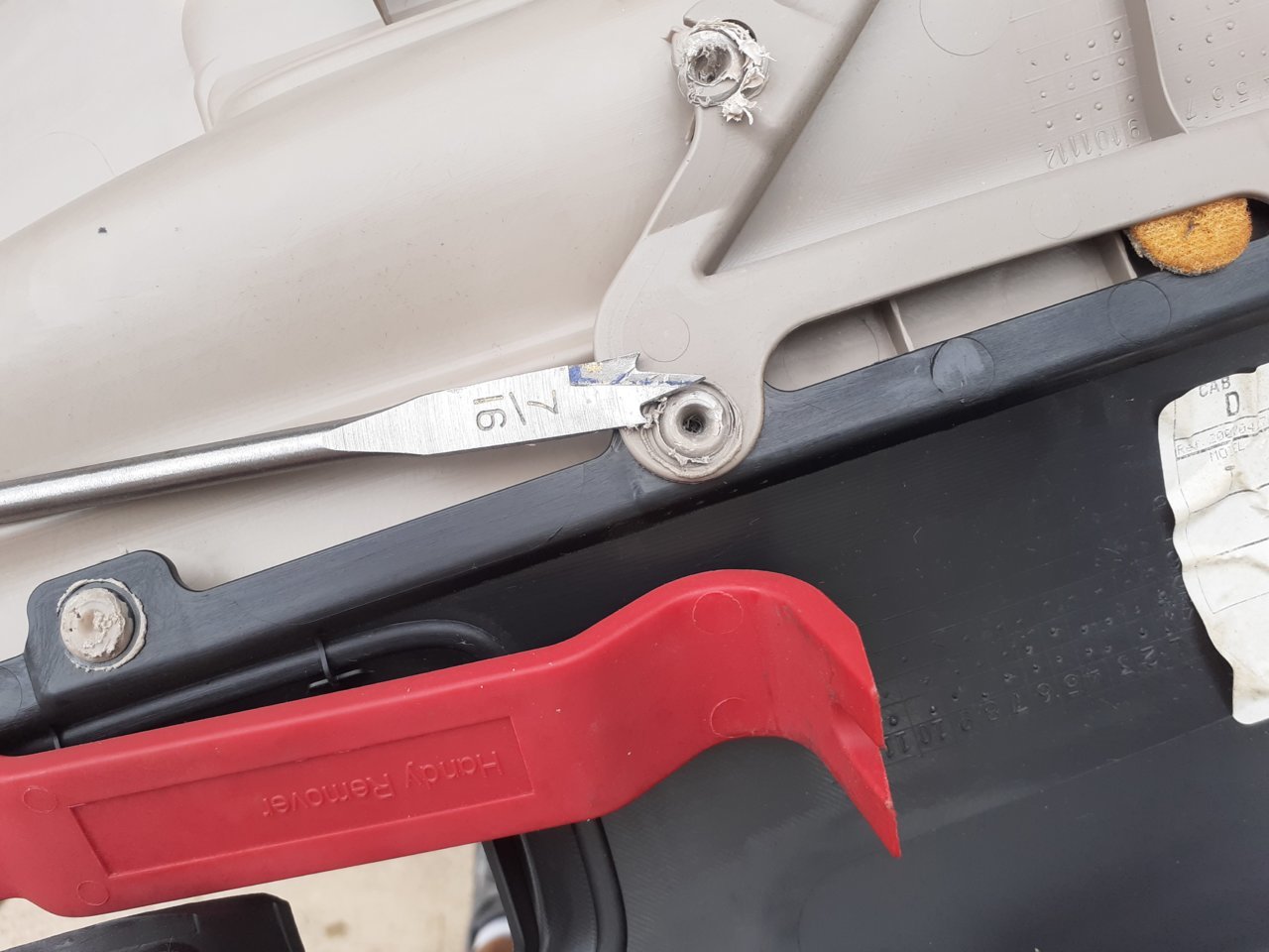

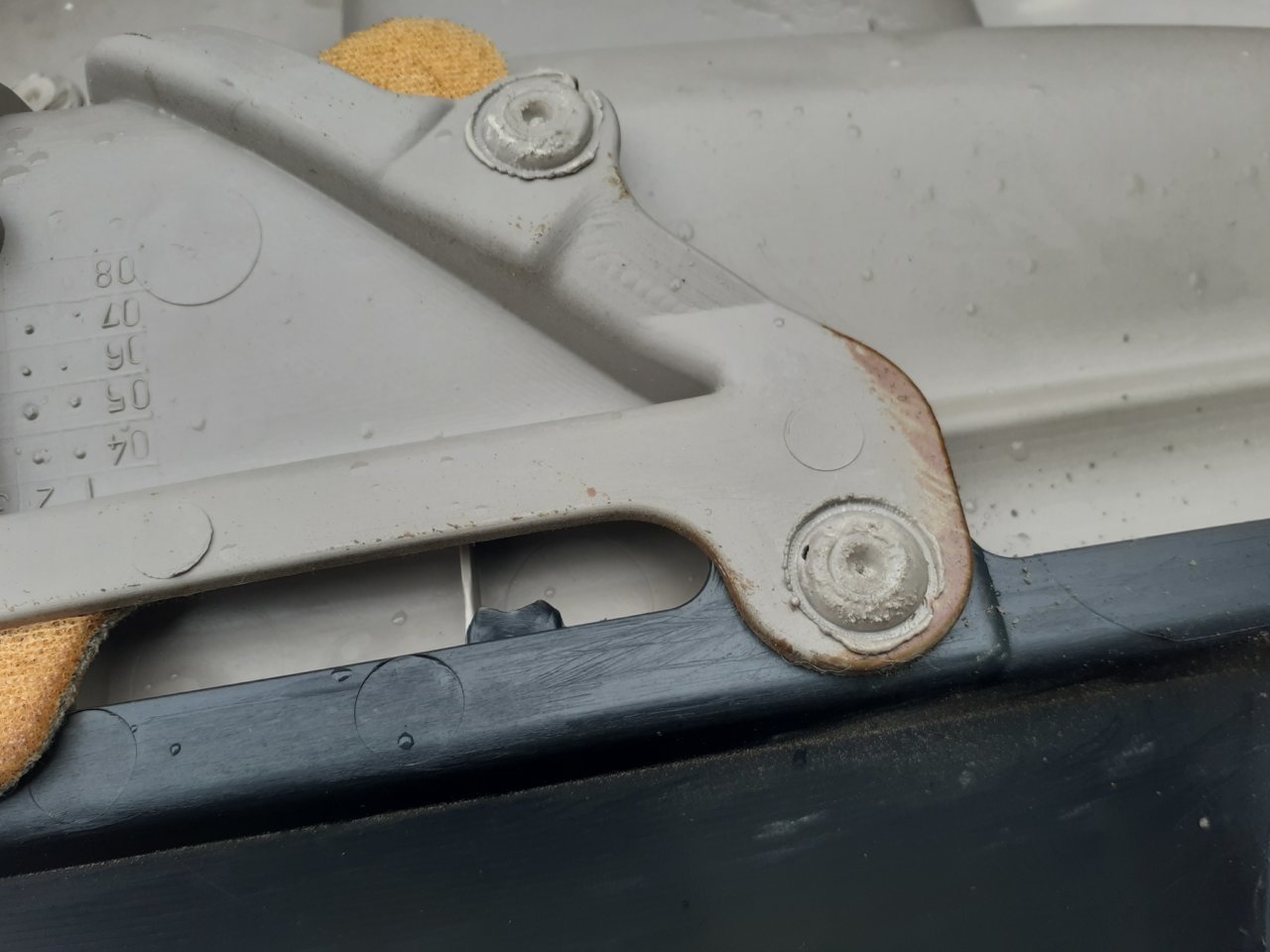

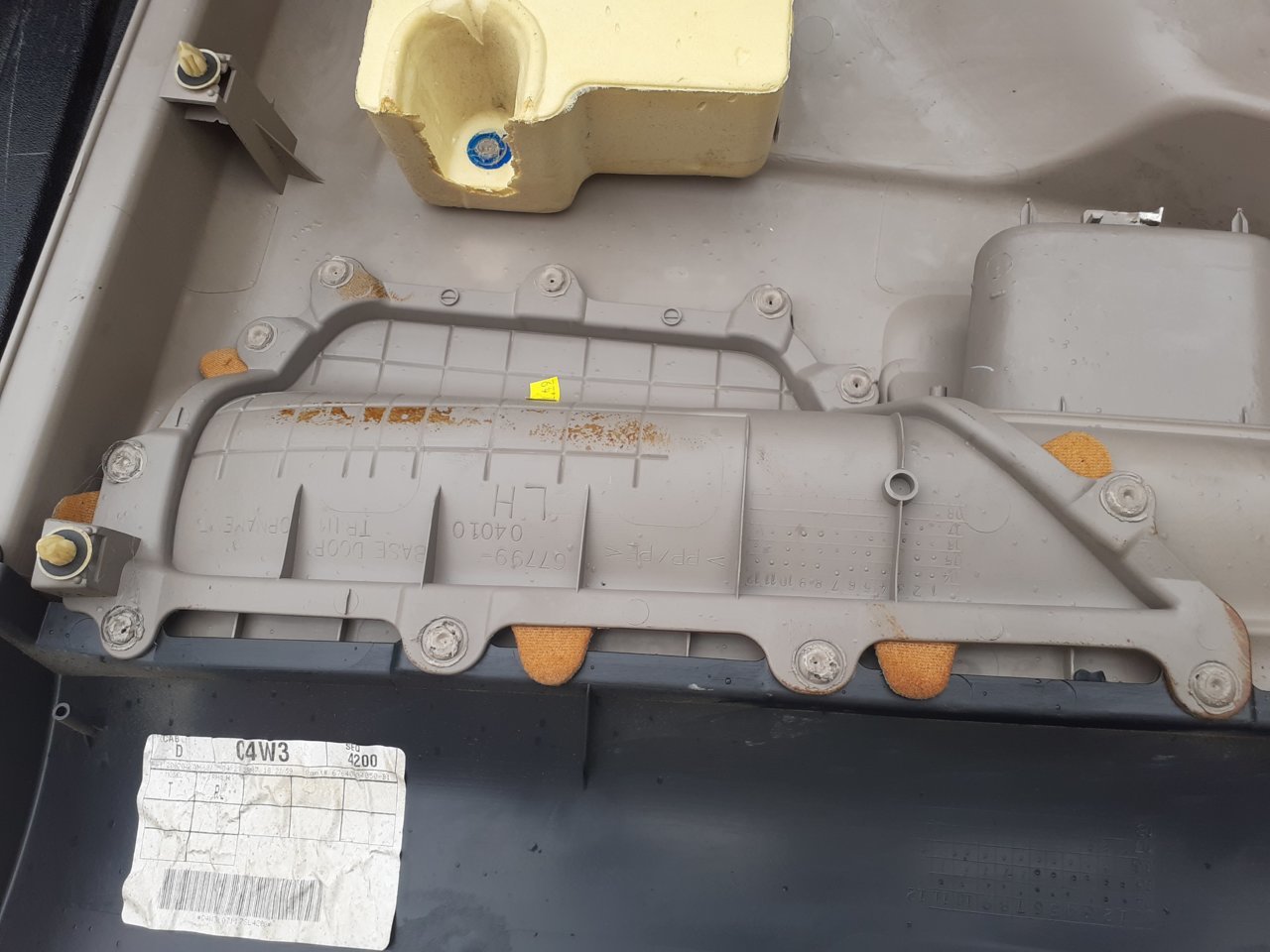

    You are NOT tucking stuff into old inserts. No matter the trim tool, not happening. So, you take off the door panels, AND,
    That's right. The panel is heat staked in place. He used a 3/8" Speed bit - I used a 7/16" after trying the 3/8". He had important words....PATIENCE, PATIENCE, PATIENCE.
    You will bork at least one on each attempt. Not to worry, they are not all needed for support.

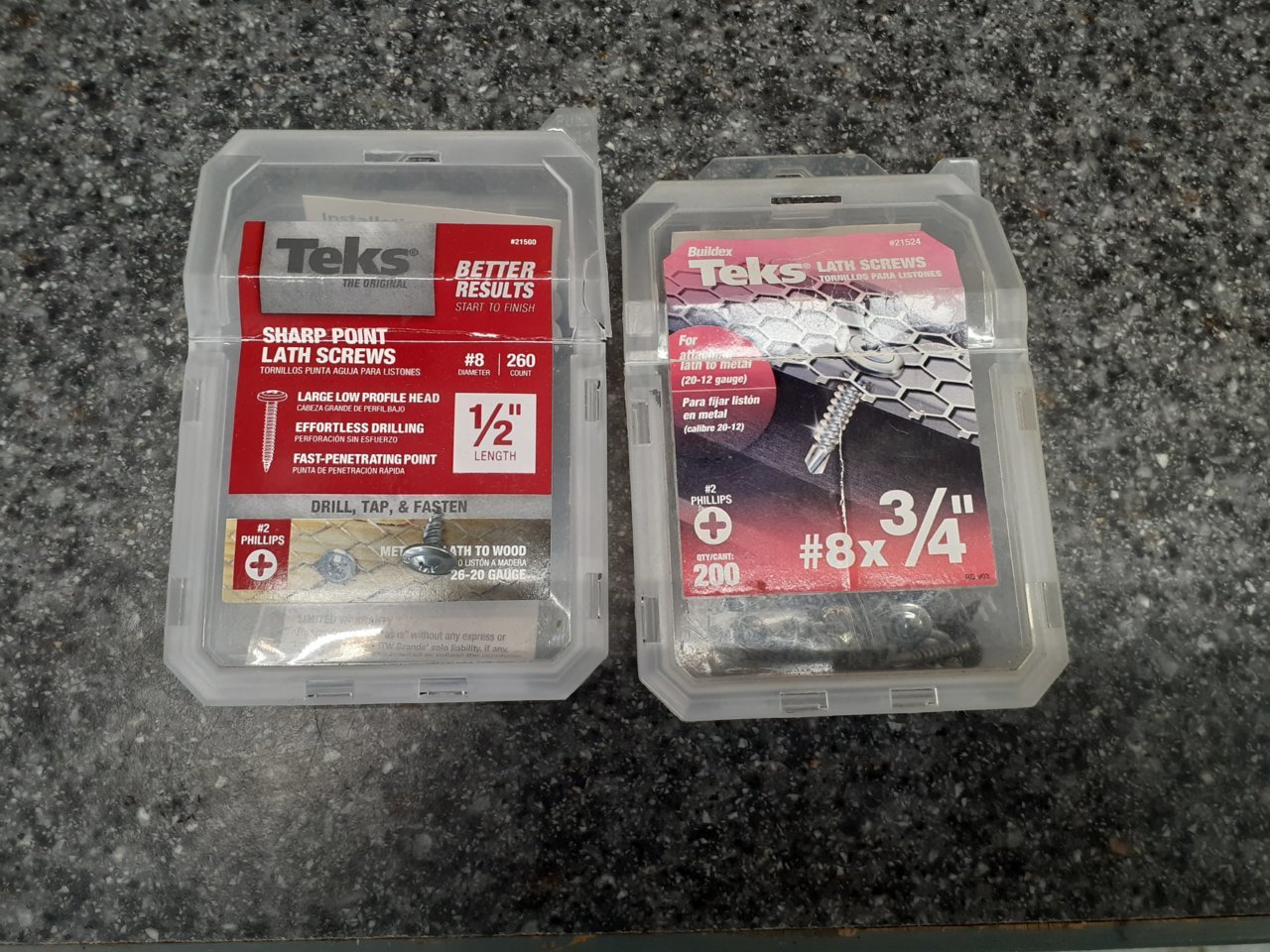

    After cleaning, I used a #8 screw. 1/2" to start, 3/4" at worst. But. PATIENCE AND CHECK AS YOU GO. I tipped through in a few spots, but, not really visible at a couple feet. And, that happened with 1/2"! The BEST screw is #6, 1/2" tops' because you can easily max out the stakes. JUST DO IT GENTLY, CHECK EACH PROGRESS. Use some double sided tape to hold the insert in position, fasten a couple screws, and turn over and smooth as you go.
    Aaaaaand repeat 3 more times. Sorry for the detail, my mind is on my Digest feed! SO, what do we get?
    And you know why I do all this? Because it's LBR's 15'th Birthday!!! :taco::kona::dancingbacon::broccoli::dancingbacon::kona::taco:
