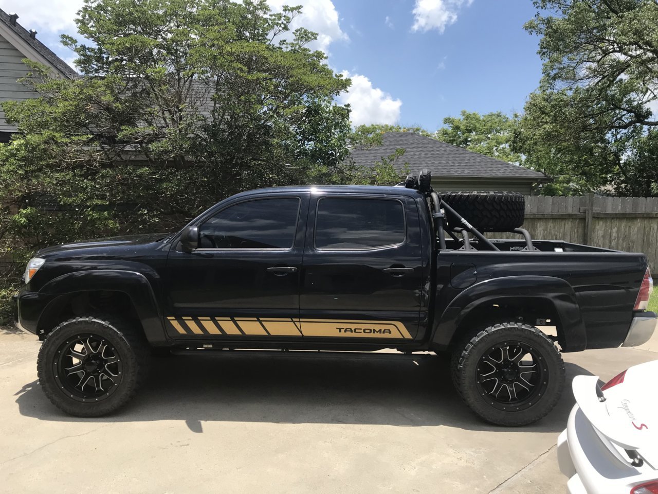

    The black with gold wheels looks awesome!

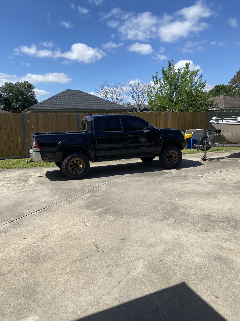

    After I got the vinyl peeled off, I started with Goo-Gone then went with WD-40 to remove as much adhesive as possible. I then rinsed with water and used polishing compound to remove the rest, then some spray wax. Doors and tailgate are next.

    100% on the debadged/de-decaled look. Especially the 2nd gen's. The bed and tailgate have some nice lines. You really see them when all that other stuff is gone.

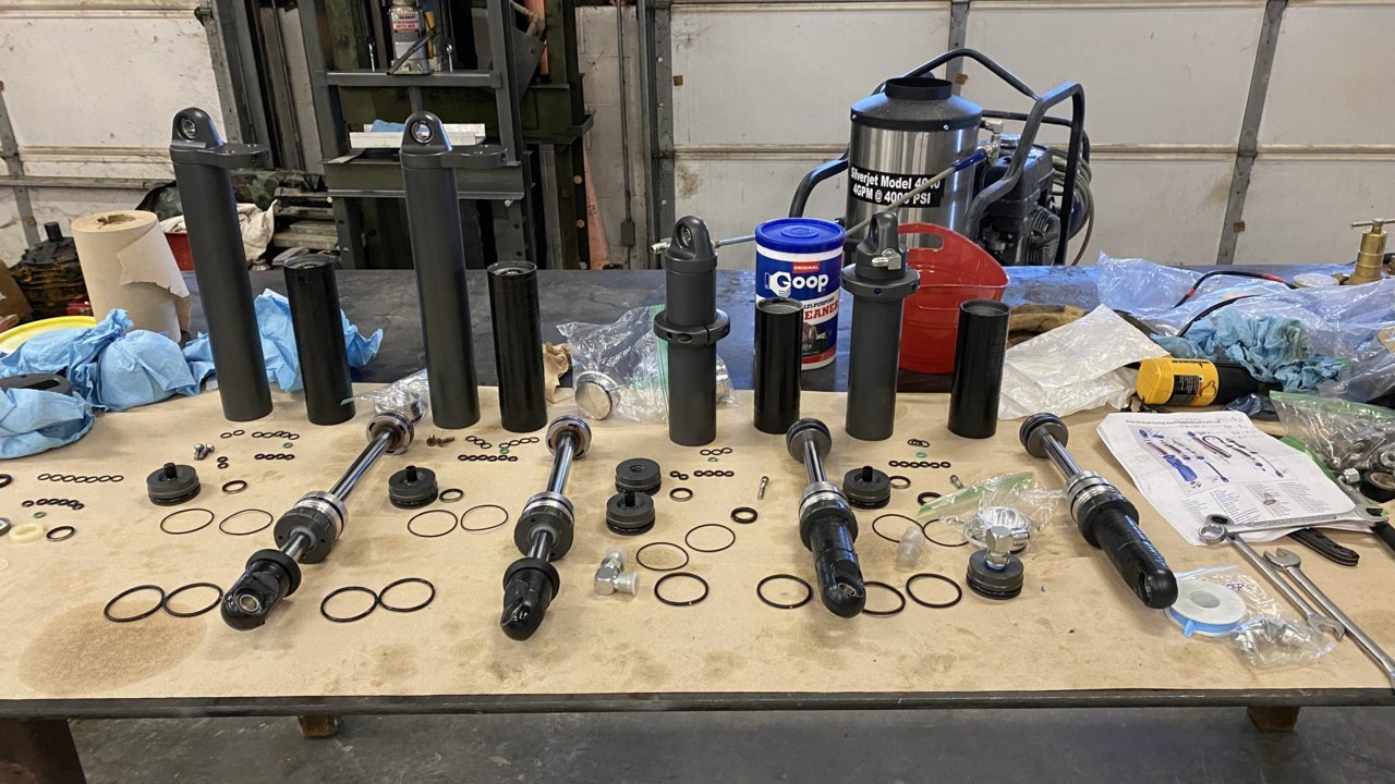

    Well this has been a process ( 1st time tearing down a shock myself) but made some good headway last night. 31E277F7-545D-4E15-B44E-A8AC7CD53E27.jpg

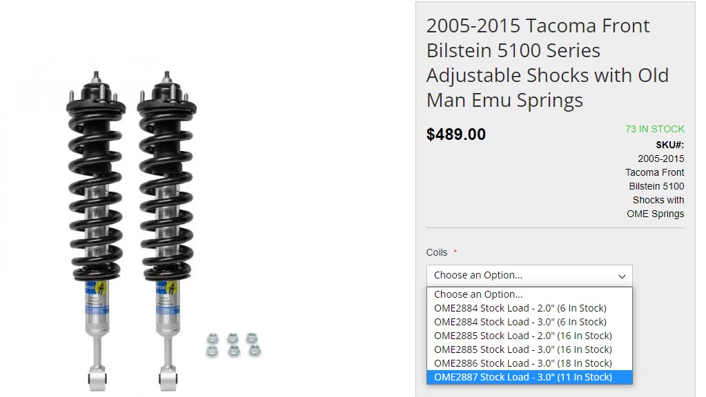

    Good to know. Nice to see that you are getting at least 3" with your 887 on the lowest clip. Still confused how they came to the conclusion that an 887 set on the lowest clip would give only 2" of lift while set on the third clip up is 3". I emailed again and asked how they decided that, and asked why they were the only ones who think its ok to put Old Man Emu Springs on a perch above the lowest one. Also reached out to them through DM on TW, have yet to hear back from them in either case. It took them over a week to respond to my first email so I'm not expecting another response for a few days.
    Their response to my first email was:
    "Hello,
    That is the clip option you ordered.
    For a 3” lift, you have to adjust the clips, otherwise it would only be the 2”.
    You were shipped what you ordered."
    but their only option for an 887 on a 5100 for a 2nd gen is 3"... there is no other option on their dropdown on their site, so I thought it was safe to assume it was on the lowest perch.

    yeah there aren't clip options when ordering online through them.... because OMEs are supposed to stay on the bottom clip no matter which spring you order. I am surprised that's their response they should definitely know that.
