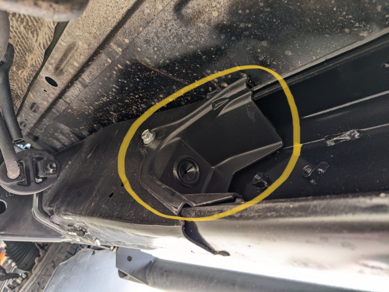

    I got the same things on mine when I had to treated. Its to prevent more water and such from going up into the front of the frame where they have had issues. I actually had to remove mine to bolt on my rock sliders. I don't know how much good they would do, I think they would trap more in there then anything its not like they are sealed tight.

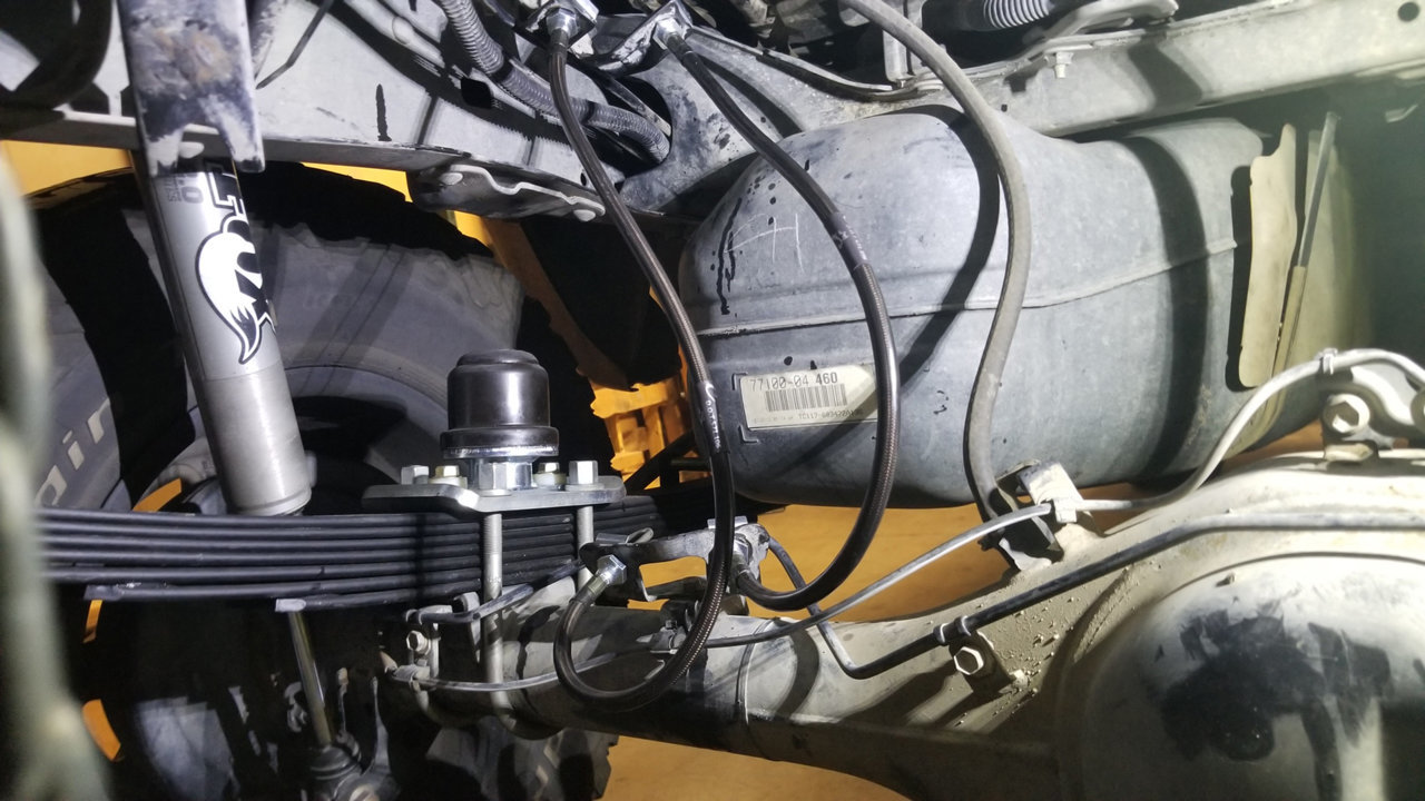

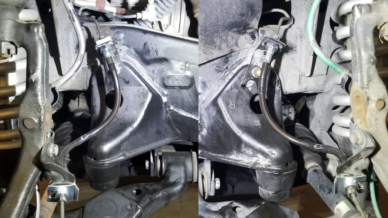

    Installed Crown extended steel-braided lines on all four corners this morning.

    Were you able to bleed them like normal? I’ve got brake lines I haven’t installed because I read somewhere you have to open the abs with a Techstream

    Invoice says plug hole kit. I guess that's what it is. Once I get a chance I'm going to hit with some fluid film.

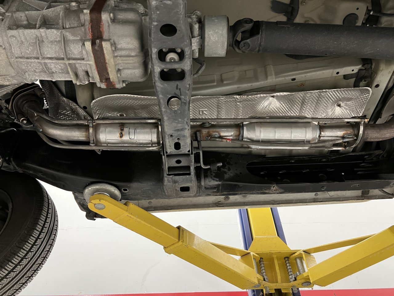

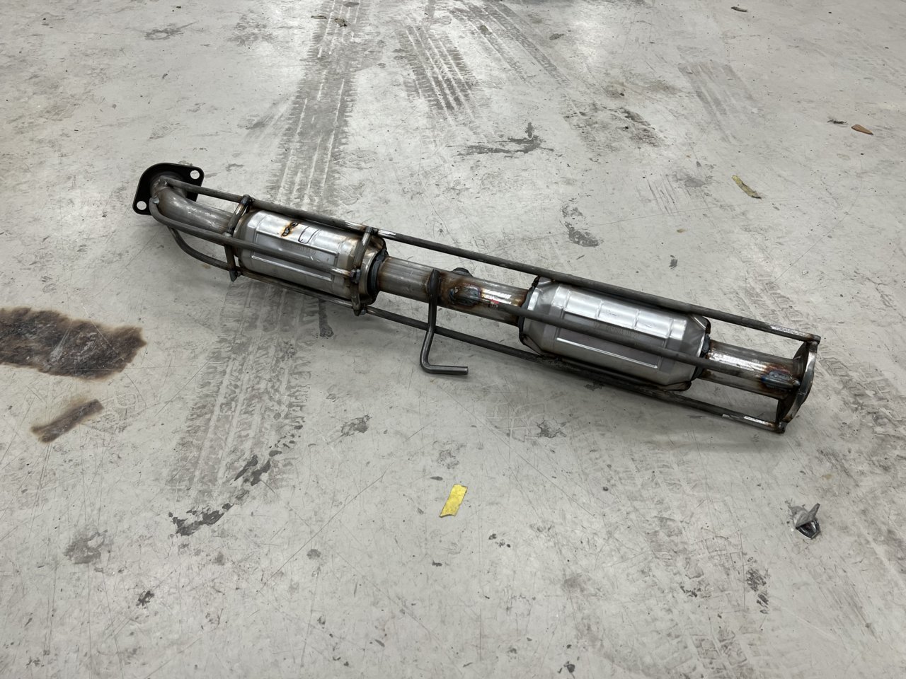

    Got a new cat and a friend of mine slapped a cage on it after some asshole stole the original cat off my truck last week.
    I’m still pissed off about it, seriously some people.

    When I took mine in for frame inspection, they added those and then filled the front end of the frame with foam. The little hole in the middle is where they pump the foam sealant in.

    Yep! Bled them like normal starting farthest from the master cylinder with help from a buddy pumping/flooring the brake pedal.
    I went through Headstrong for mine. https://www.headstrongoffroad.com/s...SS_Front_Brake_Lines_(PAIR)_-_05__Tacoma.html
