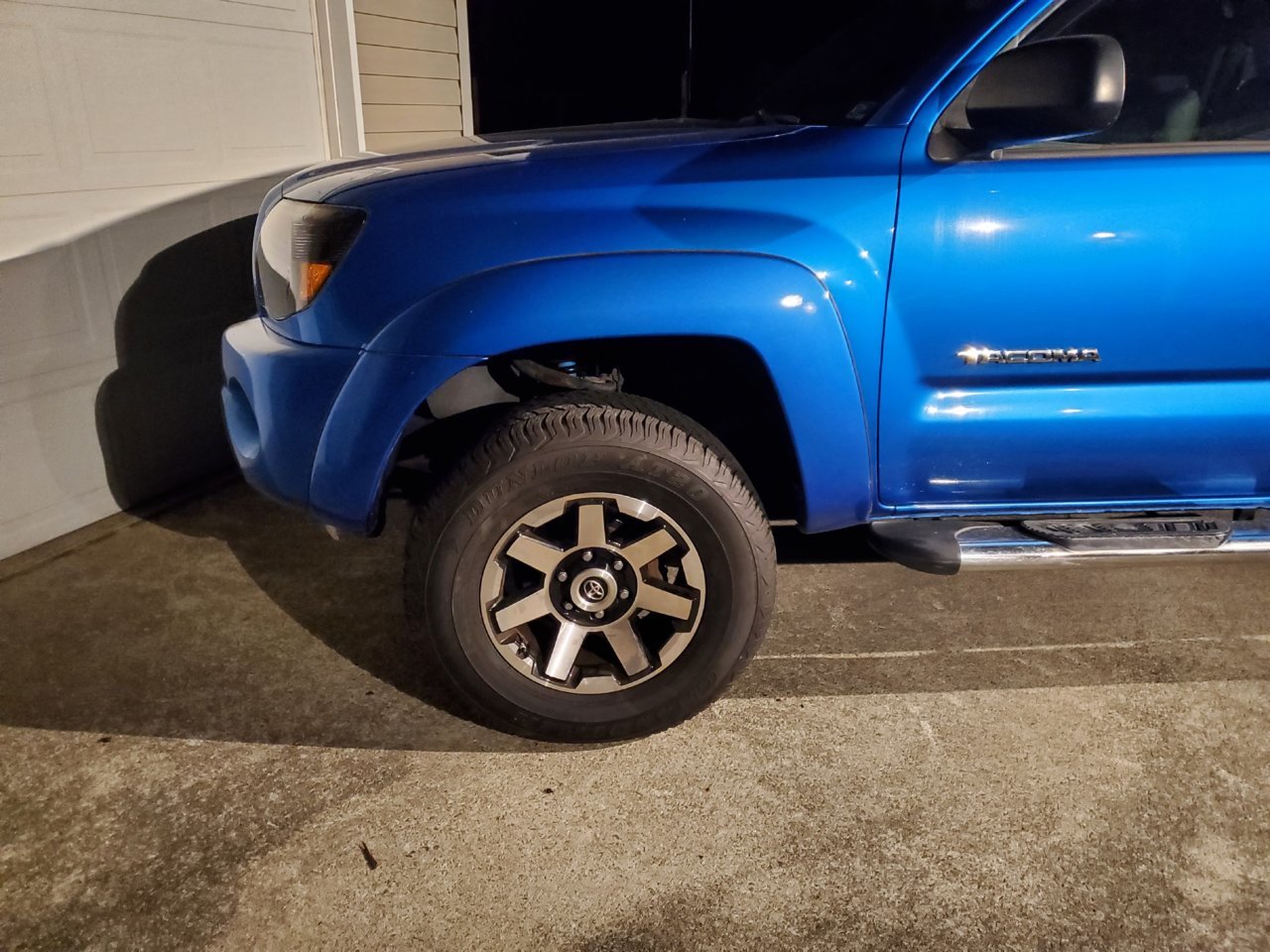

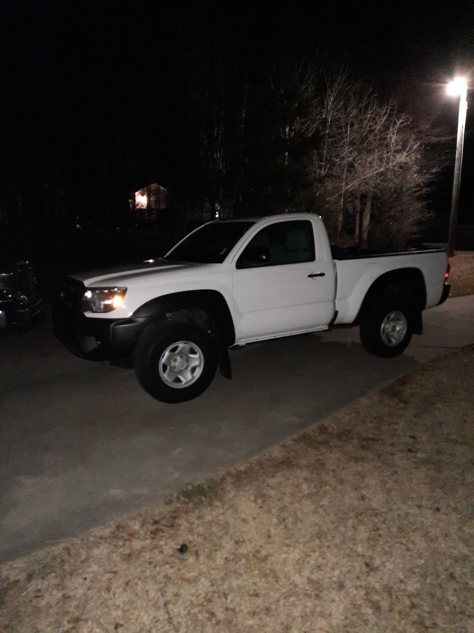

    You using these wheels ? Painting or dipping them ?

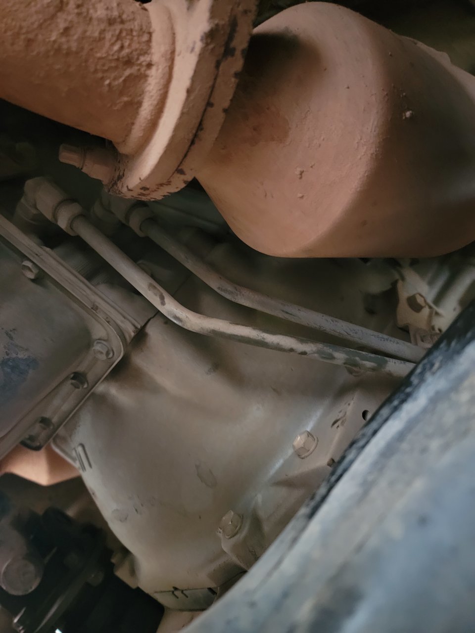

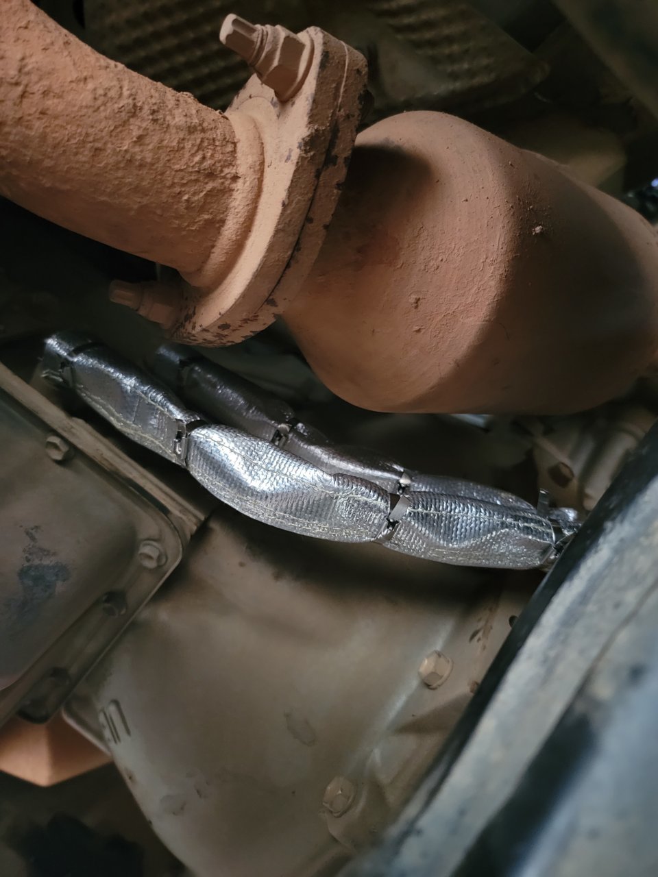

    Added some heat shield to my transmission cooler line since it was so close to my cat

    Those are what I'm going with.

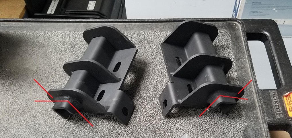

    What exactly did you have to grind? I have the usoffroad and want reinforcements but I know most dont fit natively on the usoffroad without modification.

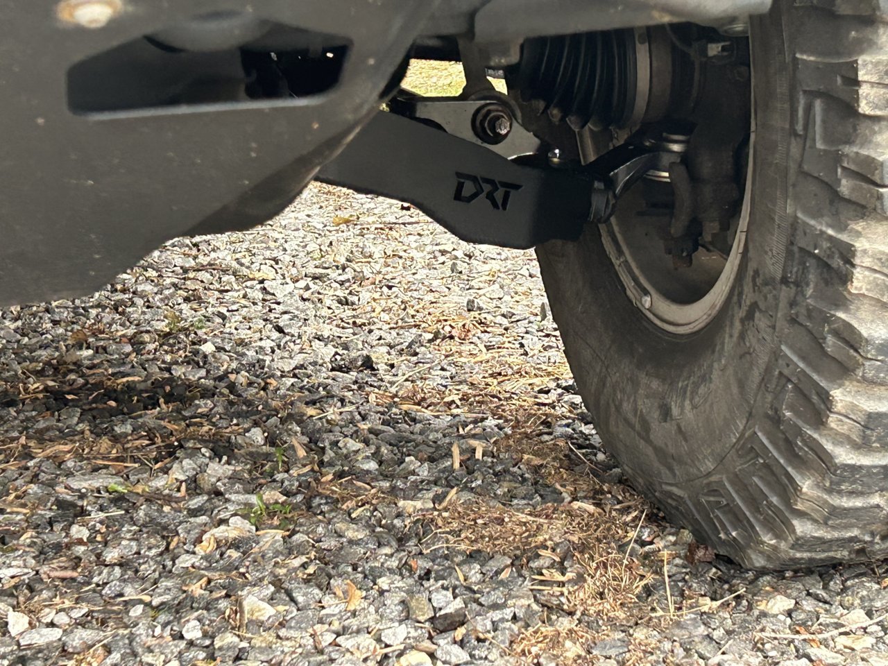

    1A1CA5DF-3295-453D-9389-3C5EBAE61DB2.jpg Put on DRT LCA skids

    I had to cut off 1/4" of the bumper mounting plate (red line)

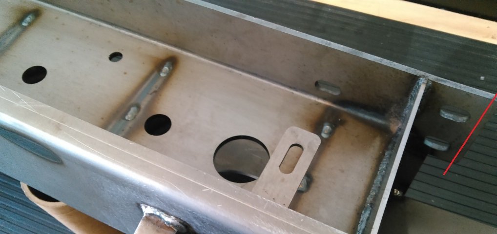

    These are the cut lines I made just above the welds.
