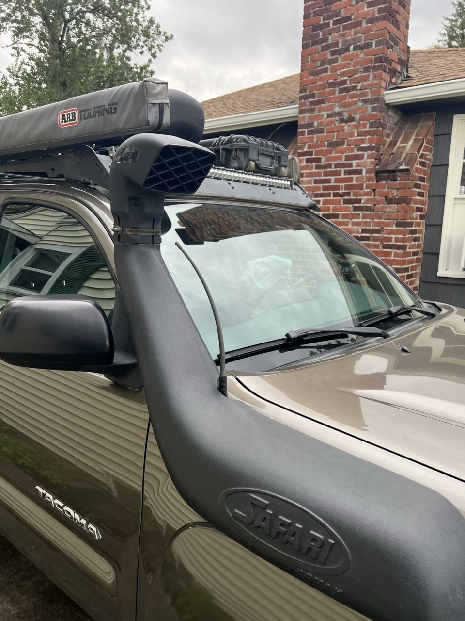

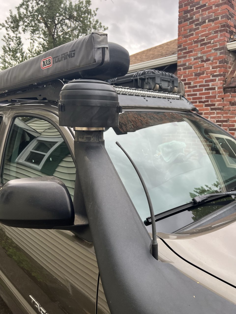

    Replaced the wiper inserts.

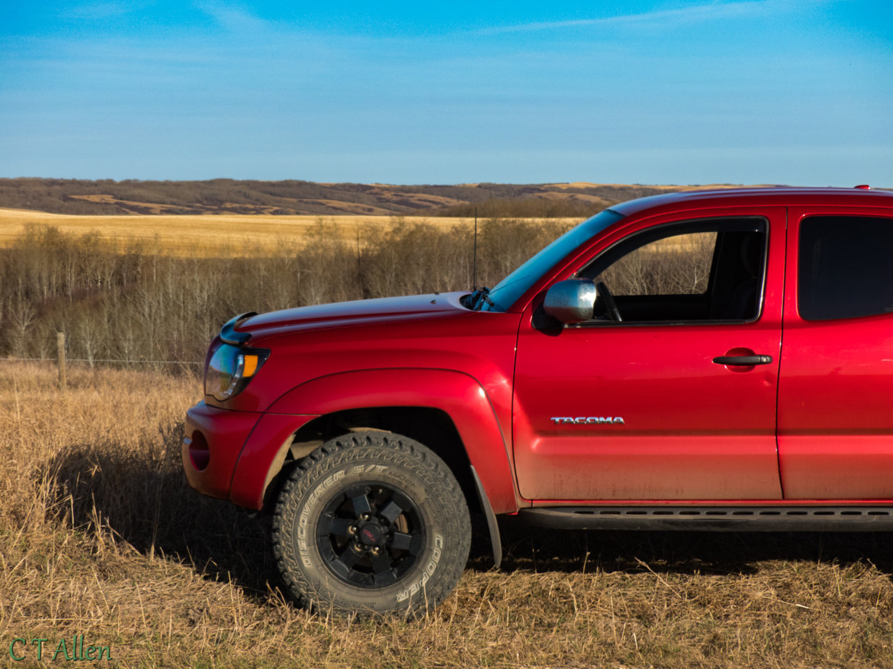

    Looks great man. I’m running the same setup, and for the money and my uses, I couldn’t be happier.

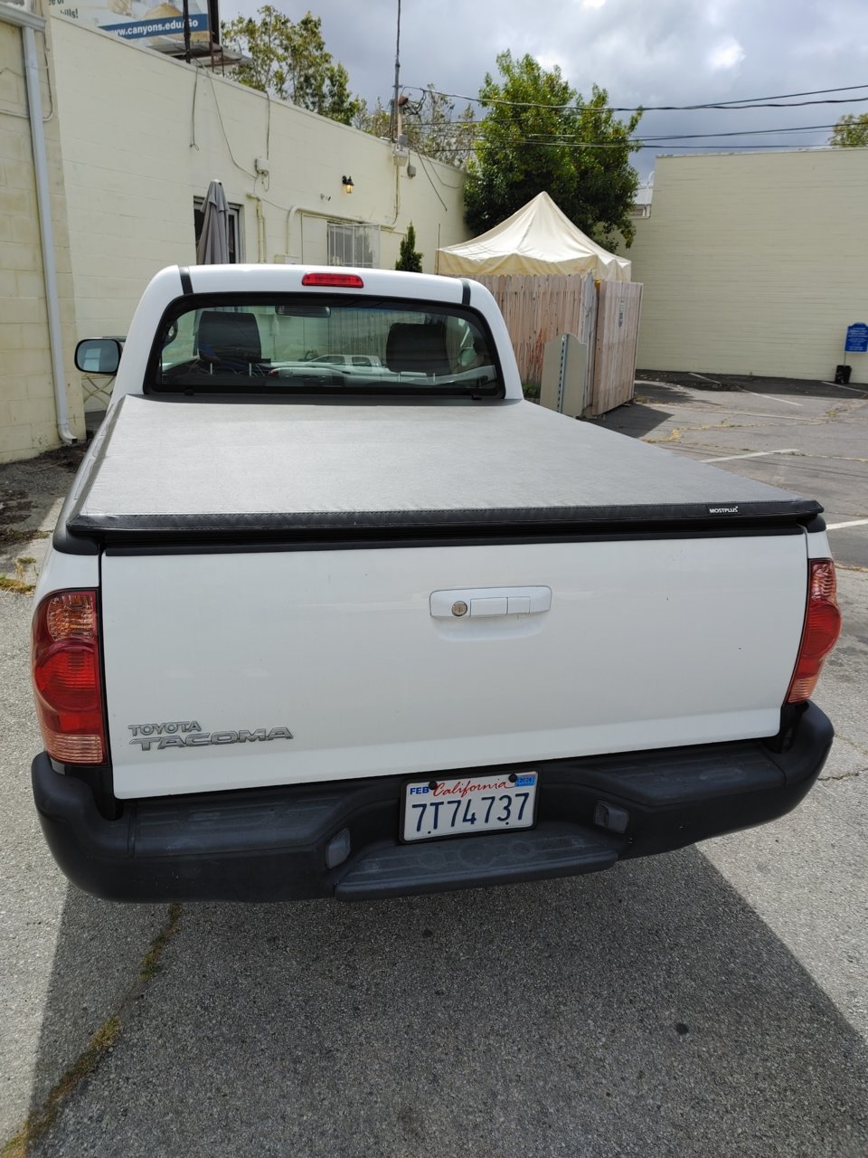

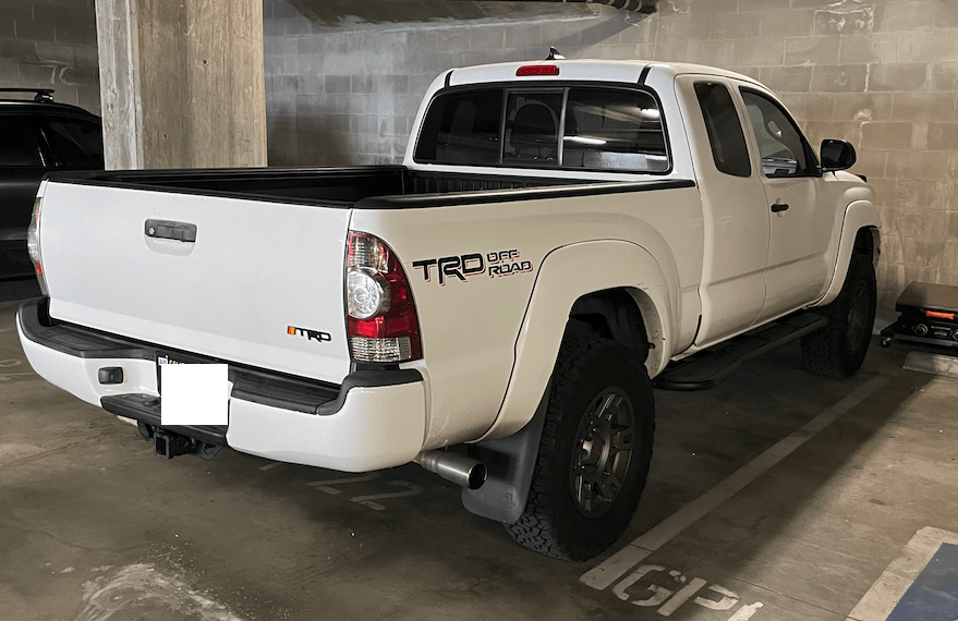

    Made the bed more useful for a daily driver. Added a folding tonneau cover, bed divider (not pictured) and a locking tailgate handle.

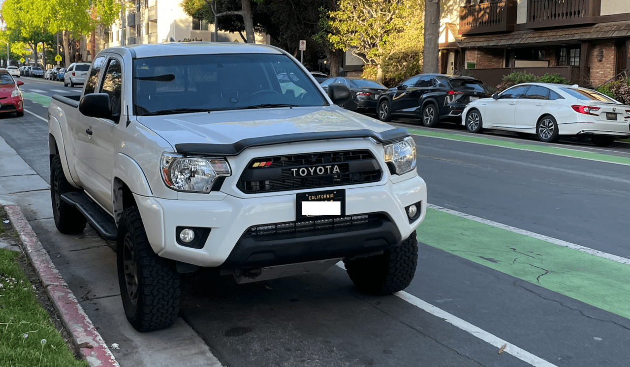

    light detail/wash and painted grill surround with duplicolor primer, base, clear. added bumpershellz. 99% of chrome deleted now! might paint the mirrors too.

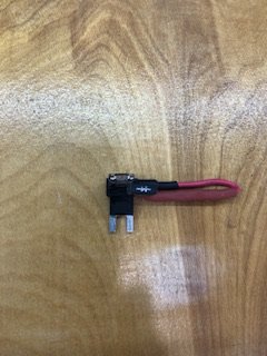

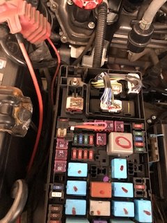

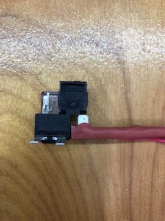

    I’m not taking credit for this voltage booster setup but I just did it and my charging voltage went from 13.54 to 14.1 volts at the battery. I used the gm diode part number
    GM Genuine Parts 12135037 Multi-Function Diode
    cost 9.00 on Amazon. I like this setup because it retains the fuse instead of just popping in the diode in place of the fuse. I got an alternator warning light at first but all I did was rotate the diode 180 degrees and no more light.

    im confused
    So what are the pros and cons and why didn’t Toyota do this stock?
    I have always been taught and seen
    That a resting new battery is 12.7v
    and that with a good alternator on, regarding vehicles in general, charging voltage should rise to 14.5v.
    so why Toyota would make it 13.5v stock I have no idea. Most vehicles do not take long trips regularly to slow trickle charge.
    I’ve heard different manufacturers design their charging systems for certain types of batteries. But in my experience Toyota is always basic as fuck, and how your charging system is designed only becomes something to think about when switching to different kinds of batteries, electrical load add ons to support, etc
    what other parts did you use?
    Edit: according to Amazon description, this is to be done for switching to an AGM battery

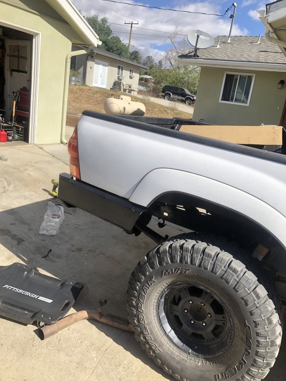

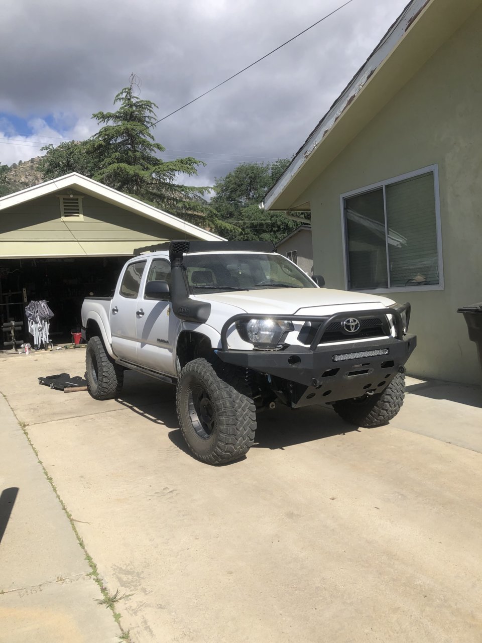

    high clearance bumper done and installed, now leaf springs and a better CMC is next

    I need to paint my surround to match all the matte black trim on my base model.
