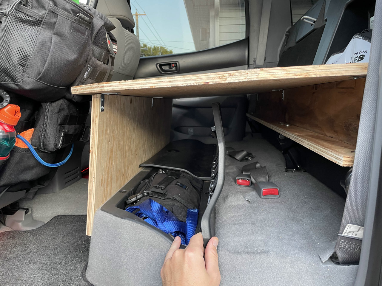

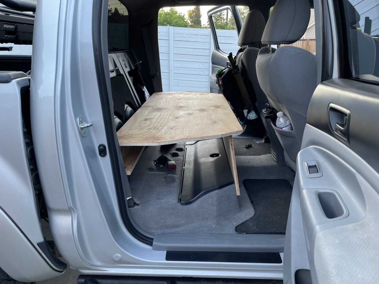

    The start to the Raised Rear Seat Delete!
    See my build page for way more info and pictures.

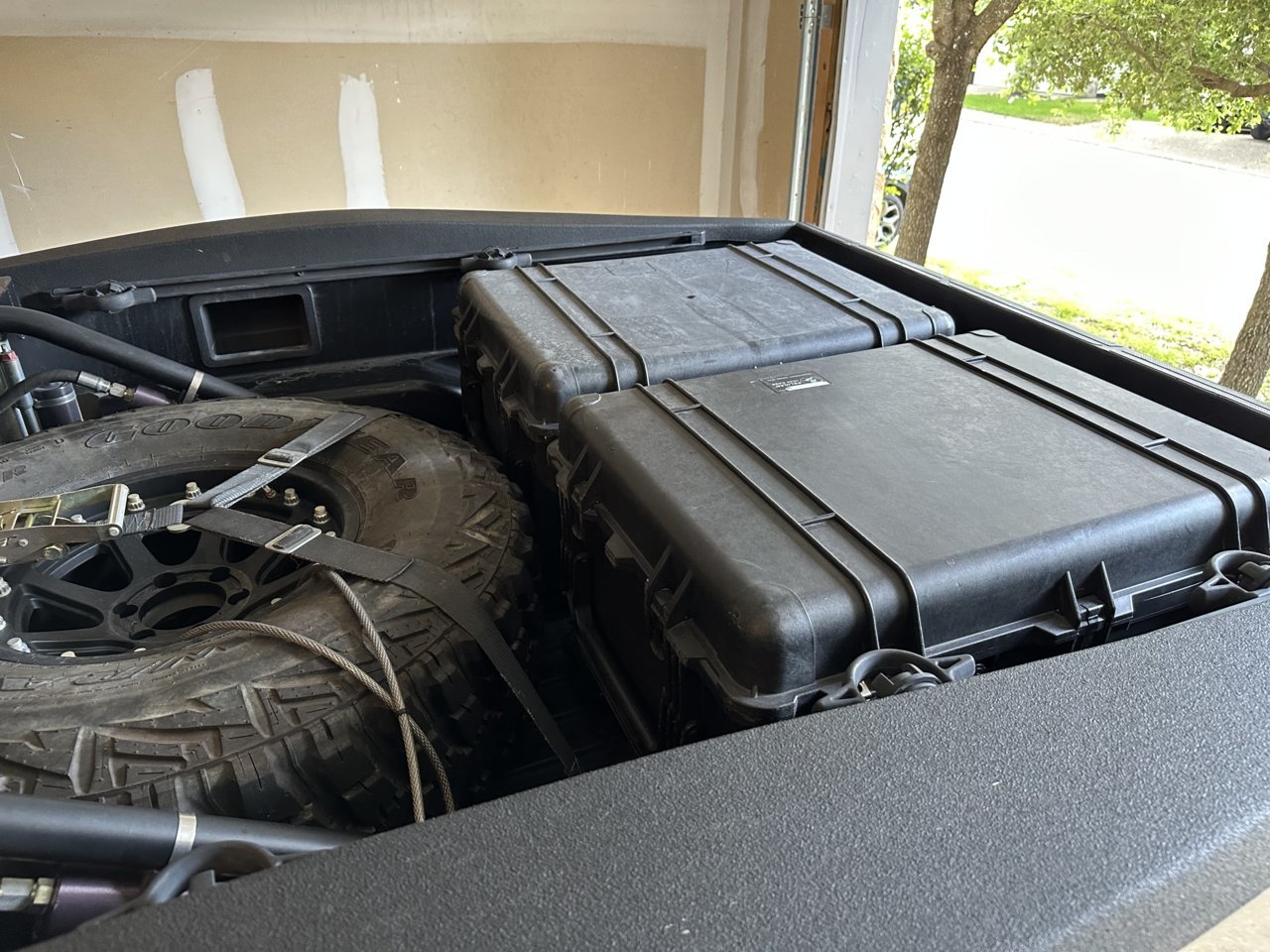

    Two pelican 1630s fit the rear of the bed perfectly. Had to find something that would work for an upcoming move.
    Adding some L-track next.

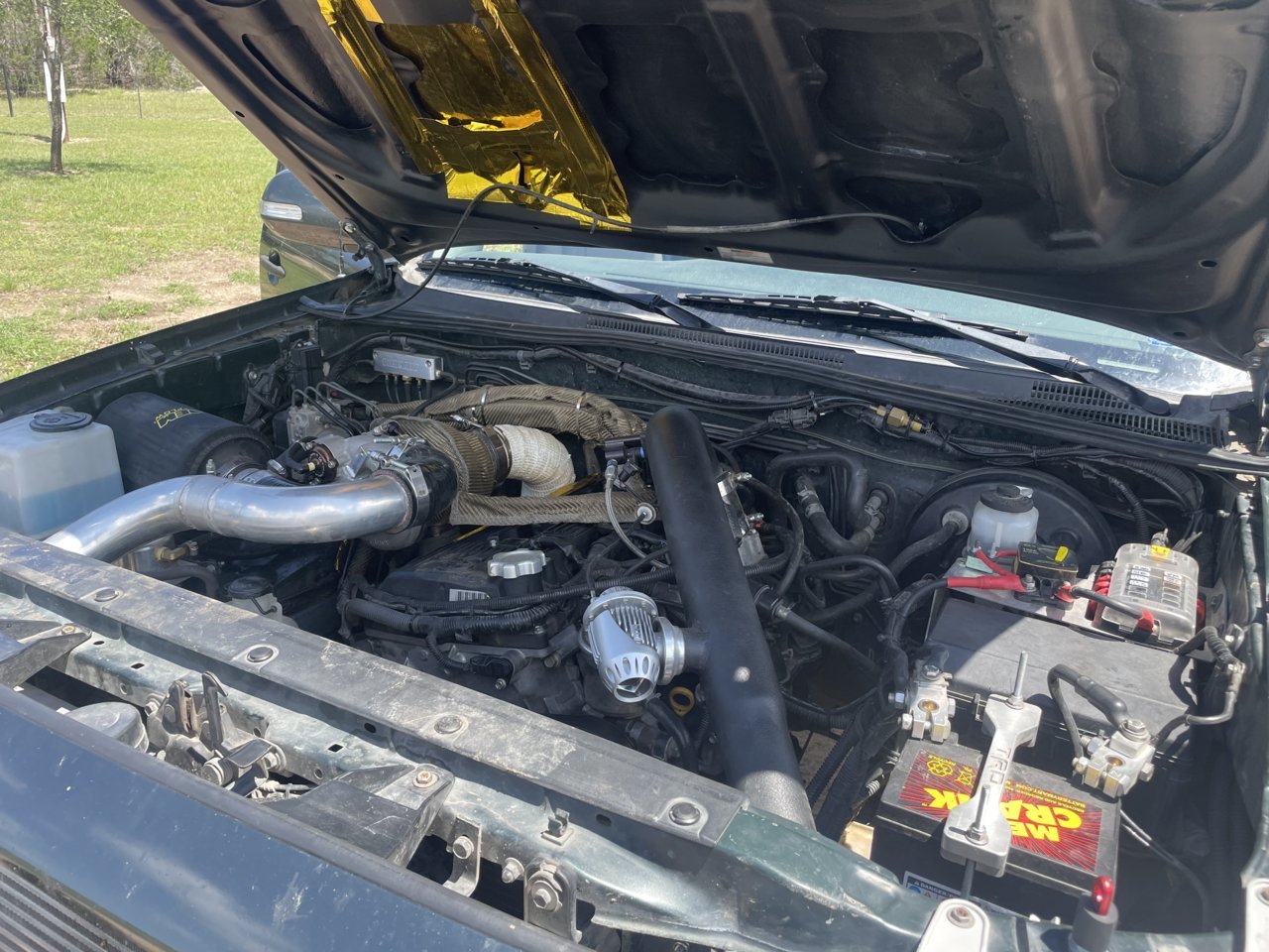

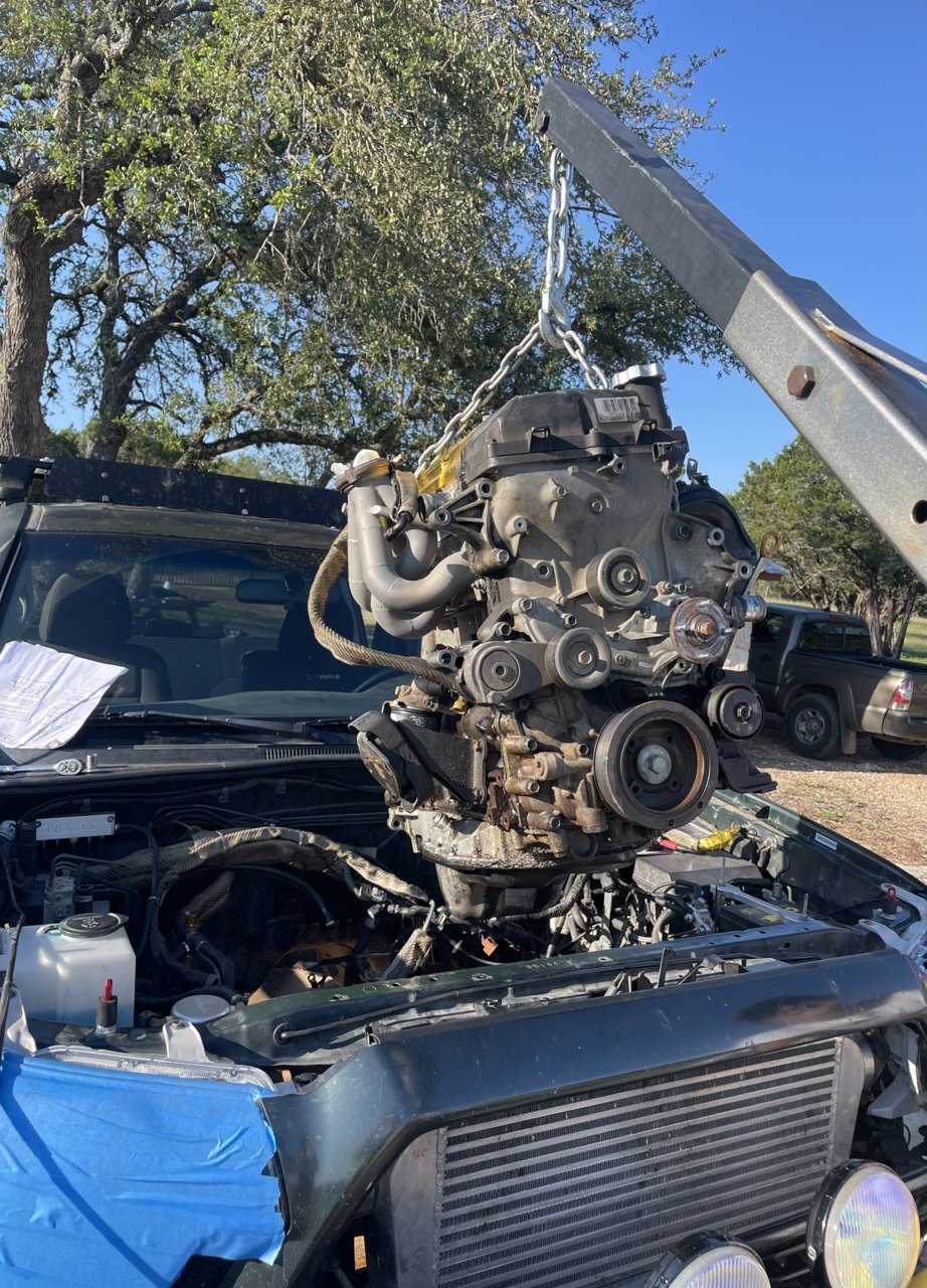

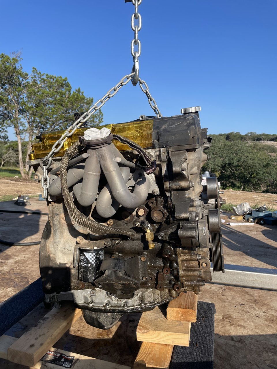

    Swapped in my new long block! Took about 9.5 hours total for just the swap. Changed out the motor mounts while I had it out with some new OEM ones as well

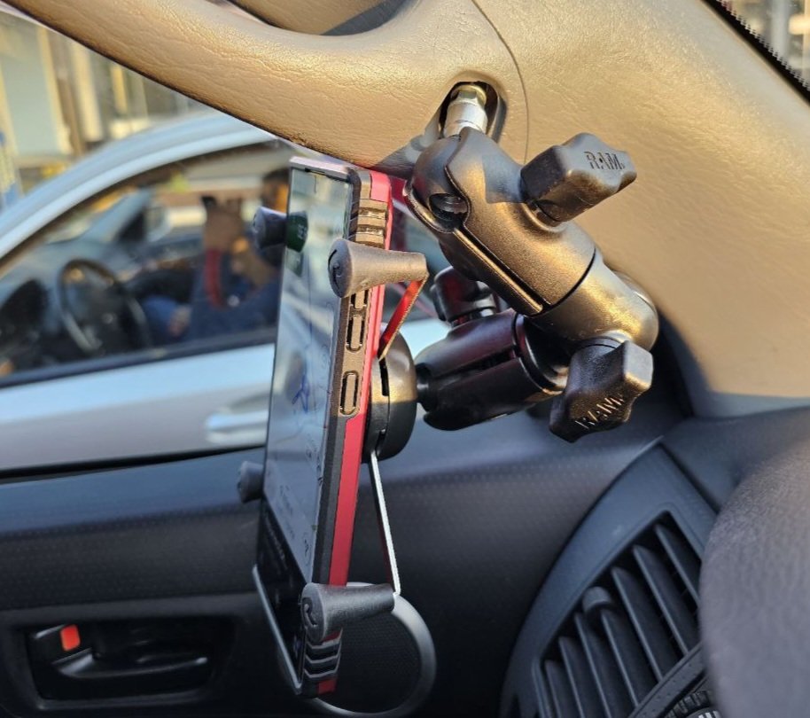

    Today I made a phone holder based on the A pillar mod. So far it works great. I still need to run a charge cable but that will happen another day. It took longer to get the angle just right than it does to assemble the mounting stuff. Using the "elbow" mounting arm let me get it into the perfect spot far away from the turn signal with the perfect viewing angle. The sail panel is the only thing being blocked. No windshield blockage at all.

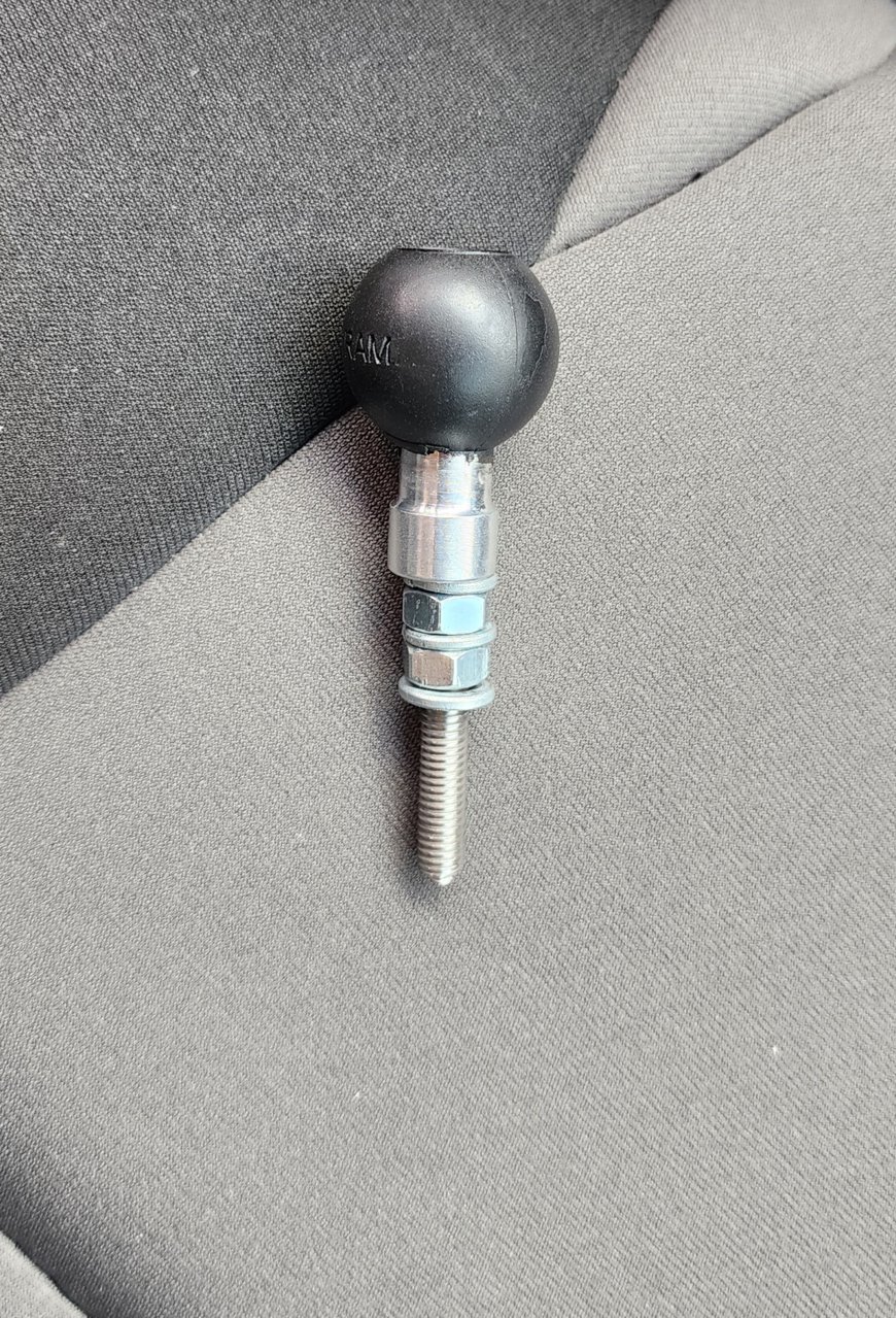

    I got a 70mm M6-1.00 machine screw w/ large Phillips head. This bolt is fully threaded instead of the original bolt shown in the mod. I placed a lock washer inside the top of the ball mount and ran the screw through that and a lock washer at the bottom. These were tightened together with the first nut with wrench and screwdriver. By tightening down each nut with the previous lock washer as I built out helps keep everything firm with no chance of the ball mount rotating once the bolt is threaded into the A pillar.
    Using the 70mm threaded screw let's you build the length easily by adding more washer and nuts. I first did this with 3 nuts but I decided It was to close to the turn signal if I got the perfect viewing angle. The factory hole has more than enough space to take in any excess bolt.

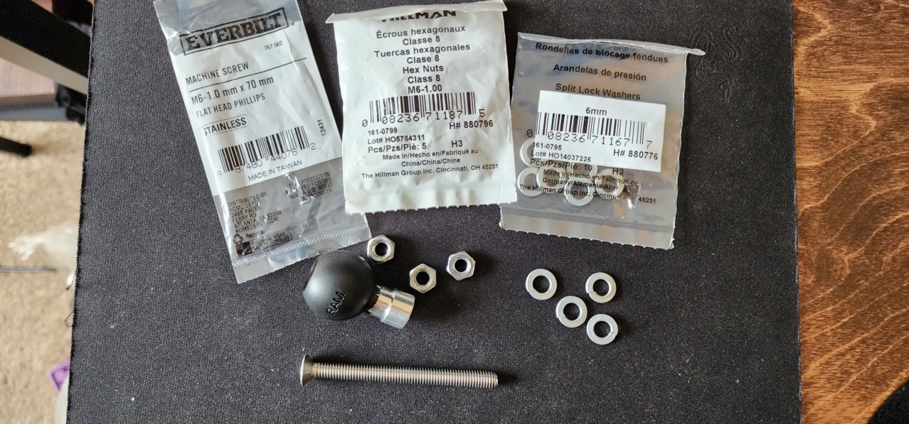

    Home Depot hardware -
    -70mm M6-1.00 machine screw
    -6mm split lock washers 4x
    -M6 1.00 hex nuts 2x
    Amazon hardware -
    RAM Mounts RAM-B-348U Ball Adapter with 1/4"-20 Threaded Hole with B Size 1" Ball
    RAM Mounts Composite Double Socket Swivel & Ratchet Arm
    RAM Mounts X-Grip Large Phone Holder with Ball with B Size 1" Ball

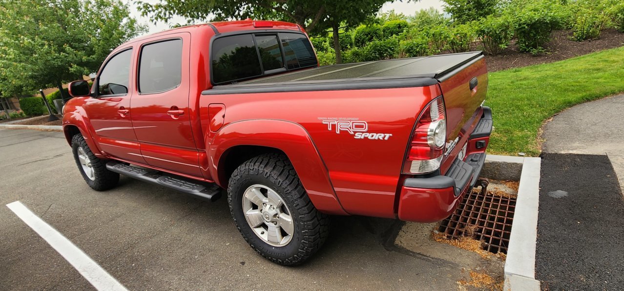

    Installed new Cooper Rugged Trek 265/70/17 tires. So far they are great. Comfy ride and minimal noise. I hear more wind noise than tire.

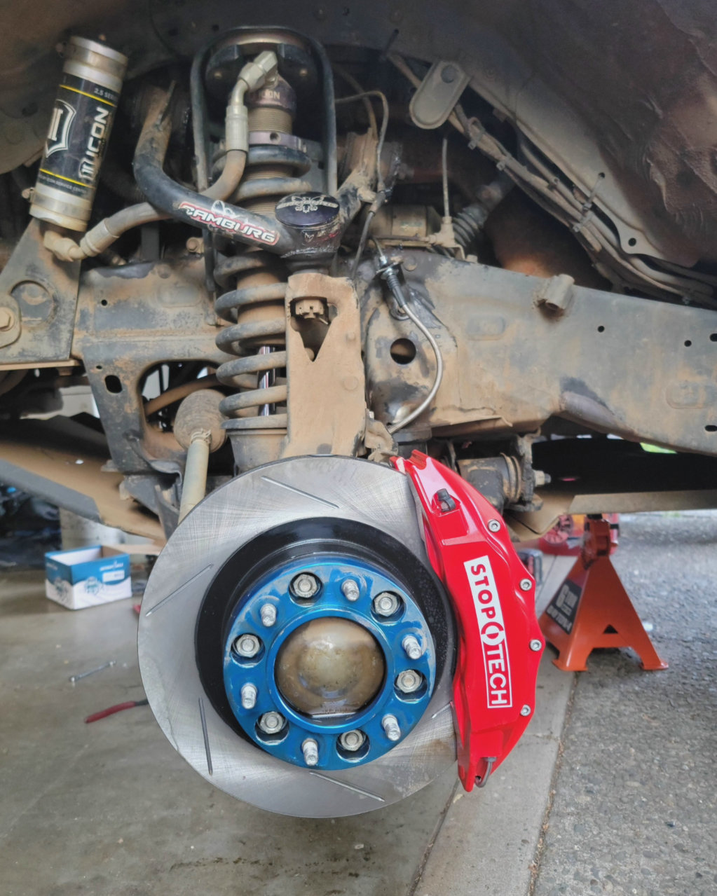

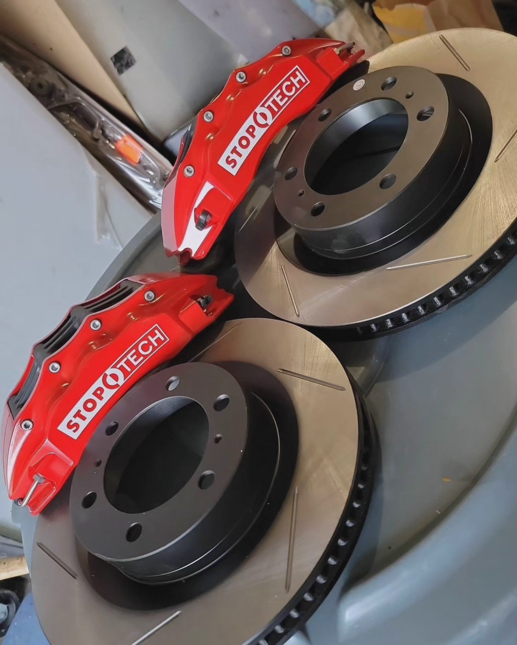

    Did a little brake upgrade yesterday

    I really like these tires. Think this is where I’m going next round

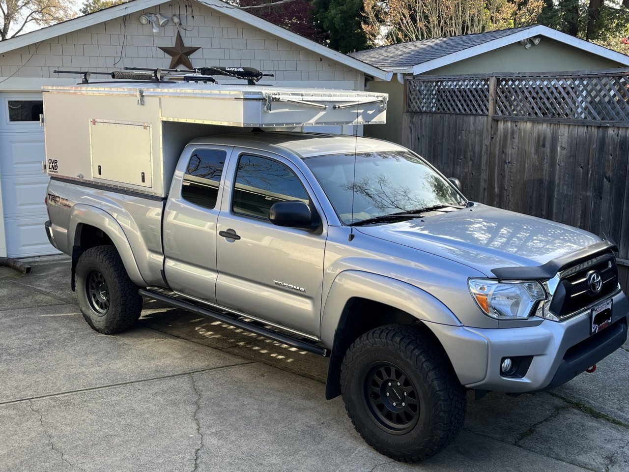

    30'' Rigid Industries front light bar BFG KO2s 265/75/R16 BAMF rear diff skid plate BAMF rock sliders BAMF Trilogy Skidplates BAMF LCA Skids Bilstein 5100s (4) Icon Dynamics MULTI RATE RXT LEAF PACK W/ ADD IN LEAF RIGd Ultraswing OvrLnd Camper Done! (almost ;)
    Method Wheels 704's
    SPC UCA's
    Akebono brake pads
    (handles much better with wheels and UCA's)

    Looks awesome!

    Do you notice a big difference in the trucks breaking now? Is it more responsive?
    I’m tired of the spongey feeling with my stick break setup.

    Without other mods like MC and booster, those will make your pedal feel even more spongy. Cuz the calipers take more fluid. They will increase stopping power tho no doubt
