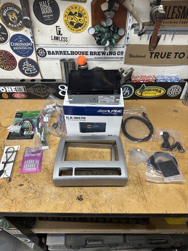

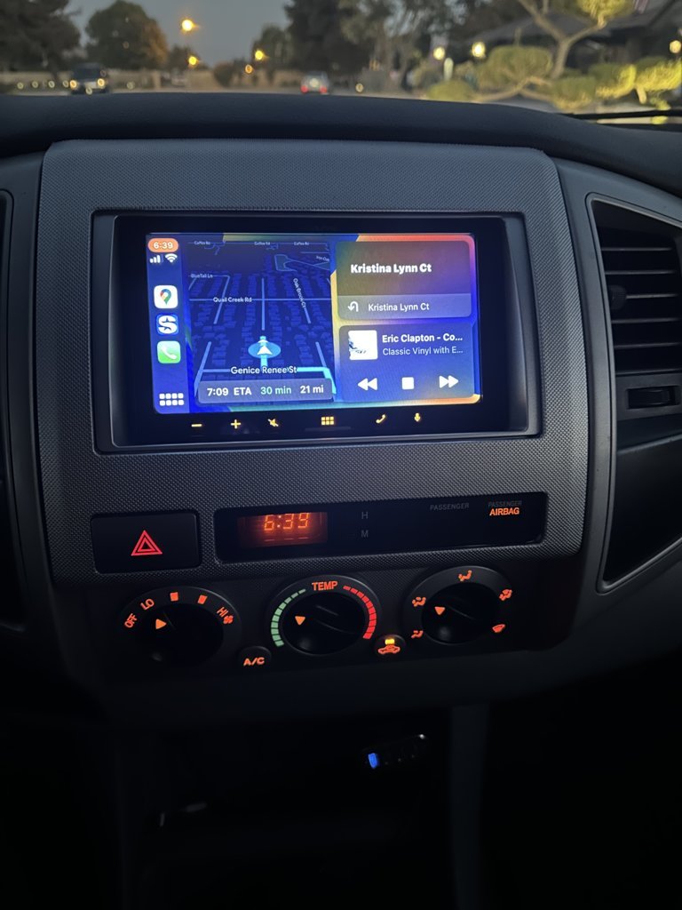

    My 2nd gen is no longer my daily. I decided that I would drive it more if it had Apple Car Play. So out with head unit #3 and in with #4.

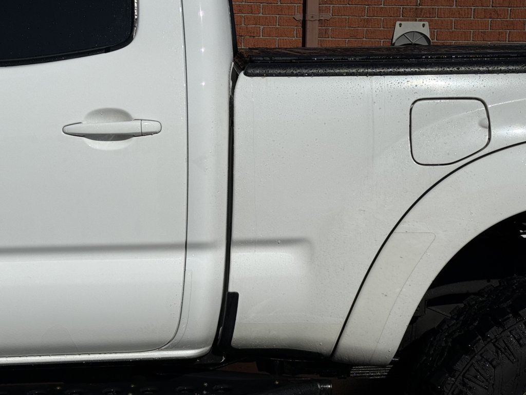

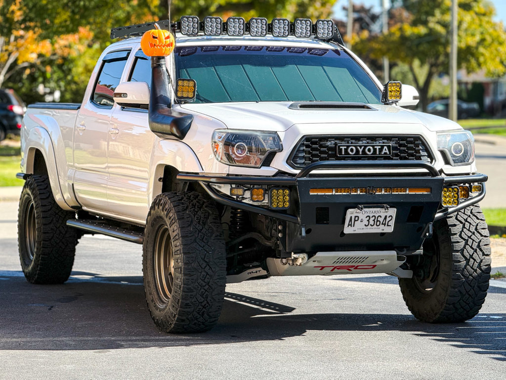

    Way overdue wash!
    It’s that time of the year!

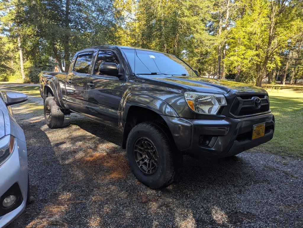

    Bilstein 5100's on all four corners with 2884 coils in the front and Icon add-a-leaf in the rear. Front should sit about 2" higher and the rear 1.5". Haven't taken any measurements but it looks pretty darned good!
    Also did a brake job, replacing pads, rotors, dust shields, and calipers (because why not).
    This wasn't all "today", I split the work over a few weeks when I actually had time to get around to it.

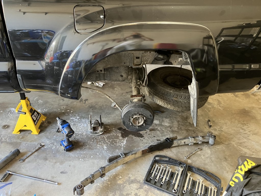

    Took my 2015 foe the annual PA state inspection. In and out in just under an hour. Pulled the rear cubbies out of the 2014 so I could start trimming them and mounting stereo goodies. Mimicking the system in my 2015. Fosgate 8inch powered sub, 4 x 75 watt amp and line out converter. Everything fits in the passenger side cubby. Going to try and run the wiring a little neater. Here's the 2015 setup20241019_175755.jpg
    In between doing this I repainted the grill surround for the 2015. Trying Krylon Fusion this time. 3 color and 3 clearcoats.
    Last but not least I pulled the rear bumper and hitch from the 201520241019_173759.jpg
    Cutting the fenders tomorrow and getting everything cleaned up. The Brute Force Fab high clearance bumper that's been in the garage for 3 years FINALLY goes on next weekend.
