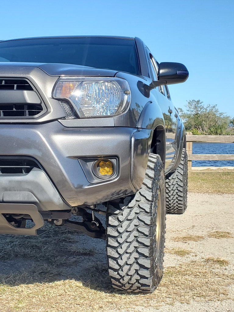

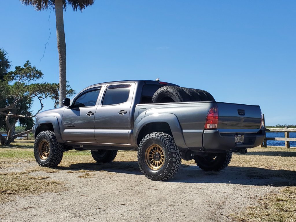

    Mounted 285/75's today (16x8 0 offset) from 265/75
    Yoko Geos
    Bring on the cheap gas, I'll need it
    Tire shop put dressing on... :anonymous:

    Those Geolanders look badass. Probably the only mud terrain tire that I would go to. Nice looking truck!

    Bigly agree man. I shopped hard for a 33 for months, only one that was as light and seemed to not sound like you're flying a Cessna. Theyre surprisingly quiet and feel better than my Falkens - i had an out of round tire that would never balance
    My brothers got some nasty hunt land in south Georgia so we'll see how they fair

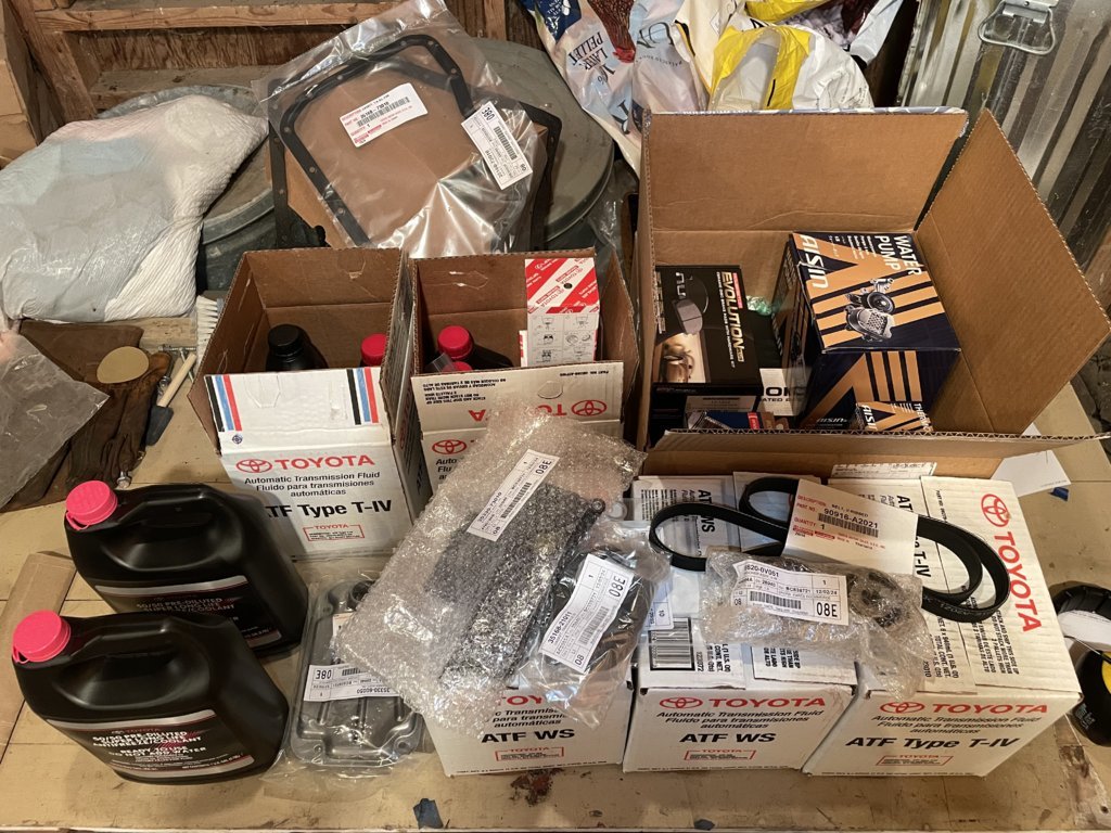

    Black Friday Maintenance Edition haul came in today lol, saved almost $500 on OEM parts. Roughly 200k service for what's left on the taco and wife's lexus, and 100K for my mothers Rav4.

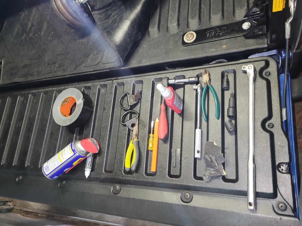

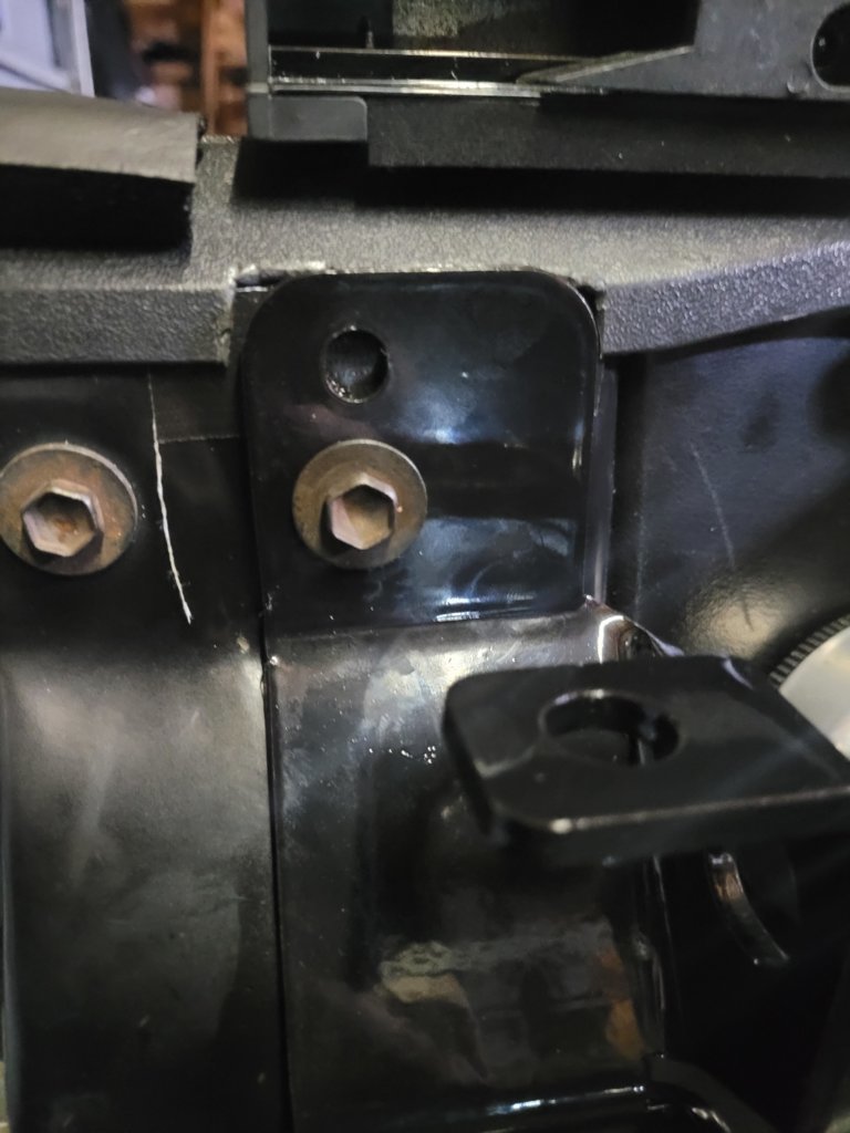

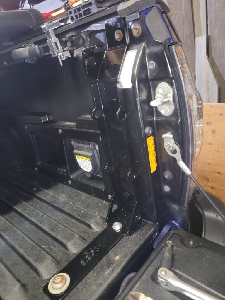

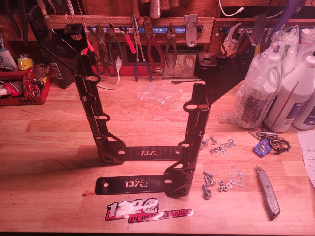

    1320 low pro total chaos style bed stiffs, mad nice powder coat, highly suggest these
    I still have to drill them pop tails and 3 bolts each side but got a good hr worth done during my workout after 9 hr accounting shift, dogwalk w baby in sleet snow
    4hr sleep and same thing again today
    20241204_193322.jpg 20241204_195218.jpg 20241204_210024.jpg 20241204_210111.jpg 20241204_212146.jpg 20241204_212311.jpg

    Finished the 6 bolts vertical bolts for the 1320 stiffeners, the top bolt under the metal flange out of view was a lot of fun (blood at some point) , and I decided to extend breather since I had taillight off. Forgot shot of oem new valve but I went thru the bottom hole in taillight area so it was more vertical to better function. Threaded in frame rail and clipped up to a wire harness with slack above rear axle. i use a toothbrush style tool to clean what i could around breather union befor einstalling new union, with some teflon tape. had to light from rear hitch a bit for access with my stock ride height and spare under there
    Fun in unheated garage in December after fluid film 3 weeks ago20241205_192832.jpg 20241205_192910.jpg 20241205_205900.jpg 20241205_205918.jpg
