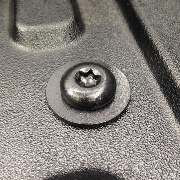

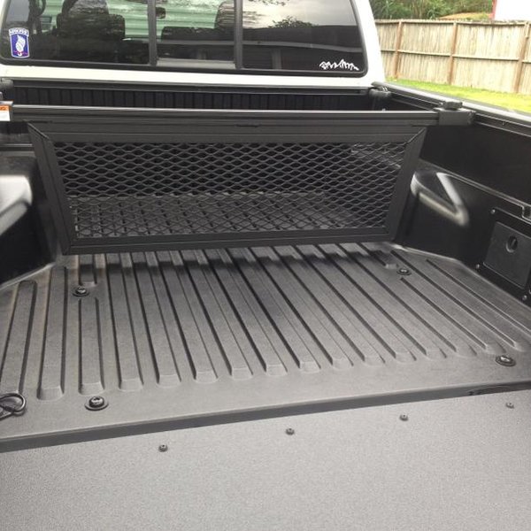

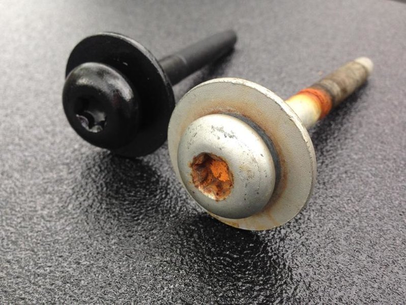

    Replaced the poorly galvanized stock bed bolts with some that I zinc phosphate coated and painted black.

    Good idea. Might copy ya

    mine look like that. i need to paint them. without me taking the extra 8 seconds to do a search do you remember the torque specs on those bed bolts?
    edit: took my longer than 8 seconds.. but 55ft lbs of torque for the bed bolts is what i found

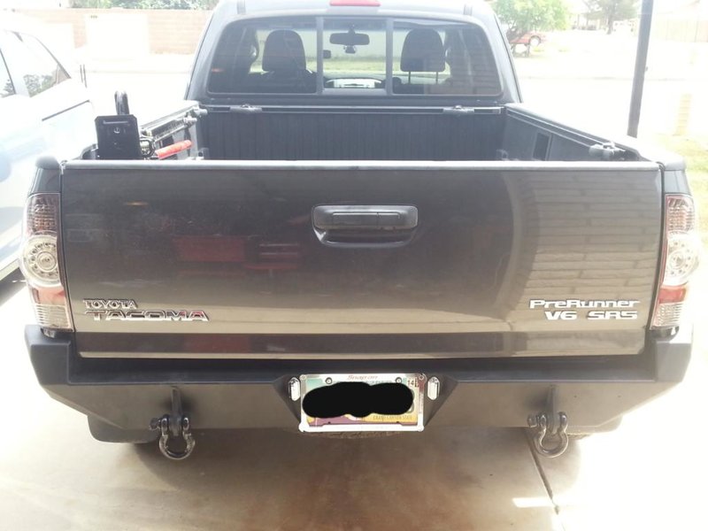

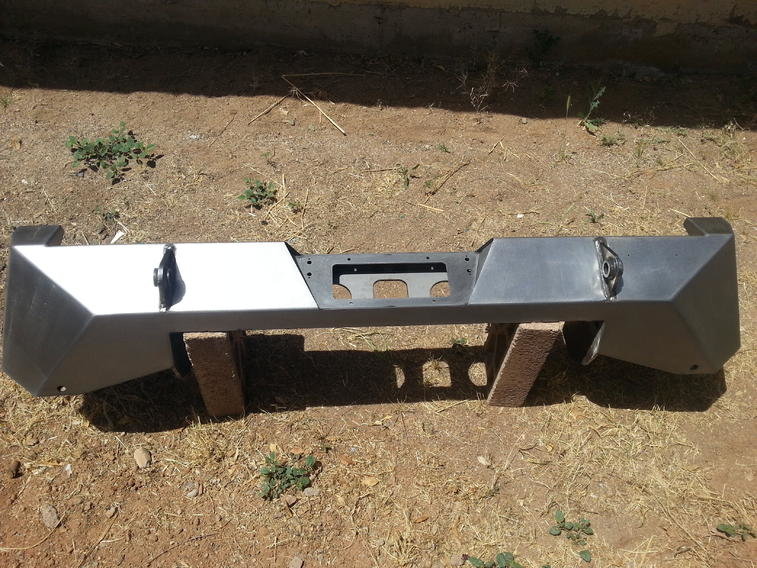

    Received my All Pro bumper yesterday, spent all day priming and sanding it. Took forever but well worth it In the end after I got it on today; by myself I might add. Ready to hit the trails in a couple weeks and start kayaking at the lake this summer.
    3 coats of primer, 1 of self etching primer and 2 of automotive primer; topped off with bed liner spray. Looks amazing in person, only complaint was waiting 3 week from All Pro to get it and being lied to about when it would ship 2 seperate times.
