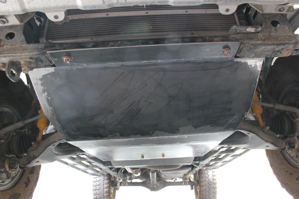

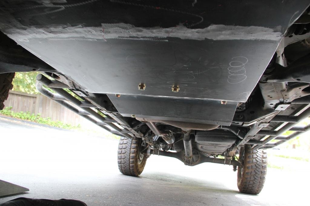

    Mounted up my skids that i fabled up last weekend. They're also now painted blackIMG_1858_zpsaf7f1600_354095451a8540d8d631bf11f6045212331b9b51.jpg[/URLIMG_1861_zpsf10b3cbc_c9c101e7a3ca2ff1c49d69e4fb092ff79eb9f629.jpg

    That's pretty cool

    Nice work!:thumbsup:

    Did you form the bends or weld them?
    I ask because they look welded. If that is the case, you may get cracks down the road.... which may lead to failure of the entire length of the weld. Something to consider. Maybe add some gussets welded in at the "bends".
    Bending with a brake press is the way to go....
    Just my 2 cents
