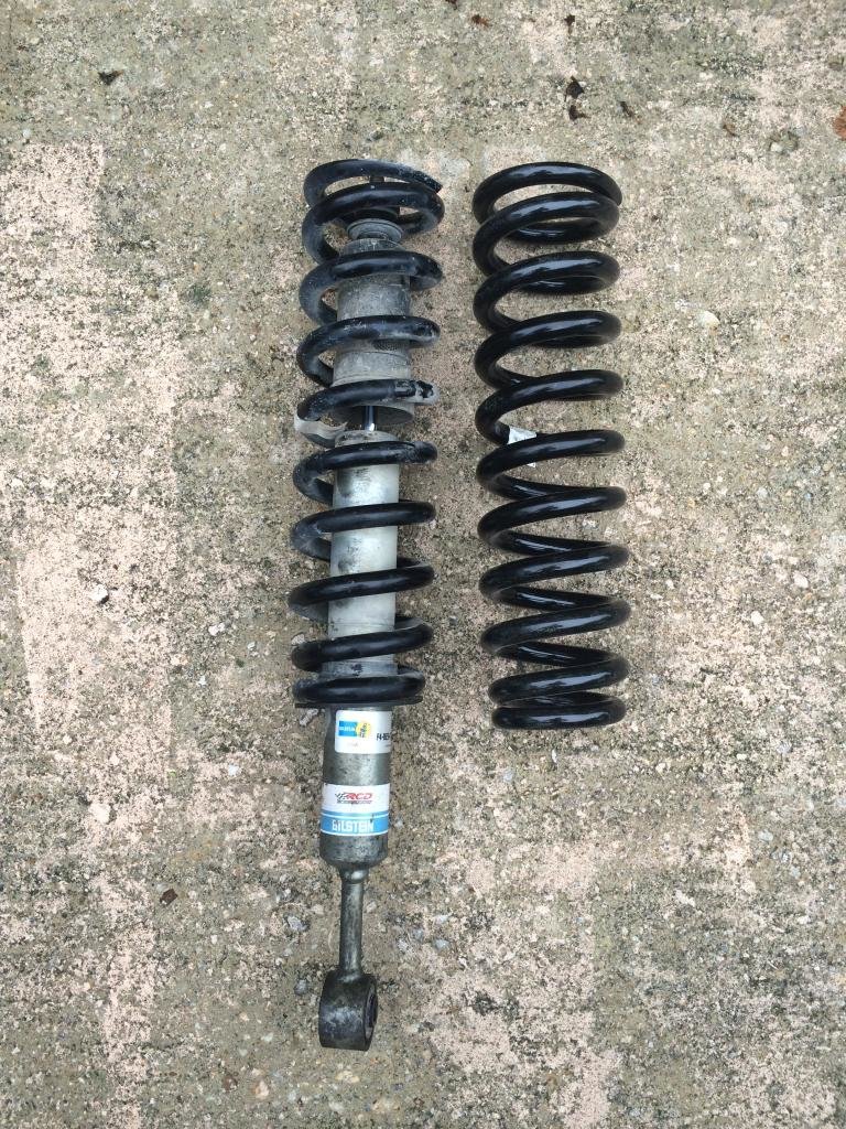

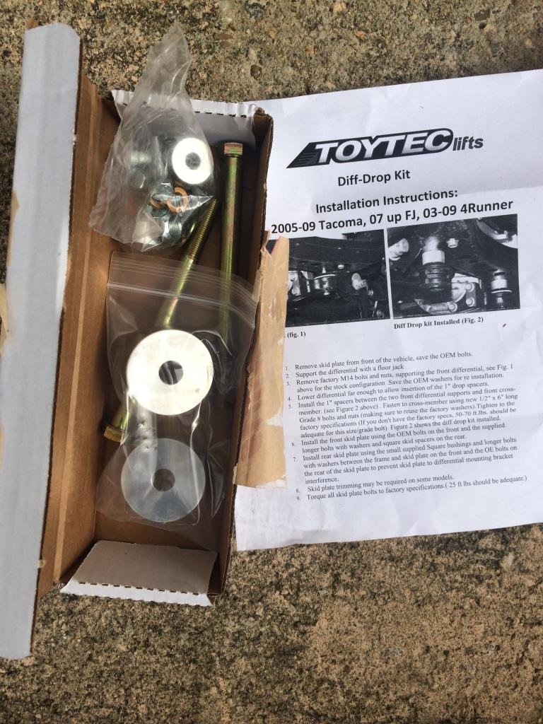

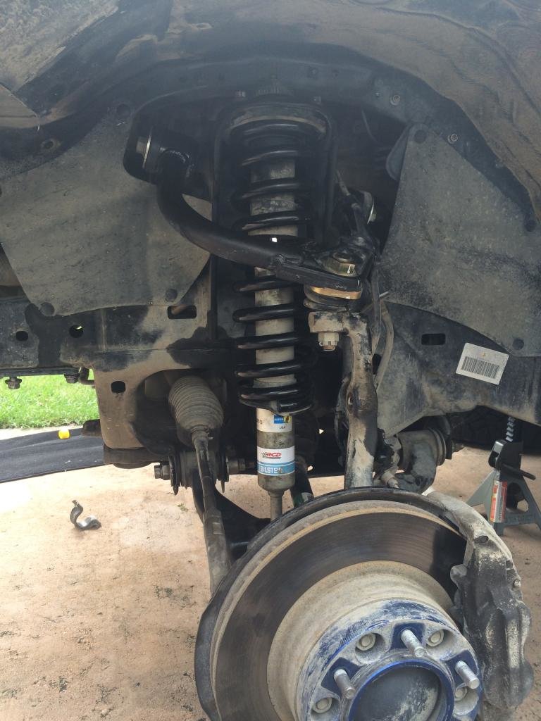

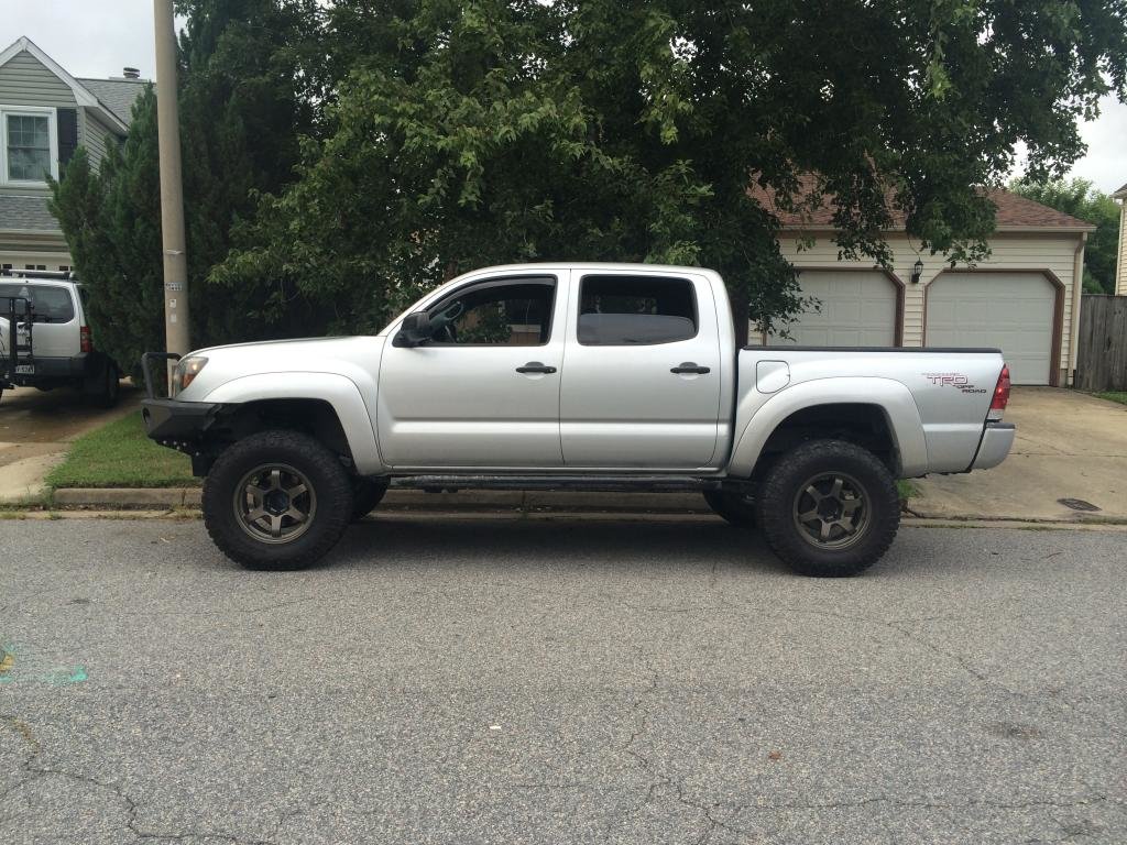

    Installed OME 886's to handle the extra weight and finally installed a differential drop kit to help my axles out. I saw the video about installing aftermarket struts and springs without a strut/spring compressor and figured I might as well save some money and do it. I took my time and it took me about an hour and some change.

    :wave: welcome and good job on the DIY!
    Here's a couple things to look into.
    A lot of people frown on OME 886 coils on anything other than OME shocks. The thought is bilstein and other shocks aren't strong enough for the heavy spring rate of the coils.
    Diff drops on 2nd gens done do anything but rotate the differential. This does not "fix" the front drive shafts angle.

    Thanks for the info! I searched and talked to some who have been running it with no issues, but Im sure that I'll get tired of this set up and get full coilovers.

    Can ya spell Tonneau
    Ahh popucock.
    Rotating the front is as good as rotating the back if you have vibe. Too many look at the result of a freakin race truck hitting a boulder and scream " ouch not for me"!

    Still doesn't discount the fact that the geometry does not lower the axle angle. Lurrys poser truck is the one I seen hit a rock, not a race truck.

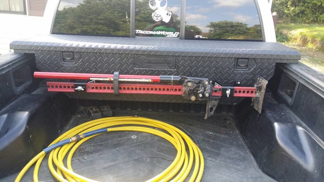

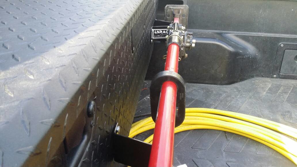

    Mounted my hi lift to my tool box. Had some extra 1/4" I put on the inside of the tool box to keep from ripping the bolts through.
    Got the mounts at northern tool for 15.00 in the sale bin.

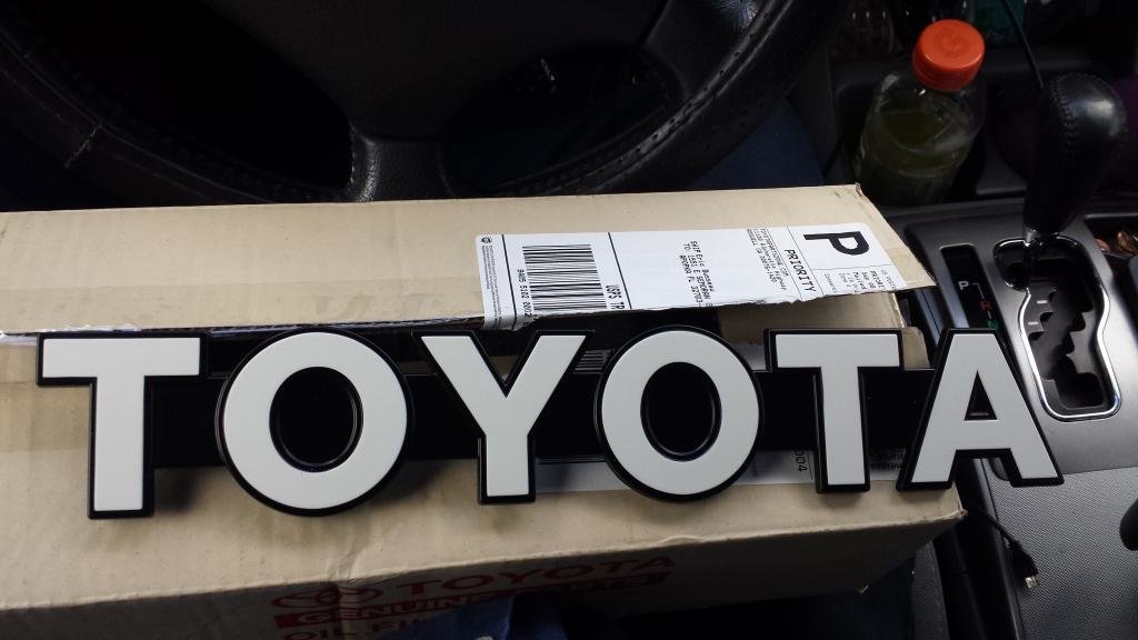

    This came in today. Just waiting on truck alterations to ship my grille now. Gonna call them tomorrow and see what's up.
    Just as I post this I got a shipping confirmation so sweet

    Love it!

    I'm gonna do that myself! Love the retro look...:D
