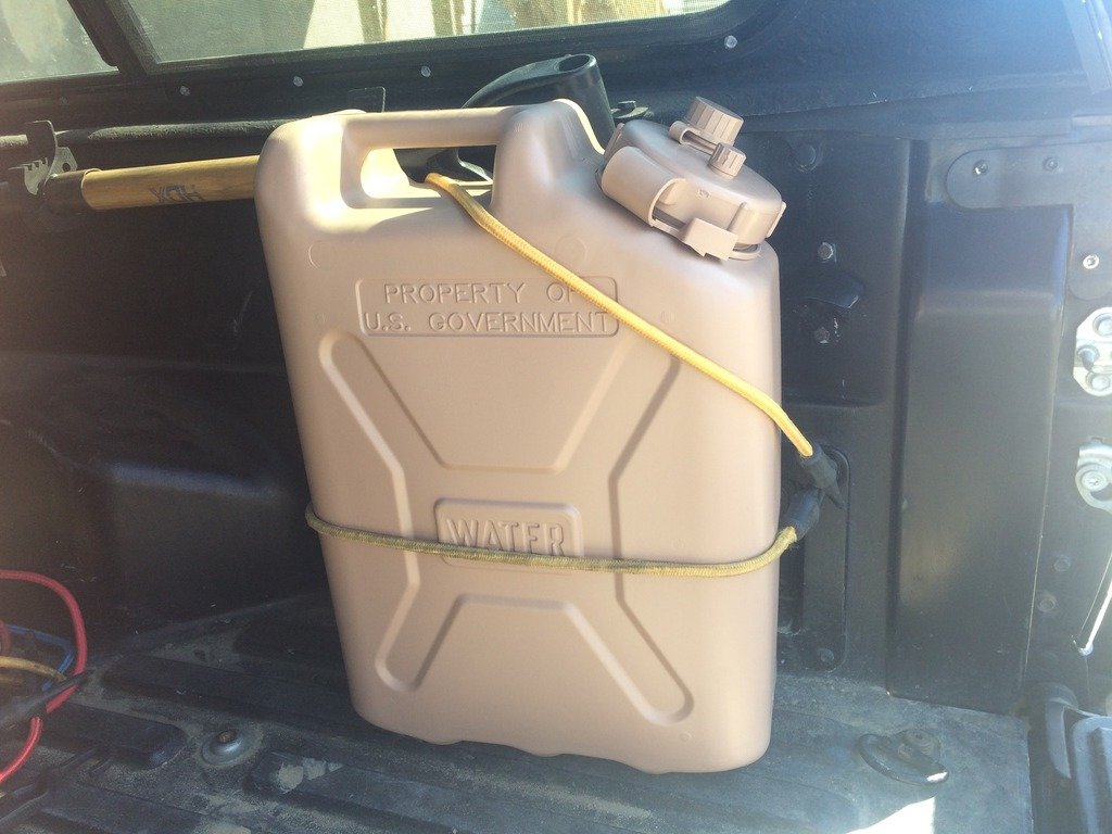

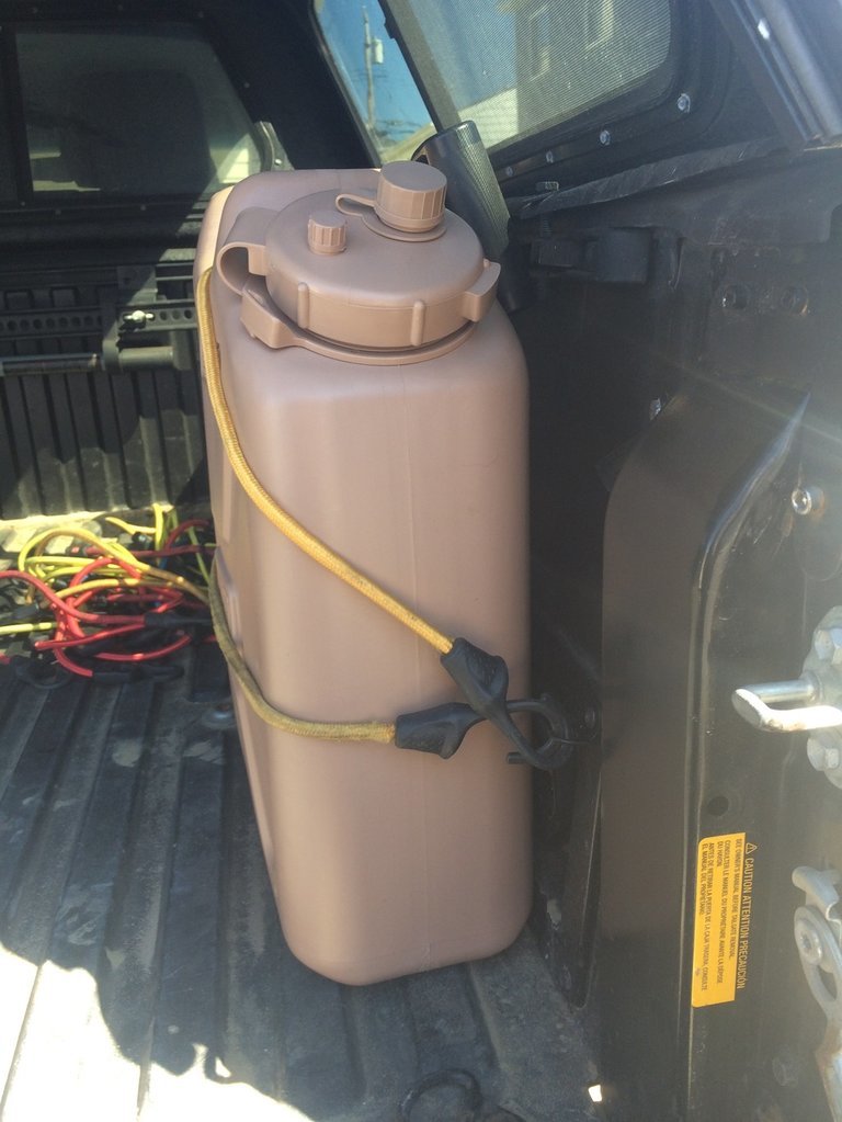

    Started this morning with a functional cheap mod I recently came across. So obvious you would never think of it :rolleyes: Wish I could find the link again to give OP credit. When I found this thread it was an alternative to a jerry can mount. But I saw more uses for it, like a secure spot to strap down a milk crate with propane tank or stretch the net you stole from your girlfriends Kia Soul :anonymous: across cubby to cubby to keep the groceries from sliding around. This was the end result the thread suggested

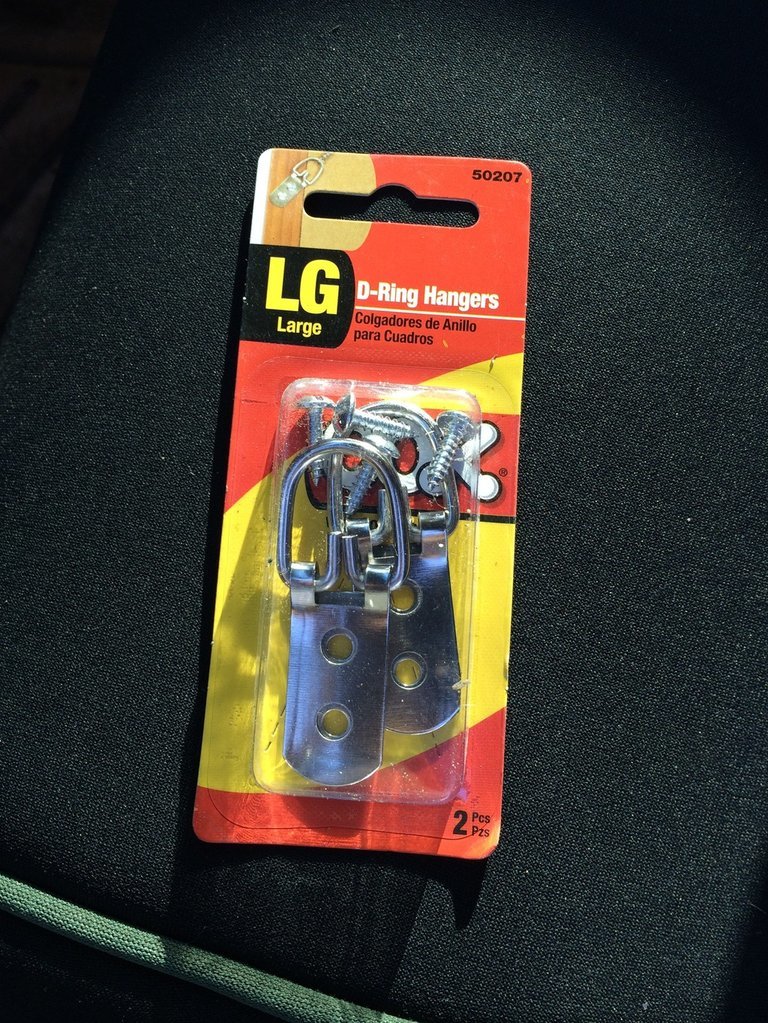

    I picked two sets of these up from the hardware store

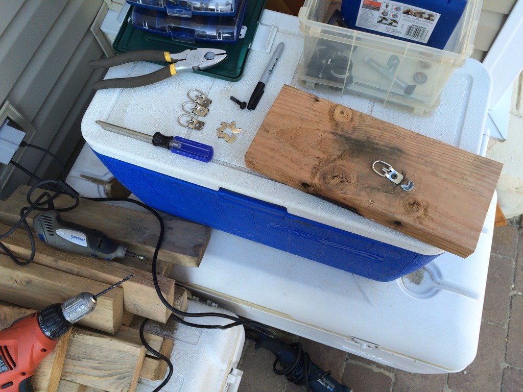

    Drilled out the hole for the stock bolt and test fitted
    4C25C47F-8F6F-49B5-8333-F7538916C914_zps_b4d14688634c83774ed10712a42fd648a8f026c4.jpg
    Cut off the excess, rounded off the cuts, and painted them black
    5F83C42B-0664-41E3-AAA4-D566B6C3BEF1_zps_fa1f3960092d333b22c71a140cbb3833fe606631.jpg
    46FA5560-83D7-4B73-B516-DB87DAC81C10_zps_2eb3c4b118eec3f75461a9f6273443c355427ada.jpg
    174587CD-D6AC-44B6-9E86-88B33D767DA5_zps_d1b0ed8b548a0eeb9cac6c61dce919364c7289b2.jpg
    Great little mod with lots of potential.

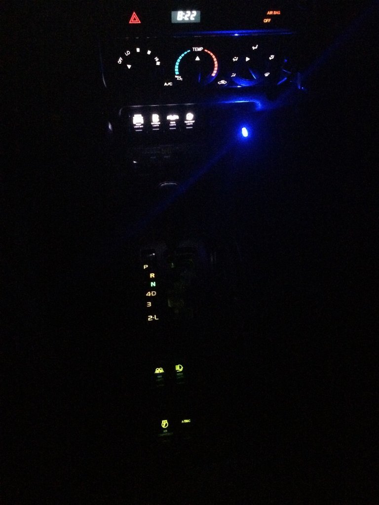

    Lastly, While everything was torn apart I ran the power and ground to all the switches next to the center cup holder. Soon to be wired in will be the A-tac system and OBA. Still two open switches available.
