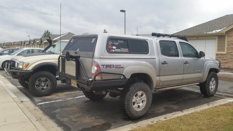

    That taco lean :eek:

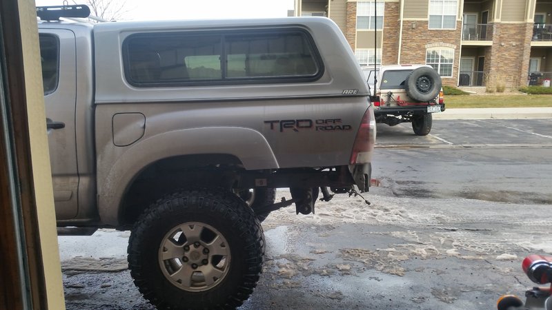

    I think the pics make it look like I have the lean but it is pretty even. Unless you mean my rake. Ya I have a lot but I like it.

    Oh i know rake. First pic the driver side is lower than passenger

    Ya I took the pic from different angels and distances. When you look at it from the front it is level. I spent a good hour taking measurements and eyeballing the look of the front end. When I put the front bumper on.

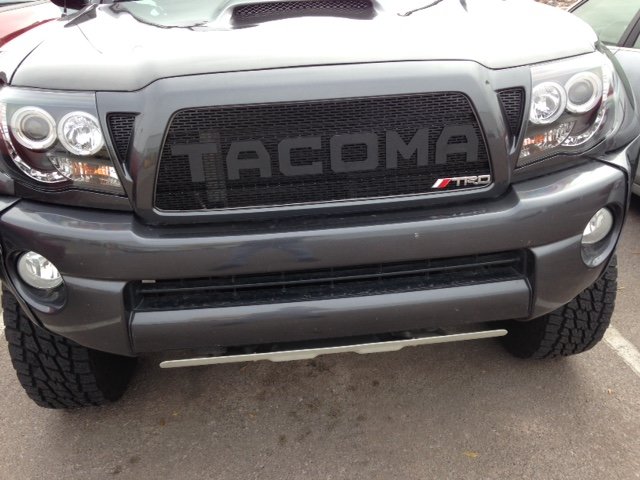

    Ok first question is details on the hood and lights.. .Those are sick and I bet the hood is lighter then stock. Am I right?
    Second question is how much did they cost. I kinda want one now.

    Hood
    hood is made by Carbon Creations. Weights about half from the stock hood. The halo light I found on DT motosports, they were the cheapest there about $120. The hood was about $900. I'm not sure about your tire size. Mine has a lift with 295 on. I wouldn't machine ur wheels. They would loose the strength for sure.

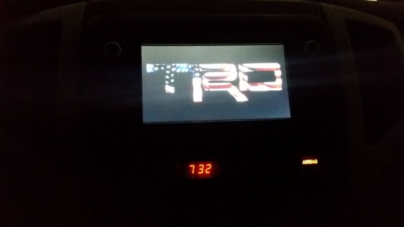

    Is it a straight swap putting the older clock/hazard into the '15?

    All of them
    If it is an your looking to trade I'll send you mine from my 13 you can swap then send me yours.
    That way you don't have a hole in the dash :D

    The hood only shows for 2005-2009. I wish I had someplace like this around my area of country so I could talk to them about doing a test fit. I was also hoping someone would make only slightly flared fenders so we could fit our slightly larger tire sizes without rub.

    05 to 11 are all the same hood

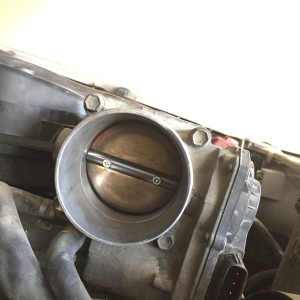

    Had code P0303 and P0304 then:
    1.check spark plugs, had iridium NGK looks still good.
    2. Changed both coils, didn't fix the problem.
    3. Changed spark plugs, put original Toyota-Denso. No more codes.
    4. Does 4.0 hates Iridium Sparks?
    5. Also cleaned throttle body.

    Basically you need 2 terminal repair wires p/n 82998-12690.
    The new clock/hazard switch( I would recommend trading with another member.)
    Then check the link I told you about for wiring. Post #119 and #123 are the best for help. Also I'll be posting more pics there later today.

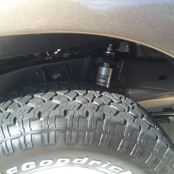

    image.jpg image.jpg Installed new Fox 2.0 smooth body Rear Shocks this morning. :D :kona:
