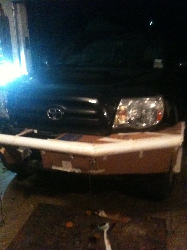

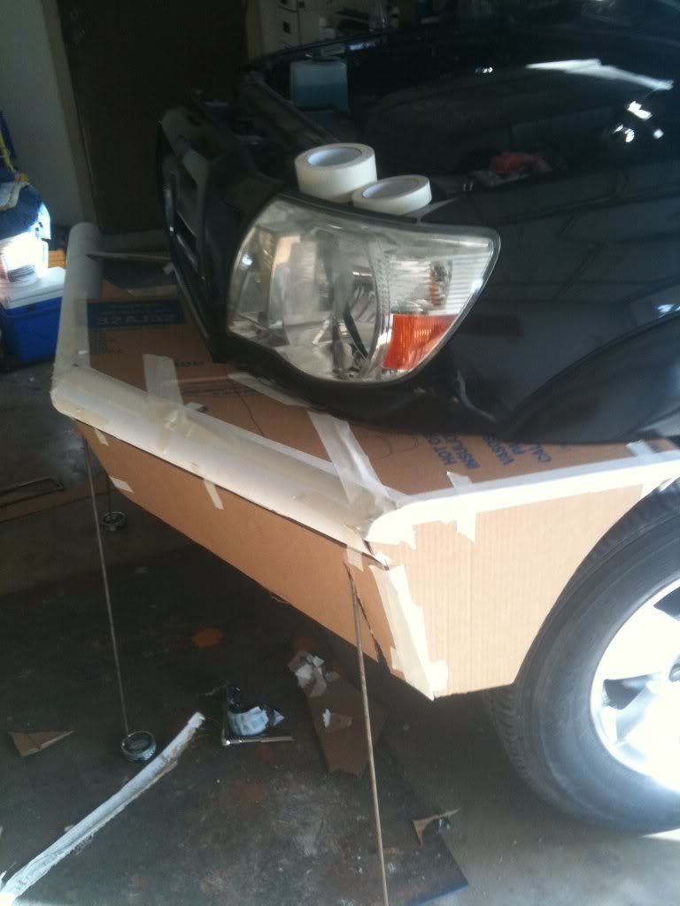

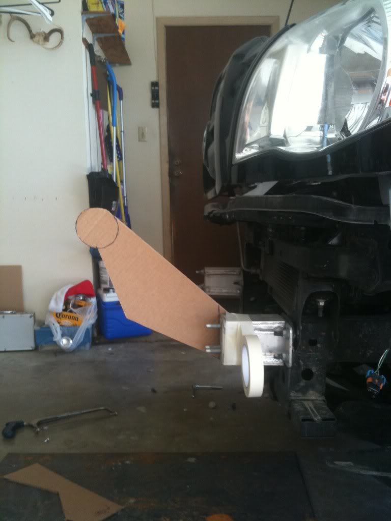

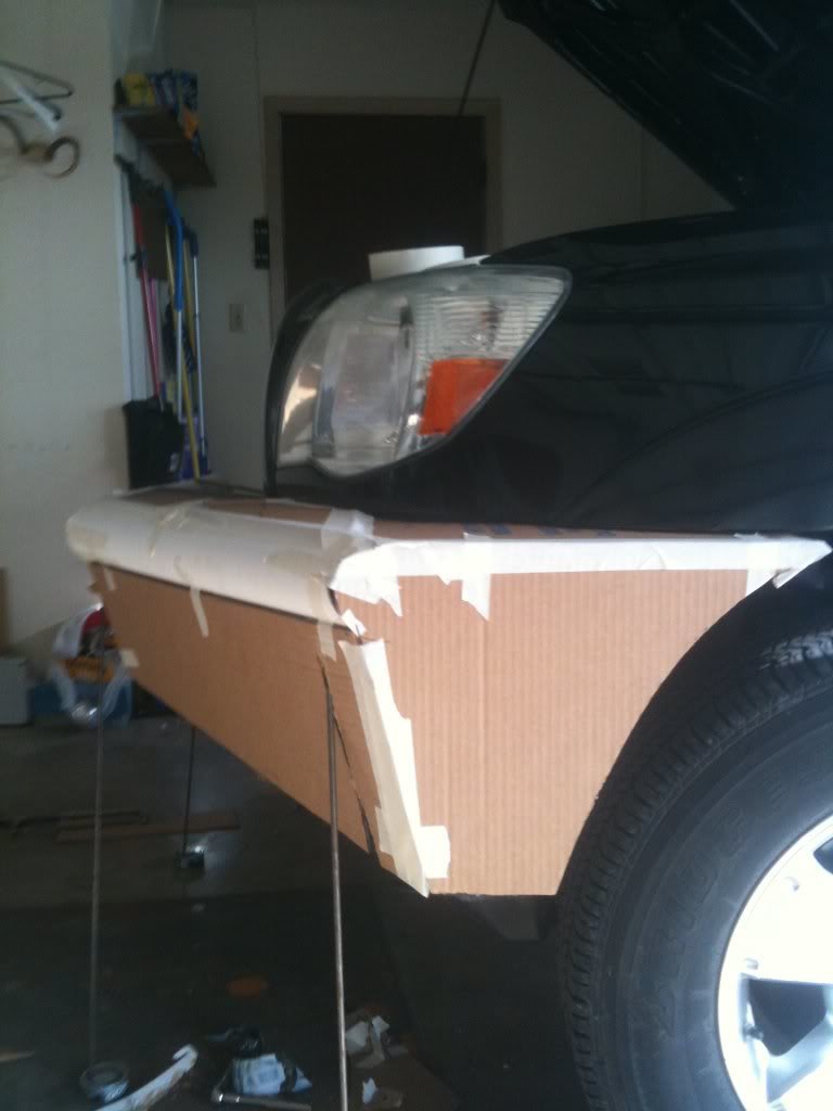

    started my mock up of my twisted metal bumper.

    the bumpers looks a little bulky to me, like it comes out too far. But if you like it, thats all that matters! :)

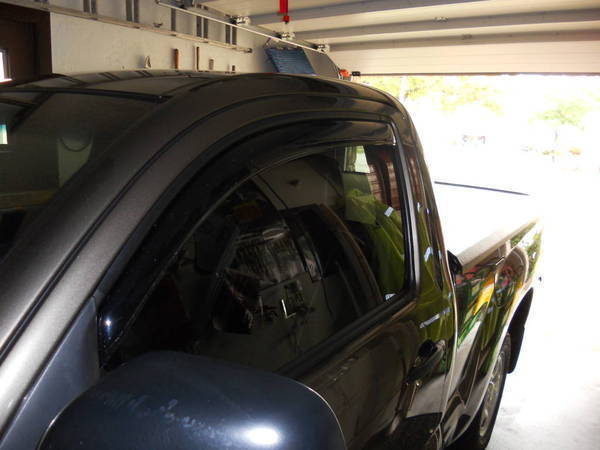

    Got my in channel window Vent visors installed today. It is raining so pics were taken in garage.

    i'd make life easy and scratch the curve around the wheel well...give yourself more space for bigger tires and more room for compression by going more directly to the front corner instead of arching back toward the tire...yea it looks cool mocked up but it'll be a bitch to fab up and limits yourself with performance...
    i even have issues with my arb on full compression with my tire rubbing on the bumper even with my lift...i'm about to hack the bastard to give my tire some more breathing room if my buddy doesn't want to fab up a new bumper for me...he already is in the works on my sliders and rear bumper

    i would deff cut a little off on the sides to allow for travel... rubbing is a bitch
