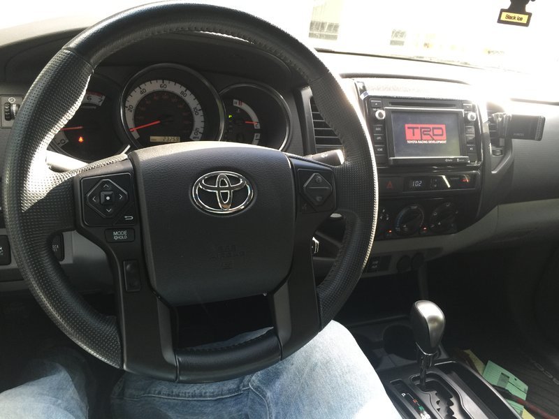

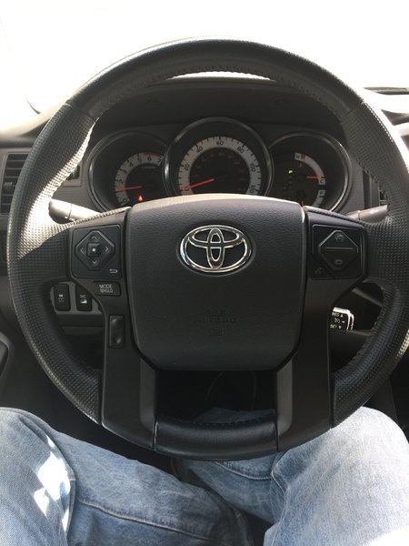

    It was pretty easy. I had the trim pieces out of the truck in less than 5 minutes. And then I just prepped with steel wool, washed, air dried and painted after

    You had all these trim pieces off in 5 mintues? :bowdown: Even the shifter bezel thing
    How exactly did you prep them? Seriously very interested, love how it looks

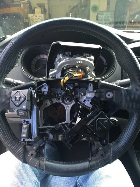

    I had the steering wheel trim off in 5 minutes, everything else has been black for a while now. The bezel below the shift knob comes up very quick as well. What I do is pull the rubber cup holders out, pull straight up on the plastic piece holding them in, it's just clipped in and comes up easy. Then I reach my fingers under the bezel and push up from underneath the forward cup holder area, then pull starting at the front, then side then back and it's out. After you unscrew the shift knob you can lift it right out. The vents/ radio surround are a little trickier to get out and take about 15 minutes, they have screws and bolts holding them in. The trim around the gauges just pops right off, as do the bezels around the tweeters on the door panels. I "sanded" all the silver trim pieces using very fine steel wool, the kind that says its for plastic, until it's no longer glossy and you can see the silver paint coming off in most areas. Wash all residue really well off of it using the kitchen sink, then let it air dry. I then paint the pieces normally throughout the day, letting each coat dry before putting the next on and then reinstall. Sorry for the long post here's a picture of a taco

    If you're gonna pull the steering wheel trim pieces off make sure you unhook the ground from the battery for about 30 minutes prior and during the job to disarm the airbag.:headbang:
