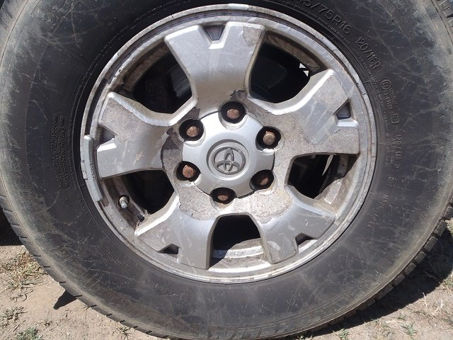

    Jesus those wheels are in bad shape! They will look so much better with the derp. Stuff some plastic bags in the holes to cover the rotors and such. then just start spraying. Follow the instructions on the bottle and shake it like mad for a while. I'd recommend the spray gun attachment so you don't get your fingers dirty. Like spray paint, don't get too close or go to heavy or it will run. Rotate the car wheel 180 and get the spots you missed. You might peel off some of the flakes before hand also.

    How many cans for each wheel is needed?

    1 will allow you 7-9 coats the thicker the better but with light coats

    Buy a few cans. It depends on how many coats you want to do. It's cheap stuff so use it until it looks nice.
