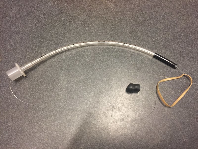

    Changed the spark plugs and woke up to a cracked windshield.
    Made a pickup tool to pull the plugs out since I left mine at home (I changed the plugs at the station).
    I present the Endotracheal rubber fishing line pickup tool.

    I'm clueless, I have never changed my plugs yet. But I am curious about this special tool. Why do you need it and what does it do?

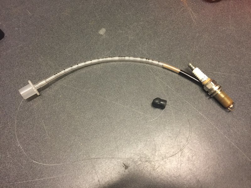

    You have to reach down in the area where the plugs are to grab them and pull them out after you loosen them. Here's a link to the thread that shows you. You could also use a pair of line nose needle nose pliers to do it.

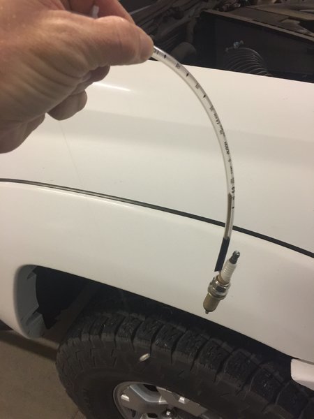

    The plugs are down in a hole in the engine. It works like this to pull them out. When you pull the coil packs off you see how far down they are in there.

    Makes sense. Thanks for the explanation. I will remember that.

    Welcome man. Driver's side is a little aggravating but easy to do. Save yourself some cash and do it yourself.

    I used one of these when I did mine - just make sure the diameter is small enough to reach down to the spark plug.

    Or you could just buy a 5/8" spark plug socket from anywhere that sells tools for around $10.00 and be able to install the new ones without cross-threading them as well.

    Haven't found one yet that would grab them and pull them out.

    I have one, just used it last week. Worked like a champ.
