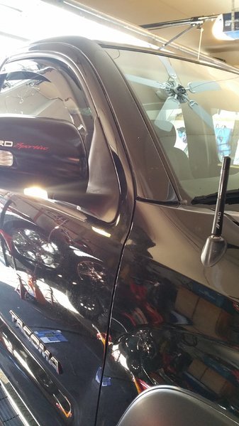

    shorty antenna, good call. I did that a day after I picked mine up

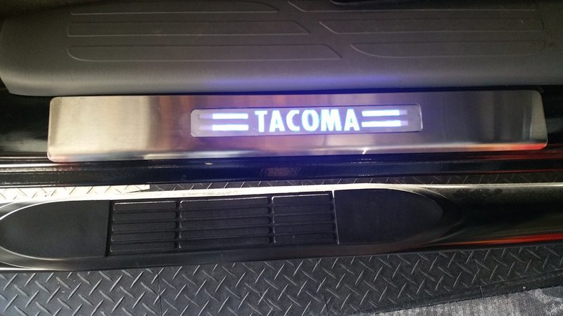

    I like those sills where did you get those?

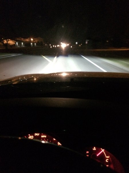

    Finished my H1 retrofit install last night.

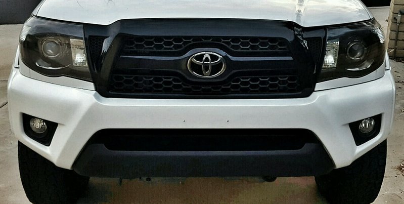

    Custom Grille TL Retro Borla Muffler
    Finally finished!

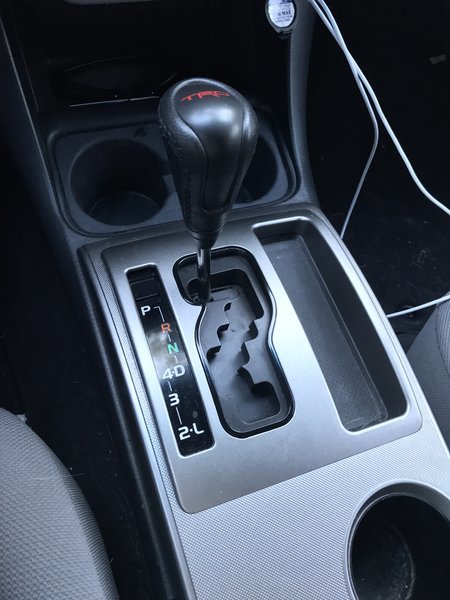

    Painted the chrome around the shifter with my new trd shift knob. Love how it came out

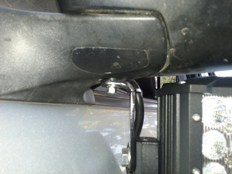

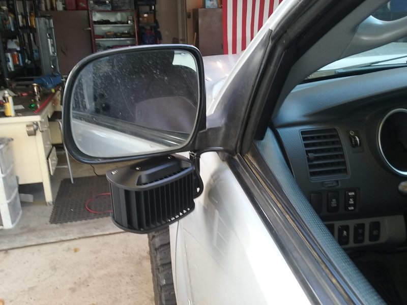

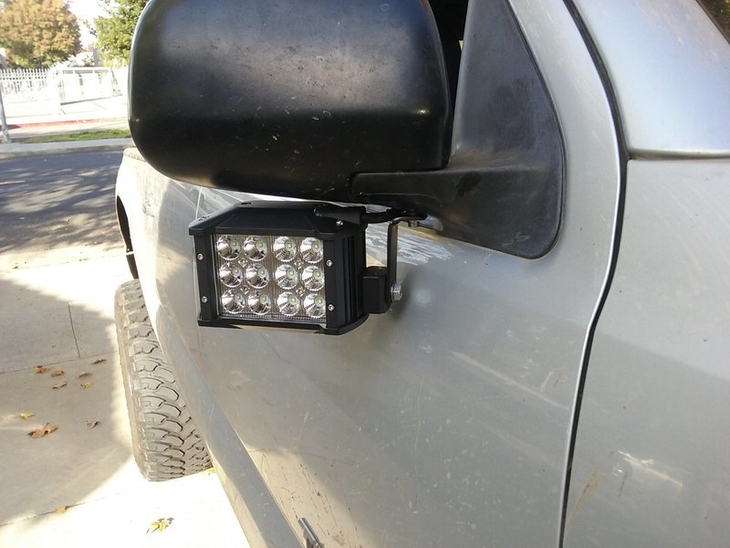

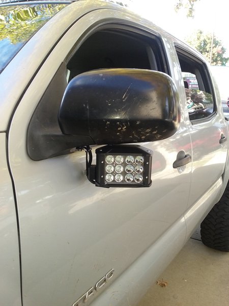

    Made some new ditch light brackets today. pretty simple mod, just bent some 10 gauge into an L, drilled the holes and used an existing bolt hole on the mirror to mount. If anyone wants to do this there's a few things I'd advise, like use a stud instead of the factory bolt in the mirror, it's WEAK! After removing a broken bolt twice I decided to use a stud and it worked much better. I just cut some little lengths of M5 threaded rod to make the studs. Also used a nylon spacer around the stud that fits up into the recess and gives the bracket a flat surface to seat against. IMO mounting ditch light this way is superior to the a-pillar area type that bolt to the hood hinges in that the lights don't glare off the top of the hood/fender, they actually light up the tire area, and it's almost free, about 5 bucks in materials.

    Holy shit, I didn't even know that you could make that fit. more details for the curious please?

    i actually like it as well!! it gives it a nice hybrid look.

    And wayyyy cheaper than a full conversion.
