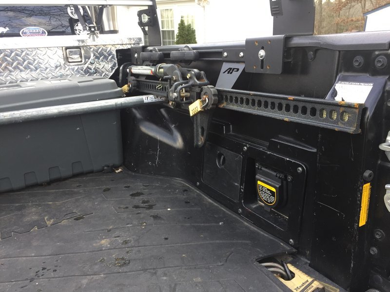

    A couple of rear window decals...
    The 60" just barely fits in a SB, and I had to store the base plate in the toolbox. The AllPro mounts work really good.

    Nice! Make sure to do the initial setup items like scuffing the standard bar's paint mostly off, lubing the gearing, and cycling the components both with and without being under load.

    Those AP mounts are nice... But pricey!!! Think I'll be going this route - https://www.tacomaworld.com/threads/diy-hi-lift-and-tool-mounts.260147/
    Good stuff to know! Appreciate it buddy!

    RE: Hi-Lift jack
    Why? ... and lube with what?

    Why what? Prep it? Because the thing is capable of killing you.
    Use whatever metal lube you want. Hi lift ships a fairly generic one. Lots of people just hit it with wd-40.
