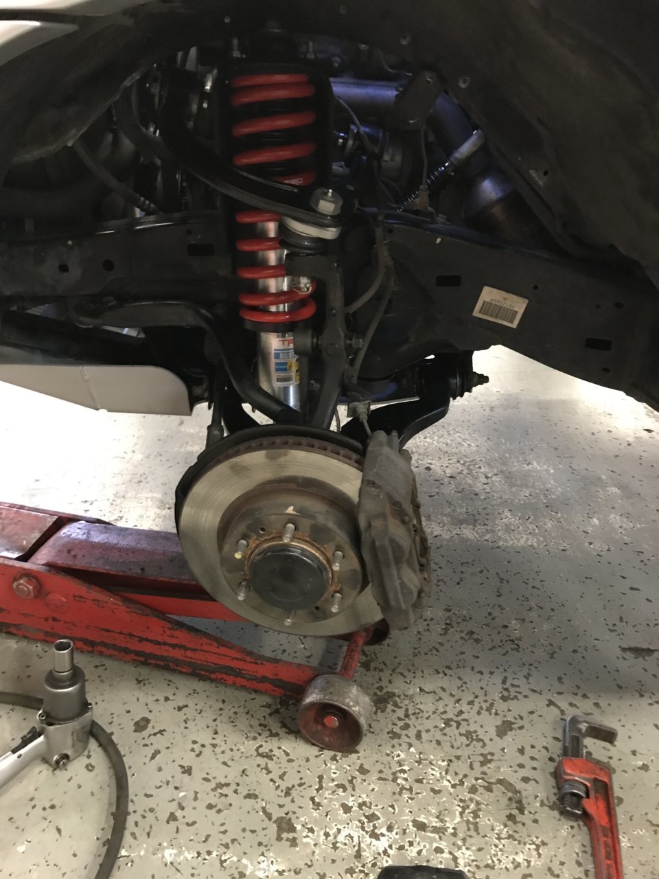

    Yeah I read that stock coils are fine. But saw somewhere on her that if you were to run 884 or 886 etc. That could damage the shock? Is this true?

    I can't imagine it is. Someone correct me if I'm wrong, but I don't think the 5100s are long enough to damage the spring, or vice versa.

    Negative. People run 5100 with those coils all the time. I had them paired with 884s for a little bit.

    What height did you have bilstiens set @?

    With any of those coils you set them to 0. The spring provides the lift.

    Everyone here is on the same page, but y'all are confusing each other :rofl:
    With stock coils, you can set the 5100 at any clip/height you want. That's their main selling point.
    With aftermarket coils, you typically leave them at 0. The only time I've seen them not at 0 is with the eibach coils and they can get set to 0.85

    thanks! So I can set up to 2.5" on my stock trd sport springs then?

    Sure can! Now whether or not you'll be happy with the ride is a different story.
