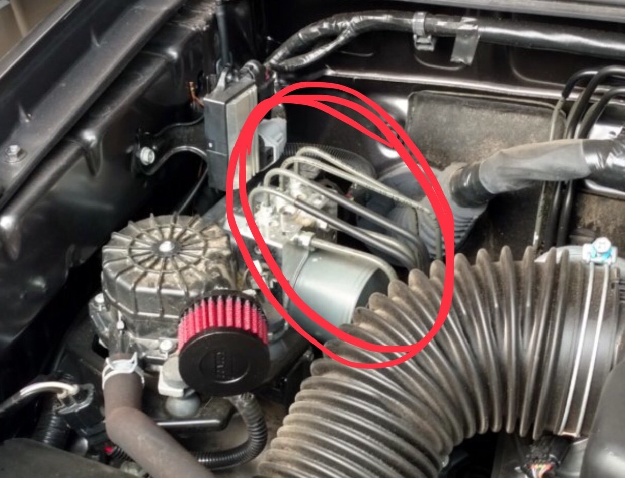

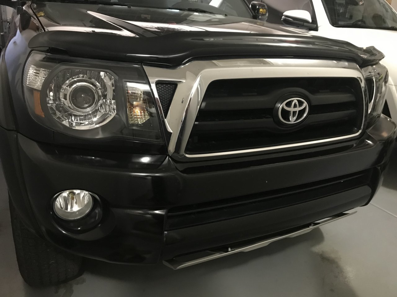

    What is

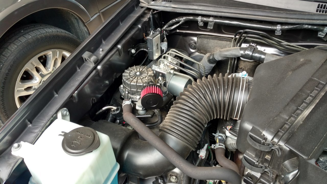

    Okay but what is this device lol

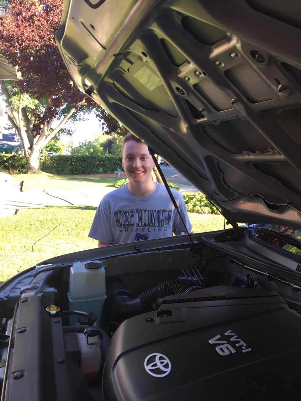

    Had my 15 year old Grandson install the Redline Hood Struts/springs. He did a great job He helped his brother and me do a brake job on my 02 Tacoma during spring break. He his brother(17) and twin sister will be living with us from now on so will all the help I need and they can learn. That hood is easy to open now for this old man

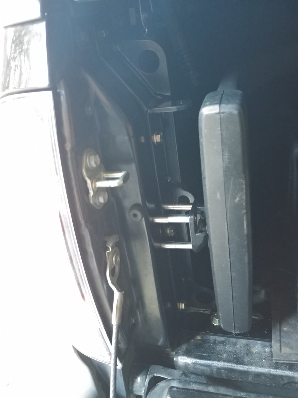

    Total Chaos Bed Stiffeners done, and bed extender modified to fit.
    (had to finish the left side after swapping some hardware at Lowe's, so I just finished today)

    ABS module?

    Wut..?
    WHERES MINE LOL. what year is your truck

    That's not my truck. :thumbsup:

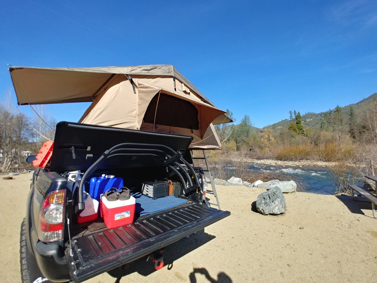

    I kinda followed this: https://www.tacomaworld.com/threads...feners-with-amp-research-bed-extender.484522/
    ...but my hardware was slightly different. I use six 1" spacers, four 3/4" spacers, and two 1/2" spacers. Two of the three bolts that hold each bed extender mount weren't over the stiffeners, so the spacers are longer on those.
    Basically it's a 1" spacer + 1/2" spacer + 1/4" stiffener, or 1" spacer + 3/4" spacer.
    Then the center section of the bed extender bars go inside the outer sections, so I cut about 3" off of each side of the center bars, so they could insert further to make the overall width moor narrow.

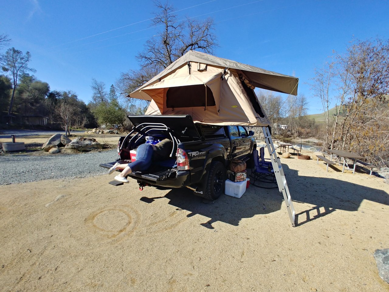

    I use my bed extender to prop up the last section of nut tonneau cover, and it allows me to load/unload while camping.

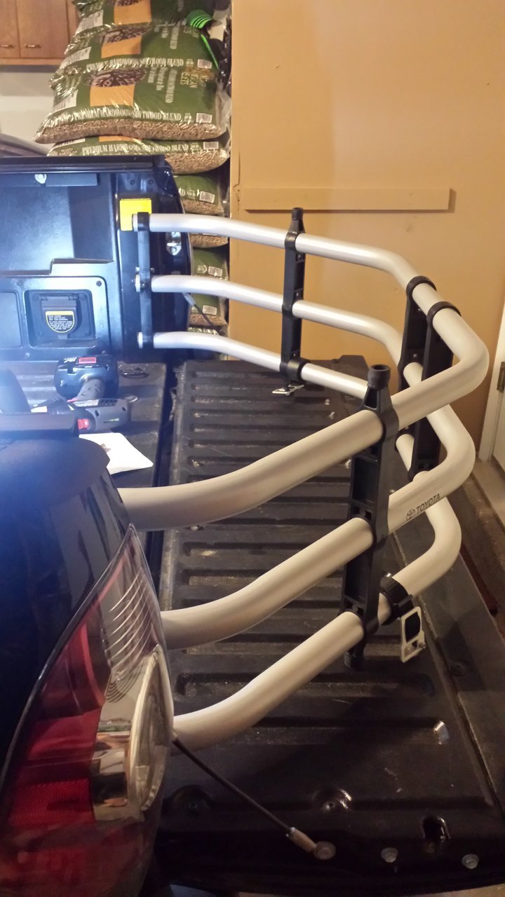

    Mine is a little bit different AMP model:
    But might be the same assembly sort of thing as yours, so I'll have to check that tomorrow then. Thanks again!

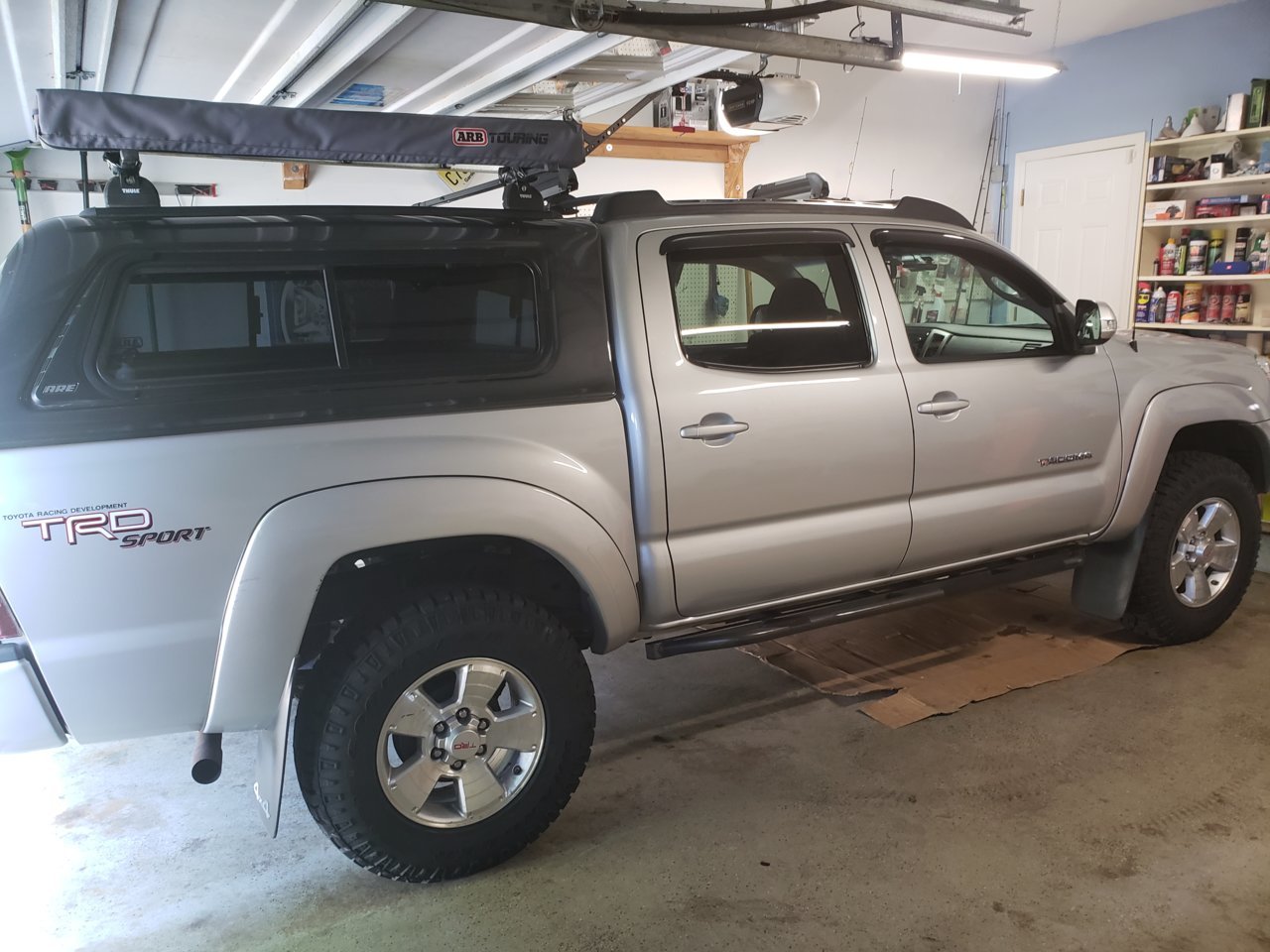

    what type of lift do you have, your truck looks very nice

    Well heck.
    Does yours have that?:eek:

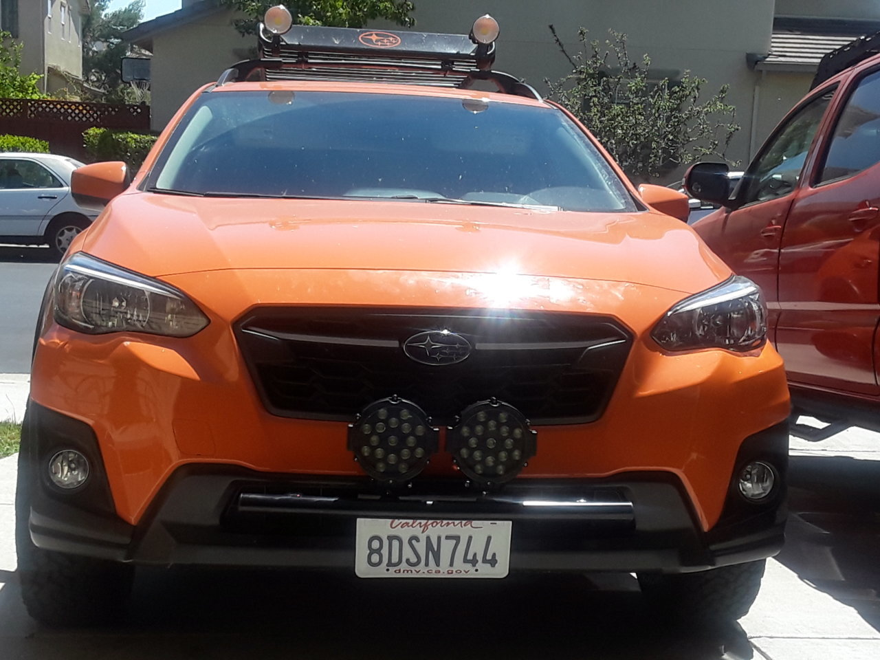

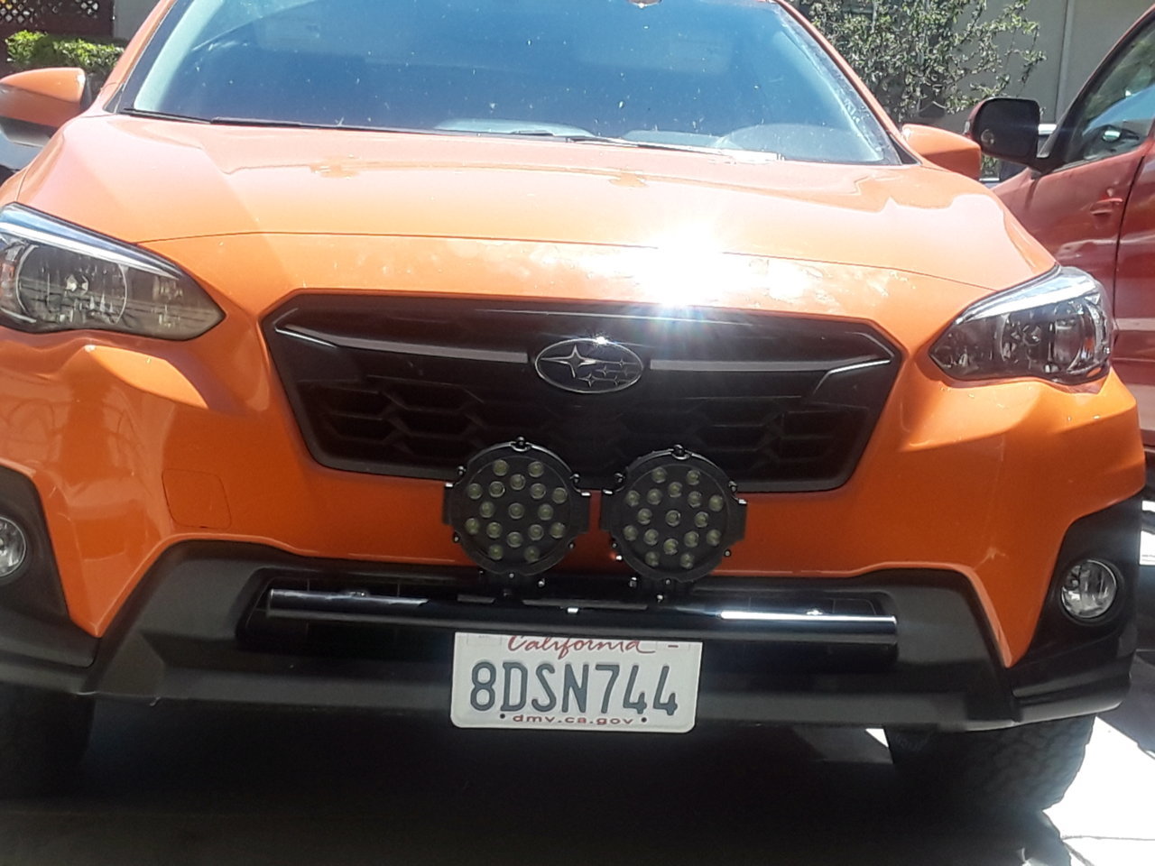

    Did more work on the old lady's Crosstrek. Added a front light bar and some 7 inch led lights. Still waiting on some better lights to mount on the roof rack.

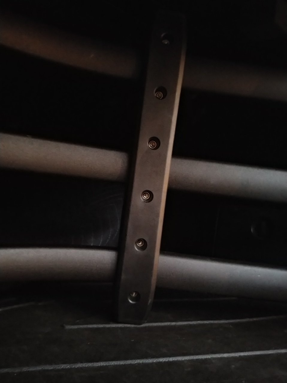

    Hmmm.....
    You may want to verify you can disassemble yours first. If you cannot cut from the center, you're not going to be able to narrow the entire thing.
    Here's my vertical pieces:
    They cover the slip joint, where I cut the smaller diameter bars.

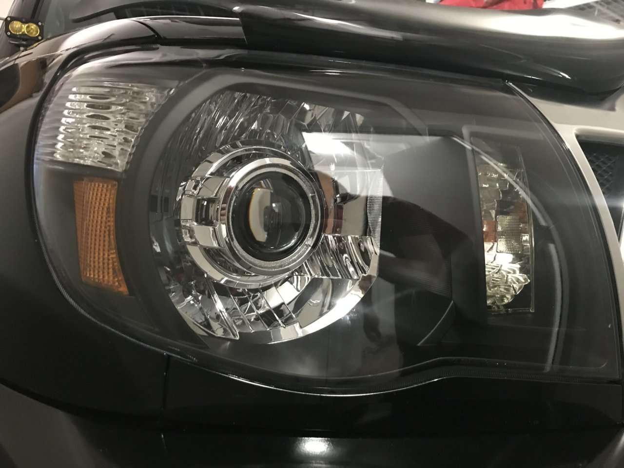

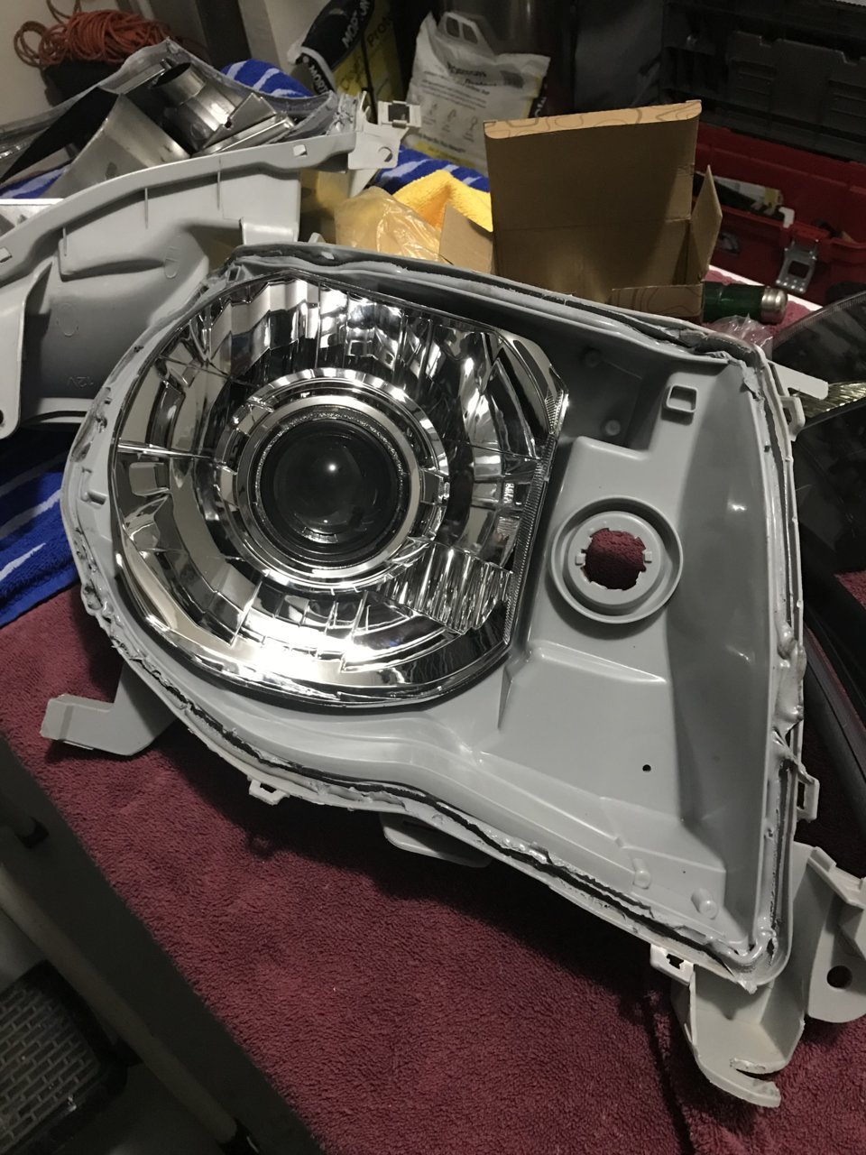

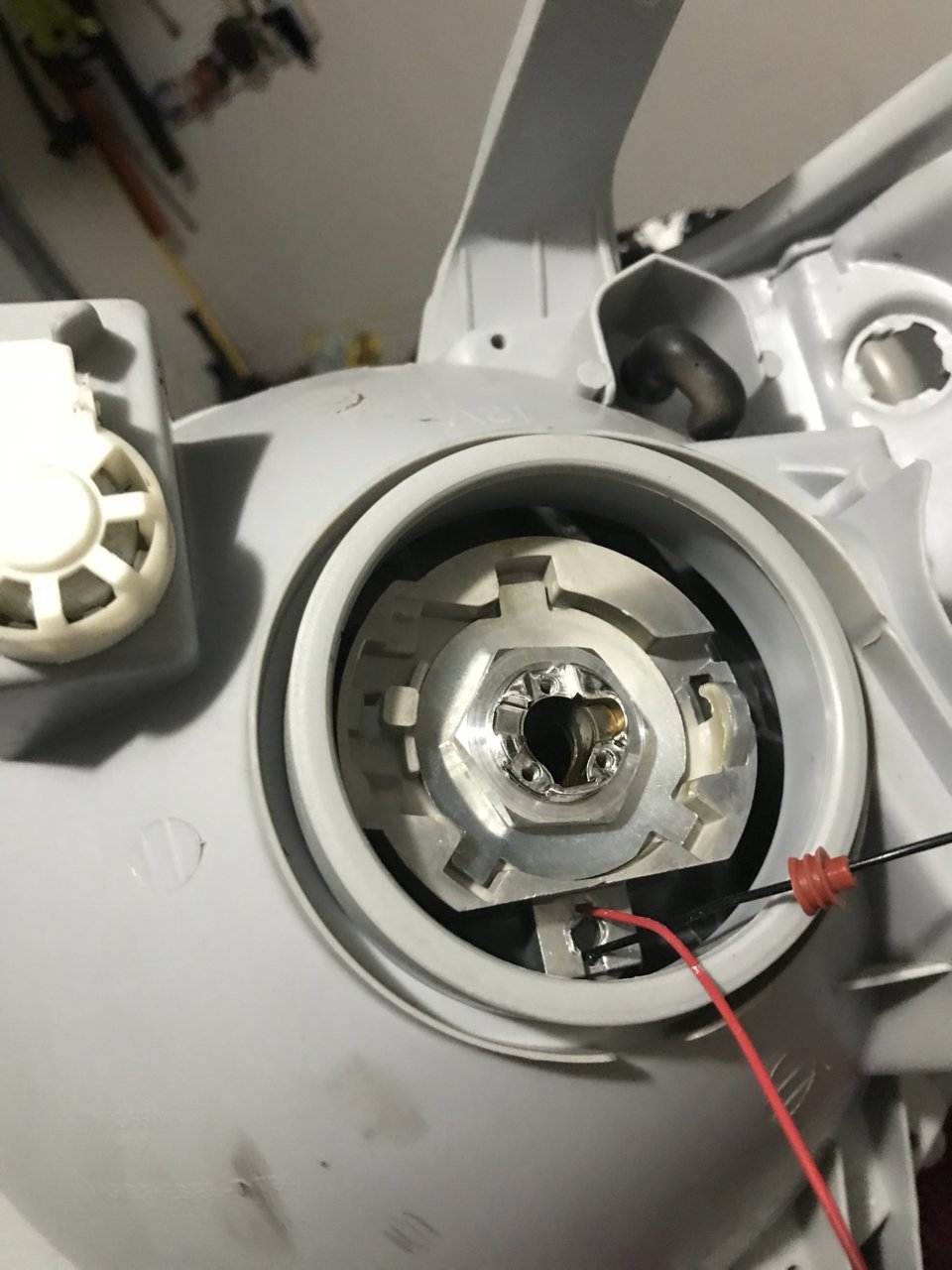

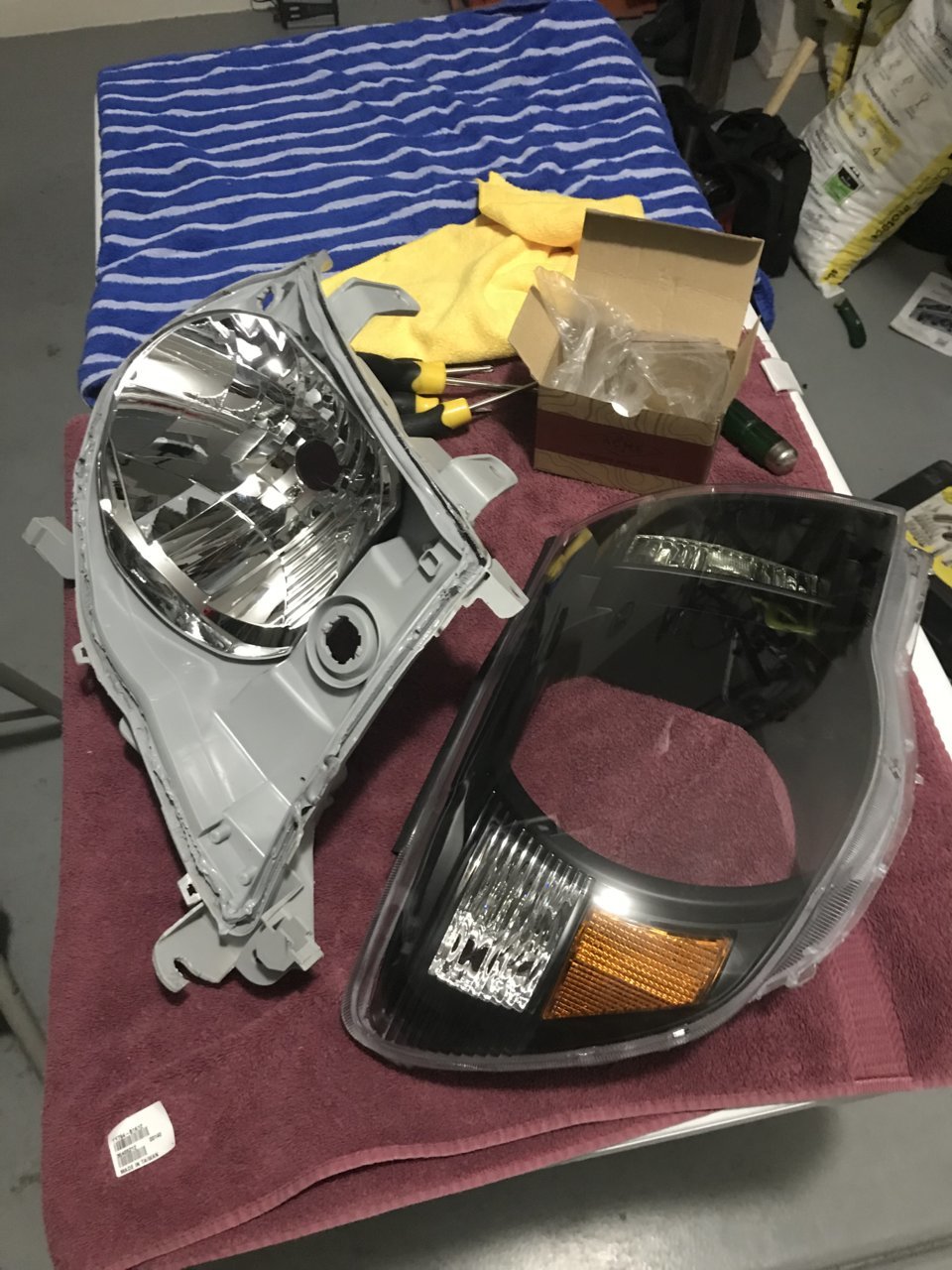

    Do you know if this will work on 2012 and up headlights? I like the whole pnp
