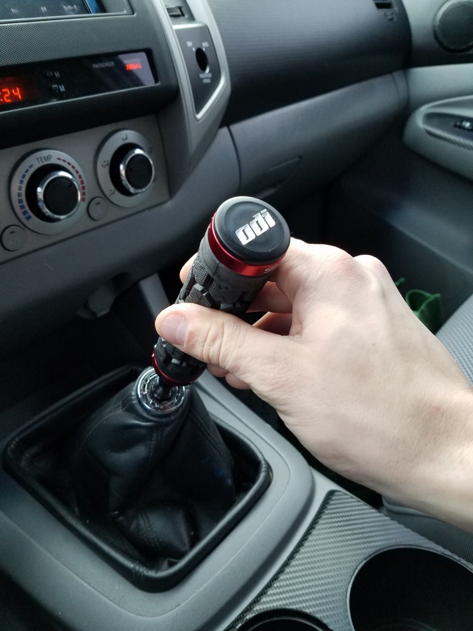

    I made my own for the same reason. 6 inch length of 7/8 OD pipe and an M8 nut coupler.

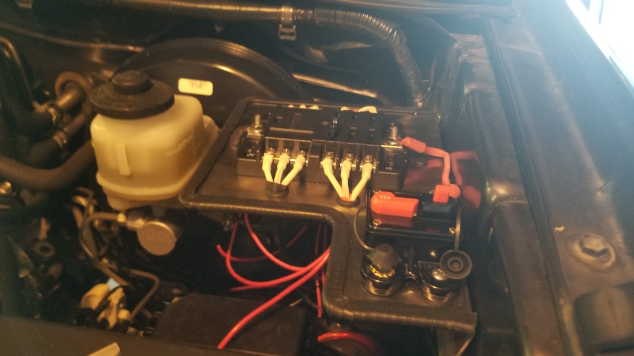

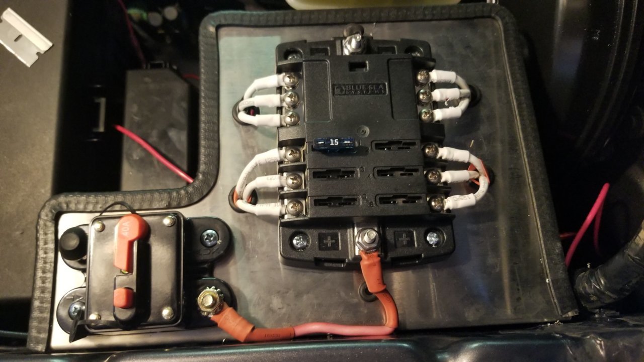

    Had my brother make me a tray for my external fuse box and breaker. Cleaned up pretty nice.

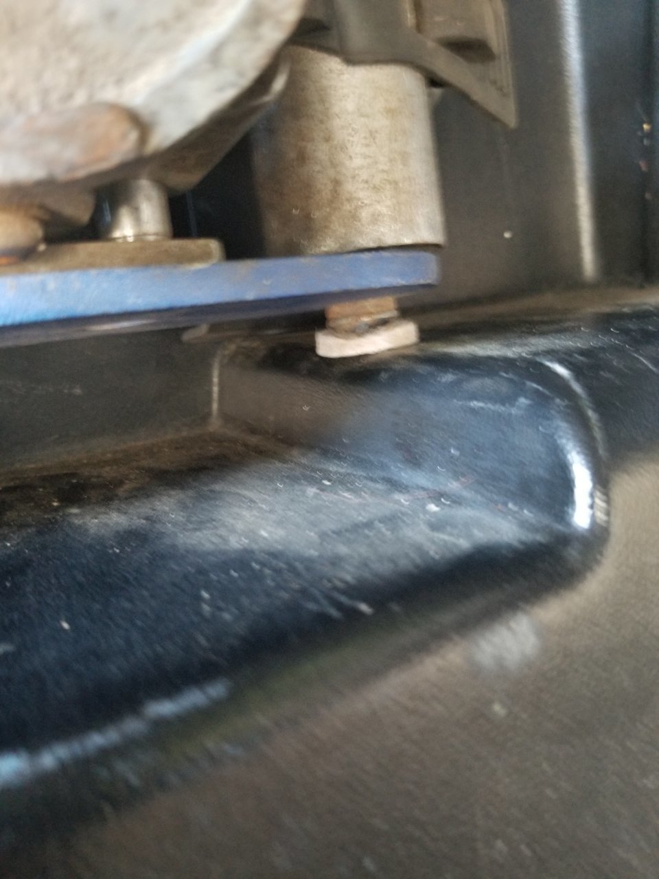

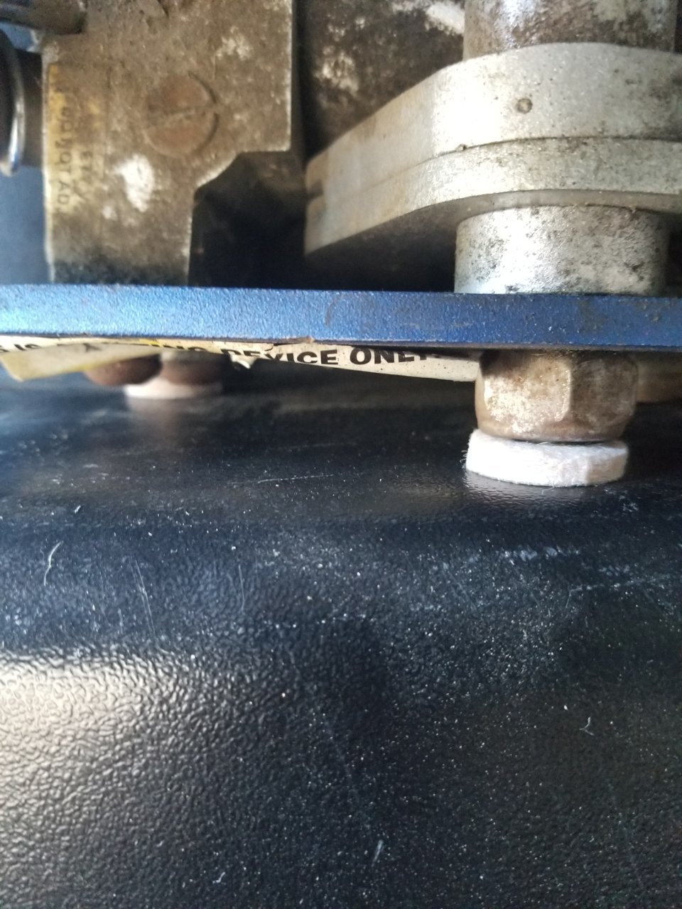

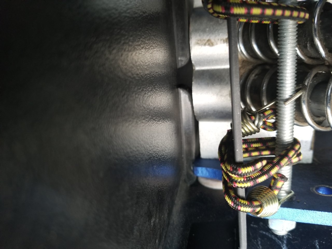

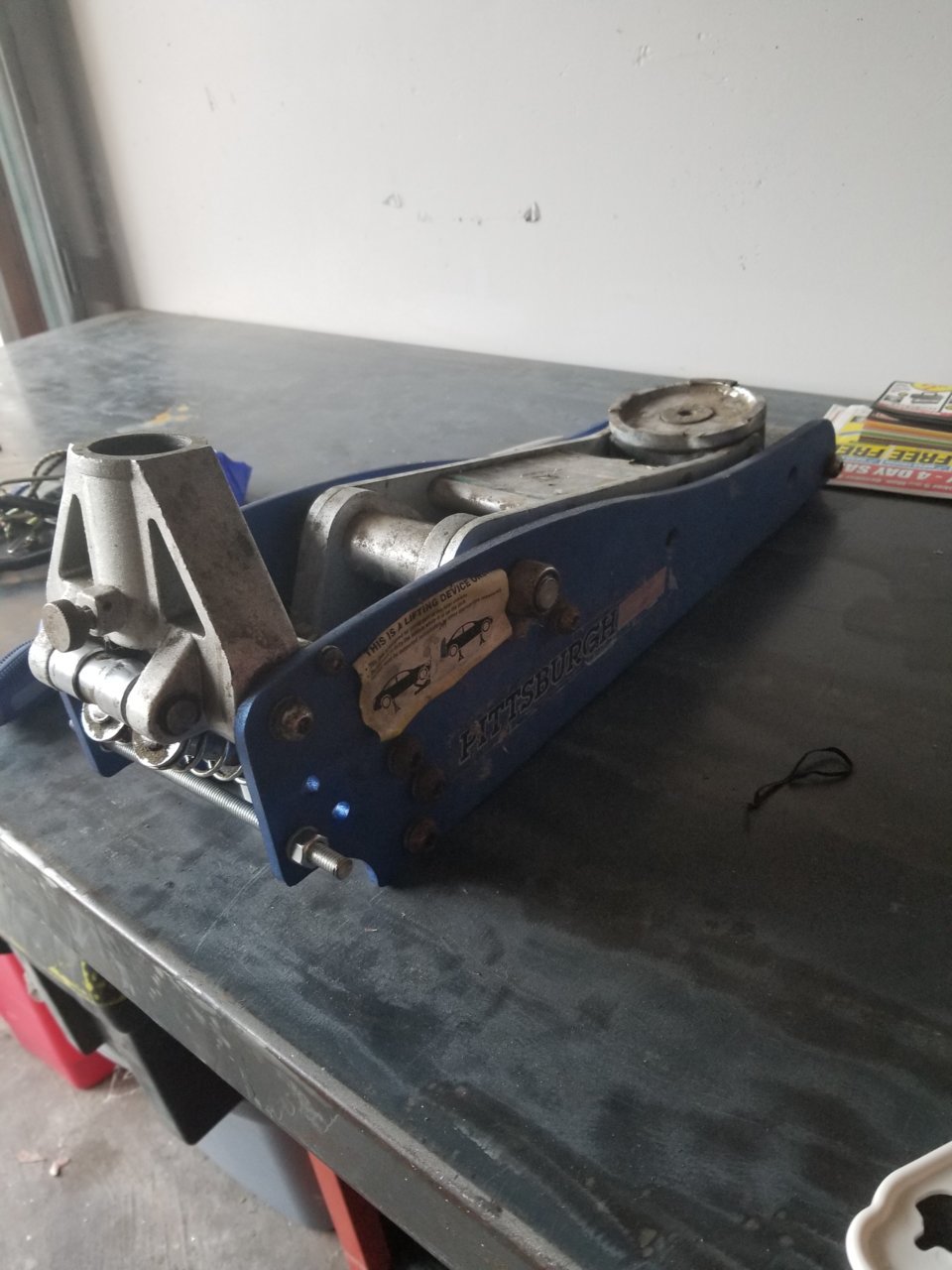

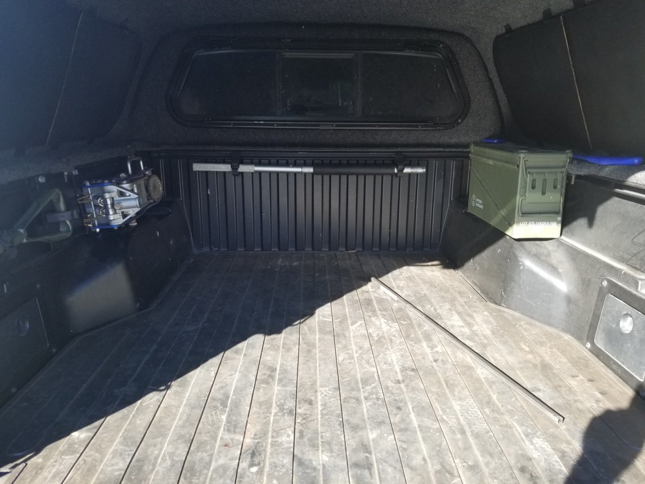

    Came up with a solution for my situation. Lifted and bigger tires the stock bottle jack wont do anything for me, a high lift wont help either because I dont have steel bumpers or sliders. So i wanted a way to carry my floor jack but have it secured incase of a rollover and not have it become a projectile. I also wanted to mount in a way where it wont take much room. So this is what I did, I mounted it above my wheel well and on its side. The jack handle is up front with 2 quick fists and brackets I made. The floor jack is mounted with a quick fist around the roller and the rear is secured with bungee cords to a bracket. I added rubber pads where the jack made contact to the bed to avoid rattling noises and scratching the bed. I removed the rear wheels and added all thread in place with nuts on each end to provide a anchor point. Im actually pretty stoked on it because its pretty solid and doesnt move around at all.

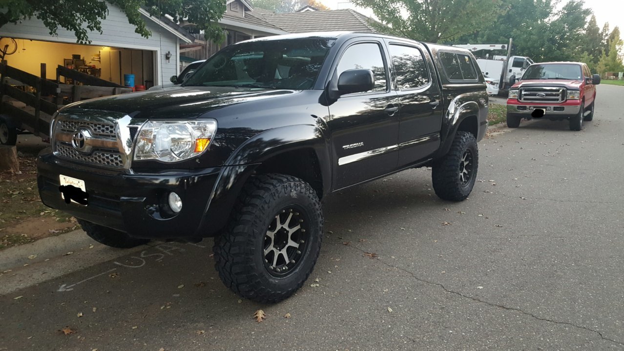

    Over the last week or so installed the lift kit, replaced wheel bearings, got some stt pro's, threw on the mag Mount antenna for my dual band radio and got a full detail inside and out. Cab Mount chop this weekend. Looking pretty good I think for a 2011 with 160000 miles
