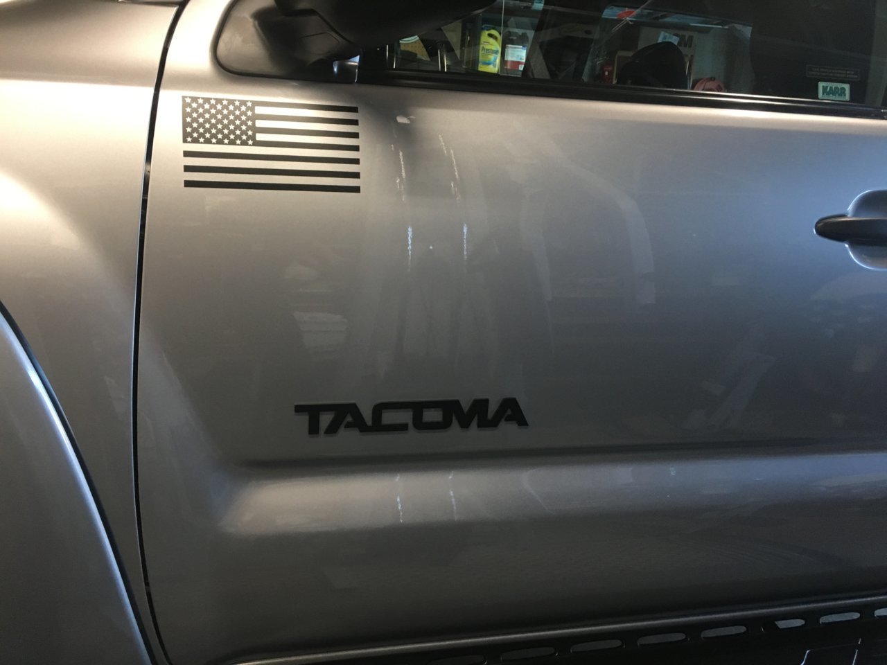

    Removed the OEM side emblems and replaced with some aluminum emblems that I water-jetted this week and had powder coated in flat black. Very easy removal. Used a product called De-Bond that we use at work to remove marine adhesive and used braided fishing line to saw through the emblem adhesive.

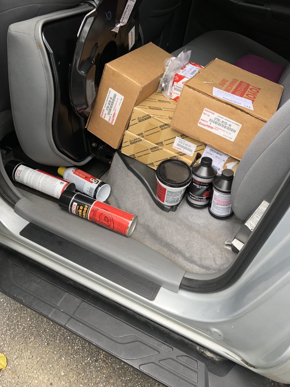

    I used all Toyota parts including new backing plates. Calipers are Toyota reman
    Bigger than stock for for sure. Can definitely feel the difference

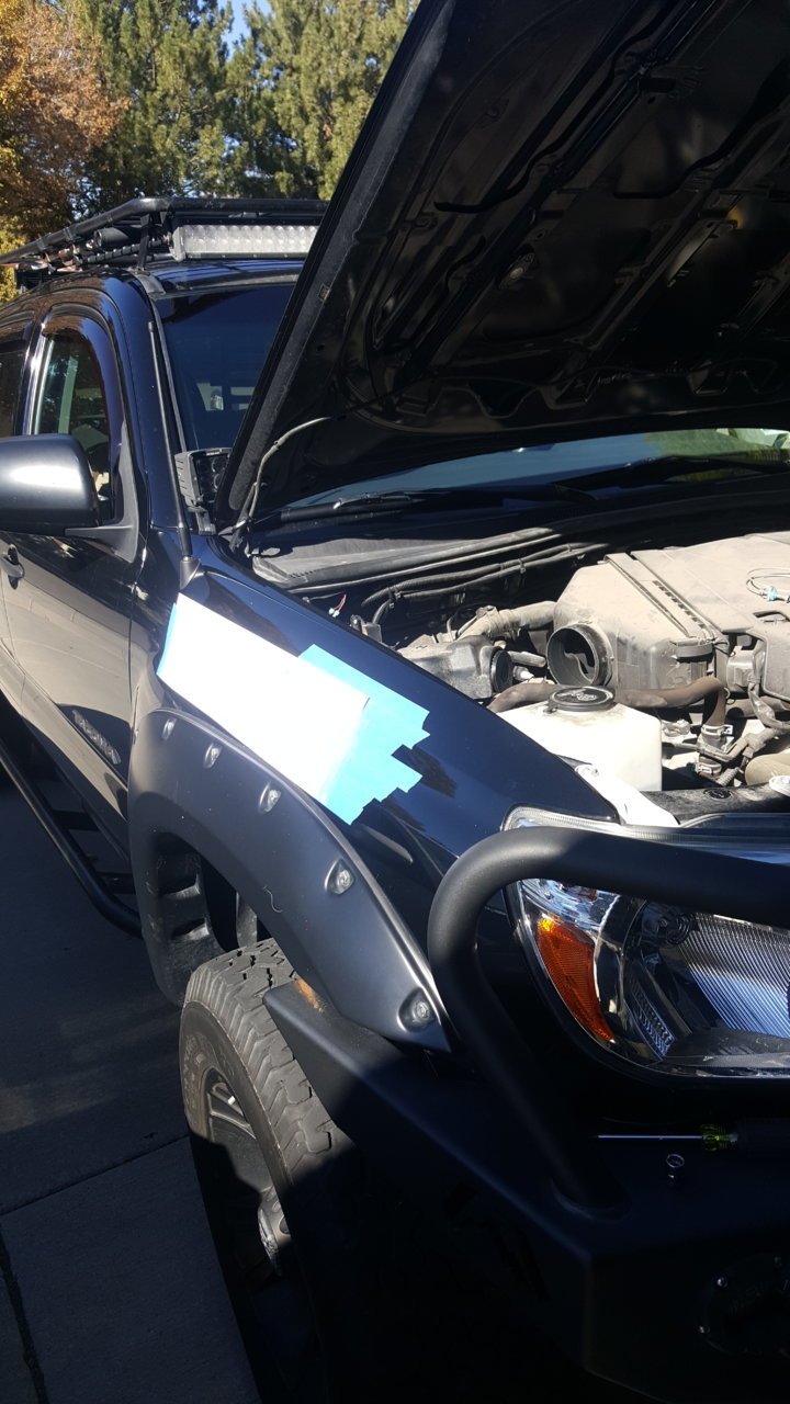

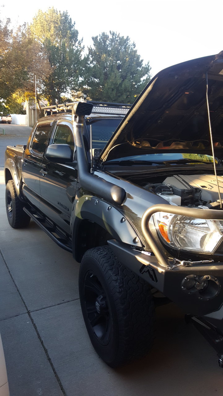

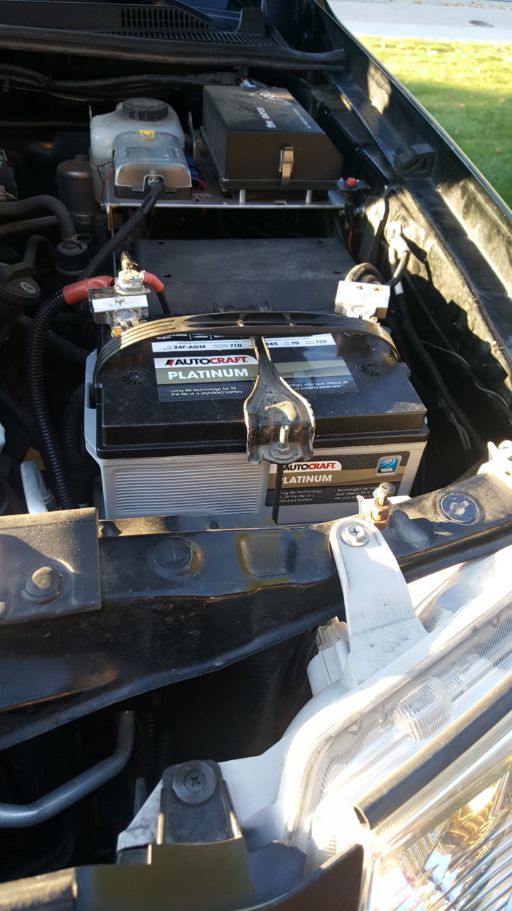

    20181020_175924.jpg Swapped out the battery20181020_175932.jpgAdded a snorkel20181020_144129.jpghuge pain in the butt

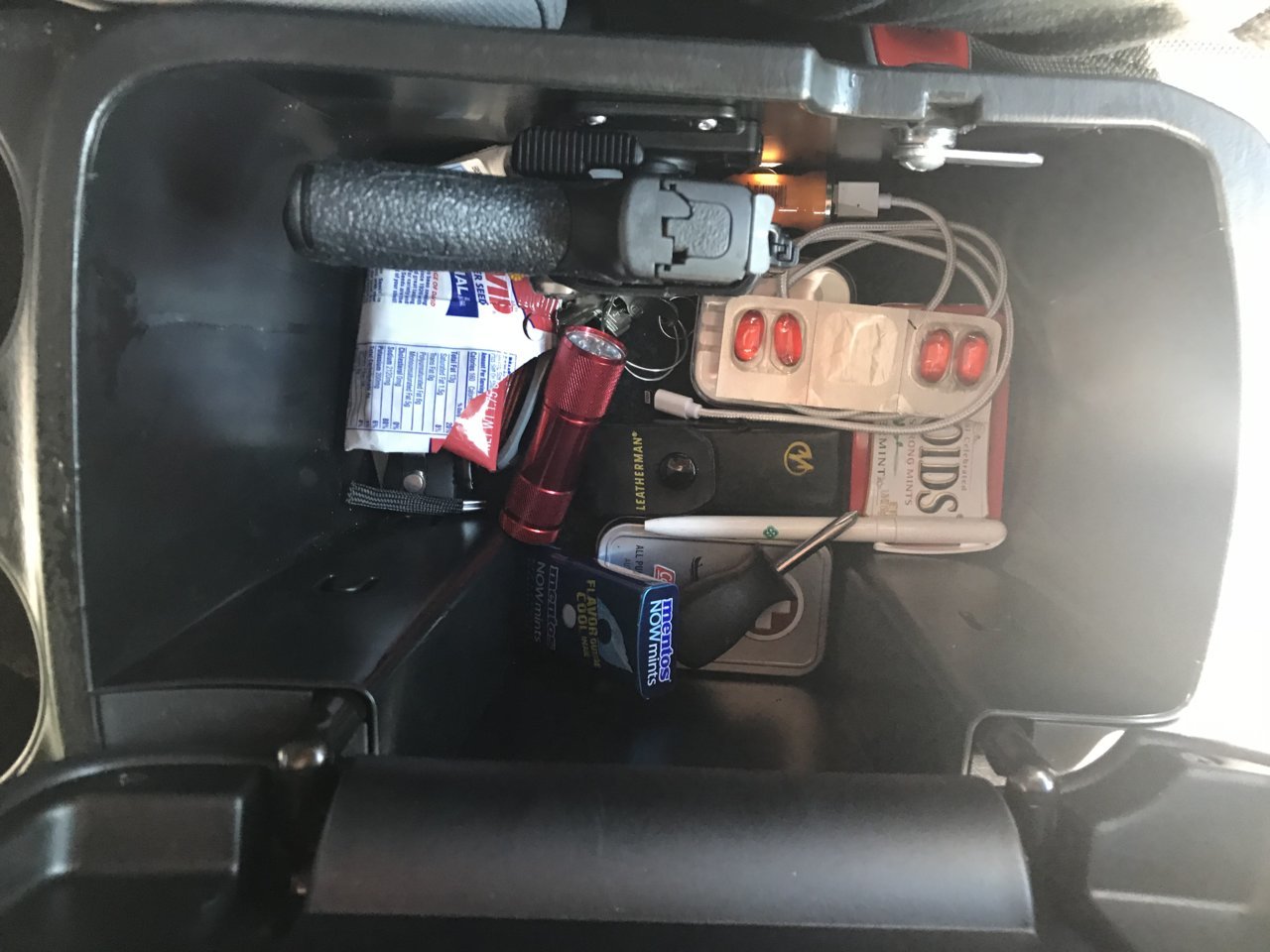

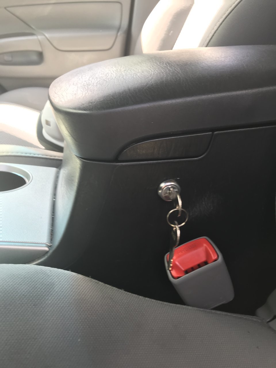

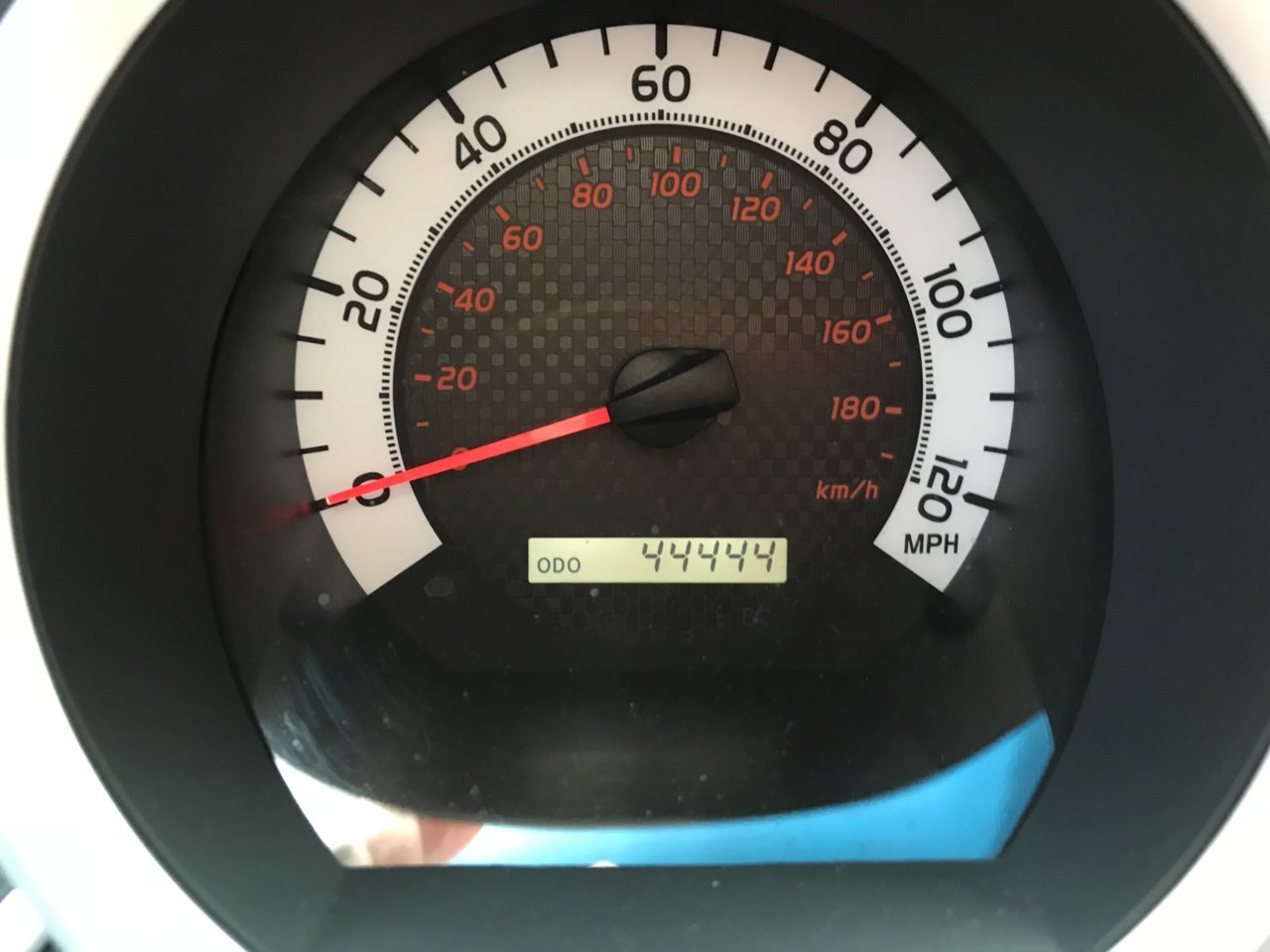

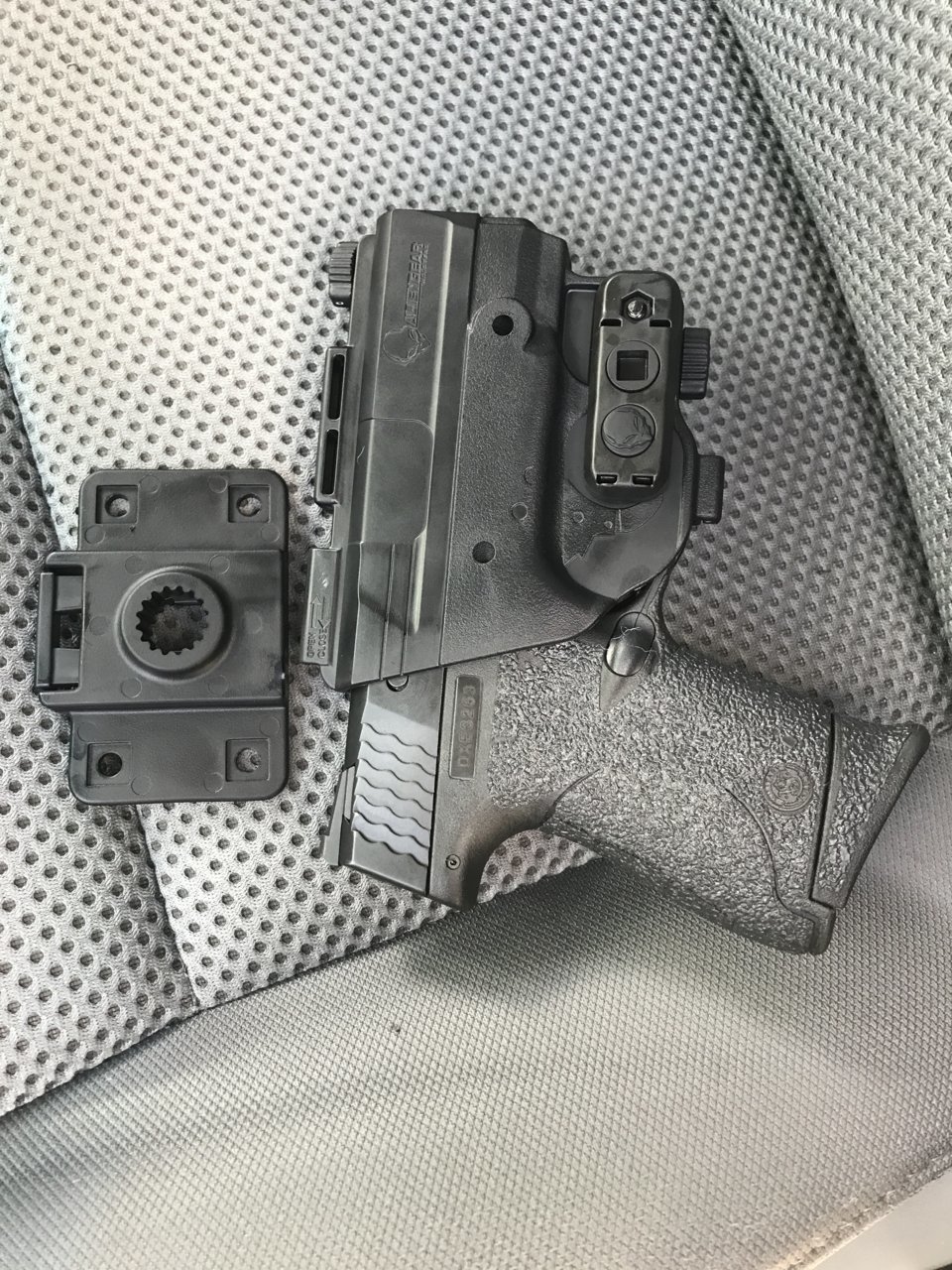

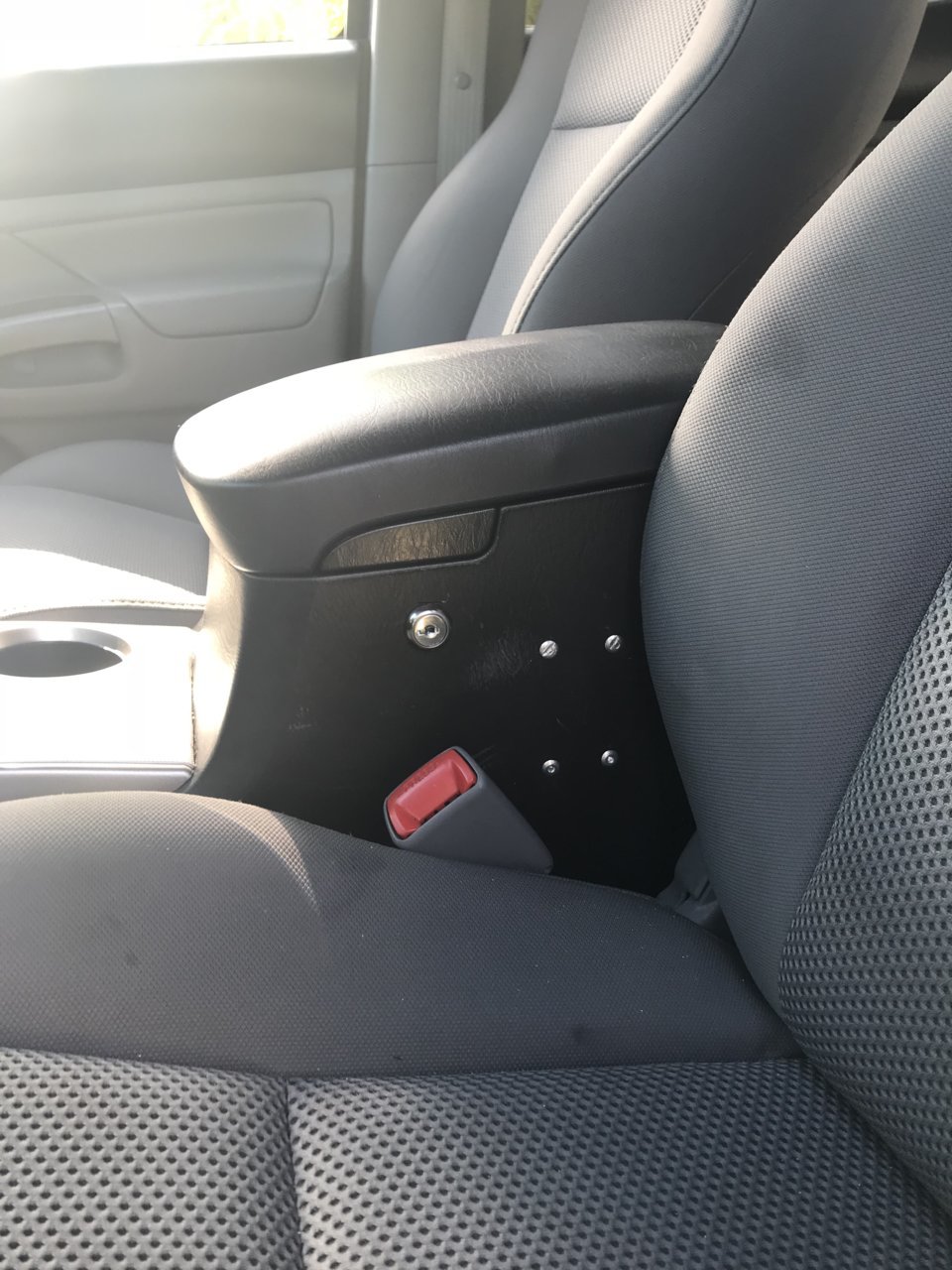

    In addition to a minor mileage milestone, I also added a lock to the center console as well as an alien gear holster inside. Still need to touch it up with some paint but I’m pretty happy with how it turned out.
    BD473BC9-EC14-4086-B5C0-C9A854FF7B4F.jpg C2AE9948-A22D-4484-AB3F-C6B64548C1DD.jpg 609F1BE9-7165-492E-8F62-609267C02A3F.jpg 1A715861-5B5D-4921-A6C2-3EF3271CC415.jpg 61E5F9EB-F7E6-4DB5-8DCC-C118DA38864F.jpg

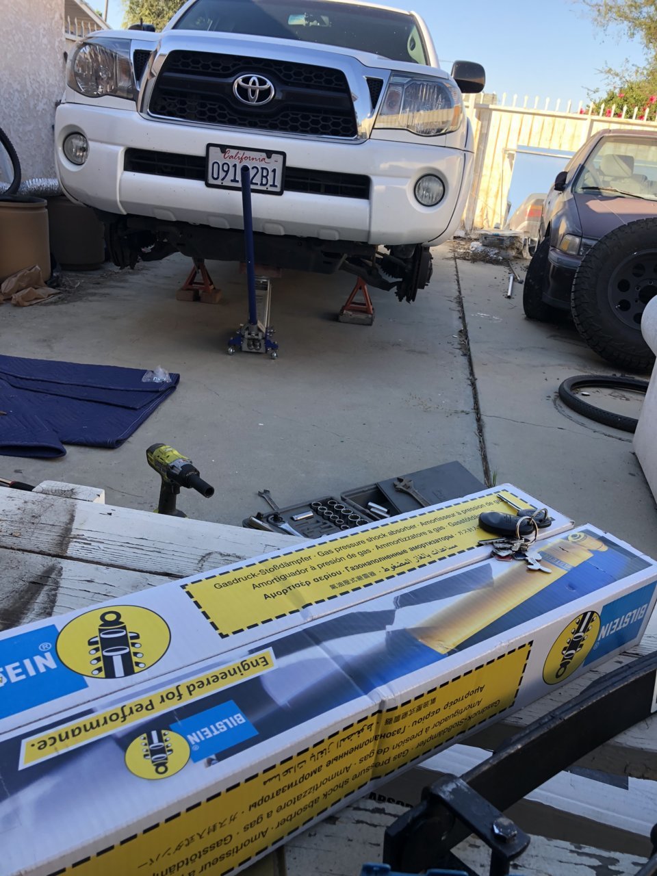

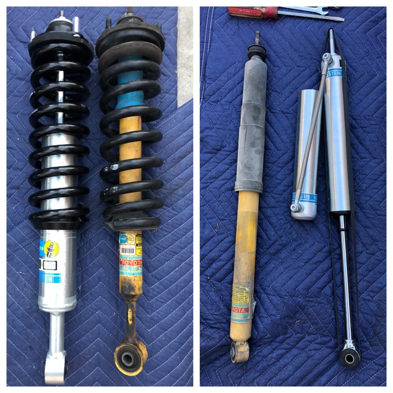

    Installed Bilstein 6112/5160 and Icon 3 leaf add-a-leaf
    Set at 3rd perch, rides nice. Much like stock but smoother and of course added height
    Can’t wait to test them out on some dirt

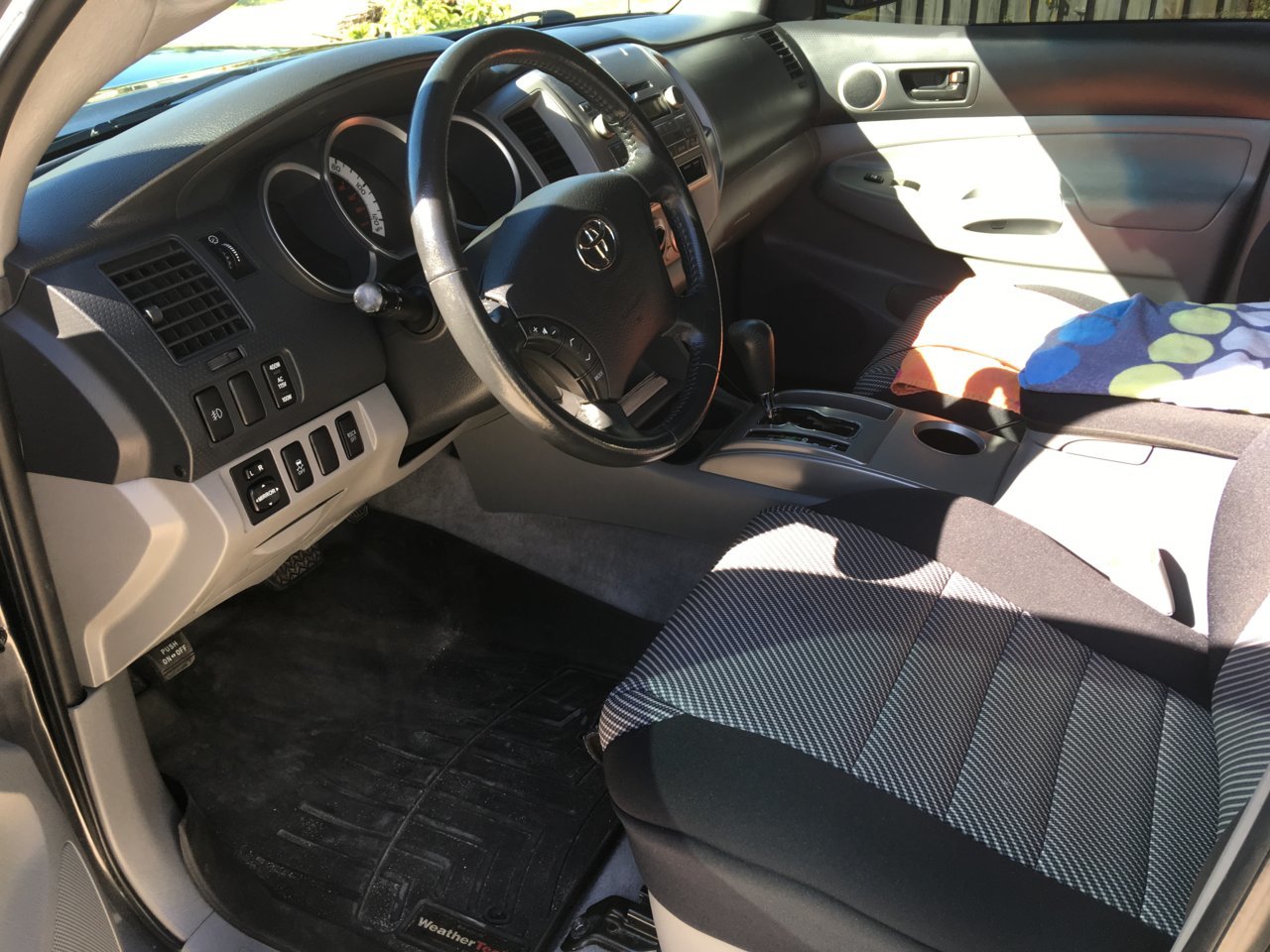

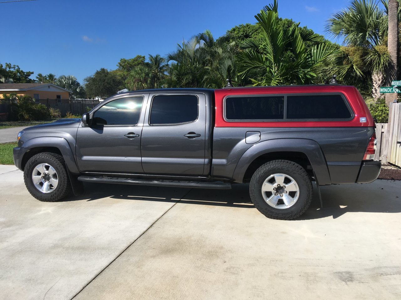

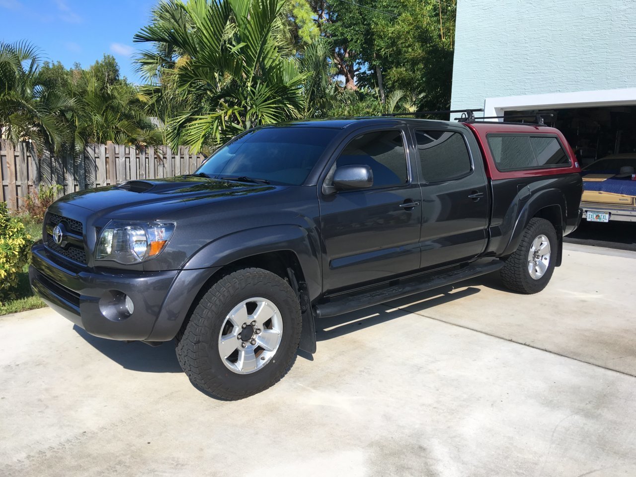

    0F5D96EC-470A-4167-82BA-928115B9081D.jpg CC3E88D1-DAB3-4B92-BD64-A9376E870B7B.jpg 60DBA07D-F4EC-4C6C-9F06-0C298F28C60F.jpg Freshly washed and waxed and int. detail. Just in time for some rain and some bird to shit it up as per the norm.:notsure: Soon to be adding my ADS ext travel resi’s, DK UCA’S, and RXT’s expected this coming Fri. :woot:

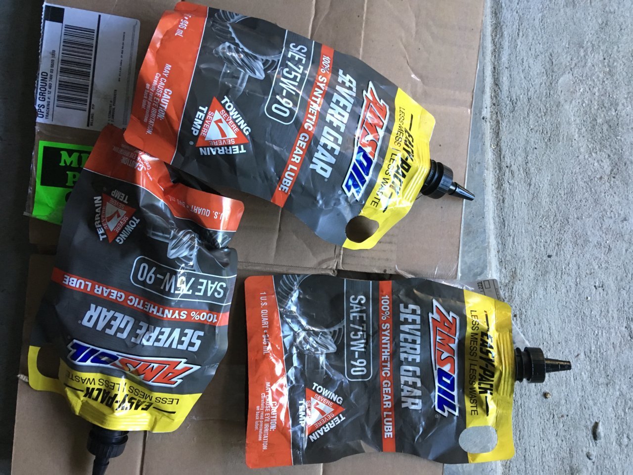

    Replaced Center Support Bearing to get rid of viberations at take off and high speeds. Used a Spicer one that I got off of Amazon and it works like a charm, no more vibes! Also went ahead and changed my rear diff fluid just for some due maintenance and who knows how much leaked out when my rear axle seal was leaking. Ready for the snow! IMG_3875.jpg
