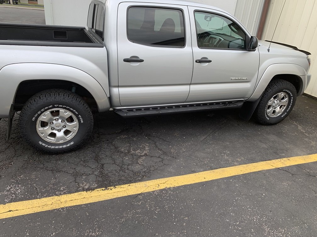

    Well, went and put new tires on the truck. Was pretty worn when I bought it. Now need to go do front and rear shocks, and then alignment. thinking of going with 5100 and ome885 kit I see on Amazon. Honestly, this is DD so not going off road much, unless, when I go to upper Pa to family function.. thoughts?

    Can’t go wrong with that set up. I’ve been running it for a little while and it’s great. You have just enough lift but not too much. Probably still get good alignment numbers without new UCAs. I decided to go with JBA UCAs since I am planning more lift and I have 285/70/17 tires so I was needing to adjust caster to stop tire rub.

    From what I have been seeing here in the threads, was good route to take also. I just want some lift, not too much, and when I looked at the rear shock, seemed pretty worn out, and going over bumps tends to want to bounce.

    That’s where I started too. The only other things I would suggest is an AAL for the rear. And 1/4” spacer for drivers side for taco lean. If you run those 5100s with OME885s in the front you are going to have a negative rake aka bro lean. I added the Heavy Metal 2” AAL from Amazon and it has been awesome. Just need to make sure you grease that thing when you put it in or it may squeak over bumps. If you click my build link in my signature you can get a link to the AAL.
    Between the AAL and 1/4 spacer your are only adding about an extra $80-100 but they are both well worth it imho.
