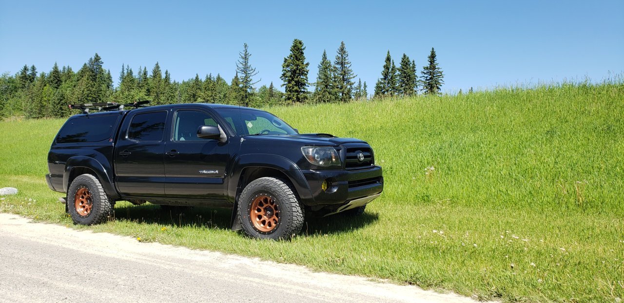

    Wheels and tires mounted and balanced. Next step is to get some suspension purchased. Need a little more clearance for the offset of the Ray 10's.

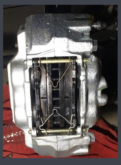

    Every time I go from reverse to forward, I hear a clunk. Its the brake pads shifting from the back of the caliper to the front. Seems to have gotten worse as the pads have worn more. On the 2nd gen Tacos the pads ride on pins, unlike other vehicles that have spring clips that lock them into a position. Adding a second spring clip supposedly takes care of this issue. I have not tried it yet since I am still on the original pads, but I plan to.
    Pic for reference, not my truck.

    Any idea where to order the 2nd clip? I'm 99% sure this is happening on my taco. 40k miles, OEM brakes. Trying to get another 20k off em before I replace. Thanks

    I believe this is the part # for the spring clips: 049470C010
    I have 64,000 on mine and the pads still have plenty of life left. I hope I can hold off until 75k. I usually check them every 5k when I rotate. Oh and I am also thinking about doing this upgrade when the time comes. Decisions, decisions. LoL :)
    https://www.tacomaworld.com/threads...t-oem-parts-part-s-provided-installed.443656/
    There are a few variations throughout the thread.
