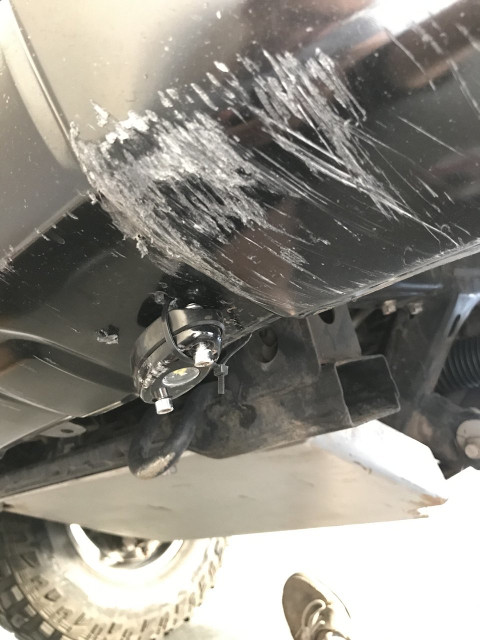

    Stellar. Hence why I just praised them again. Mine have been bulletproof. I even smashed one of the lights against a boulder while crawling & it’s fine. No issues. I just had to put some washers on the bolts so that it held on the holes that I drilled because the holes got a little bit bigger when I smashed my bumper against the rock

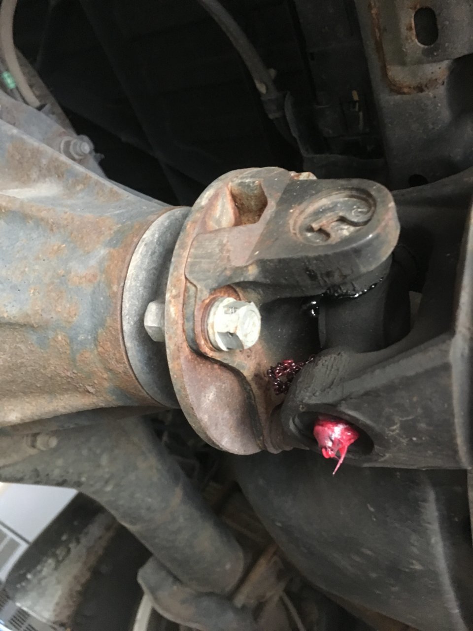

    -Greased my drive shaft (yes I cleaned that up before i drove it)
    -Re Torqued my drive shaft. Good thing I did because the front to the front diff was loose by 1/8 of a turn on all 4 bolts.
    -https://www.tacomaworld.com/threads/the-torque-spec-guide.318116/

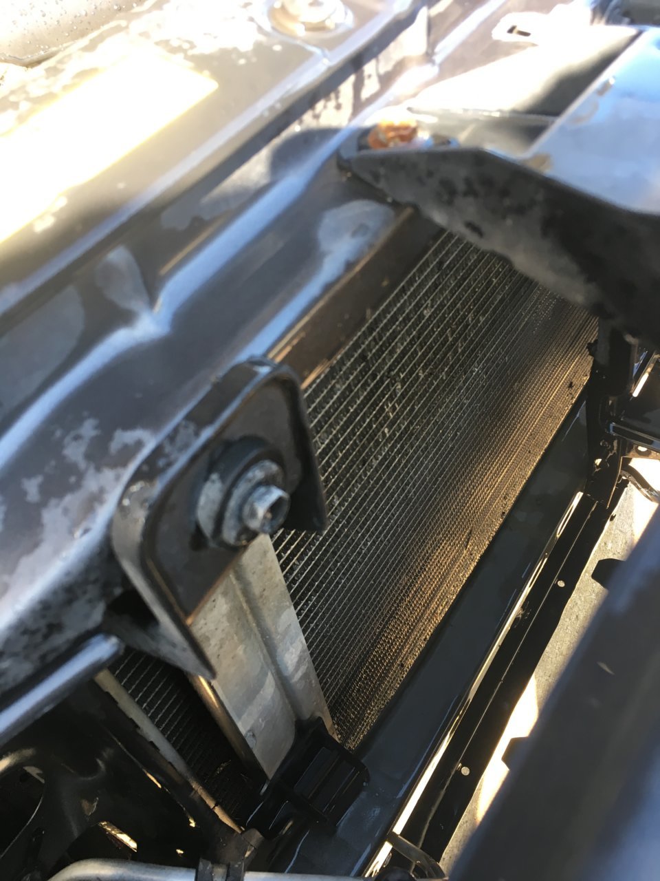

    -Cleaned my AC condenser coils. Actually Saw a little improvement, although mine were not that dirty.
    Before Cleaning: 66 degrees outside/ Blowing 45 degrees full blast/ 45 MPH
    86/46/30
    86/46/50
    After Cleaning: 66/44/55
    64/42/50
    88/44/55

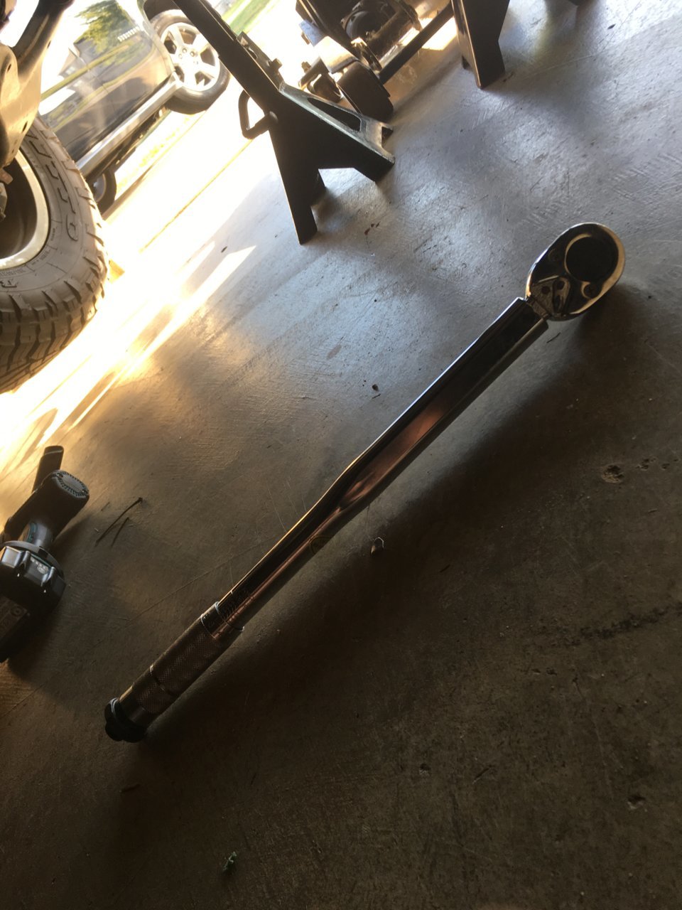

    I need a new torque wrench!!
