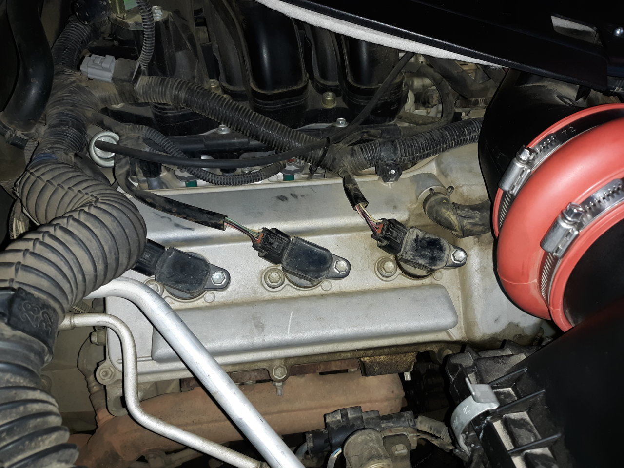

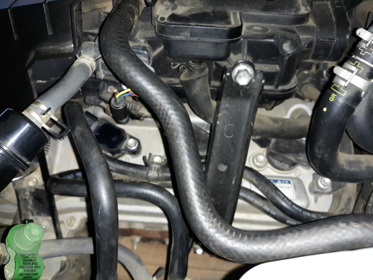

    Couldnt be easier actually.
    The only pita is the front drivers and only because its impossibly hard to unclip.
    An 1/8" more wire would have made it much MUCH easier.
    Excellent write up here
    https://www.tacomaworld.com/threads/how-to-spark-plug-change-1-gr-fe.30479/
    Pass side w/intake or remove airbox is like old school chevy v8 all 3 are right out in the open. Dont even have to remove intake if you have one....
    Drivers side just remove 1 bracket and 1 vacuum line. Then its just a matter of wrestling that front connector off and rotate the coil the right way as it comes out...

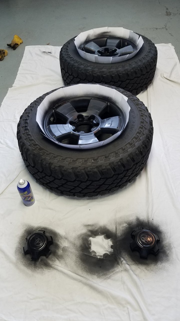

    Three years later, having to redo my plasti-dipped rims. Not bad for only $25.

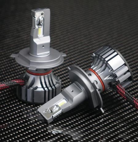

    I think its interesting that there is so much hate for LED headlights.. I had a pair in my taco before I did the retrofits and they had a perfect factory cutoff when installed properly. Most of the LED headlight bulbs that you can buy now are built with a cutoff shield on the body so that you dont get the crazy light.. I've been on the receiving end of LED's that don't have that cutoff plenty of times, but that's somewhat outdated. See the attached picture for reference.. LED Headlight.jpg LED Headlight 2 .jpg

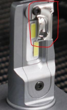

    Same here, I have the Phillips LED headlight bulbs and they have the exact same cutoff as the factory halogen because of the cup and narrow blade design
    Edit: A guy I used to work with has the cheapo ones and they are blinding as hell. But he's young and doesn't care :rolleyes:
