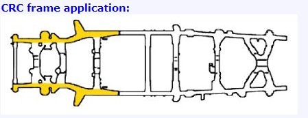

    are you suggesting you want to wait the 2 years hoping it will get worse to justify the replacement?
    What he said. This current program cleans and treats the interior portion of the front third of the frame only. Won't obscure any that they view to assess. You'll then have til 2023 for them to determine if it needs replacement. If you wait, that all still applies but your frame will be in worse condition at the point the interior CRC is applied.
    You asked for opinions. In my opinion you don't gain any advantage by not allowing them to do the CRC ASAP.
    Here's a great thread on this issue.
    https://www.tacomaworld.com/threads/frame-coverage-for-2011.590939/

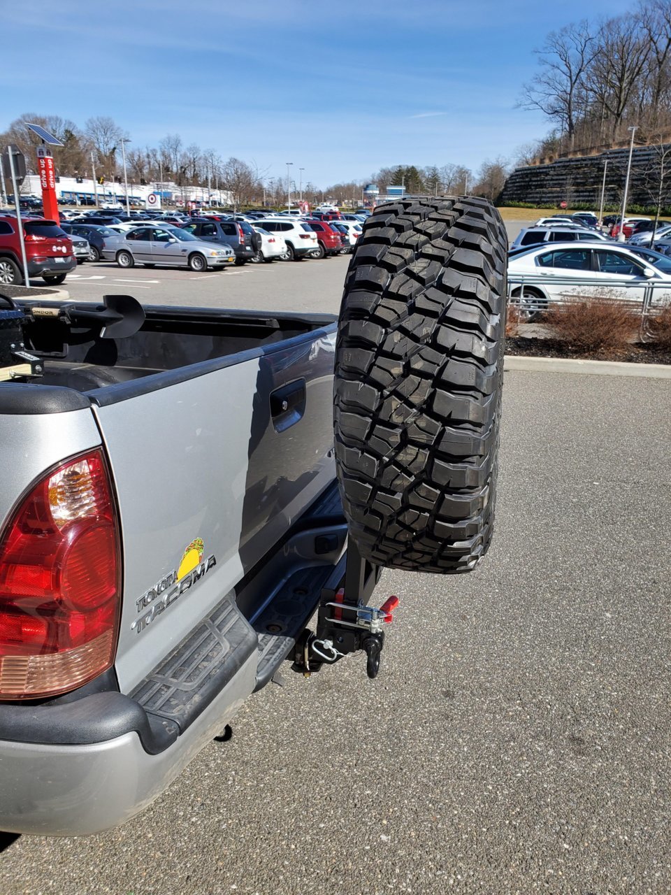

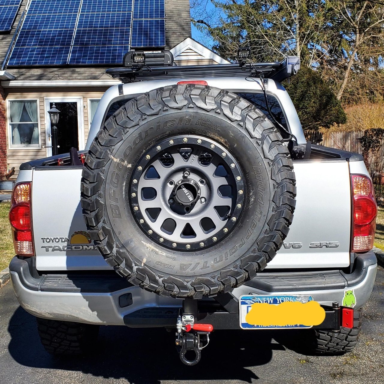

    Added this beauty to my taco--
    GS Industrial Spare Tire Carrier
    https://gscompressor.com/shop?olsPage=products/spare-tire-carrier
    After an exhausting amount of research I felt that this was the best option, despite the higher price tag. Install took less than 1/2 an hour and about another 20 min to tighten everything up after a test run. There is some shake when I go over the usual bumps in the road, something that I hope is to be expected. The included anti-hitch rattle plate seems to tighten everything up but will need adjusting. The gas strut powered opening mechanism is really cool. Simply undo the latch and the tire swings out without any additional assistance. Some care is needed though as, in my case, the full size spare weighs in at 96#, and as the hitch swings out, the tire moves faster and can cause an injury or possibly a misalignment with the receiving part of the hitch.

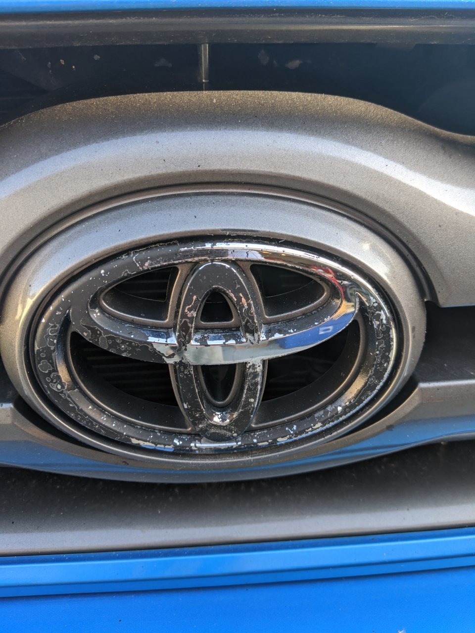

    Currently stock as it was just purchased but there will be modifications to come!

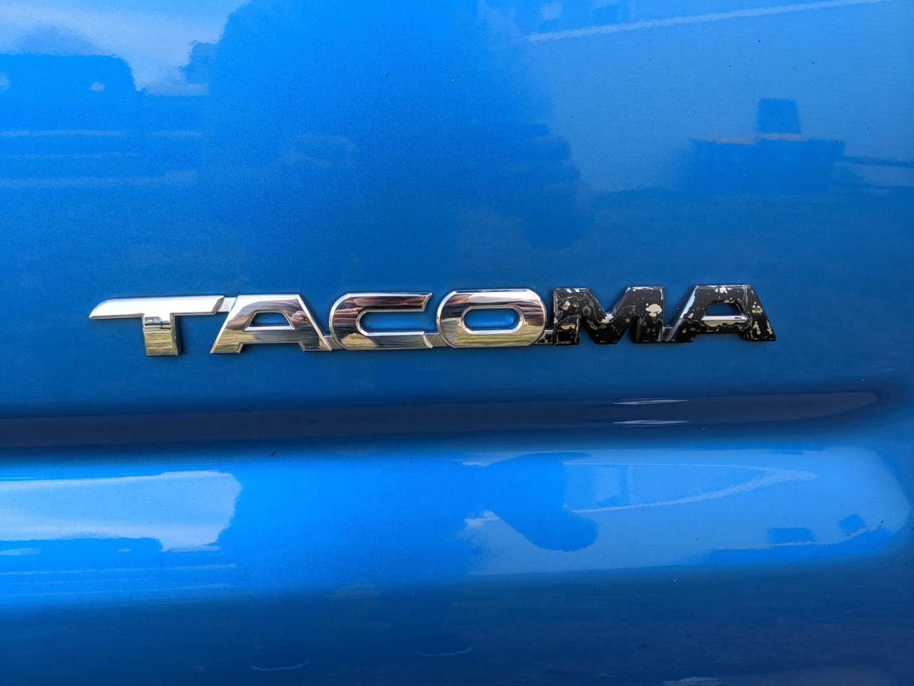

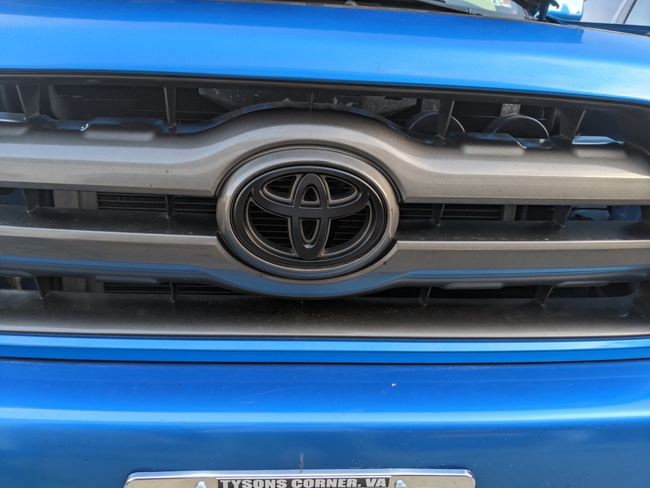

    Failed inspection for the window tint, so went ahead and removed that so Wednesday I can get back through finally get this thing registered to DE and throw on my 5 digit tag. Then decided to start cleaning up the poorly painted decals from the previous owner. The Tacoma letter started cleaning up pretty good but the front Toyota logo on my grill, not so much so i cleaned it best I could then scuffed it up and re-painted.

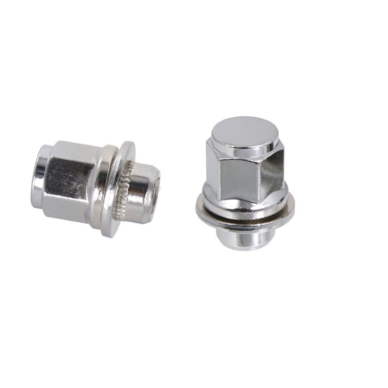

    The oem lug nuts are meant to work on the steel wheel too. The tip is tapered like an acorn lug nut for this reason. Toyota thinks of these things.

    I’ll leave them in there to make my anxiety/OCD feel better. But that’s good to know! Thanks!

    Looks gorgeous! ( should have left the badges off :) )

    Yes, that’d normally be the case. But my xspx came with aftermarket alloys, hence the extra lugs (which Toyota did indeed think about including luckily). Those wheels are long gone now and I’m running spline drive lugs...not sure if they work with the steely, never tried :notsure:

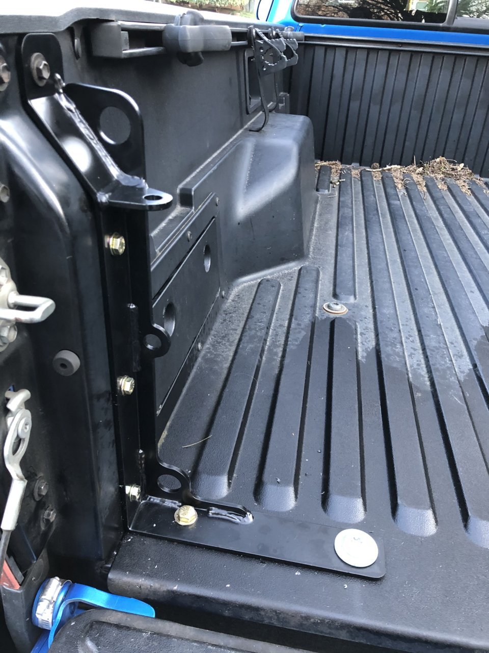

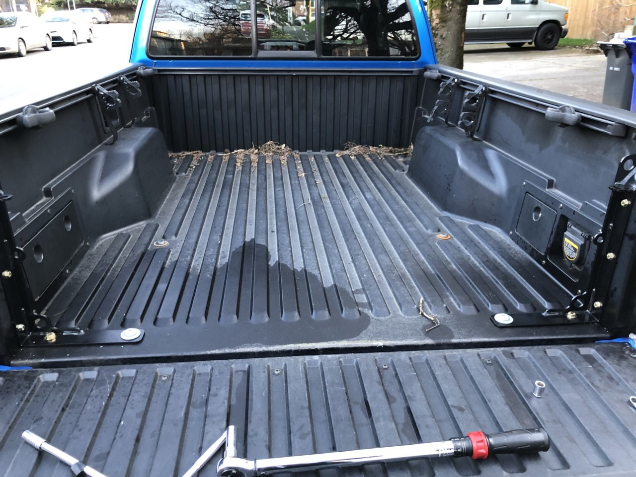

    Installed TC Bed Stiffeners today. Pretty straight forward.
    I even managed to get new bed bolts from the dealership, so fresh unrusted bolts!

    I did the same thing incase I need to throw the spare on. What I really need is a spare rim to match the Level 8's I presently have.
