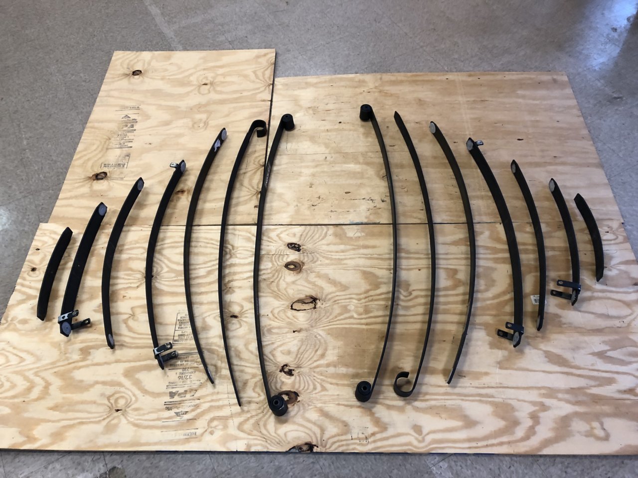

    Got both of my leaf packs from All Dog Off-road. If you have never checked those dudes out I highly recommend it. They are a small co-op and have some of the best customer service I have experienced in the industry. They also gave me a killer deal on the Icon RXT leaf pack.

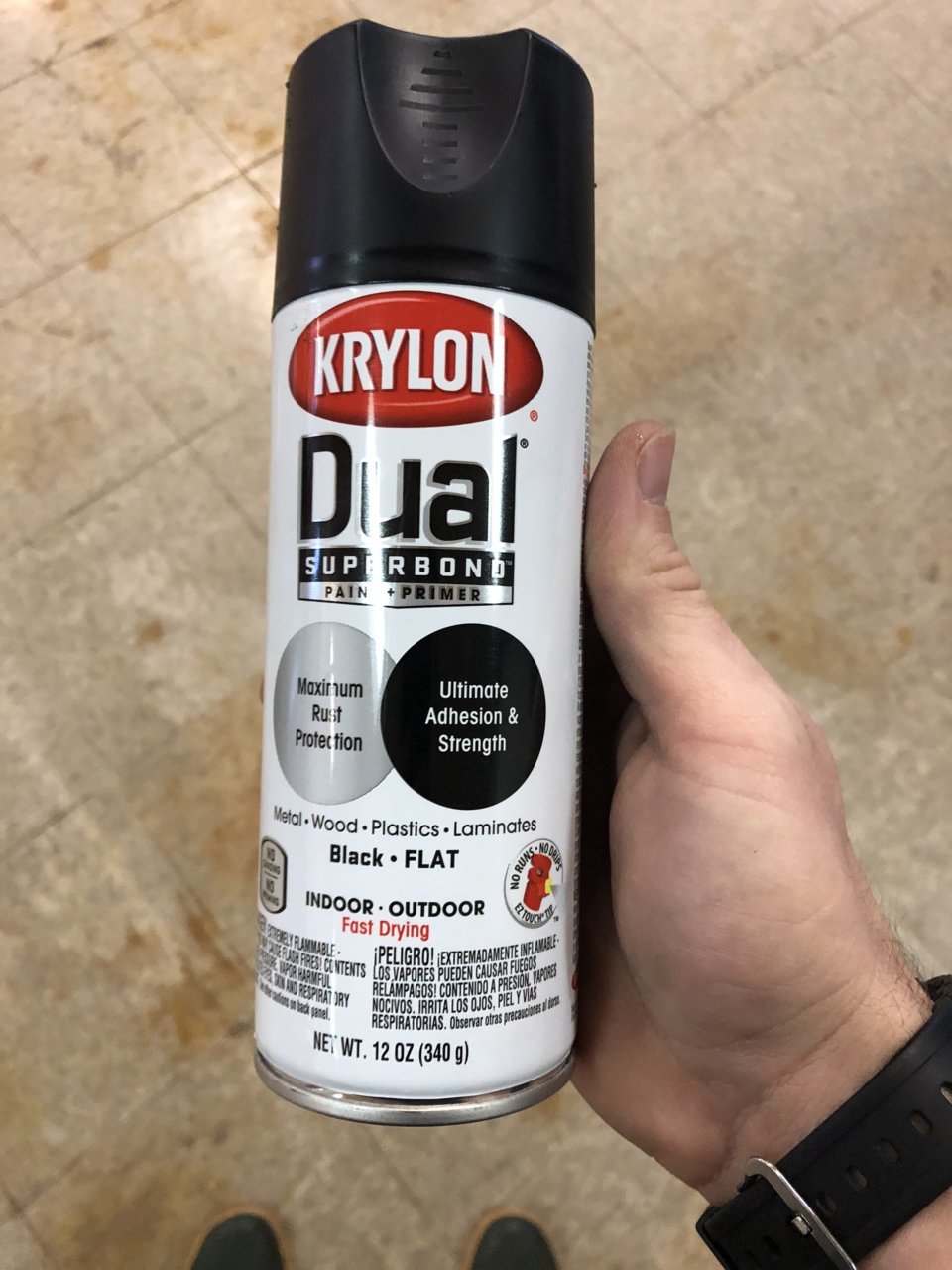

    Today, I broke them down to swap out leaf for option 2 and decided to repaint to help mitigate/delay rusting.

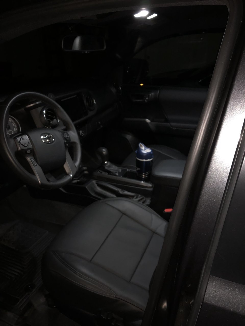

    Replaced the map and dome lights with LEDs. Really easy and affordable. Didn't realize how dim the stock bulbs were until I put seat covers and floor liners in.
    Tip: If you want to replace your map lights, it's easier to remove the whole top console. A how-to video said to take the lens covers off, and pull the bulbs out with your fingers. Was not happening for me.
    If you get your fingers between the headliner and the console, it pops right out. Do the front, repeat for the back, and it'll come off. An electrical connector will keep it from falling, so it'll hang when you remove it. Then just unscrew each bulb holder, pull out, replace the bulbs, screw back in, and pop the console back in place.
    I'd also recommend disconnecting the negative terminal on your battery before doing this, to be safe.
    How to video I referenced (includes how to replace dome light): https://www.youtube.com/watch?v=xOy5LlwEPd0
    Map Light LEDs: https://www.diodedynamics.com/map-light-leds-for-2005-2019-toyota-tacoma-pair.html (I got cool white, HP3)
    Dome Light LED: https://www.diodedynamics.com/dome-light-led-for-2016-2017-toyota-tacoma.html (I got cool white, HP6)
    There are probably cheaper options. I saw other TW members bought these and wanted to be safe.

    Same company I used and I also popped the top console to install the map lights. So much easier to do it this way. I have been very happy with mine.
