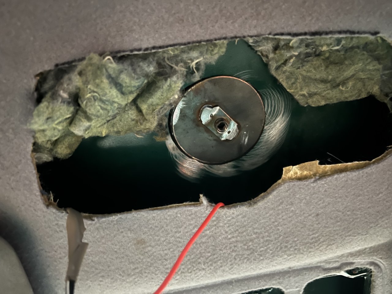

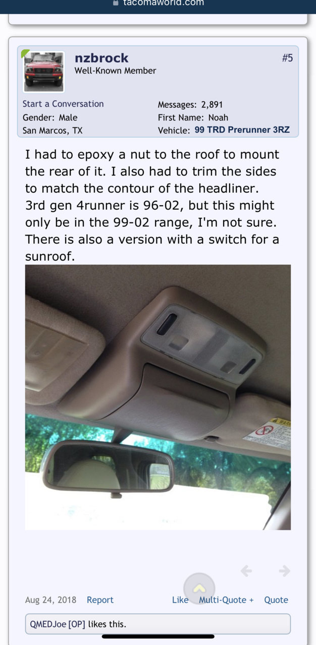

    Write up I followed for the mirror
    https://www.tacomaworld.com/threads...ap-homelink-temp-compass-auto-dimming.553041/
    If doing it again I’d have kept the 7 inches or so of the wire length on the pigtail included with the mirror and made my connections back further in the headliner.
    The sunglass holder is from a 3rd gen 4Runner with no sunroof controls. https://www.tacomaworld.com/threads/has-anyone-put-an-overhead-console-in-your-1st-gen.50567/
    Both 4Runners and Tacomas had 3 interior colors, the blue grey (moon mist) matches 95.5-00 Tacomas, the lighter grey matches 01-04 Tacomas, and oak matches all Tacoma years.
    https://www.tacomaworld.com/threads/interior-color-id.96355/page-3
    Don’t know what year 4Runners had what colors, they stopped production of 3rd gens in 02, I found mine on eBay and mistakenly first bought the lighter gray that matches later models.
    Only thing unique I did on the sunglass console was use a weld nut tacked to a 2” diameter piece of 14 gauge and epoxied that to the roof for larger surface area, others who epoxied something with a smaller footprint said it caused a distortion in the roof as they tightened things up. IMG_0349.jpg There’s a mounting bracket that comes in a 4Runner that’s not easy to track down.

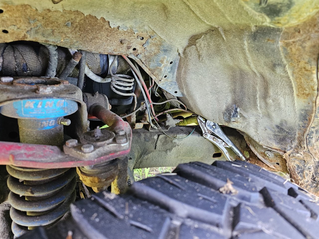

    vice grip line lock mod

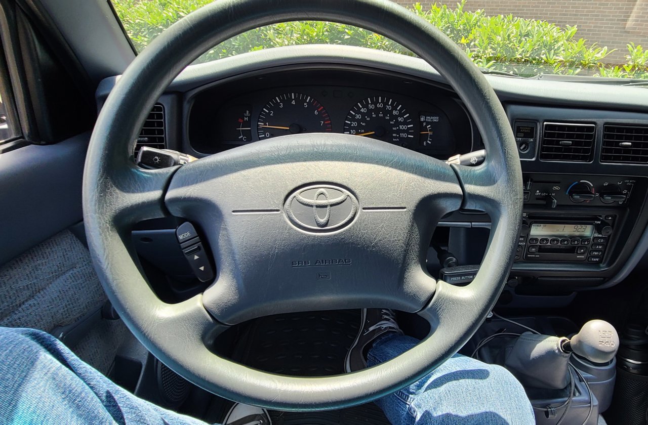

    Added steering wheel controls for the radio with a Sienna steering wheel. Gray is slightly different but close enough! Love it!

    looks like your brake line rusted through?

    yes. they were cheap lines i put in 10 years ago when i did manual proportioning valve. already replaced them.

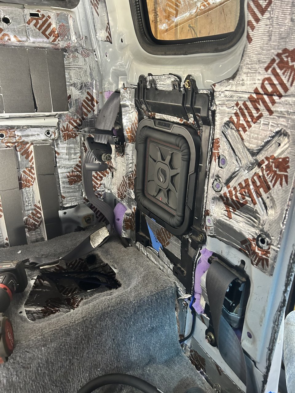

    I like that. But surely that's not efficient for the woofer with no box..

    That was my original concern so I ended up sealing the compartment behind the speaker with dynomat and a queen size 2” memory foam mattress. I left an empty pocket just behind the subs to the manufactures sealed box square footage spec. Hits harder, cleaner and louder than my old single 12 I used to have in a sealed box.

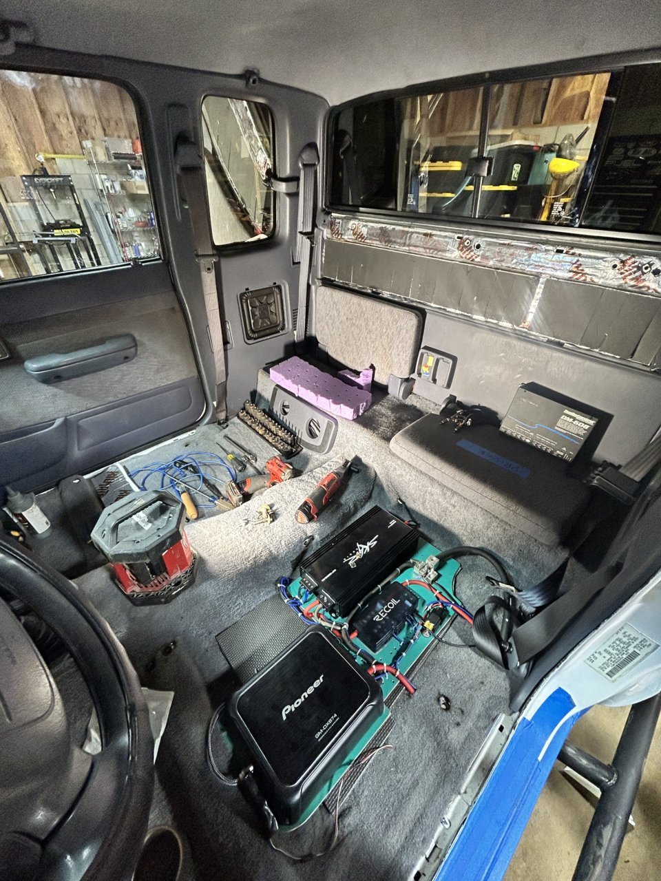

    upload_2023-8-18_22-8-41.jpgHere’s a few more pictures from the project. I ended up stripping the entire interior to Matt and foam everything
    You can see that foam trying to bust out from every hole/opening .I took that picture during a little test fit, so ended up sealing the sub bracket to the body of the truck with more killahmat
