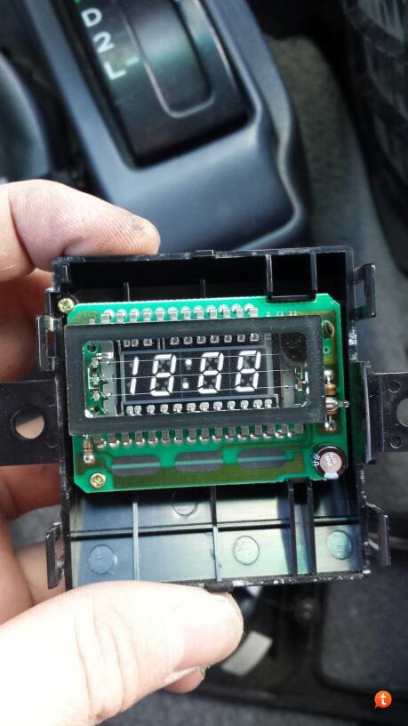

    amaqegeq_5448409de4ff6869f93db5ad7cc19495dadffff8.jpgAttempted to fix my 'broken' check engine light (never came on with the key turned on). Replaced bulb and works when it should :)
    Also, my clock and ignition switch light only work when they want to. I changed the bulbs nothing...do something else and look over and its on (key ring light). The clock is got a burnt spot in the corner (top right)...it still works if you hit it just right :eek:
    Possible reason the PO installed remote start keyless entry..super sketchy job..that and the cd player smh

    Odd... My clock on my 96 would do the same thing, if I hit it just right it would come back on. Never tried fixing it haha

    Check the connections for a cold solder. Get a cheap microsope (the hobby shop type for looking at rocks) and check all of the soldered pins. If one or more appear cracked, resolder.

    Yup, probably so. Didn't know much about wiring at the time, plus the truck is long gone as I don't own it anymore haha
