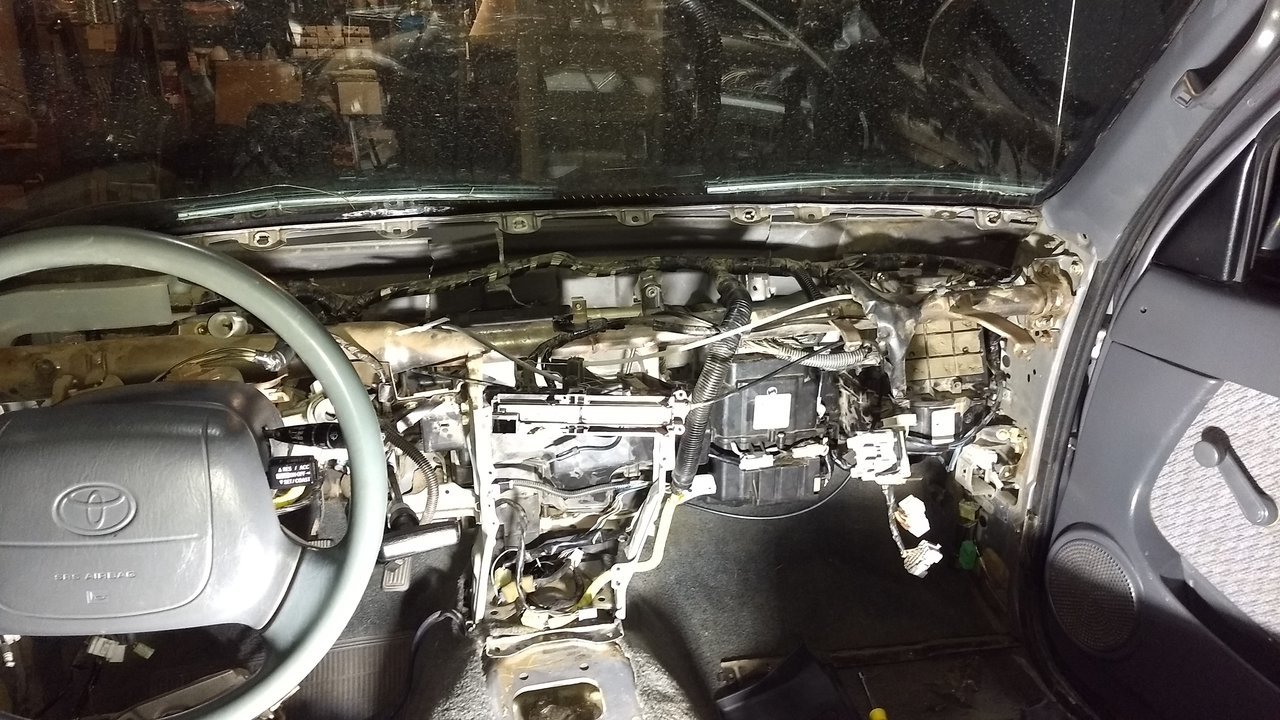

    Jesus that looks like a nightmare.

    Nah, it was a nightmare when it was empty. Honestly Toyotas are basically just automotive lego compared to some of the old Nissans and Jeeps I've worked on. Hardest part will be cutting the hole for the clutch MC.

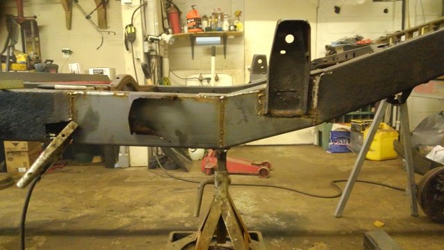

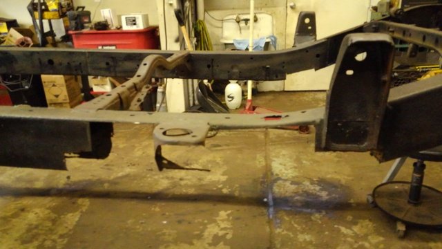

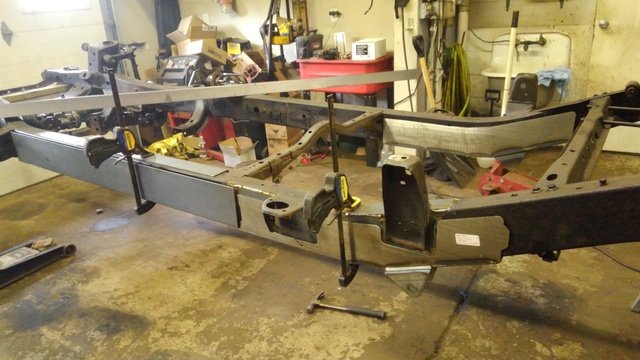

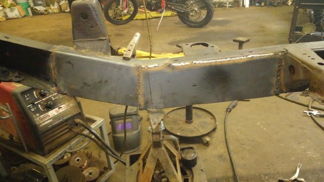

    Got some time today to start welding up the frame. Cut out the bad section and got that all boxed in. The rest is easy, I've got some steel bent to box the whole frame from the front cab mounts back and the safe-t-caps for the front spring mount section. My OME parts will be here Tuesday so it won't be too long before this is rolling again and ready to drop the engine back in and start putting her back together.

    Providing any drain holes along the bottom? going to do any internal treatment - Fluid film or such?

    Yes I'll have drain holes on the bottom. I sprayed the inside with Corroseal and undercoating. Probably going to hit it again once I'm done welding. Going to use Sherwin Williams Dura Plate 235 on the exterior of the frame, rear end, springs and a bunch of other stuff.

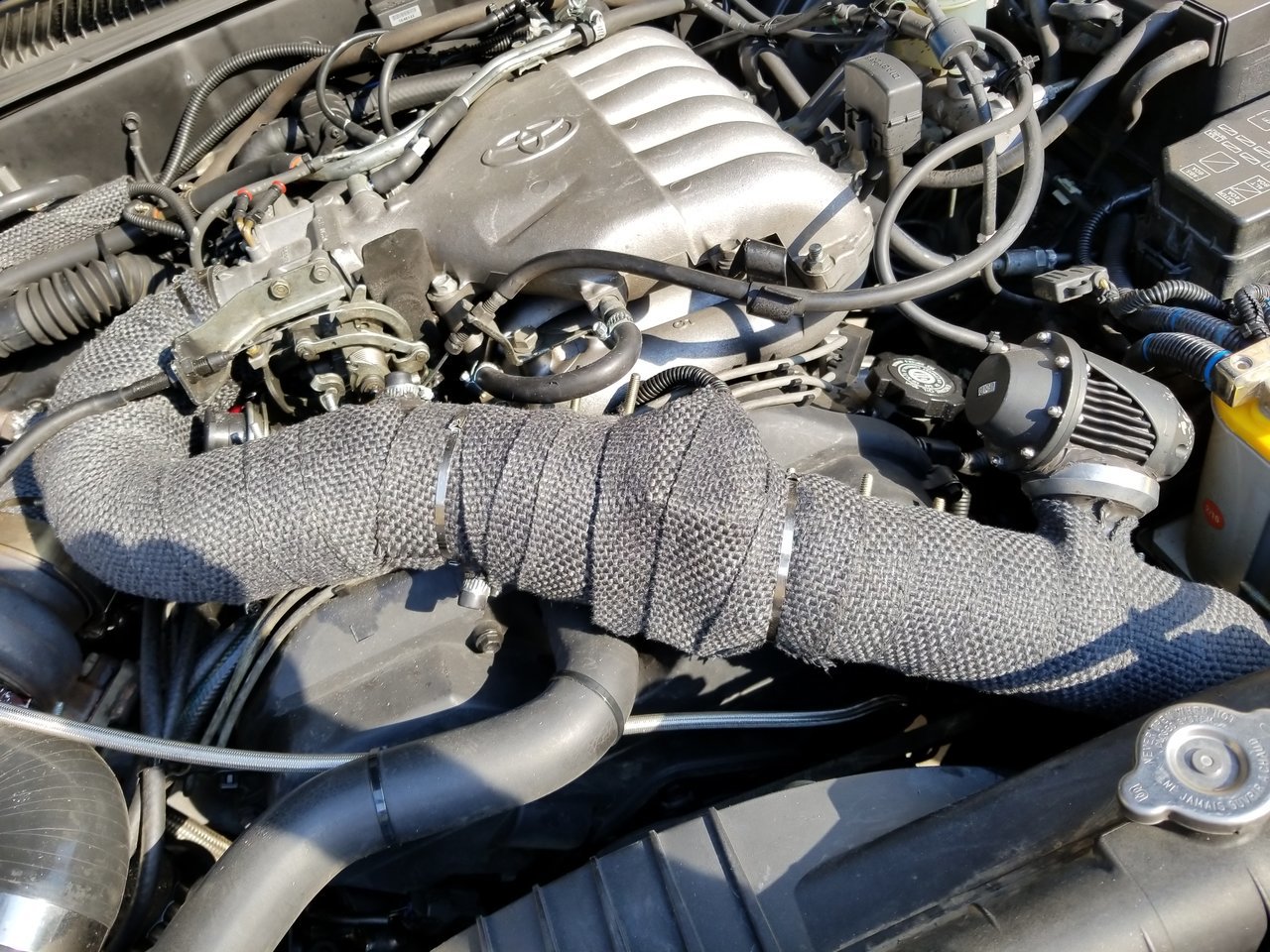

    I did this today. Header wrapped charge pipes. Less heat soak.

    i think it looks good too
