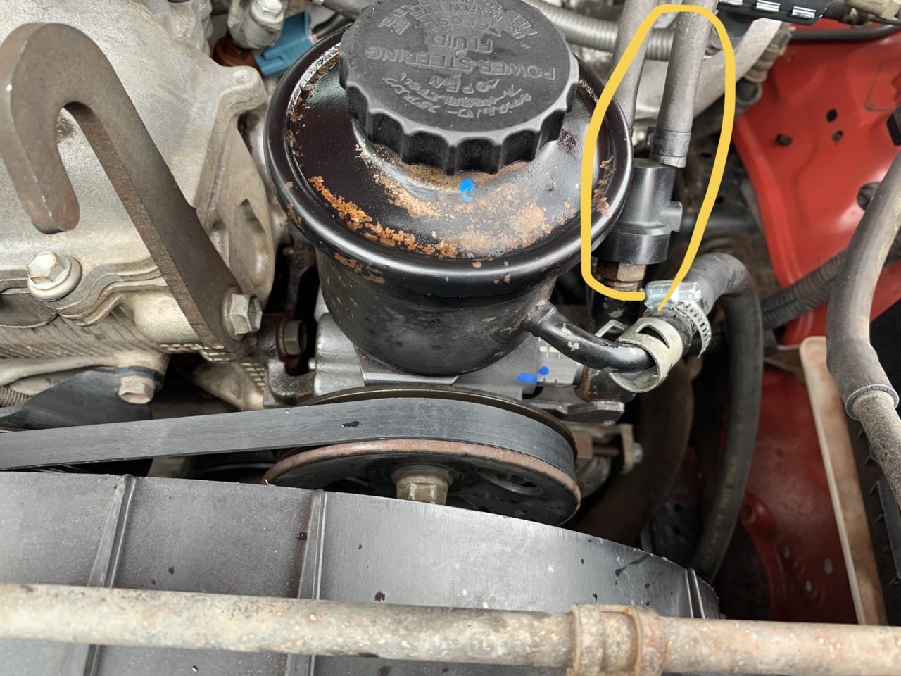

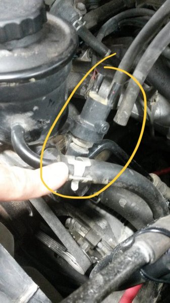

    Power steering pump, Steering rack, Tie rods, Radiator cap, Thermostat, New radiator, magnets to hold the fuel door closed, new starter drum/cylinder, dash lights changed to red, replaced all carpet in the cab. Not real “mods”, but all work
    Had the same thing happen to my truck after chasing a power steering whine, replaced my power steering pump, rack and pinion etc etc etc. If you go to the search bar and search “Power steering help” in 1st Gen and “Power steering help...again” you’ll see my doozy. Anywho, in the end I sold the truck cuz I needed something I could take my kids around in.
    Check out this thread for rebuilding, really helped a lot.
    https://www.tacomaworld.com/threads/power-steering-pump-rebuild-how-to-with-photos.377002/
    The seal around the shaft that’s connect to the pulley is a beast to get out. That was the hardest part with rebuilding the pump. Also, make sure you replace the main gasket on the pump facing the right way. I was an idiot and put it on backwards the first time.
    I got a 17mm, 14mm, and 12mm ratcheting wrench which helped a ton.
    If rebuilding doesn’t help, I’d just buy an OEM pump with the reservoir from Toyota. Something like $500.
    Also, be very cautious when taking off the high pressure line, this piece is only sold as the whole set that goes to the rack and pinion and costs over $400.

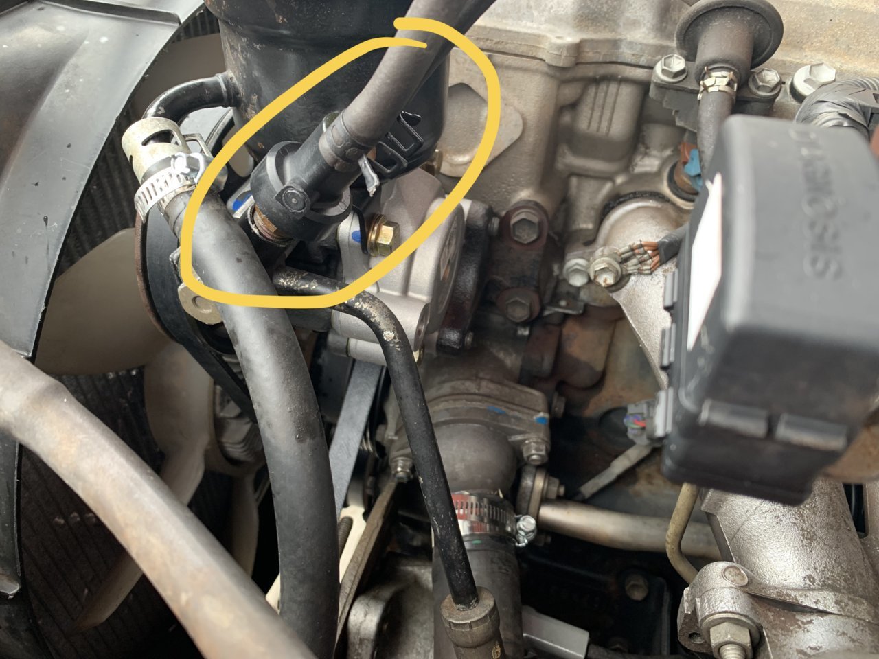

    Also, to keep from having to take the fan shroud off, just remove the two top 10mm screws holding it on, and the bottom left (passenger side) screw (easier to get at than the bottom screw on the drivers side).
    Sorry. Had to do this like 7 times trying to figure out where my whine was coming from.
    These steps should be done after draining your PS system.
    1) with the 17mm ratcheting wrench, loosen the bolt on the PS pulley.
    2) next would be to loosen the bolt on the tensioner pulley to the left of the PS pulley with a 14mm flex head ratcheting wrench (if you can get one like the picture below)
    If you don’t have one, you’ll need a 14 mm socket with a 3” extender. Pull the fan shroud up onto the pulleys, slip the wrench and socket through the gap, loosen the bolt)
    3) loosen the tensioner connected to the pulley
    4) after you get the belt off, finish taking the bolt off the PS pump pulley, and slide the pulley off the shaft.
    5) next will be a 17mm bolt that holds the high pressure line on. Be careful that plastic vacuum piece from the other post. And be careful because there are two metal washers just don’t wanna lose those. From there you’ve got three 12mm bolts holding the reservoir to the PS pump, shimmy it out of the PS pump because the neck that goes into the PS pump is pretty small, don’t lose the O-ring. Easier to take the reservoir off while the PS pump is still bolted to the truck.
    6) last 2-3 bolts holding the PS pump to the housing and you’re done, should shimmy on our for ya
