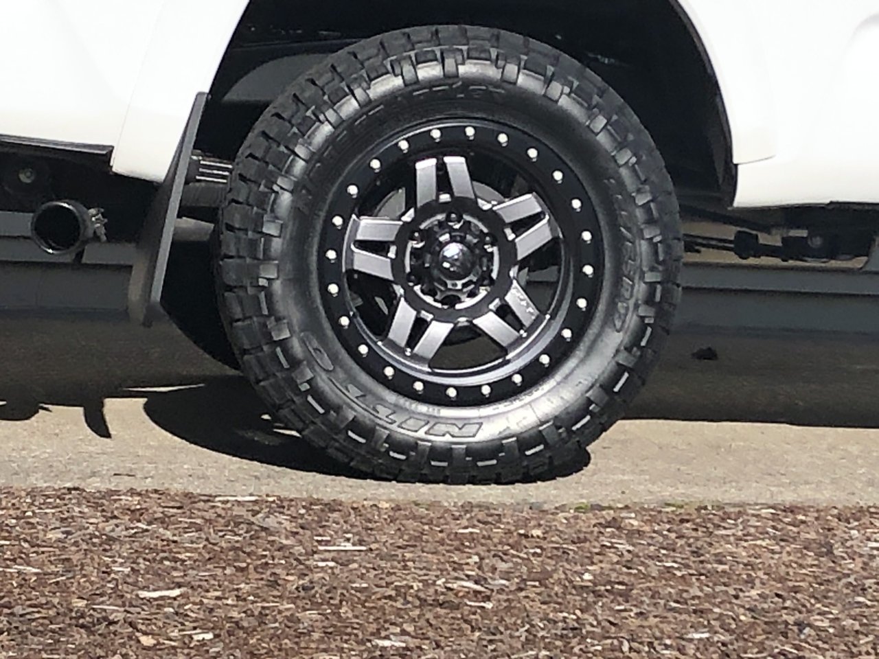

    I have the black spline drive on my Fuel wheels and love the look and the fact that even if someone has the key to remove them they most likely won’t take the time to remove all 24 of them.3490FB5F-EAD5-42B7-A78B-A4707308AC9C.jpg
