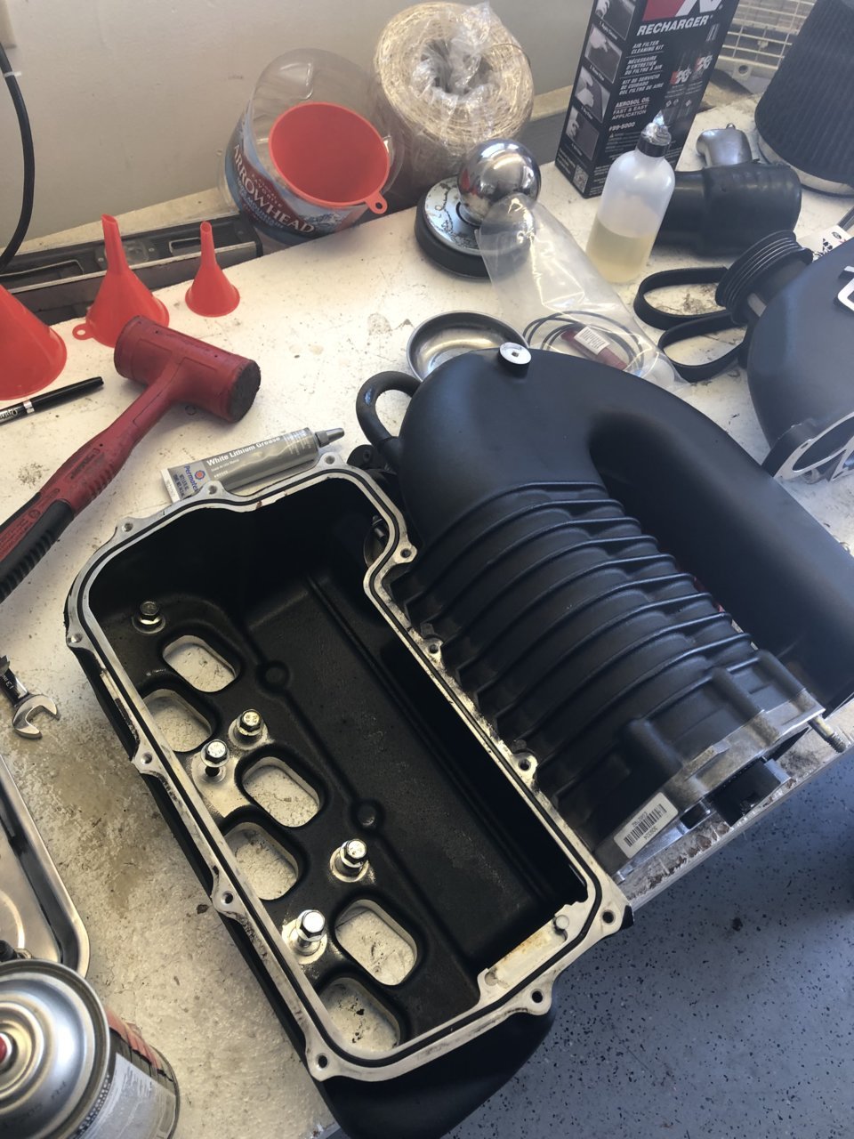

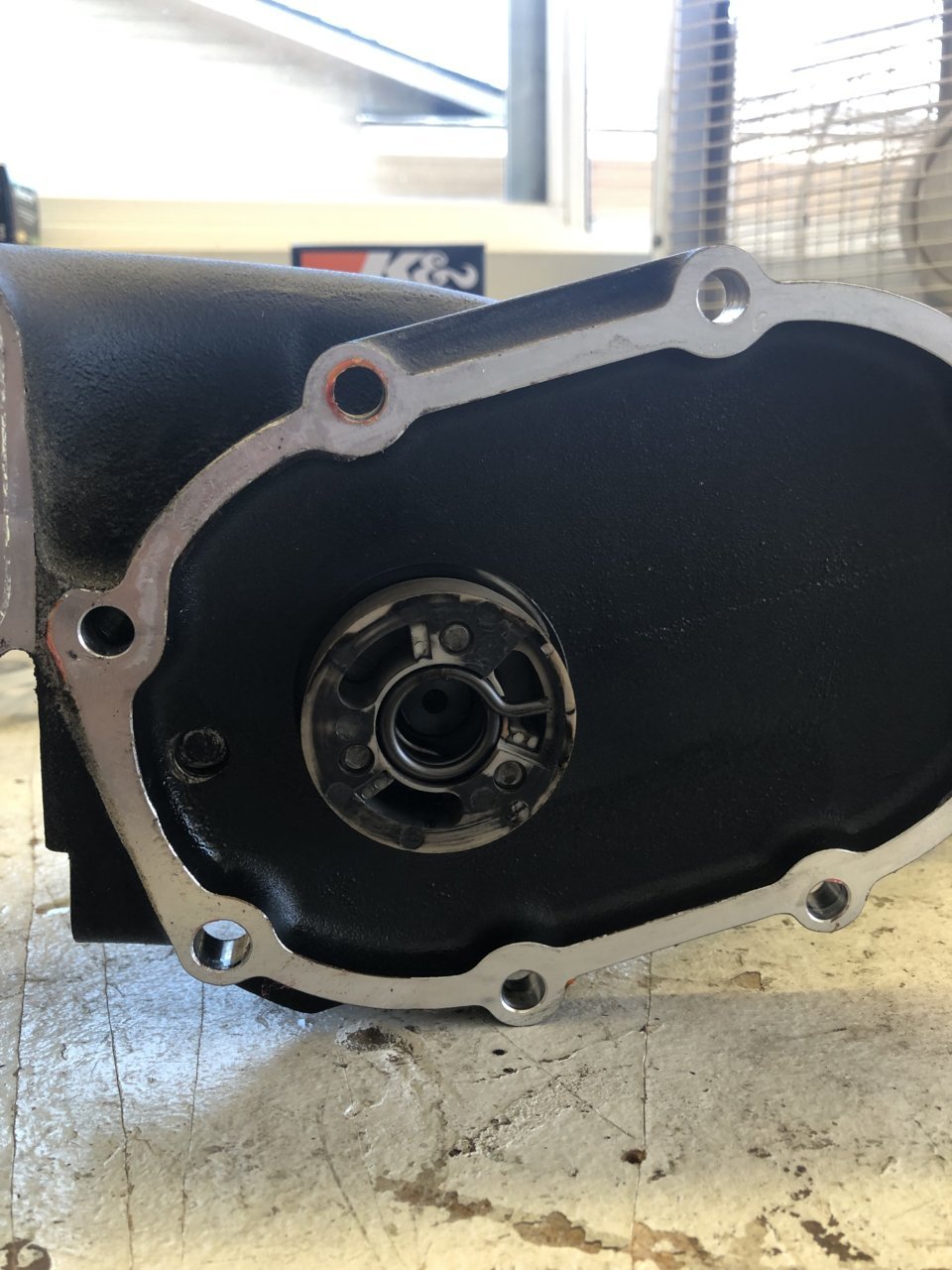

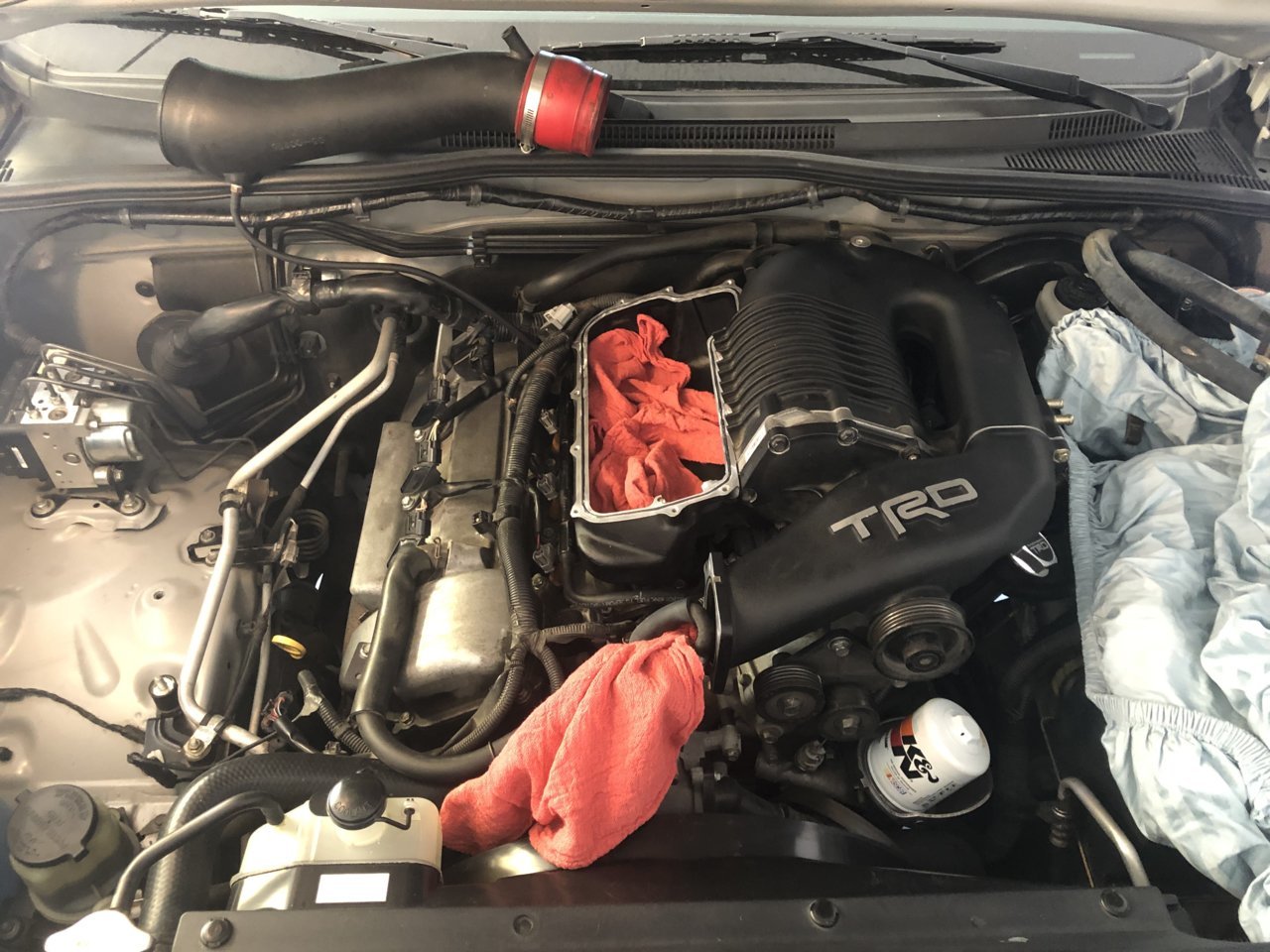

    8218BDFB-3960-442E-A785-0943485041D4.jpg 01C516AD-682C-4419-A34F-AB26B9D92E43.jpg C10B598D-7497-4C7B-8128-DA5C7D2AAFB6.jpg If you’re taking everything apart anyway you may also want to consider servicing your supercharger. I'm running a 2nd gen so it's a little different but not much.

    I was unable to remove all of my spark plugs with the supercharger in the way so I replaced the torsion isolator and all the seals and put new oil in it. If you don’t know when the last service on it was I would recommend doing it and you will be good for another 100k
