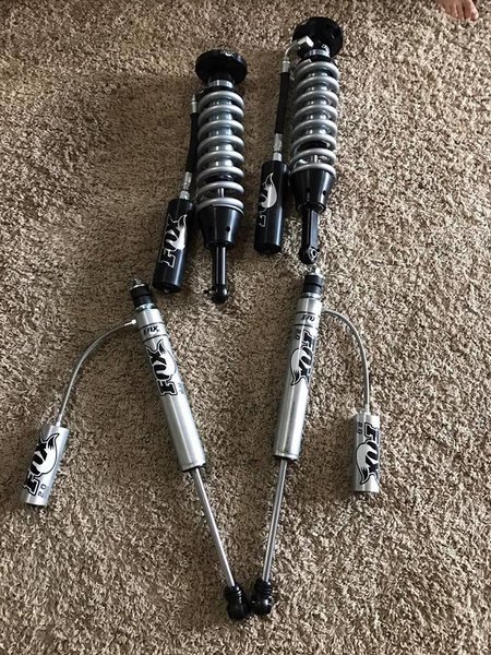

    Hey there, I've been running my Fox 2.5" Extended travel Coilovers for a few months now. LOVE them. Theyre model # 880-02-418
    I recently ordered a new bumper (~100lbs). I've noticed to attain my current lift height, i have placed quite a bit of preload on the springs. I'm worried the new bumper will be pushing those poor springs and my preload to the max. So, the question is.... whats the spring rate are my springs? i can't find the info ANYWHERE. I've looked for a few hours, and even called fox. I've searched all i can think of. Im guessing my spring rate is too low though... SO which springs should i get? Taller, or stiffer?
    A good idea of how much preload I have
    Suspension off the truck
    the bumper that will be installed next week. ~100lbs

    The springs are probably around 650lbs, like the "stock" ones from ICON (and other manufacturers).
    100lbs won't make much of a difference. Certainly not enough to justify putting stiffer springs in.
    I saw my front-end dip by 1/8" when I installed my low-pro bumper and winch (130-150lbs total); ICON 2.5 coilovers up front w/ 650lb springs.
    As far as how much preload you currently have - quite a bit. I'd be careful with that as there are limits to how much you can/should crank it. You need to find the max that FOX recommends and ensure you're not over it.

    According to @Downsouth Motorsports's posts in this thread, the coilover part number you listed comes with 13" long and 600lb spring-rate springs. In that case, you may want to step up to 650lb springs. You can probably get them from Eibach.

    Right, so if Fox says 3", then that translates to 2" for the third gen. If you're sitting at 2.5", they are probably cranked a bit higher than they should be. Probably as in, it will vary from truck to truck. FOX can give you a simple measurement of how much coil thread can be exposed at max setting (something like 2", or 2 1/4"), and you can then compare that against the visible thread on your setup.

    Lighter spring rate will make for a softer ride. A 50lb increase in spring rate can make a very big difference in ride quality. Note that with heavier-duty springs, the max amount of preload you can run will change. Again, using ICON as an example, I vaguely remember that on 650lb springs you can have about 2 1/4" of preload, but on 700lb springs, the max is about 1 1/4". So it's a pretty big difference, and there's likely to be a similar one if you step up from 600lb to 650lb coils on your FOX setup. Best to confirm specifics with FOX.
