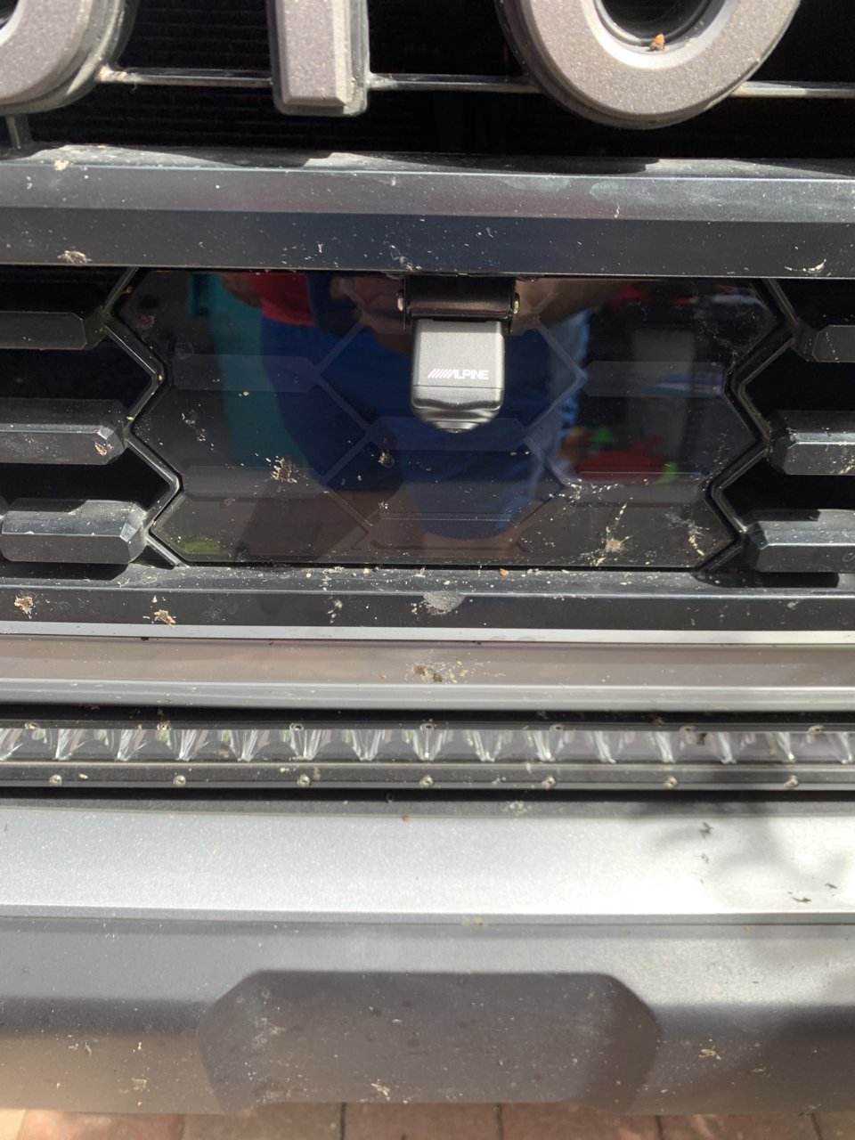

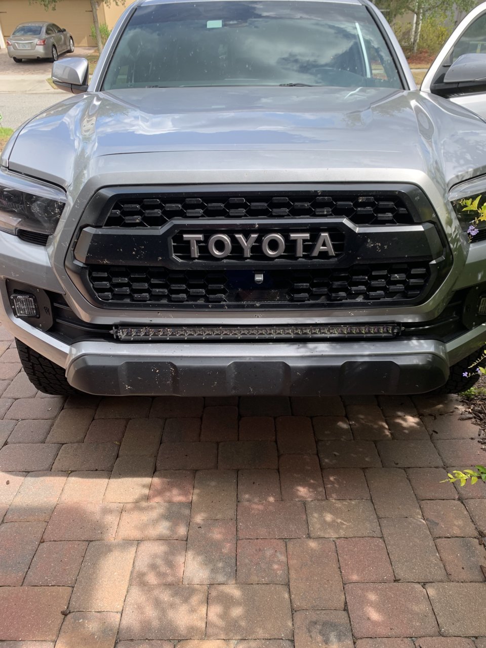

    I installed my Alpine camera today and unfortunately it’s causing the TSS pre collision to disable itself and tells me to clean the sensor. I’m going to have to figure out where else I can put it.

    I think I’m going to cut a hole and bring the camera more into the grille. I prefer this camera as the quality is better than anything I’ve seen and it has 4 views I can toggle through on my Halo 9 head unit.

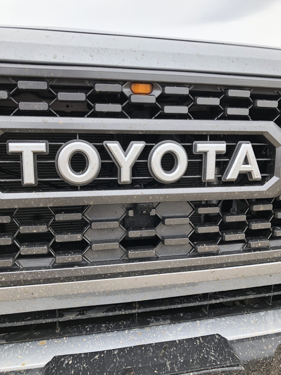

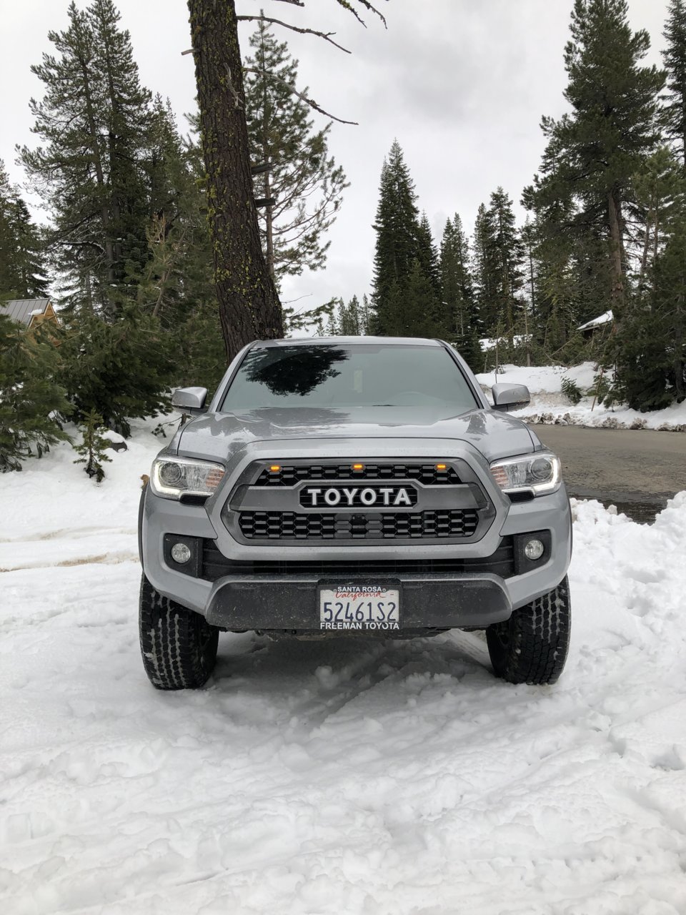

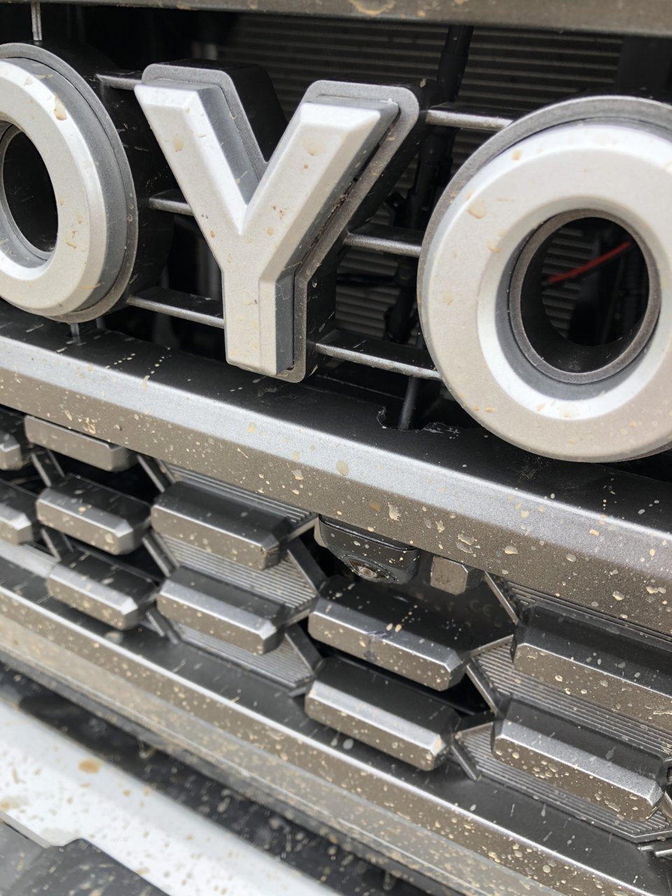

    Dead center. Blocks the radar slightly, doesn’t have any noticeable effect on the radar. As you can see I don’t even run a garnish and my sensor works flawlessly.
    Camera is nakita
    Been in snow and rain no problems.
    No idea what the point of the garnish is but its a rip off. 38A8A2C5-80DF-41BB-9205-B535EC0B7346.jpg
