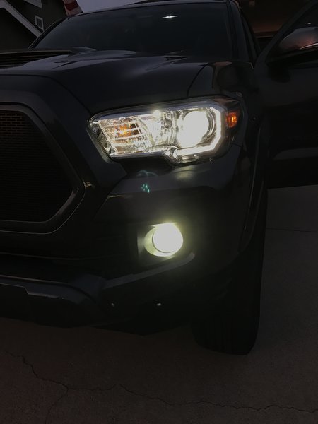

    Sorry for the crappy rain pic here. I went with the 6k HID kit for my lows and the LED fog kit from Diode Dynamics. It's hard to see but they actually match up well with the driving lights. When just running the driving lights with the LED fogs, it's nearly perfect.
    I've had the HID kit on cars in the past and I love them. I like how the fogs spread the light from ditch to ditch, I was afraid that I'd lose some of that when going to LED but it looks amazing. There is no douchey purple or blue hue and overall light distribution is awesome and very white.

    Fair enough. The reason I like the 6k temp is because I can see a lot better with that color and with the dark wet roads in Oregon, it helps A LOT.
