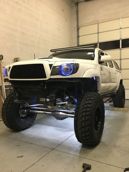

    :wave:Thanks buddy. I haven't driven it yet, the build is currently tacked together. I still need to cycle everything and make sure it all works properly. I will let you know in a week or two though! :wink:

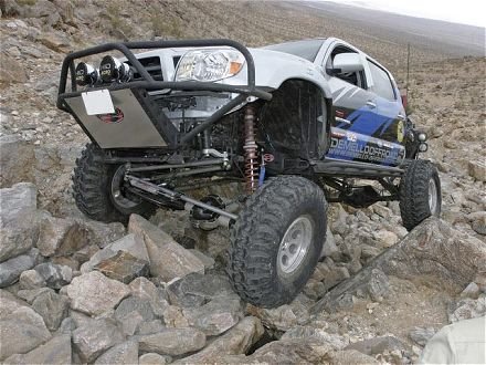

    Super duper subd. That first picture is so sick! Truck looks amazing

    Thanks for the vote of confidence boys! I been workin too much to have any time on the truck. I will hopefully test er out this weekend with power steering and brakes done.:fingerscrossed: Also be posting all fittings and measurements as well.

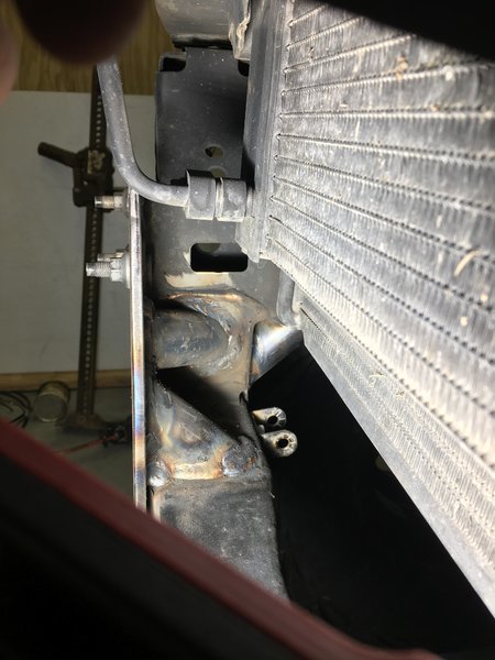

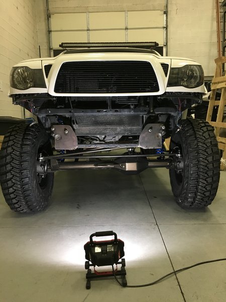

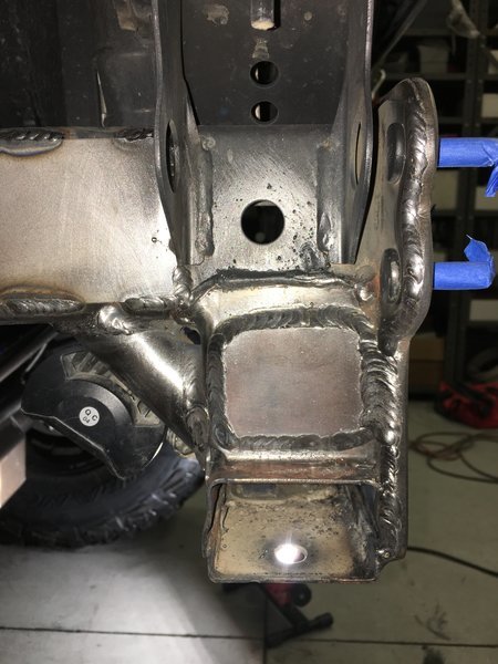

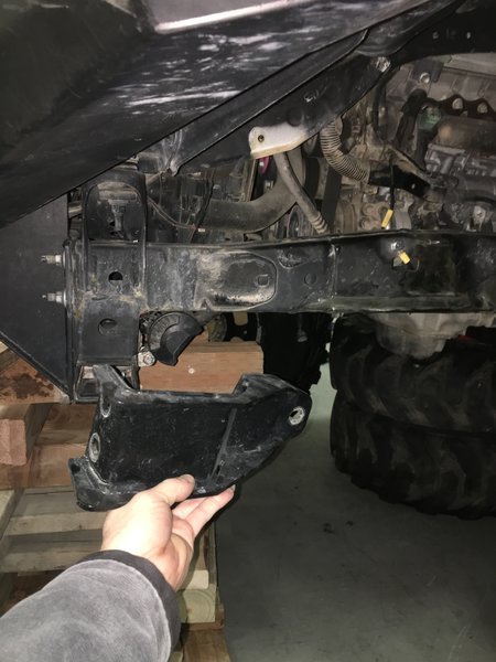

    Alright so I'm back to where I started. I had to re work the shock tabs because they were at too much of an angle, kings were hitting em. Then I focused all day today on the front bumper. The old supports for the bumper didn't work anymore so I fabbed up some new ones out of 1/4 plate :curls: should be pretty tuff and hold up to the insane amount of winching I'm about to do lol

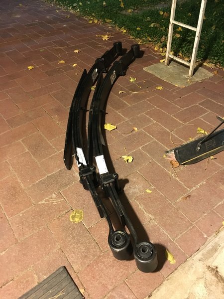

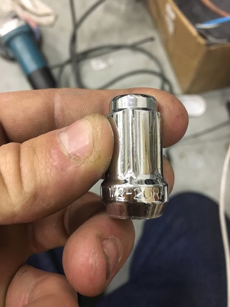

    Also if anyone else does the kit from all pro the lugs are 1/2 x 20 RH thread. Took me like 2 hours to figure that mess out. I also came home to some new Chevy 1500 springs Then i also bought the pressure side for the power steering (59" #6 inverted 90 degree fitting) I will buy the non compressed Monday (67" #7 inverted 90 degree fitting) and bought a stainless brake line to fit into the stock line running on the driver side (56" long)
