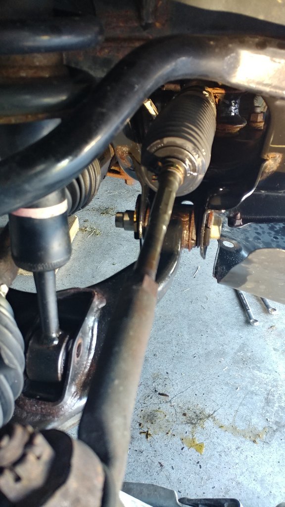

Why won't my arm drop so I can get my shocks out

    I want to say it's because you haven't disconnected the tie rod and sway bar.

    Disconnect the two bolts holding the bj to the spindle and loosen the cam bolts

    I have taking the bj bolts out and didn't think I needed to take sway bar bolt out?

    Can bolts are almost out and Still won't move

    Check Build thread
    Disconnect sway bar
    Then loosen top shock bolts that tap the shock out
