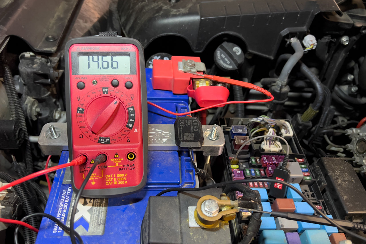

    07/17/22: Previously upgraded my battery to an X2 Power AGM and played with voltage boosting back in build post #104. At the time it was winter and I was getting almost 15 volts with the DIY diode mod so I took it back out. Bought the HKB mini fuse booster instead but didn't install because I was getting squeaking from belt/pulleys and wanted to fix that first. Since then I haven't had any squeaking and everything works fine so today I said "screw it" and installed the booster. Battery voltage at rest was right about 12.8 volts after not being driven for a day or two.
    HKB MKIII mini fuse diode. Comes packaged very simply taped into a piece of cardboard with an instruction sheet all inside a zipper bag.
    Closer view of the fuse diode. Looks like a normal 7.5A mini fuse but the center is all black from the epoxy or whatever sealer is being used to surround that auto-resetting PTC device.
    Fuse/diode is installed in the same ALT-S slot of the fuse panel under the hood. I did end up having to flip it 180° to function correctly and stop the battery light from showing on the dash (which is all in the instructions).
    First startup and I was getting about 14.3 volts right away. Looks good so far.
    Here's the readout from the Bluetooth voltage monitor to verify the results. Luckily it comes very close to the multimeter and is usually only off by a factor of +/-0.03 volts in my testing. Close enough that I can trust it as a data source so it's doing exactly what I bought it for.
    On the other hand, my Pioneer headunit which uses the iDataLink Maestro RR to read OBD2 data is consistently off about -0.3 volts at best. I cannot trust this as a data source. Must be some weird programming of either the Maestro itself or how the ECU outputs voltage to the OBD2 system. Oh well.
    The next morning as I started up the truck, I also pulled up the Bluetooth monitor right away and was reading up to about 14.7 volts. This looks to be in the range I am desiring (14.4-14.8 volts per the battery manufacturer's suggestions). It also seems to confirm the same results on the other AGM booster thread which is reassuring. Keep in mind this is at ambient temperature of 75°F so it is something to monitor when the weather again gets down around freezing.
    And once again the Maestro/OBD2 is showing 14.3 volts at the same time, off by a factor up to -0.4 volts. At least it confirms yet again I should not trust it as a data source. For now the inexpensive bluetooth monitor is working well and was very much worth the price.

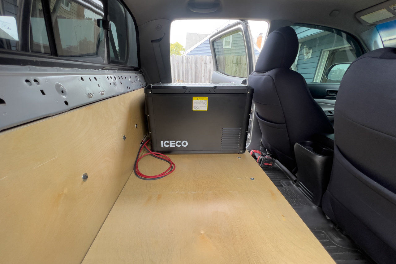

    Removed my rear driver seat and plastic cubby so I could test fit my next mod: this spectacular cardboard box. It is true what everyone has said about road noise increasing with no seat, and I can confirm this cardboard box does nothing to help. What's in the box?? WHAT'S IN THE BOX?!?!
    Couple days later I started playing with a different cardboard box...
    Then I opened the cardboard box and inside was another box. Inside the other box was a small cardboard box with various cables for the box.
    In all seriousness I have 11 days before vacation begins and I feel mental trying to add new stuff like this last minute. My life is getting super busy very quickly. Trying not to stress but I'd be lying if I said there is no pressure. More to come eventually - I have so many other Tacoma-related things to share on the build and zero time to do it right now.

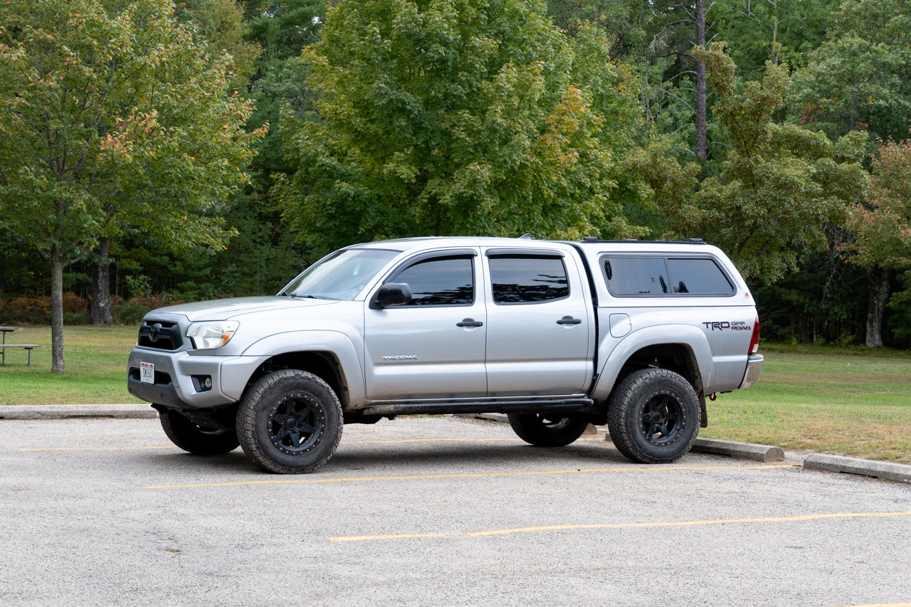

    Starting off with a very clean truck at Tigerton OHV Park. This was Sunday morning when I woke up late and missed everyone else. Where'd they all go?!

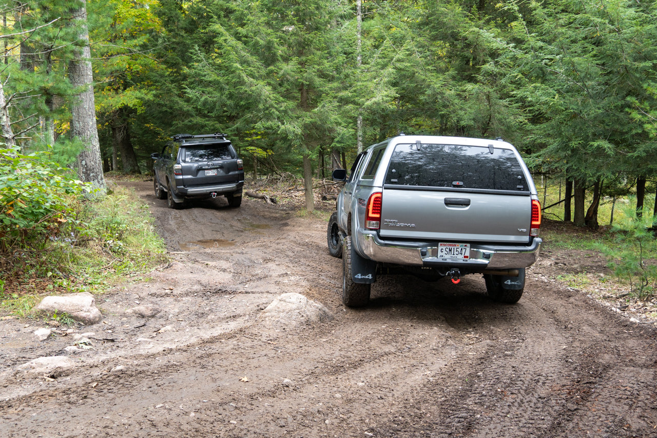

    Luckily I did find @McSpazatron and we hit the trails for a bit. Was definitely a learning experience and found I can push things further than I expected before. Saw some waterfalls too. Not shown here: the flash flood rain and hail just after we finished.

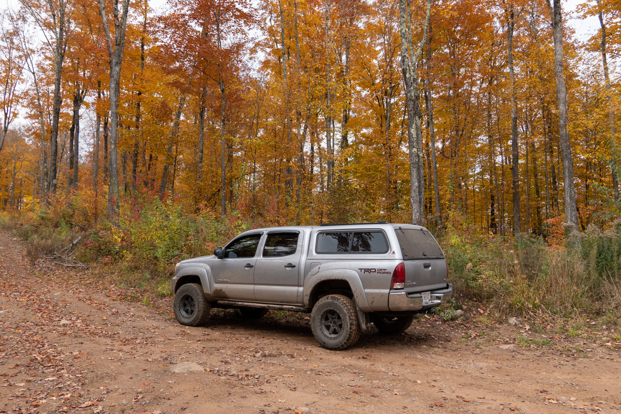

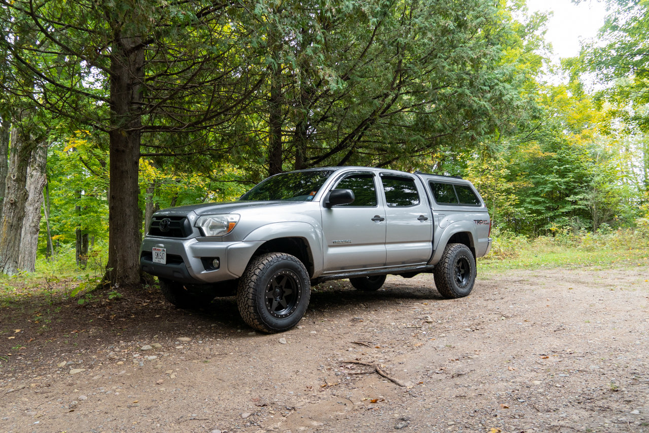

    Ran a lot of forest roads, grassy two-tracks, mud, gravel, over logs and rocks. This was early on while the truck was still relatively clean.
    Later the same day at Veterans Memorial Park in Marinette, WI. Leaves were still mostly green, I was too early for the colors just yet.
    More gravel, dirt, parking on shoulders, etc. in search of adventure in the woods. This is why I bought & built a Tacoma. This is what the hours of modding & wrenching are all for.

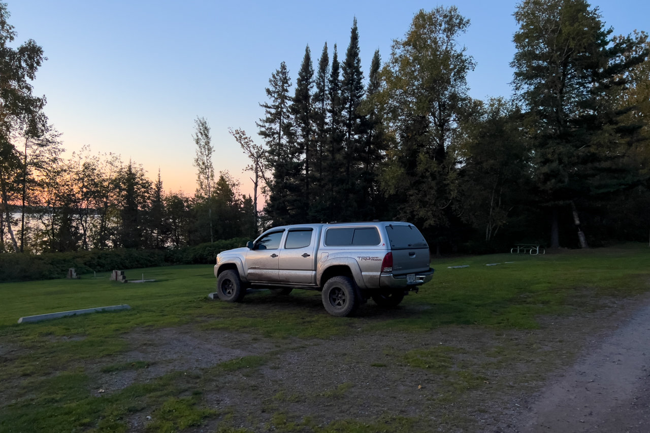

    Parked at L'anse Town Park & Campground enjoying the sunset before I set up at my site. One of the nicer town parks I've seen, even still had hot showers running!

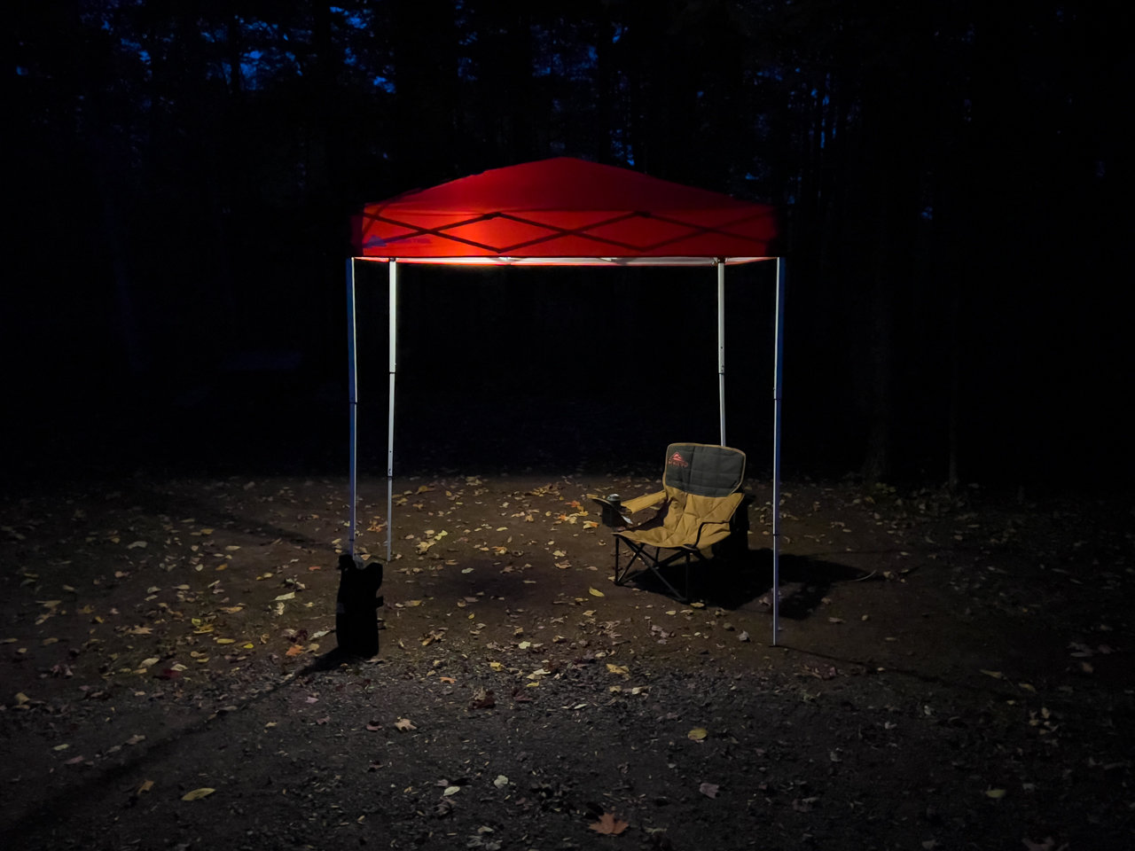

    Some new gear I was experimenting with was this cheap 4'x6' canopy tent from Walmart, some Eurmax small weight bags to hold it down, and a new Kelty camping chair that sits very low which is great because I'm short. What's the purpose? Well, since I sleep in the camper shell I don't have anything to set up to make it look like the site is occupied. This folds down and packs away small enough, and if I set it up and it gets stolen I don't care much because it's cheap. After setting it up one time I can say the experiment failed because the quality of the tent is dogshit. Fun experiment though!

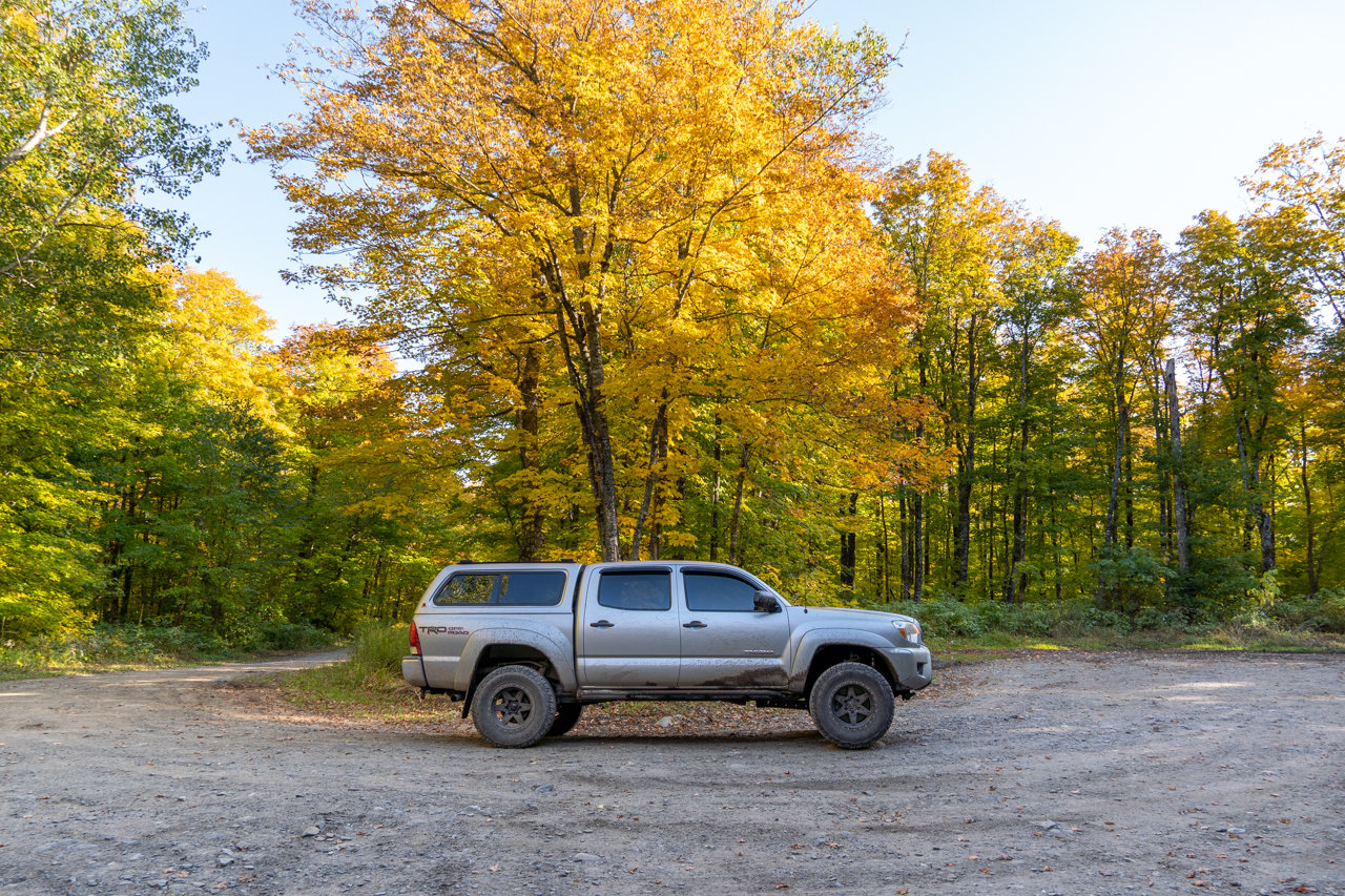

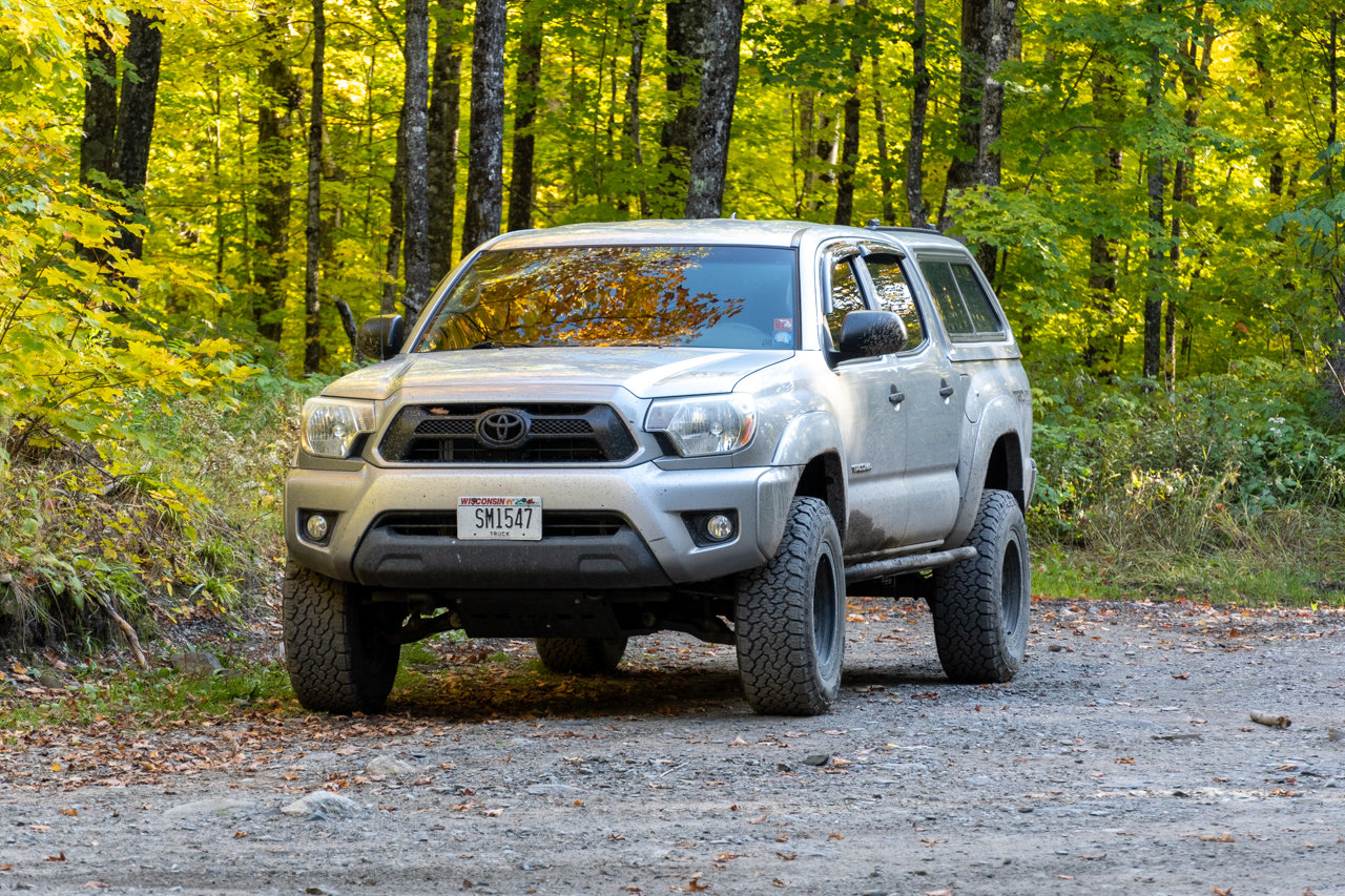

    Back in Wisconsin exploring the woods of Iron County. I'm not sure how I missed the peak colors at this specific spot but it didn't look bad by any means.
    Another angle at the same location. About 50 feet behind the truck is Rouse Falls.

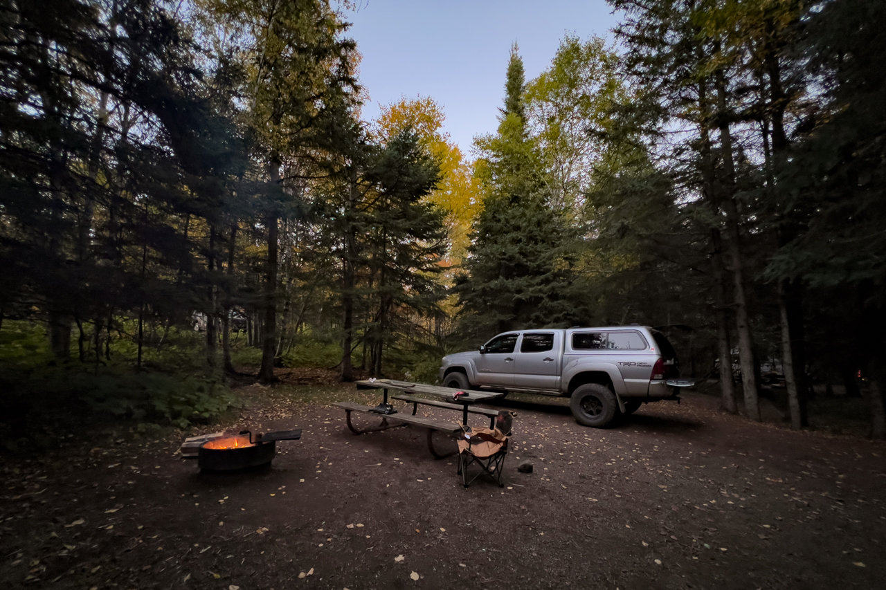

    Campsite at Cascade River State Park in Minnesota. I fell asleep in my chair at the fire for quite some time, just totally chillin'.

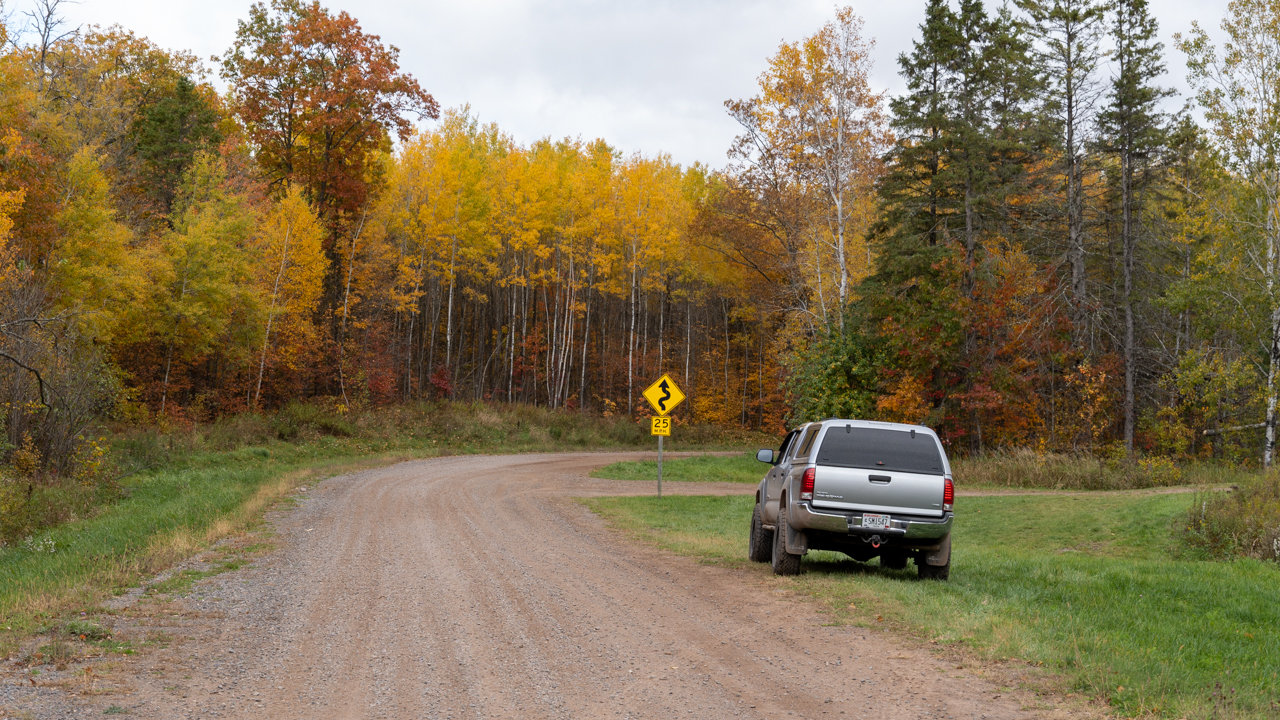

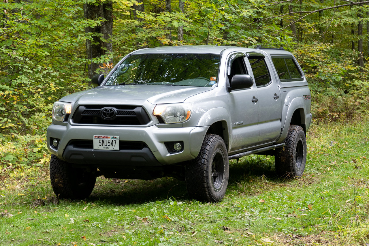

    Nothing special to see here, just a gravel and dirt county road somewhere near Hayward, Wisconsin. The aspens were their peak shades of electric yellow. Lots of bear hunters out in these woods - not something you see everyday where I'm at in the city.

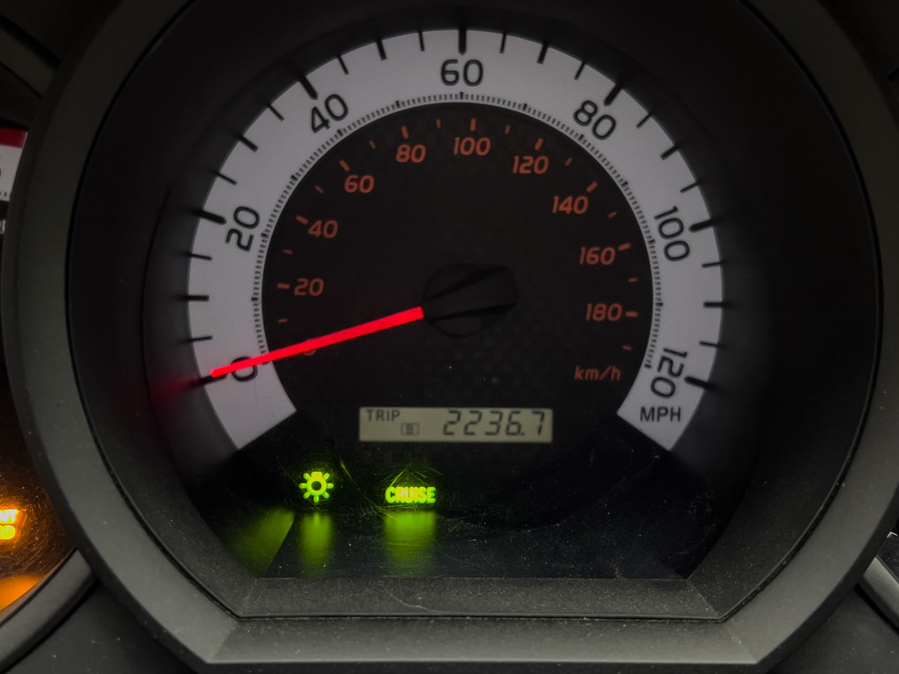

    Edit: I forgot one - the Trip B counter showing my mileage. 2,263 miles in about 2 weeks spanning 3 states.

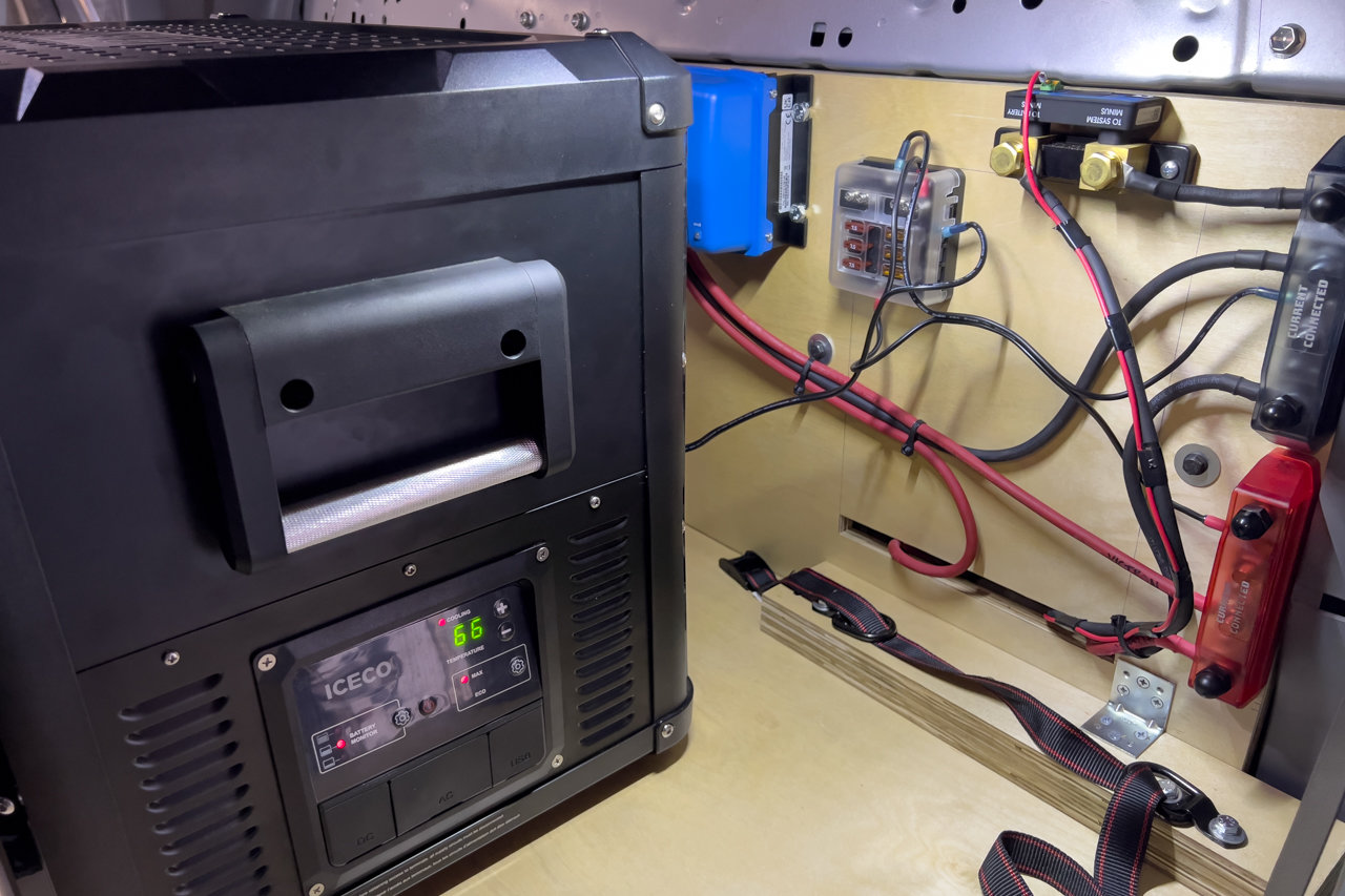

    • New 12V + fridge + wiring/etc probably adds 100lbs alone. OEM rear seats versus the 3/4" plywood platform probably a push.

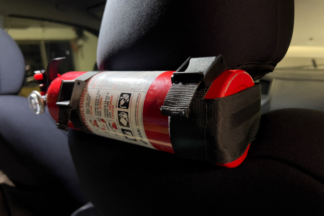

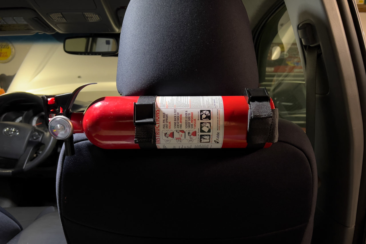

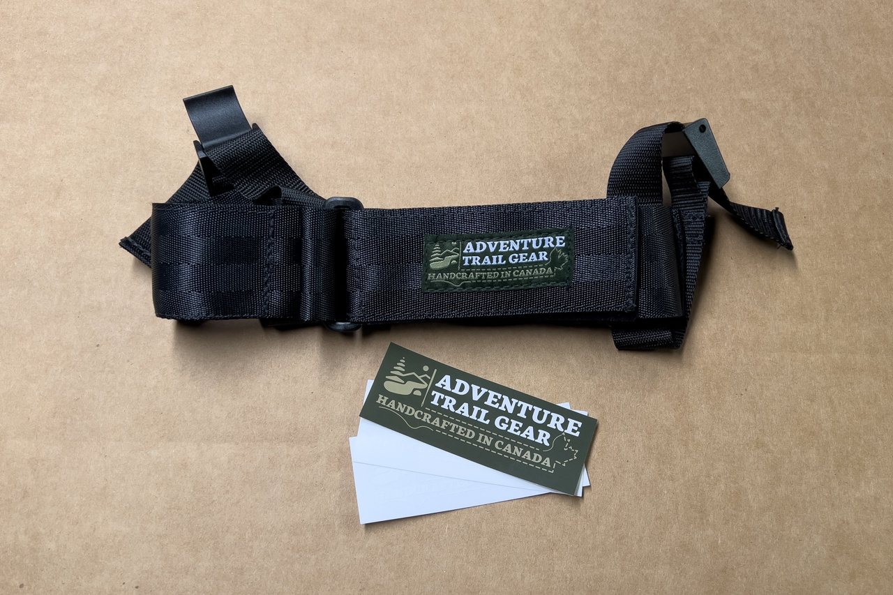

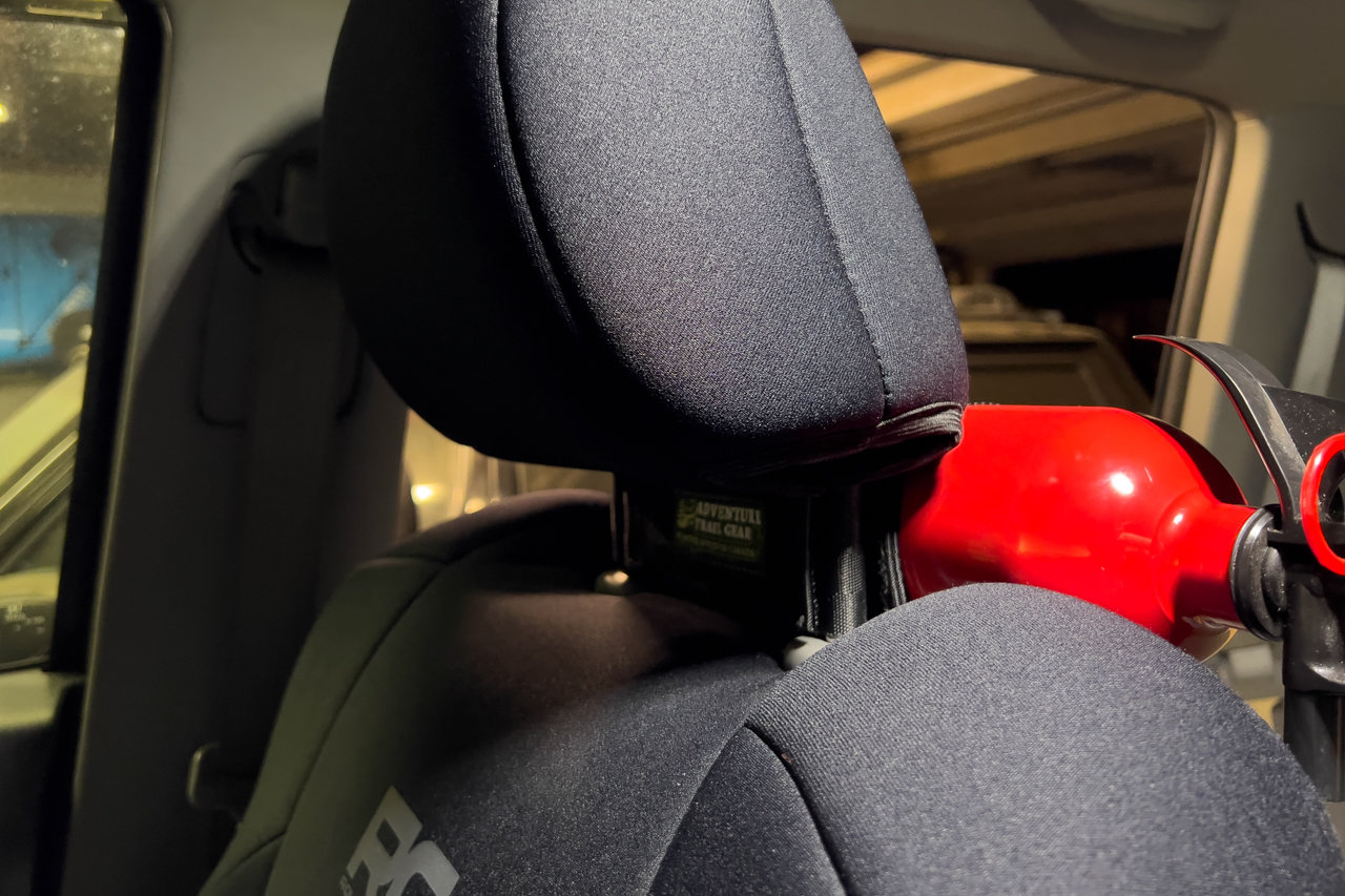

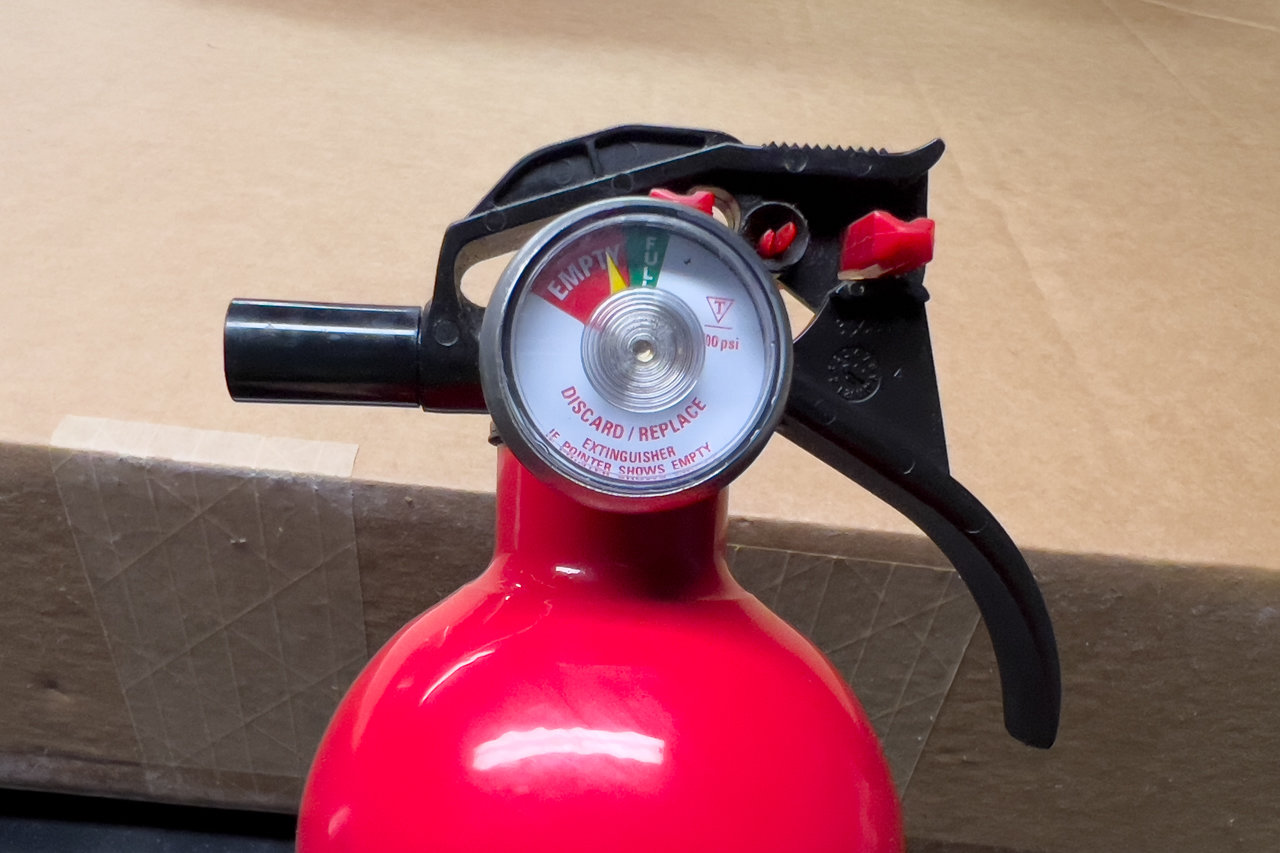

    11/29/22: Finally received my Adventure Trail Gear headrest fire extinguisher mount today. I chose this one because it's craft made, minimalist, and puts the extinguisher in a very accessible location while not really getting in the way. It helps that it's also the least expensive option - many others are metal and cost much more.
    I had an old 2.5lb extinguisher laying around and looks like it finally expired. I was planning to buy a new one soon anyways but this moves it up on the list.
    Mounting is extremely easy. Strap the mount around the two headrest posts, then cinch down the extinguisher with the two buckles.
    Here's another view. Interestingly the buckles I got are a little tricky to get tight and lock them down. They are also different buckles than pictured on the manufacturer website. Hmm, oh well. It still hold securely but I'm a little underwhelmed.
    Unfortunately I found a complete deal-breaker and it's all my own fault. Had I looked more closely at the manufacturer’s product photos I would have seen it before buying. Mounting to the headrest posts requires raising the headrest upwards several inches. I myself am quite short and generally so are my other family members/passengers. Because of the gap, the headrest is now in a slightly weird position and causes discomfort. Probably a non-issue for anyone taller than 5'6". No can do, guess I'll trade/sell it to someone else later. New plan is to mount down below the front driver seat on a bracket.

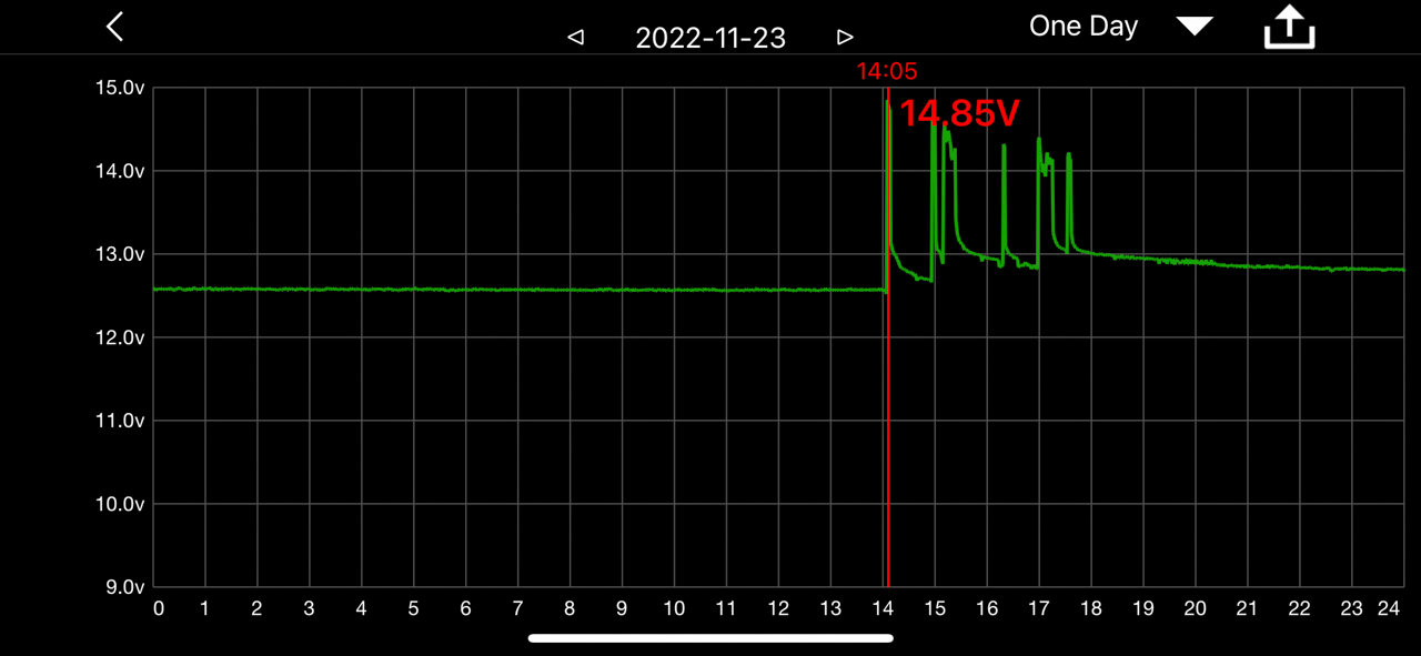

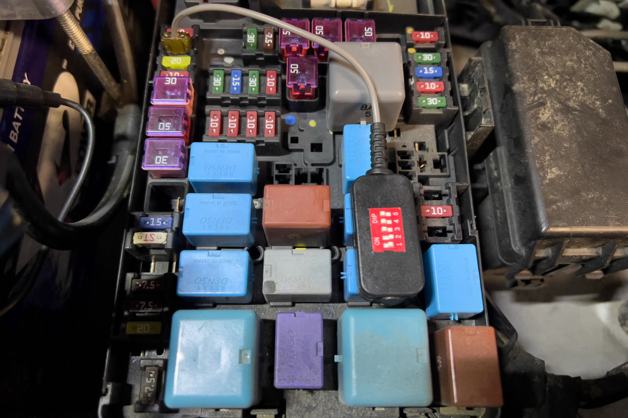

    11/29/22: Ever since upgrading to the AGM battery and installing an HKB fixed 0.5V booster I have been concerned of exceeding the desired voltage range when temperatures get cold. Checking the logs of my bluetooth battery monitor, I see the most recent day with similar temperature was all the way up to 14.85V at startup before it tapered off. I know this probably doesn't hurt anything but still doesn't sit well with me. Good enough isn't perfect and there is room for improvement.
    One random day I was looking at the HKB website and noticed they had a MK4 adjustable booster in stock. On a whim I bought it and it only took a couple weeks to arrive which is incredibly fast and lucky. I set it for +0.4V boost. Installed today and double-checked voltage using both the bluetooth monitor and a multimeter. Both read between 14.6-14.7V which is exactly what I was looking for. For a data point, ambient temperature during this reading was about 50°F; unseasonably warm but we get a few days like this during late fall.
    The MK4 assembly comes with a small piece of VHB tape already attached for quick and easy mounting.
    I cleaned off the top of a few relays and mounted in the position of least tension on the wiring. Everything fits perfectly under the stock fuse box cover. I should have done this from the start, oh well you live and learn.
    sparkystaco likes this.
