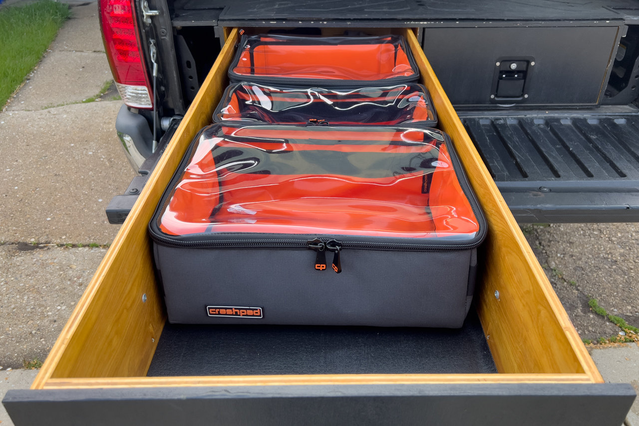

    Chapter 8: Building Drawers & Final Assembly
    Several months went by since the original platform build and it was time to finish the drawers. I pre-cut all my pieces this time which is a much smarter way to save time.
    3/4" steel square tubes were prepped by sanding down first with 80 grit sandpaper that I had onhand, then with a red Scotchbrite pad for a slightly dulled brushed finish. Cleaned up with some denatured alcohol and hit with 3 coats of clear gloss Rustoleum to prevent rusting. Came out perfect.
    Drawers were assembled the same way as before - glue and pocket screws. I used a few scrap cuts inserted like dividers to make sure the box stayed square while glue was curing. I opted against cutting slots inside the drawers for a divider system on this build mostly due to time, but also because making those cuts with a circular saw would be quite the chore. If I had a table saw I probably would have done it.
    (Ignore all those extra pocket holes drilled into the top, I made a booboo but ran out of lumber so I had to roll with it. Was angry at the time, it's the one major cosmetic flaw. Nobody really notices and the drawers work great so I don't sweat it anymore.)
    Once the drawers were assembled I made another small plywood jig to hold the 3/4" steel tubes in the correct spot, drilled 1/16" pilot holes from inside the drawers, and then attached them using 1" self-tapping lath screws. Those particular screws have a wide washer-like head and they hold great.

    Chapter 11: Organization
    Up until now, I've been throwing my gear loosely in the drawers which is a chaotic mess. Sometimes I'll use these Rubbermaid totes that I already had on-hand and accidentally fit but they are cumbersome and waste a lot of useable space. After doing a lot of searching and measuring dimensions I only found the Front Runner Flat Pack to be suitable but I don't like how they are constructed.
    Turns out @WiscoPat had these here Crashpad Crashpod organizers and was showing them to us at the last couple camping trips. Wouldn't ya know they are almost perfect for what I had built completely by a happy little accident. Took a while to arrive from Australia but so far I'm impressed. Cheers Pat!
    Truth be told I'm terrible with sticking to staying neat & organized unless I have good solutions like this. While little things like this can add up to considerable expense, if they make me more efficient for longer trips it should pay for itself by giving me extra time to do actual fun things like exploring & wheeling. Will update this post in the future to show how this evolves over time.
