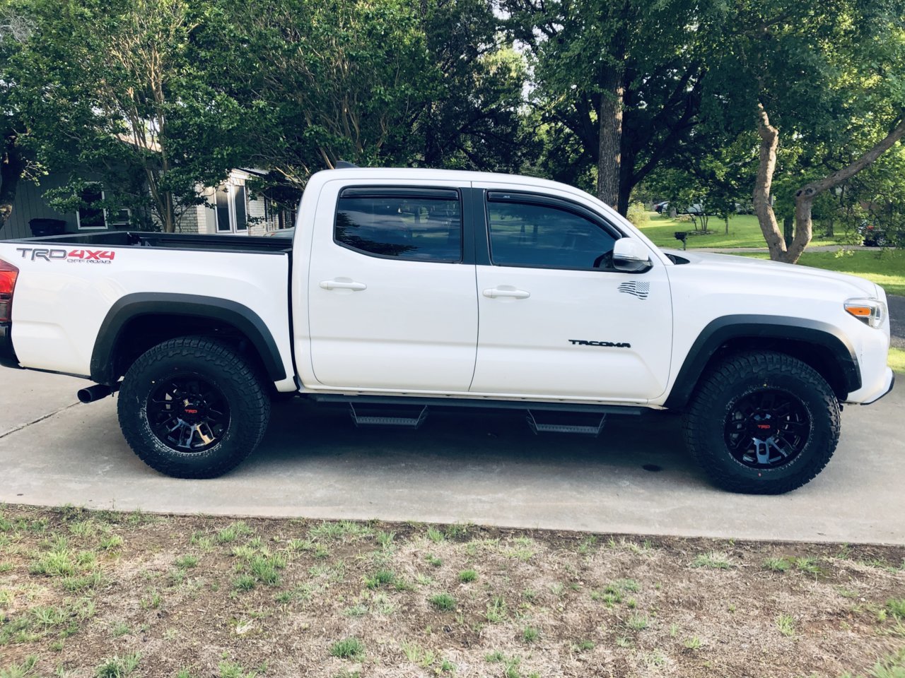

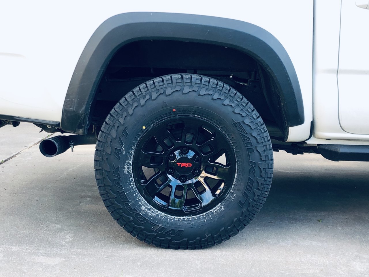

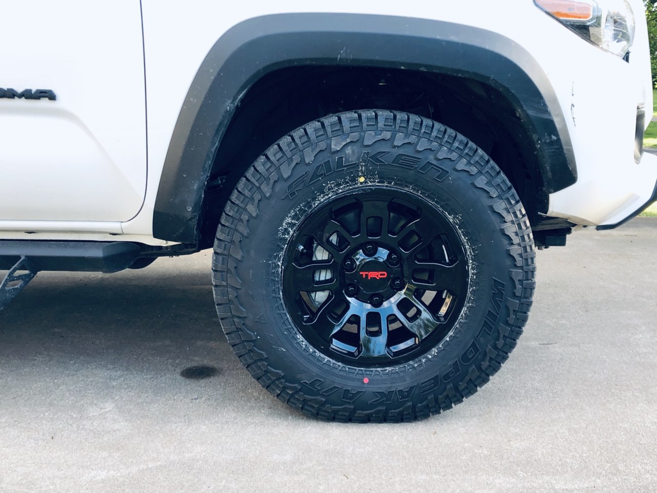

    Don't mean to hijack OPs thread. Just got it installed yesterday. Here is how it turned out, no rubbing so far.

    this is 255/80/17 with stock suspension?
  9. Apr 17, 2020 at 8:48 AM
    dleriche
    dleriche Wanee Warrior
    Feb 29, 2020
    #320735
    181
    D.J.
    Leander, TX
    2019 White TRD ORD DCSB AT
    Yes, this is on stock suspension. Aftermarket rims are 17x8 with +15 offset
